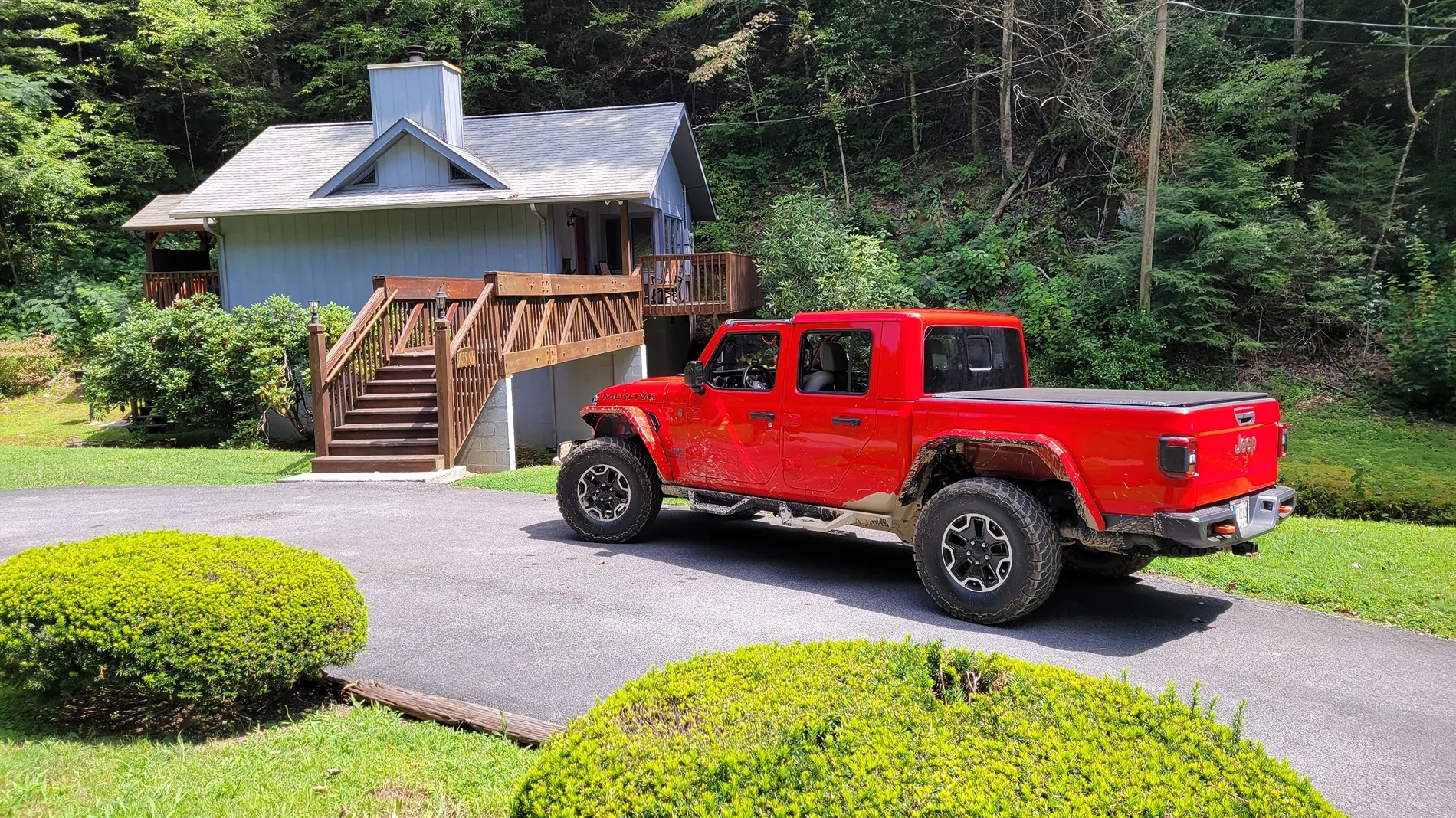

Method 709 HD's 0 offset, 37" Baja Boss AT's
man that’s a good looking setup!
How far is the tire out of the fender, one row of tread or is that just the angle of the photo? rear looks like it could just be the sidewall.
I’m leaning closer to the Micky BB - what lift do you have?

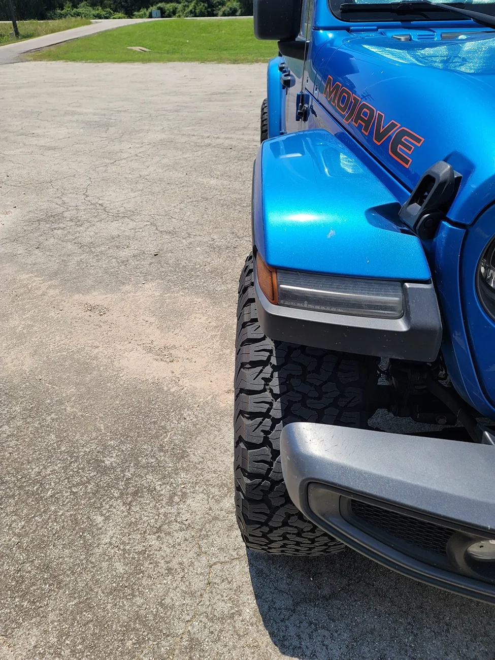

2024 Gladiator Mojave
ISSM

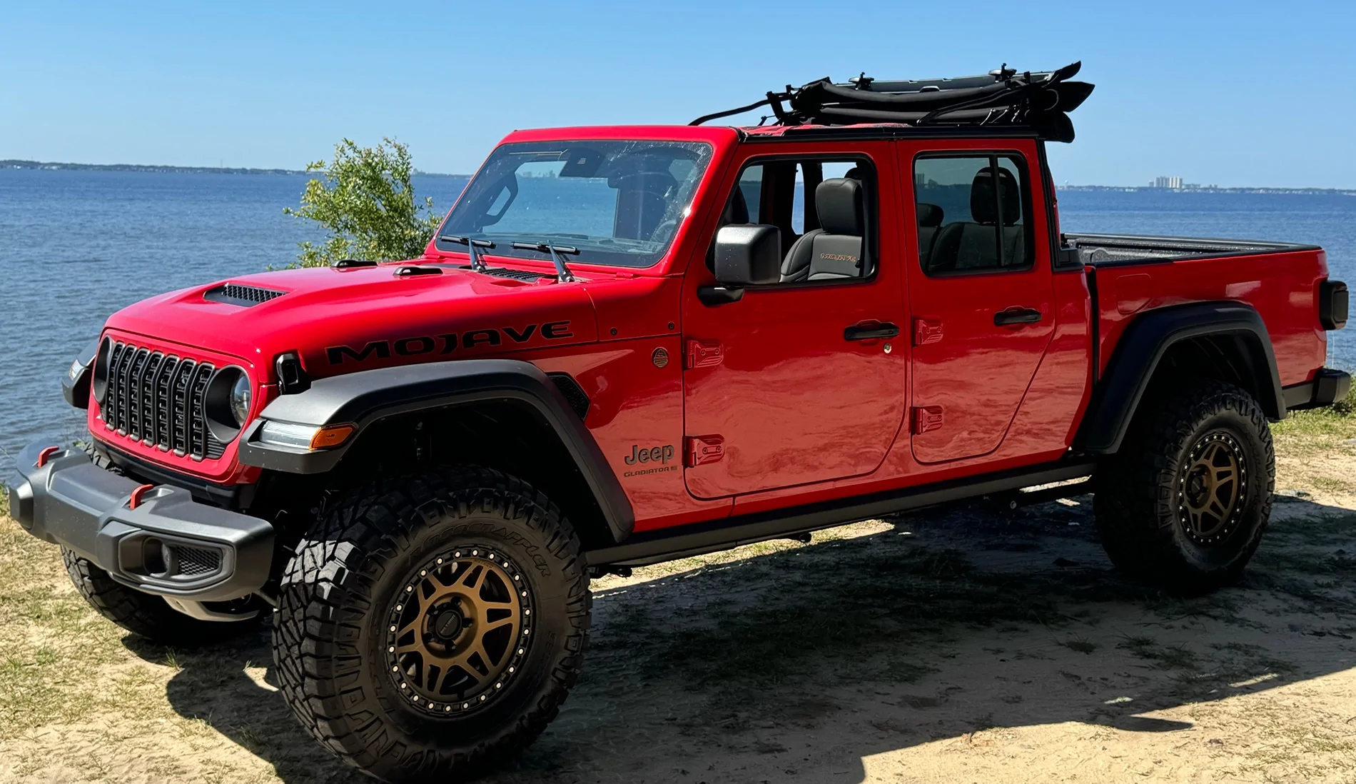

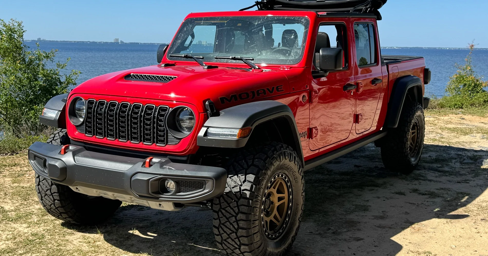

here is a picture of my 2024 with stock suspension before the lift and 35 12.5R17 Nitto Ridge Grappler's on Method 312's 17X9 with -12 offset and 4.5 inch backspacing, no rubbing and plenty of clearance

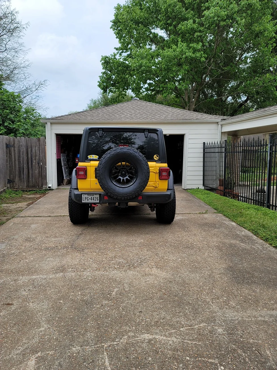

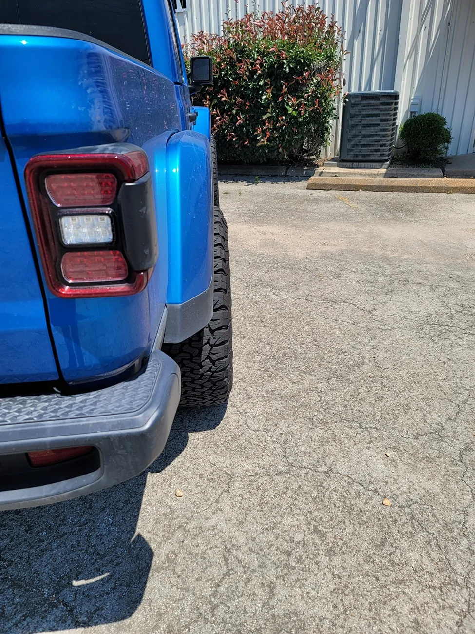

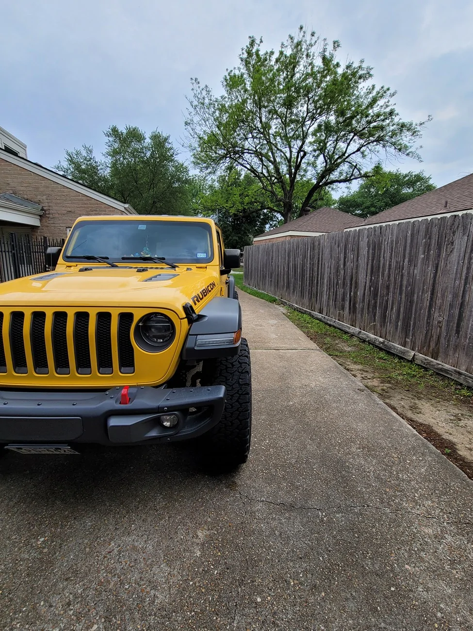

These are Quadratec wheels. +10 offset. 17 x 8.5. It has just a little less poke than my wife's JL with 0 offset.
Jeep Gladiator 2025 Mojave X - 35's & 17's 20230503_123836
Jeep Gladiator 2025 Mojave X - 35's & 17's 20230503_123755
Jeep Gladiator 2025 Mojave X - 35's & 17's 20220416_153237
Jeep Gladiator 2025 Mojave X - 35's & 17's 20220416_153016

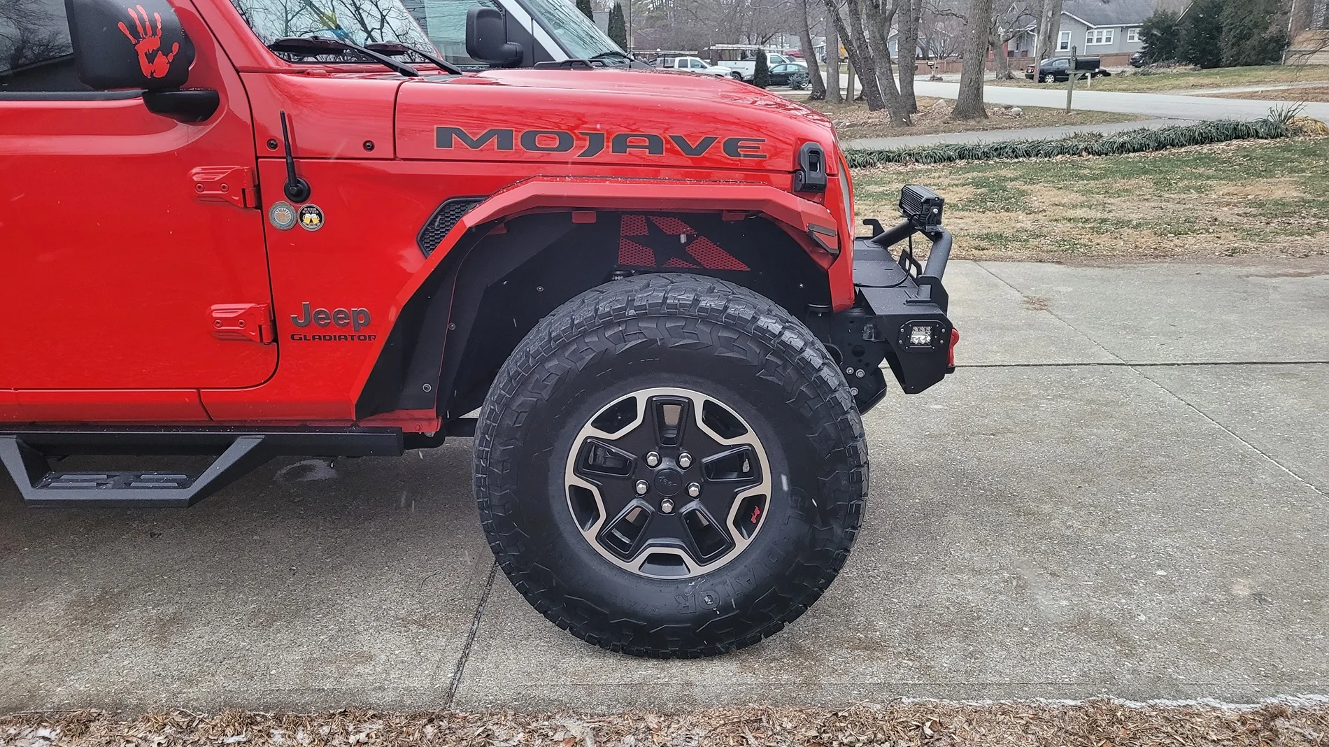

Pickle_Bill
Jul 20, 2021
123
125
SE NH
2021 Jeep Gladiator Mojave
The tread of the tire is exactly even with the outside edge of the x fender extenders. Only the sidewall sicks past that.
Clayton overland plus 2.5" lift

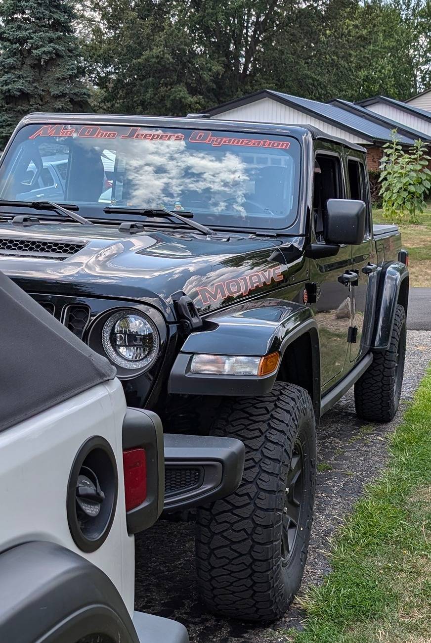

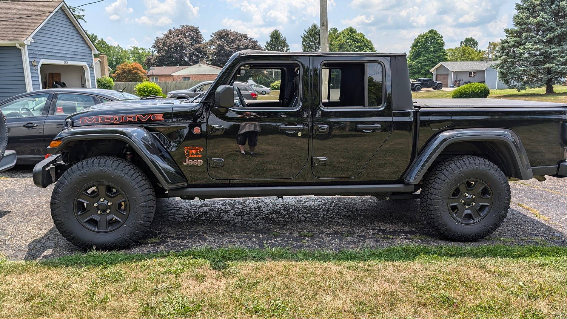

Crime fighter.

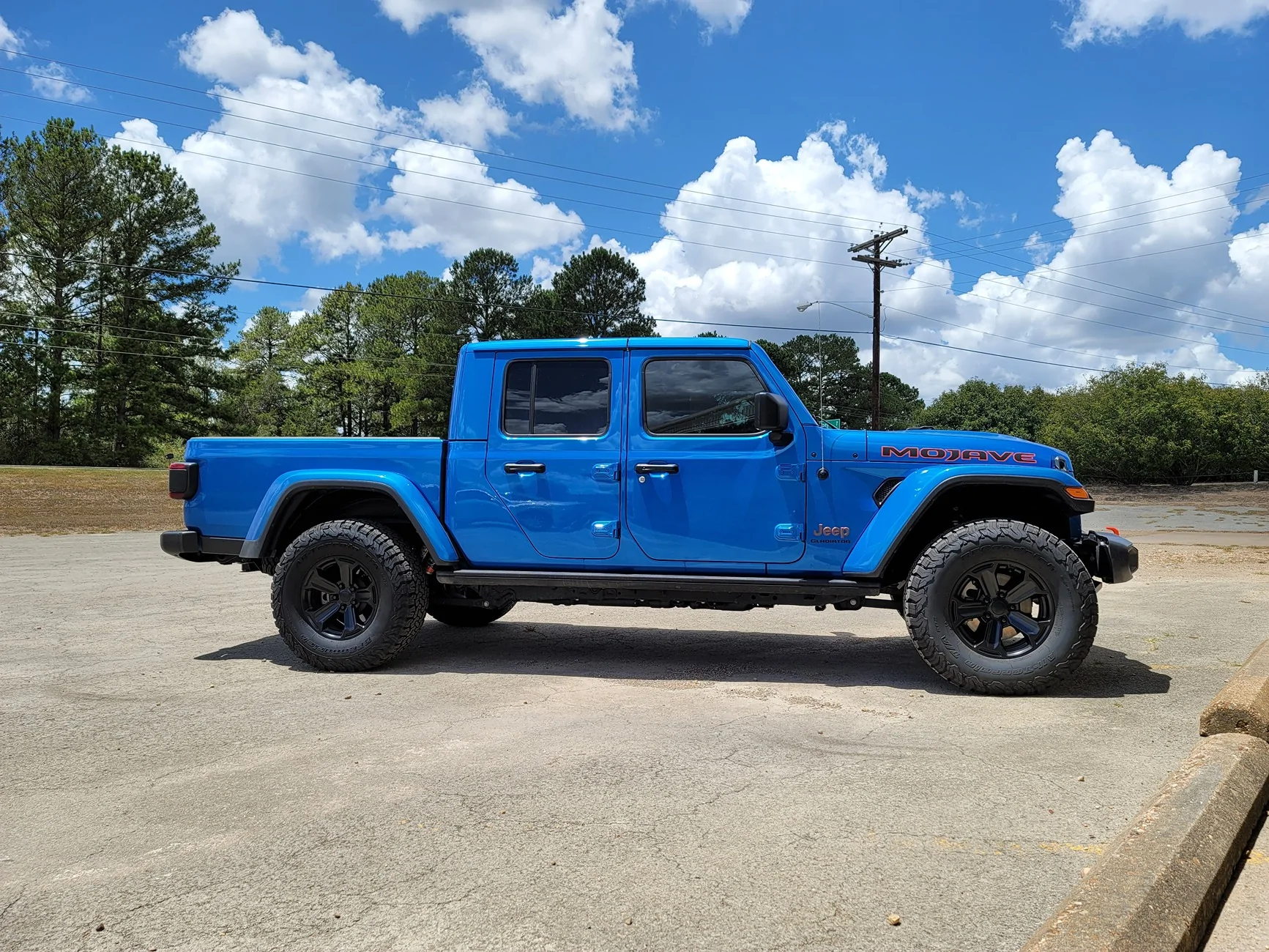

Not an X, but this is my 23 Mojave with factory wheels and Razr Maxxis A/Ts in 35x11.50x17.
No lift, no level. 28k miles on them so far and rides great.

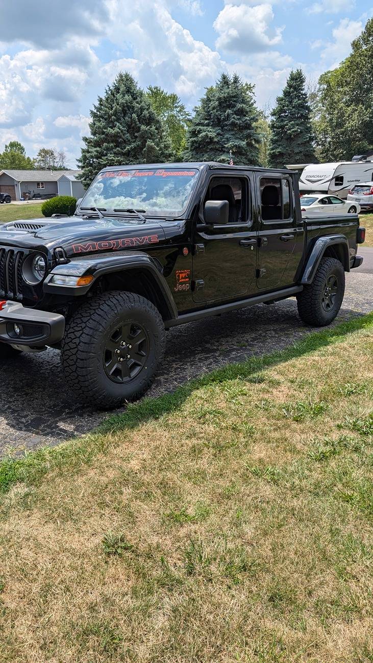

Pat Witt
Pat
Mar 14, 2024
110
106
Indianapolis
2021 jeep gladiator
Service technician
First picture is with my new 37-12.5-17 and Second is the 35x12.5x17 original wheels and no lift just different fenders from original
Jeep Gladiator 2025 Mojave X - 35's & 17's 20251229_164305
Jeep Gladiator 2025 Mojave X - 35's & 17's 20240821_144834
