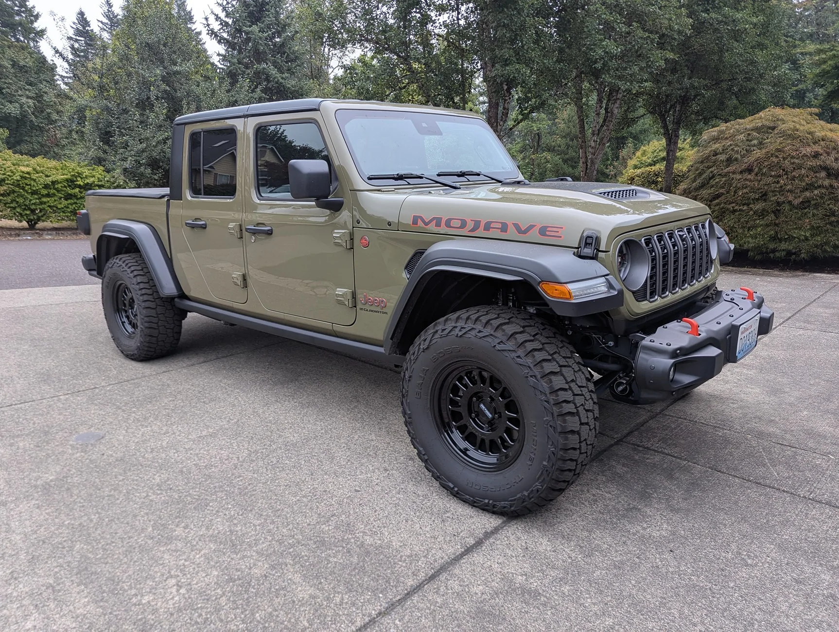

Joe
Jun 18, 2025
Washougal, WA
'25 Gladiator Mojave, '21 Wrangler Rubicon, '85 CJ-7 Laredo
Driver

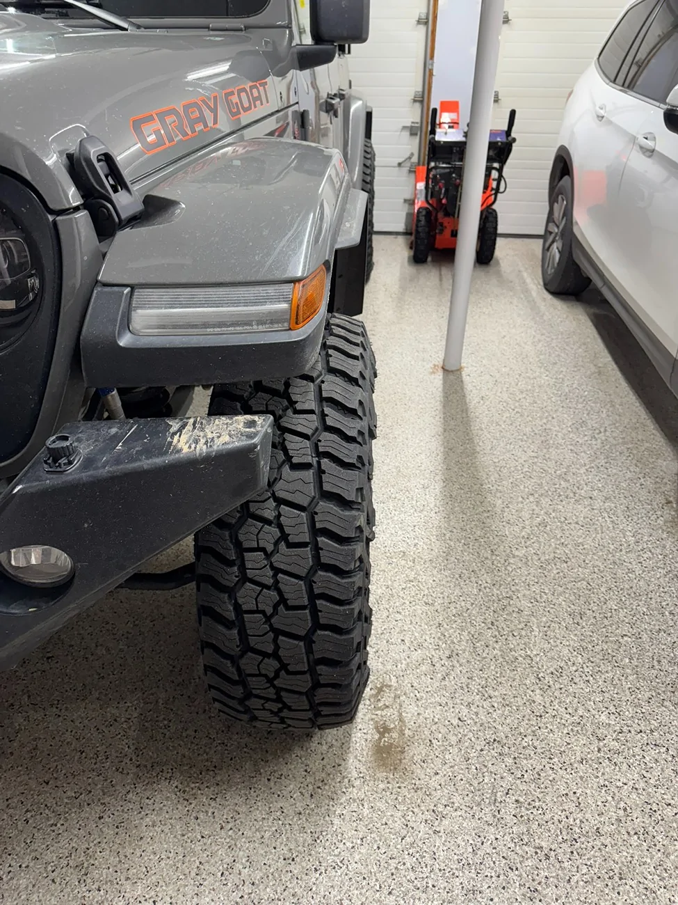

35x12.50x17 Baja Boss AT on Method 0 offset. No lift, no rubbing, but definitely some poke. I added the XR flare extensions to gain back the coverage, and I like that look. It's now lifted and quite a bit different, and will get bigger tires someday.

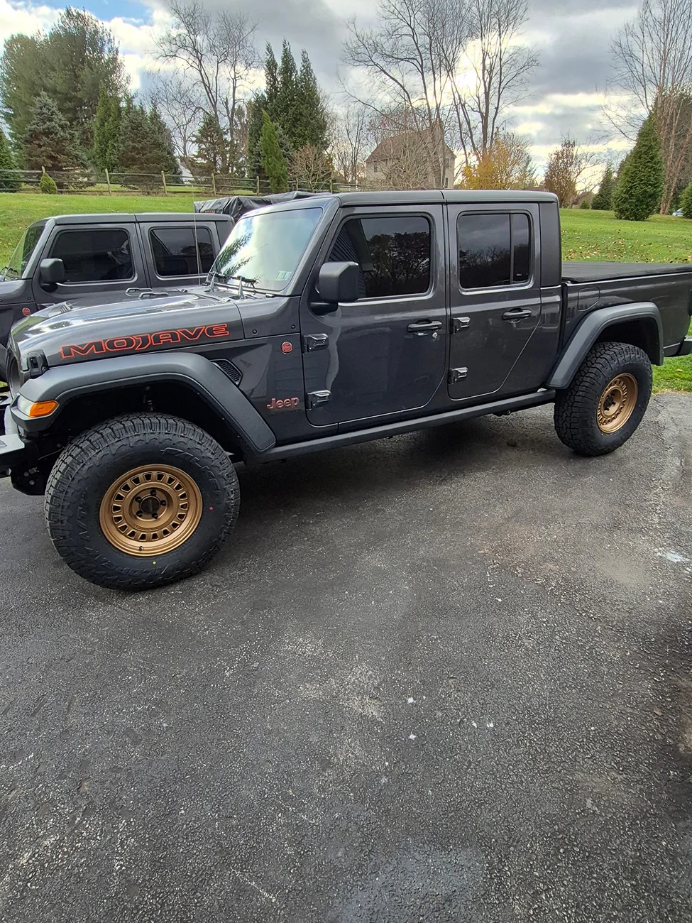

Picking up a 2025 Mojave X tomorrow. I want to put 35's and 17's on it. I don't want to level, lift, or do any trimming. What is the offset range I should be shopping in to achieve this? I'm fine with a slight poke (nh), would prefer that the tread is flush with the fender flares and just the round of the tire extending past but again, am fine with a little more than that. I'm assuming the closer I get to 0 offset, the more the wheel & tire will push out from the flare. Any guidance and/or photos here?
Tire wise, I want the biggest, true 35 A/T tire that is great in all seasons. I live in UT and do a lot of winter driving but I want something quiet and comfortable on the highway as well.
I realize there might be resources in the forums but I've been digging through the posts and it's tough to find what I'm looking for.
I have a ‘25 MojaveX with no lift, Mickey Thompson 37x17x12.5 Baja Boss AT, paired with Methods Race Wheels Bead Grip 703 17x9 | 5x5 | -12/4.57” with no rubbing whatsoever. I purchased a Teraflex 2.5” complete spacer kit, W/shock extension, adjustable upper/lower control arms, adjustable front track bar, etc. Planning on installing the kit soon.

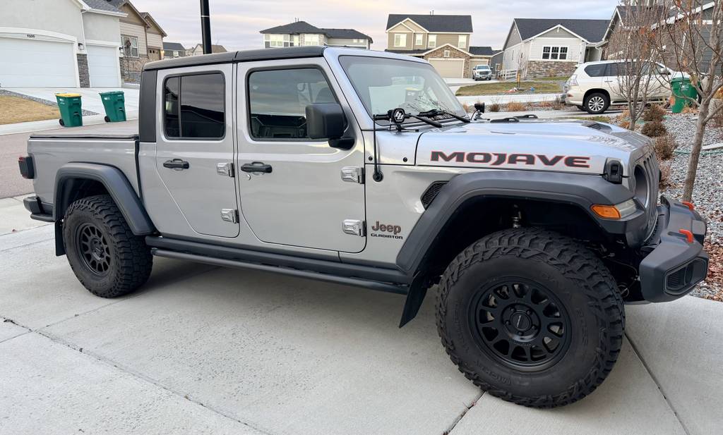

2024 Gladiator Mojave X
Biller

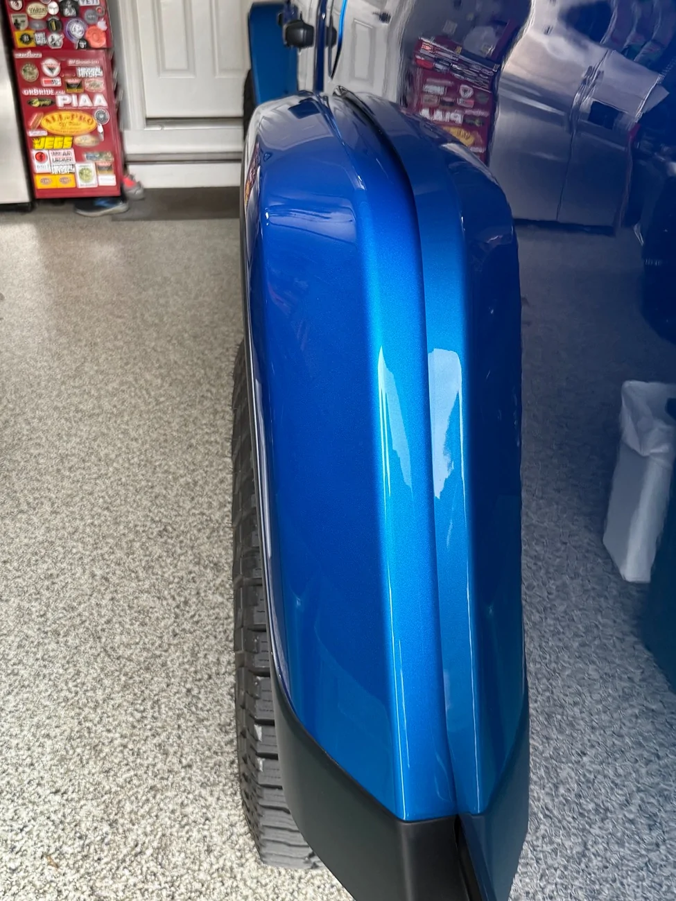

I’m not running 35’s….. but I am running the original 33’s on Method wheels 17 x 8.5” with +25 offset. 2024 Mojave X
Totally flush with the fenders and keeps me ‘legal’ in Pennsylvania.
