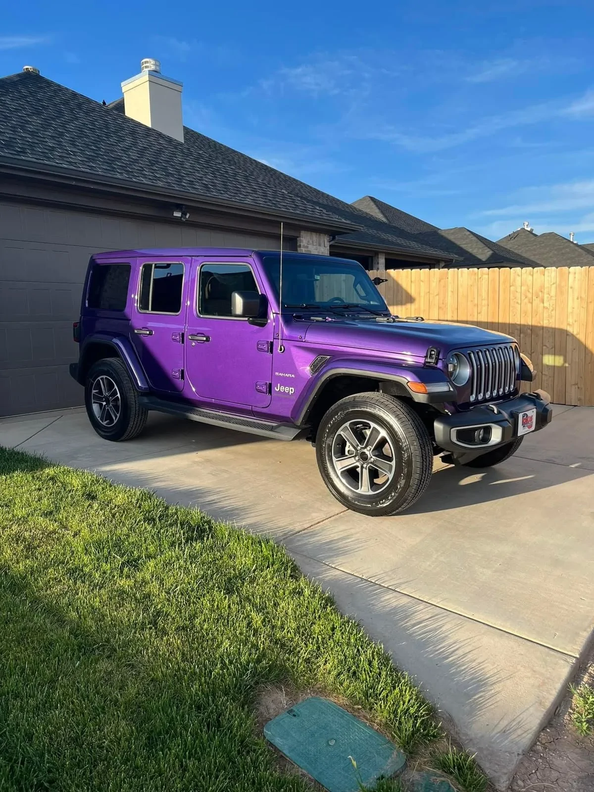

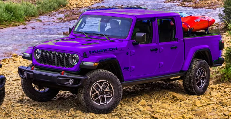

Not even close! That's way off by several shades. Whew, my wife doesn't dare see that abomination.
wow, that's really off!
Reign is deeper.
Jeep Gladiator 2026 Gladiator Quick Release Door Hinge (no tools required) + New Colors fa992b8ad73d838b492ebc32cbde788a
Jeep Gladiator 2026 Gladiator Quick Release Door Hinge (no tools required) + New Colors reign1-jpg
The top image was the target color/match. Looks close to me. Especially coming from a previous color like Gator, the color can vary quite a bit depending on lighting and time of day.
Either way, it was a "quick" (as stated) 5-minute job just to give an idea of what a purple Gladiator looks like. Not intended for anyone to make a go/no-go decision on a Reign JT.
And thanks for the abomination shout-out. :CWL:

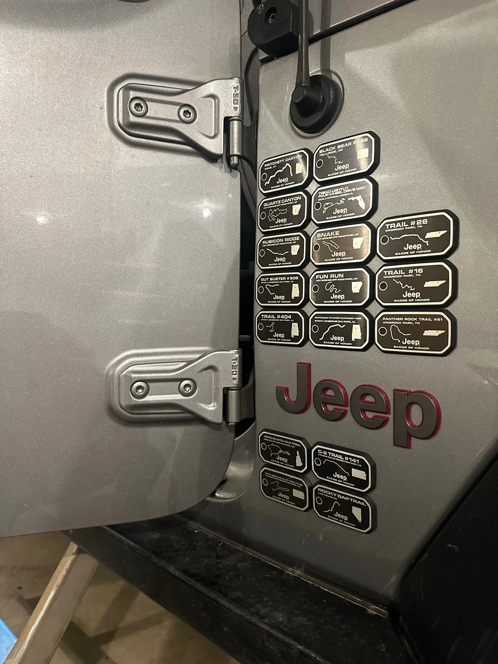

Pulled mine off and put them in the bolt holder day 1. I haven't touched them since.
We're supposed to put them back on? Are the doors going to fall off or something if we don't?
