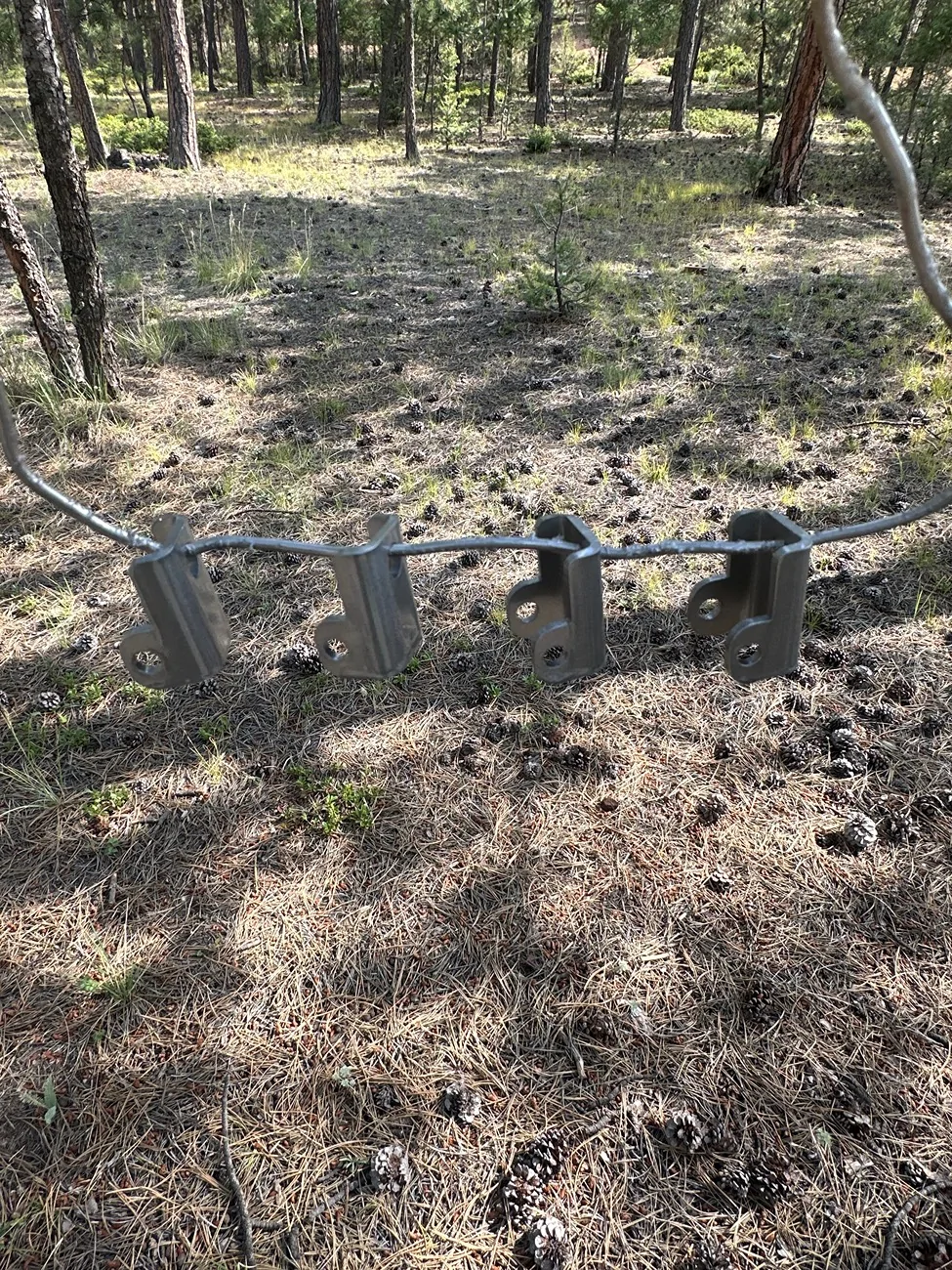

Not being "magnetic" could be multiple things. Stainless would be pretty expensive, but it's possible. Seems like overkill, and stainless against aluminum? Hmmmmmmm.
Good points. Makes me even happier that I painted them.

They look like raw stainless to me. There's a good coat of paint already as an insulator, and you could even just put a layer or two of electrical tape on the backside before bolting them down to add more isolation if desired.

Could be stainless....... seems like overkill, but could be. I was only suggesting that many metals are non-ferrous (what some call "non-magnetic")
I'd use paint, or, what I often do for such things where some strength is involved, use the cellophane as from a cigarette pack, or the plastic used on some boxes that toy action figures come in, or other bubble pack type hard, firm plastic. It won't move and squirm like tape when it gets hot in the hot sun.
There's a lot of simple ways if someone doesn't want to paint them.
I am still using the plastic washers I made for the louvers on my SX4 - I wanted a plastic washer to go between the nuts and louvers on the hold down area and made them out of a plastic bottle.
Personally, my preference, is paint to match. Otherwise, it would look like a replacement part on my rig. Again, personal preference - want it to match and not look like it's added parts.

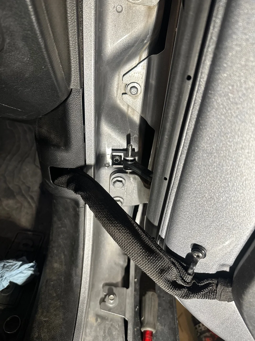

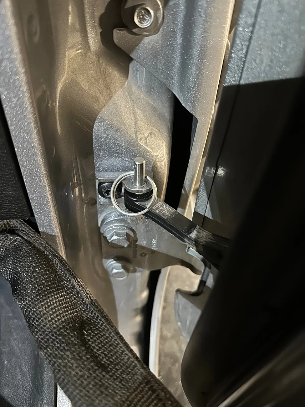

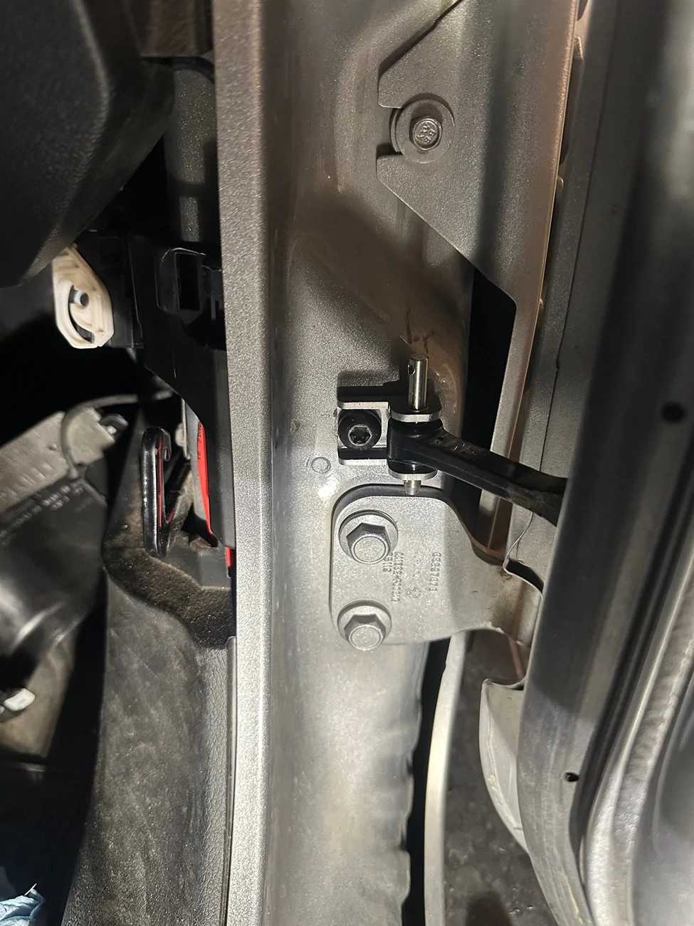

I ordered this, and just did the install on my passenger front. Worked great. The brackets come in raw steel, so I painted them with mopar billet silver to match the body. I also pulled the key ring intended ti pull the pin. It was too large in my opinion.

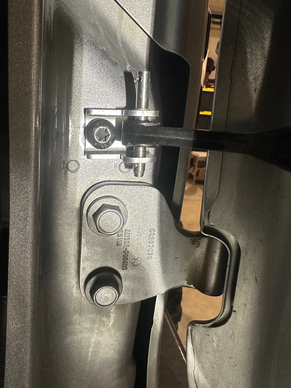

so I’m rather curious. Are there any dimensional differences between the stock brackets and the new ones? I’m just wondering why we can’t just knock out the pin and use the stock brackets.
They seem quite similar, the the new ones are a tad larger. There would be more work getting the pins out as one end is pressed into the bracket. I didn’t drill them out. I used my portable m12 bandsaw and a 2” cutoff wheel on my die grinder.

You could just drill this pin out and throw your own grade 8 pin in there.
While I agree, it would likely be loose because the holes are different sizes. You could get it to work well with some sleeves. The other thing I didn’t realize is that the existing pin is pressed in really solid on the other end. So the brackets weren’t Ben worth saving for me. Too much work to get the pins out.
