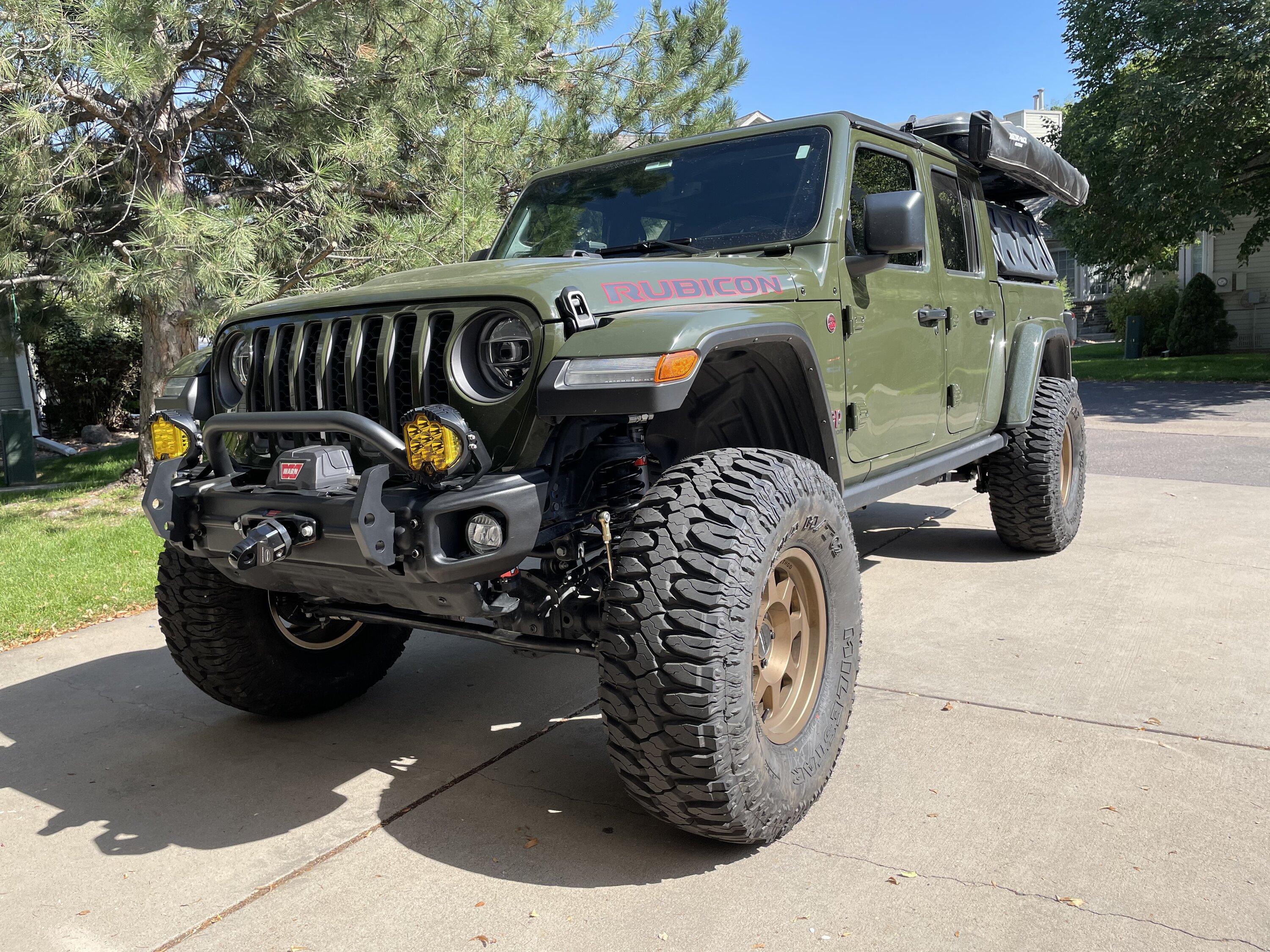

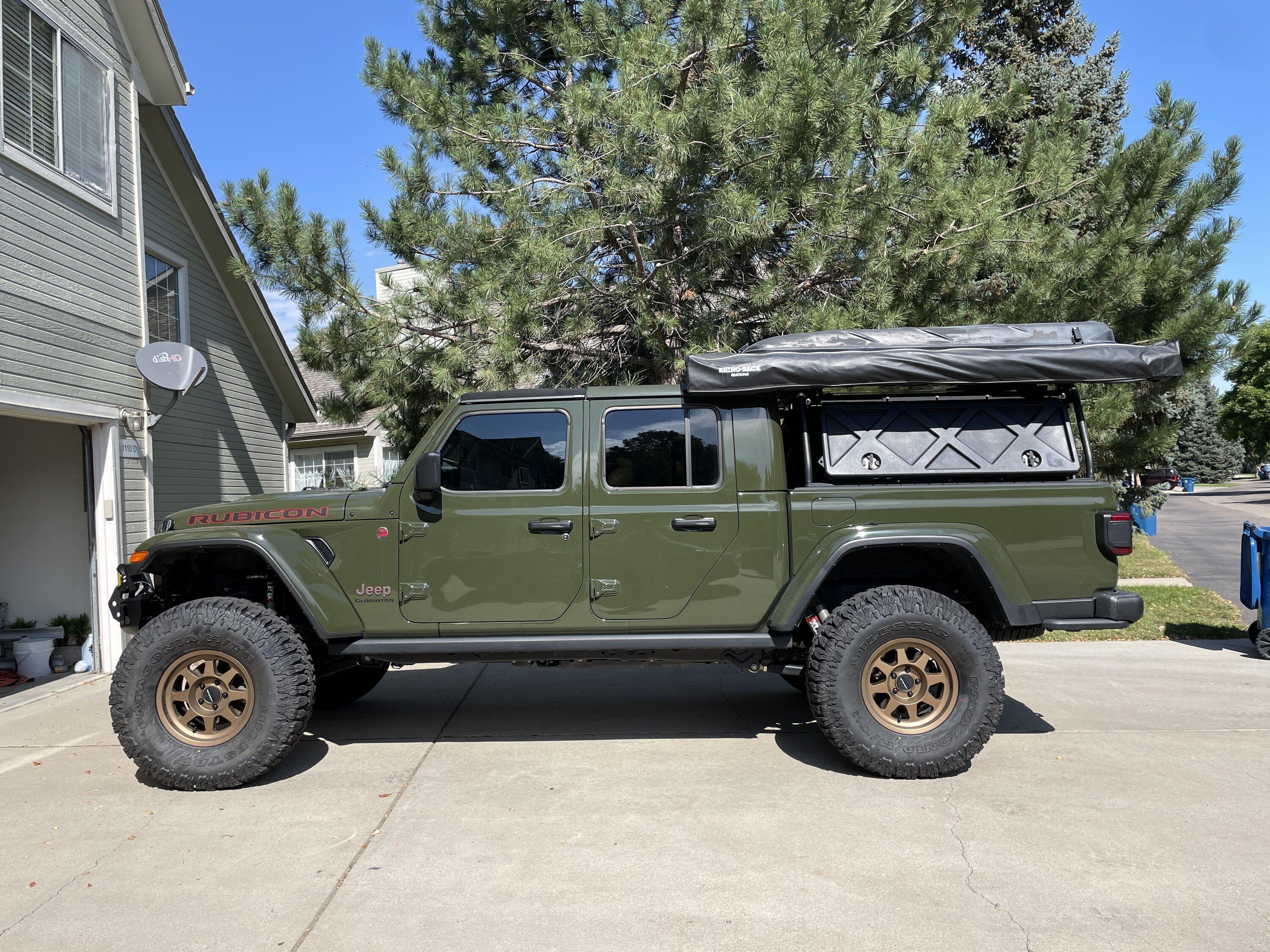

Thanks for the input. Decided to go with a tazer. Here is the rig as it sits now ready for the weekend outing. Stock to this in 2 weeks. 38s and the diesel barely noticed it. :)
