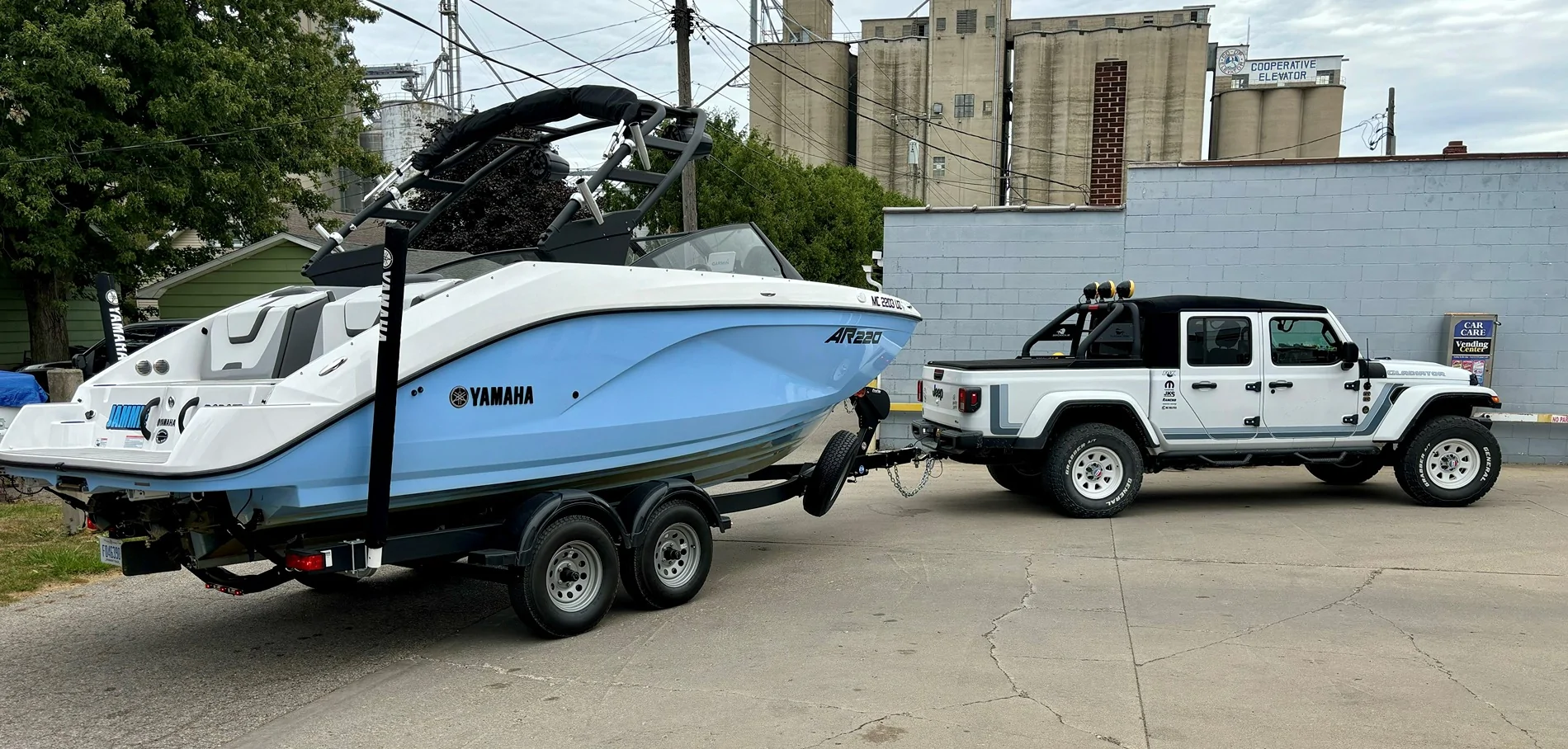

Would the dealer do that? I assume they would charge something?
Dealers charge $125 to recalibrate the tire size. They can only go up to 35's. I had to buy a tazer when I went to 37's last spring.

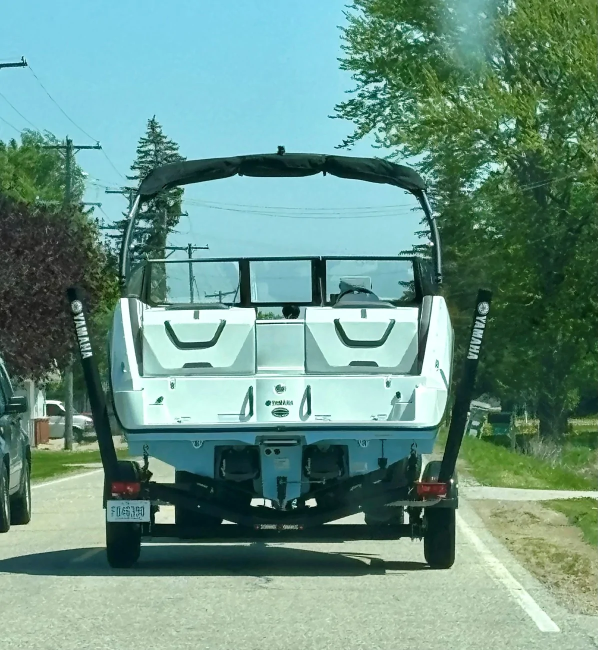

I tow a 22 foot Yamaha Jet boat. I have the max tow and towing it home from the dealer which was 3 hours away, I would not do this every weekend or really much at all. You could tell it was back there.
With that being said, now that its home (bought it back in May of 2024), I only have to tow a few miles from my dock to the marina for winterization and to indoor winter storage per season. I will borrow a buddy's truck if I ever have to take it back to the dealer for warranty work.
