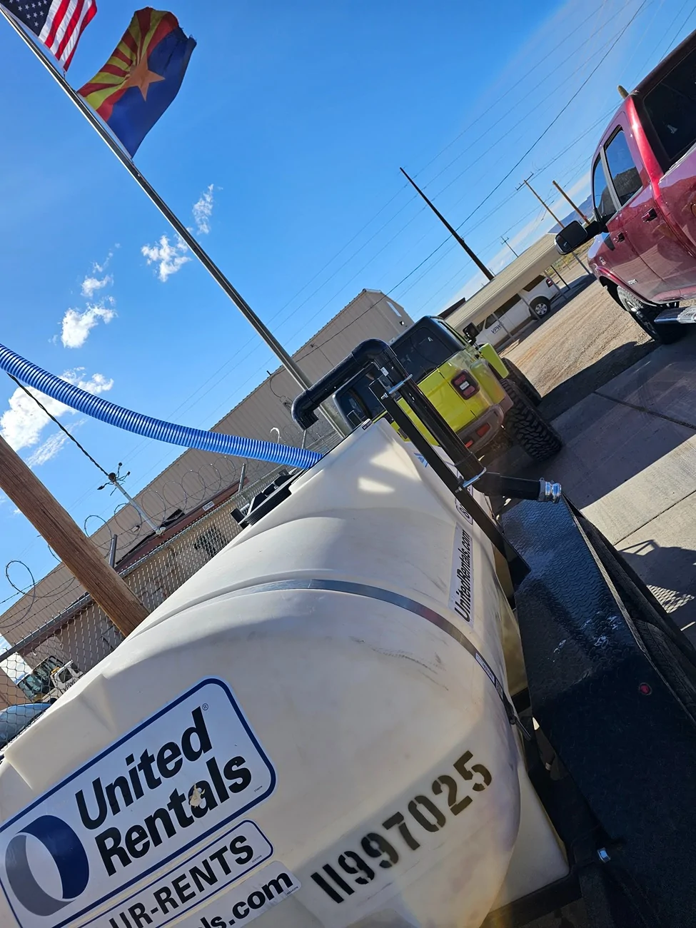

In Europe, they also put less weight on the tongue, which is easier on the tow vehicle's suspension and chassis, but it is less stable. There's a video on YouTube where they run toy cars with trailers on a conveyor belt. When there is more weight on the tongue, you can poke the side of the trailer and it will self-correct. If you shift the weight to the rear of the trailer and poke it, the trailer begins to oscillate wildly across the belt. That's why Europeans have lower speed limits while towing.
A tandem axle trailer really helps with stability at lower tongue weights, which is the only thing I'd tow over 5k lbs anyway. The lumber load pictured was 8240lbs and only 600 lbs on the tongue. No sway and perfectly stable for 600 miles at speeds up to 70mph. The water buffalo was 6800lbs full and only 420lbs on the tongue. The toy car example is also pretty extreme, likely resulting in a negative tongue weight. I've seen dump trailers lift the rear axle of dualies off the ground when all that weight shifts past the rear axles. I don't think we need a toy car demo to know that it's going to be unstable as hell with the rear end off the ground? You can tell in the pics that there's nowhere near 10% tongue weight as there's very little squat.
