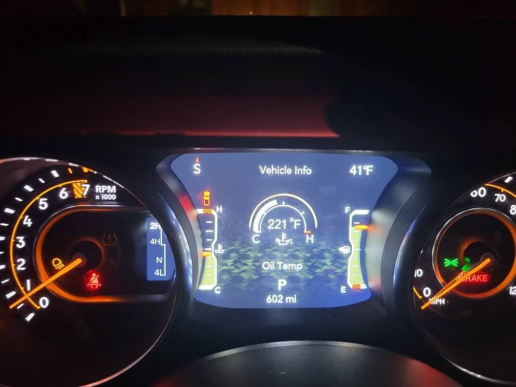

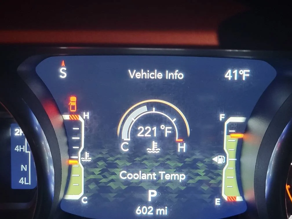

Can people please post their coolant temps at idle? I first noticed this yesterday while waiting in traffic. As mentioned, ambient air temps were in the 40s when I first saw it hit 220. I pulled off to a parking lot to monitor the situation, then shut the Jeep down. I restarted and it did it again.
Being the weekend, I decided to drive home just in case something was wrong. When I got home I let it idle and watched it go up to 222 on the display, then fall back to 213, then rise, then fall back. I suspect this is "normal" for this engine, but want to verify. Once it stops raining this morning, I will check the coolant level and make sure it is ok.

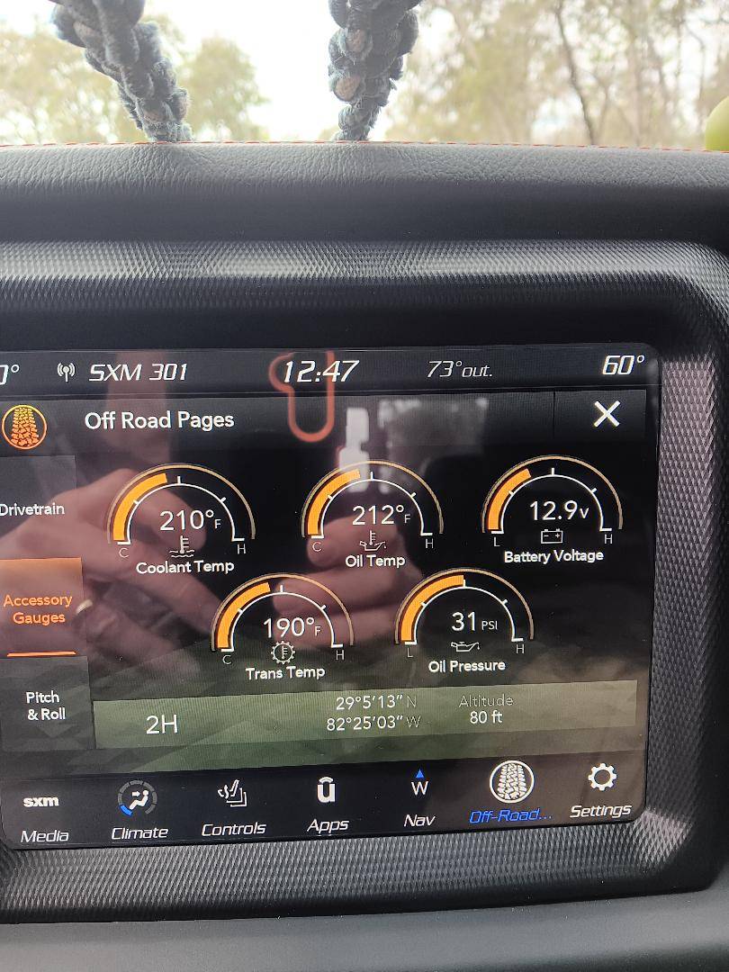

I took her out for another drive and just got back. Temps are under 200 on the highways and biways. I pulled over and looked out over the water for about 5 or so minutes, letting the Jeep idle in park. The coolant and oil temps both steadily climbed from 195 to 208 or so. I figured they'd probably climb back to the 222 and didn't see any point in continuing so I shut her off.
I drove back home and temps were again normal in the sub 200 range. The road leading to my driveway is gravel with a 15 mph speed limit, and my driveway has a steep entrance. When I stop and park the engine is 206. I guess what is going on is that these engines like to creep up in temp at slow speeds and when idling. I think the stop/start feature will be employed when necessary to prevent this creep.

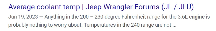

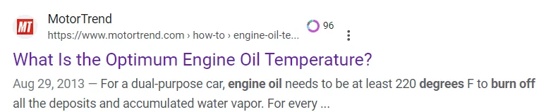

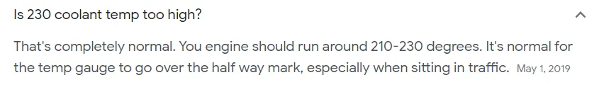

220 area is 100% normal. In fact, it's good for the oil. That's a FACT.
222 at idle is fine, it's not broken.
Thermostats start to open at the rated temperature - and aren't fully opened until at least 20-30 degrees later, depending on the thermostat, etc. - so that means the factory is not concerned about temps in the 220 area otherwise that stat would be wide open at 195-200. It's not.
In short, the answer to the original question is - it's fine, nothing is broken, ignore it. As long as it cools down while moving and doesn't climb up to the 230 area, it's just fine and doesn't need a thing.
