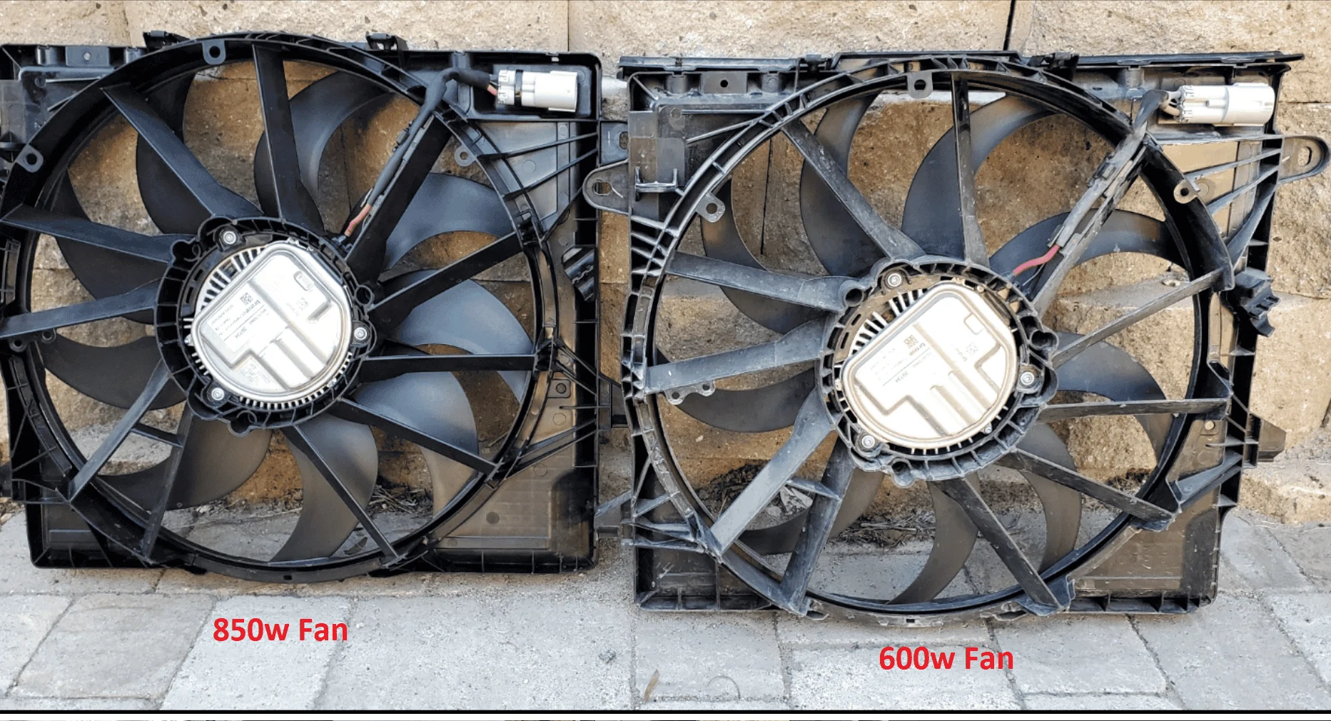

All it means is 850w versus 600w fan and the larger alt to handle the current draw.
An 850 watt cooling fan (same size, but running harder)? Do these have engine oil coolers? Sorry for the quick hijack.
The higher wattage fan has higher horsepower so can move more air (CFM, cubic feet per minute) than the smaller fan.
EDIT because he posted pics to show the difference in the blades -the higher HP motor (higher wattage = higher HP) can spin larger blades and move more air.
Interesting to note that the EPA requires car makers to show the location of every fan, inside and out, engine bay or not, and all air movement through a vehicle for evaporative emissions reports each year. A change in fan size of location means an amended evaporative emissions report to the EPA.
Now think about that in the grand scheme of things - why bother with a smaller fan? Hmmmmmm

They also have a 940 watt fan to combat the over heating problems
That's what I have in mine
Hootbro
Apr 13, 2019
10,207
20,003
2025 Gladiator Sport
Have a part number for that by chance?
