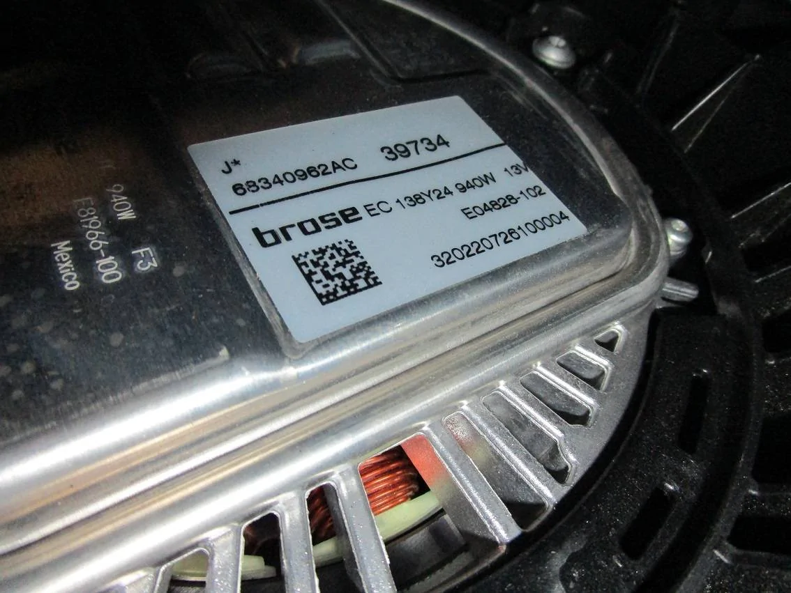

Here you go
Can't remember where I got it put it was less expensive than the 850 watt
Jeep Gladiator 3.6 Pentastar coolant temp 222 degrees at idle IMG_2010

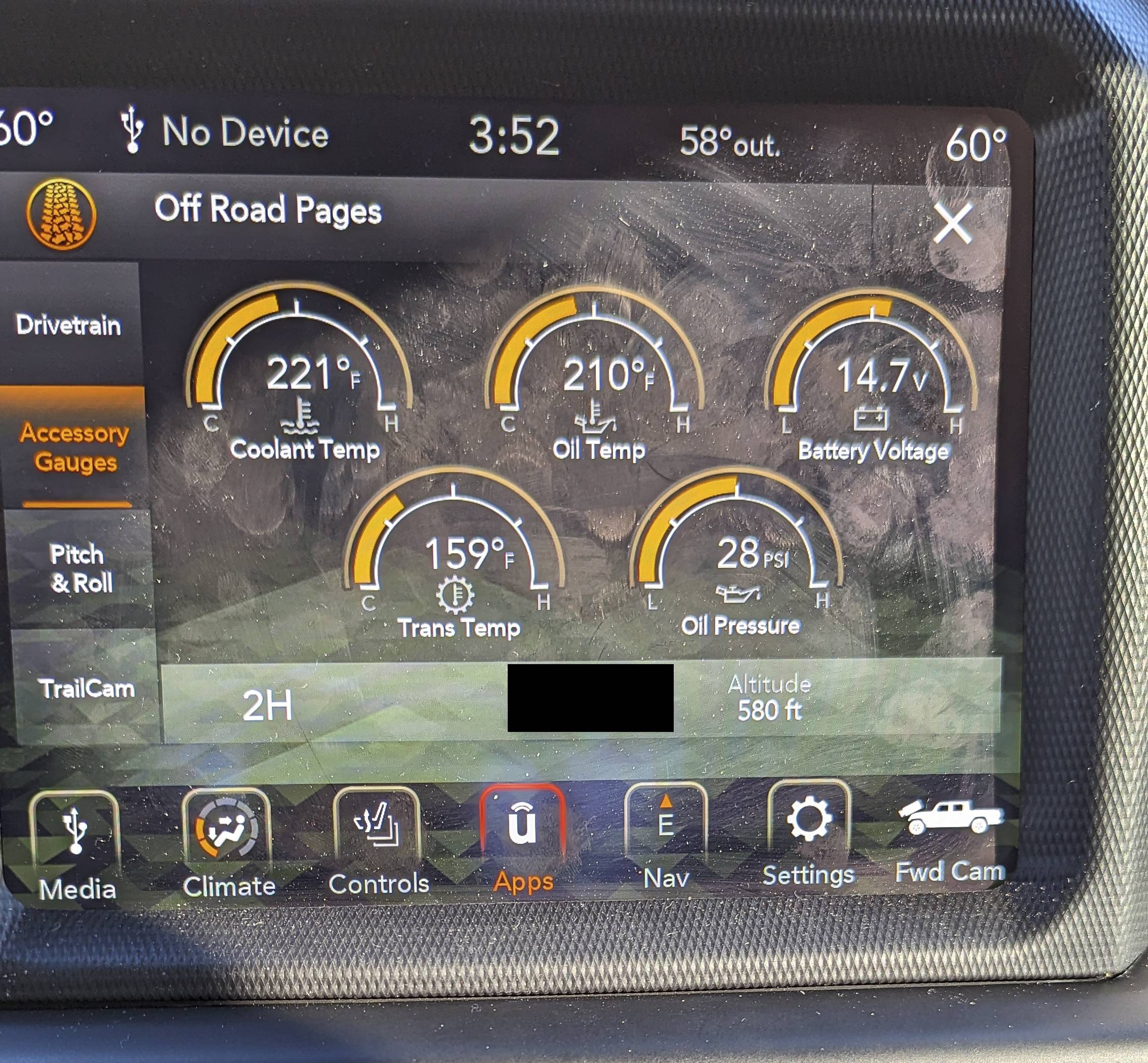

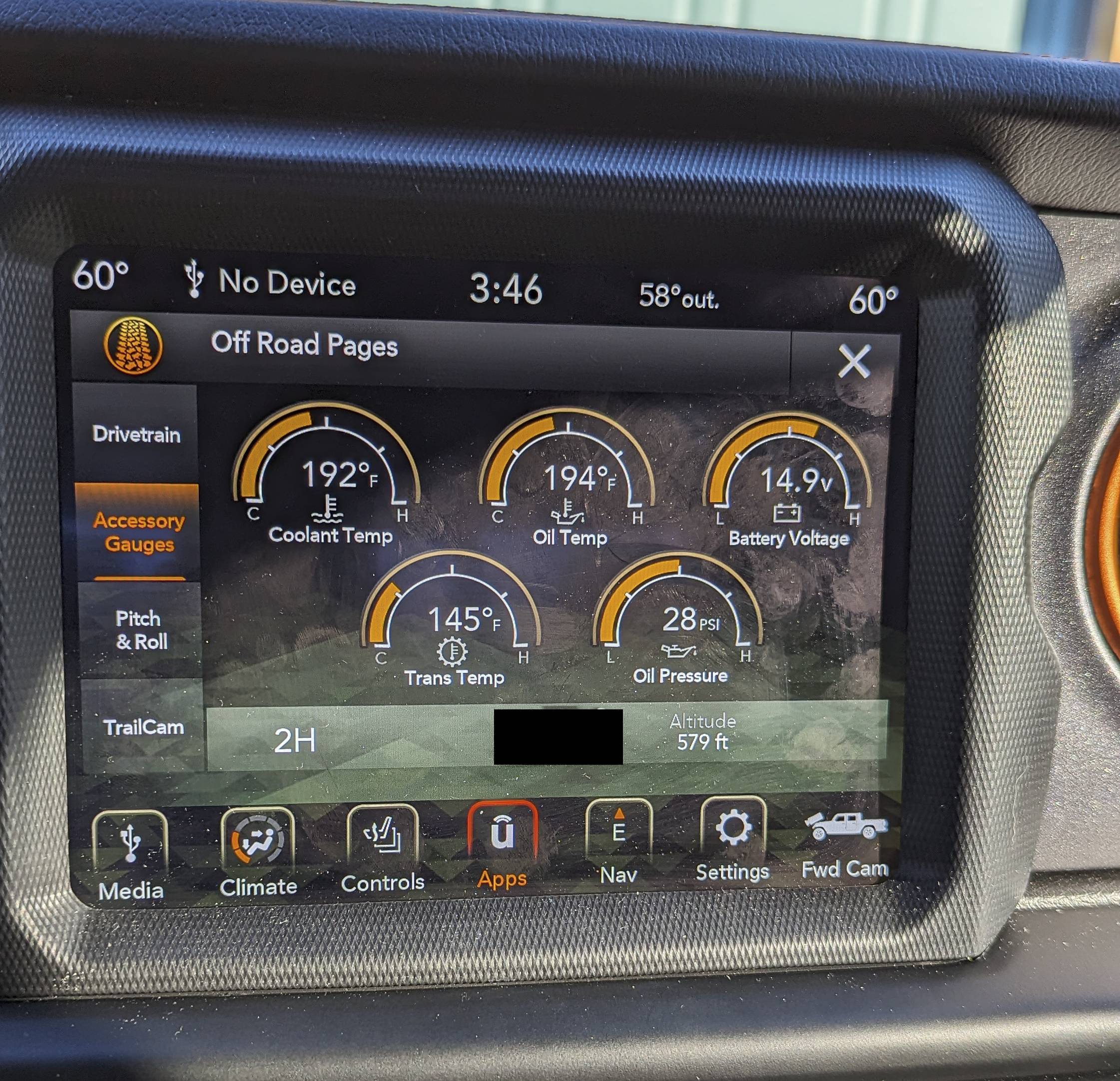

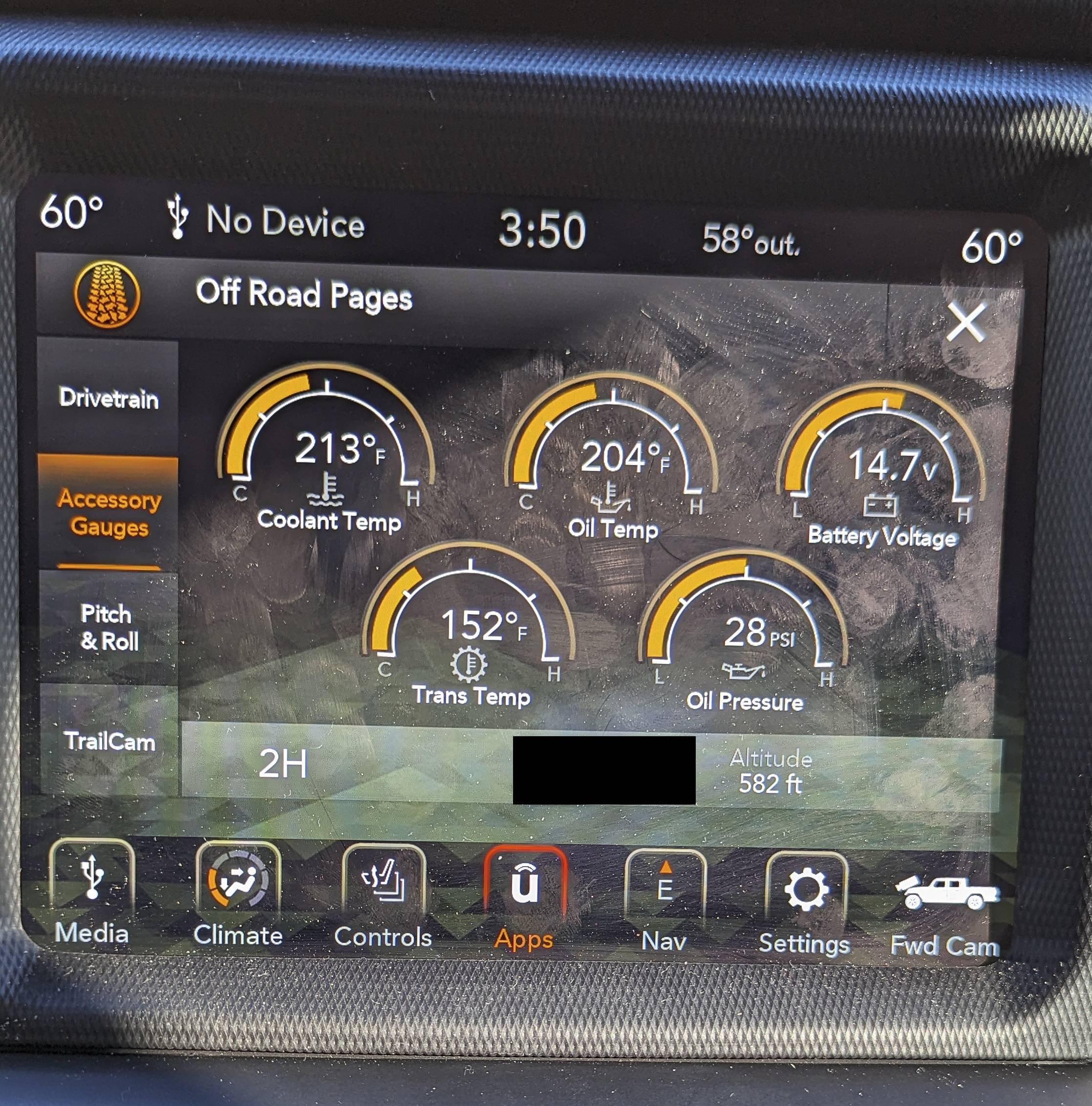

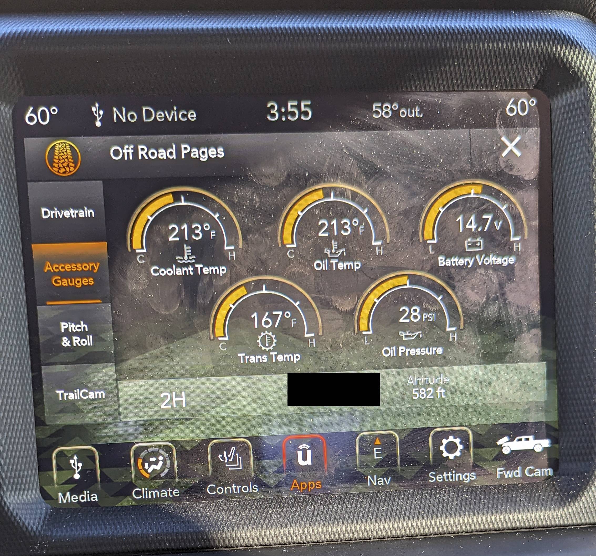

Finally got out today and did the temp challenge.
Fully warmed up after 20 minutes of mixed town and country and freshly parked (it had just flipped 3:46
Jeep Gladiator 3.6 Pentastar coolant temp 222 degrees at idle PXL_20240215_204546966
4-5 minutes at idle
Jeep Gladiator 3.6 Pentastar coolant temp 222 degrees at idle PXL_20240215_204955825
It jumped up there pretty good at about 7 minutes
Jeep Gladiator 3.6 Pentastar coolant temp 222 degrees at idle PXL_20240215_205221959
10 minutes
4-5 minutes at idle
10 minutes
Now do it with 50° higher ambient. I should be able to do it here soon seeing as our spring only lasts 2 days. Last year we hit 98 on 02/22 (not gonna happen this year) and 101 03/12.

Holy smokes 72 amps!
Just looked up that part number. Looks to be what is factory installed for the EcoDiesel and the Wrangler 4XE models.

Yap
Put it fits my 2020 3.6 and moves a lot of air
Both kick out a lot of heat (diesel/4xe). Don't expect the 2.0 turbo to be used with 4xe in the JT - too much heat for the tow ratings.
