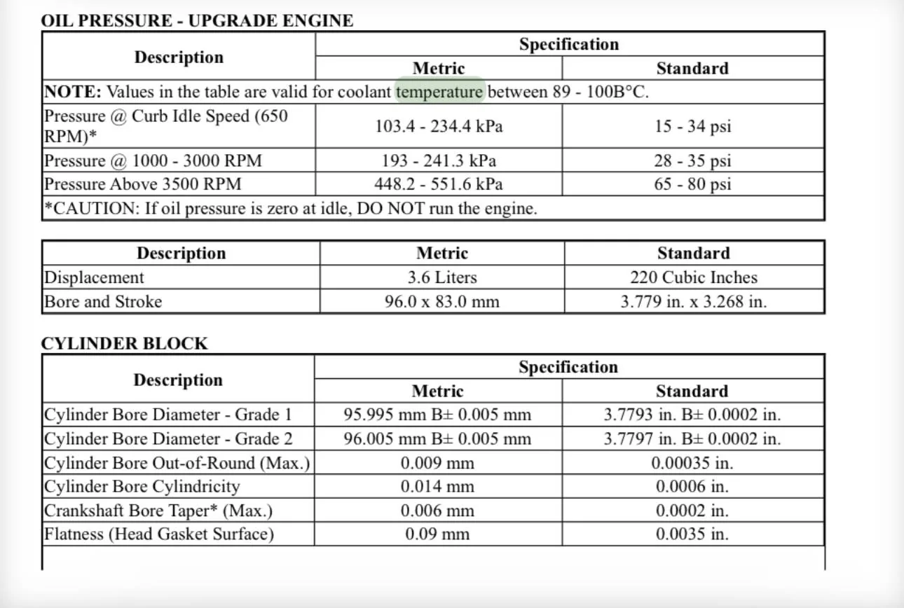

So the service manual lists engine oil pressures at certain RPM’s with a note: “values in this table are valid for coolant temperature between 89-100B°C (192-212°F)”. I wonder why they specify that temp range. One wonders why they didn’t list the values up to 230° if the engines are indeed designed to run that warm. Right?
Jeep Gladiator 3.6 Pentastar coolant temp 222 degrees at idle IMG_2303
(im not sure what that B means. Might be a format/translate issue with the text or something that someone way smarter than me is educated on)
Considering that 100 degree Celsius is the boiling point of water at sea level atmospheric pressure, I would assume the "B" means Boiling.?‍♂
Wrong.
Stop wondering - you want it all the way up to 250 degrees? For all oil brands and types?
They have no need as long as your pressures are within that range at the temperatures specified.
You may have slightly lower pressures, but why take the thing out to the Nth degree?
A lot of what happens outside of that range will depend a bit on the exact oil you use.
Looks like people are trying to find reasons to find fault with temps in the 220s - and yet, it's been normal for as long as I've been a mechanic.
Yes, B is boiling at sea level with no antifreeze involved.
The coolant increases the boiling point by itself, then the pressure on the system increases the boiling point to somewhere in the 260 range.
As long as you have a proper pressure cap and the system holds pressure and your coolant mix is correct, it's not going to boil below 250.
Those tables aren't absolute, they are giving guidelines, this is where it would be at these temperatures.
I've had mine running over 225 degrees and my oil pressure stayed at 27 or above.
Just seems like people are looking for a reason to not believe something, digging hard.

Wrong.
That’s a pretty strong answer for anyone not in in the engineering/development loop of the engine. What other parts of the manual were you involved in writing aside from this one?
No I don’t want it to cover every degree the engine will see, just the normal operating range. There has to be a reason for them to specify a certain range. I doubt it was a “let’s spin the wheel and whatever 2 numbers we get is what we’ll set the upper and lower limits of this guideline at”.
Call it experience.
People also get all worried about oil pressure.
one reason to not take it out more is people will get all bent out of shape over oil pressure numbers they don't like.
They could take that chart out farther, but to what end?
That chart is a guide for troubleshooting - you should see these numbers under these conditions. It's not stating that anything over 100 degrees is abnormal. It's a chart where they are using numbers very easily to obtain in a shop.
Look at the wide ranges of RPMs and the wide ranges of pressures - it's a go-no go chart more than anything. It's not speaking to normal temps, it's speaking to oil pressures you should see under xx conditions.
If it meets what you see there, why worry about the other ends?
It's not saying over 100 is too hot, it's saying these are the pressures you should see under these conditions.
Read it as an oil pressure guide, not an engine temperature guide.
Look at the other parts of that chart - do YOU as a driver care about the finish on the cylinder walls or head trueness?
Don't read into it what isn't intended.
