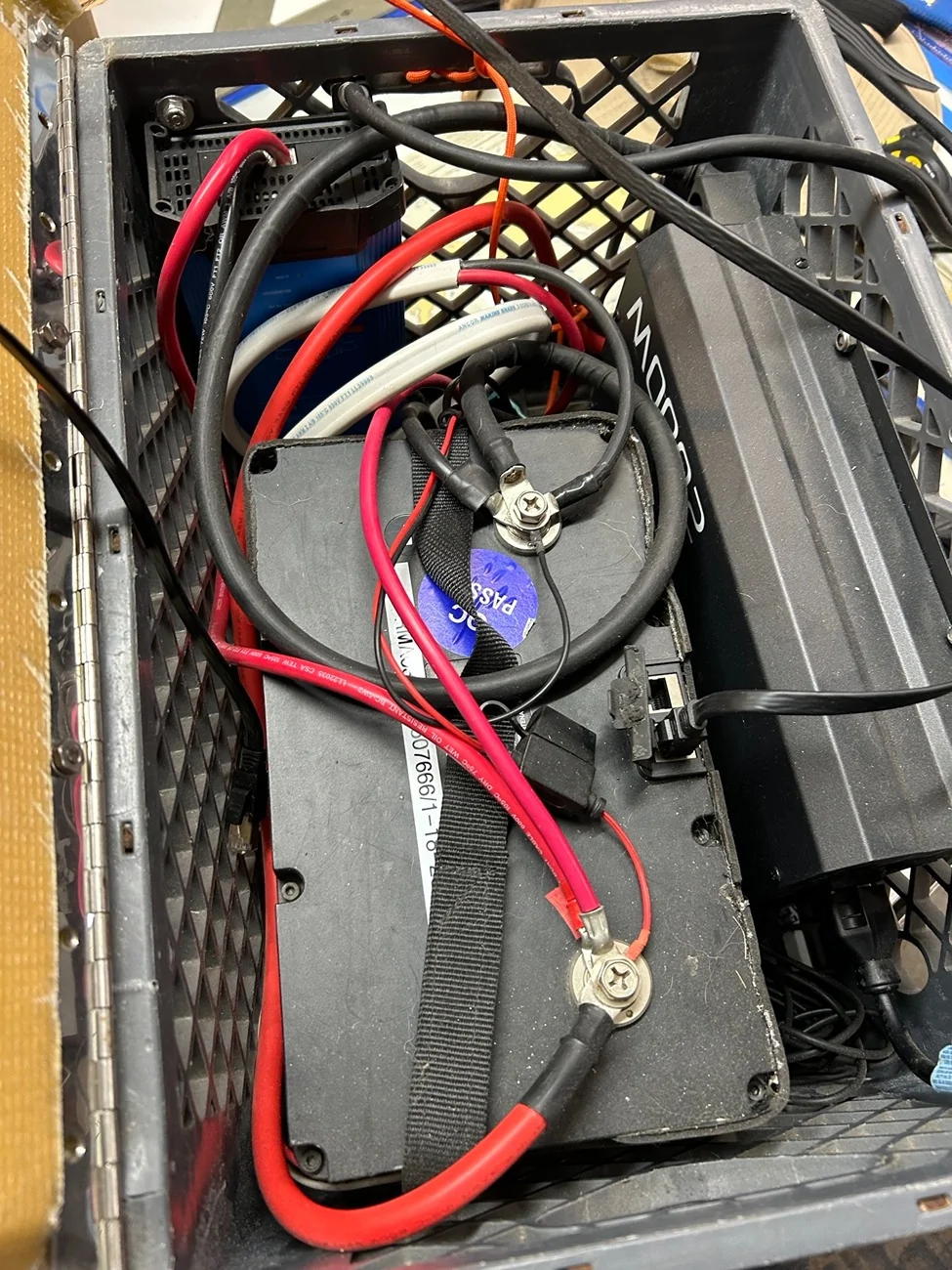

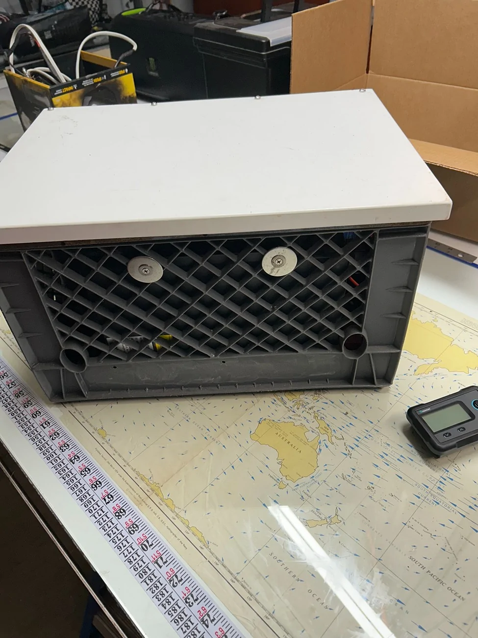

I use a 100amp lithium battery, 30amp ac charger, 2000w inverter in this milk crate for portable power. I have an extra 100 amp battery to bring along if needed. This keeps it portable for boat and camping. I charge with Honda generator and folding solar panels depending on application. yes the wiring is a mess but works great! I even have a small fan for cooling when charging and remote monitor.
I love this setup and think I might just copy it. Great idea.

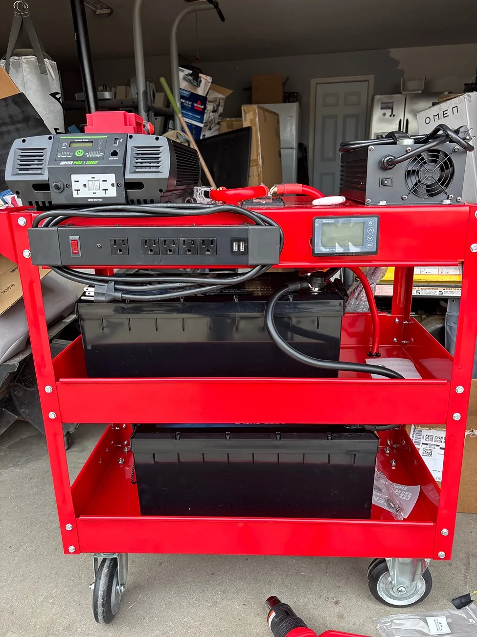

Well since the Gladiator is a truck…….. 600Ah 12v with 3k output. Ac-DC charger with a 10 gauge extension cord to charge once power comes back. And it’s even portable!!!! Kinda. Good luck lifting it into the bed without a forklift.
