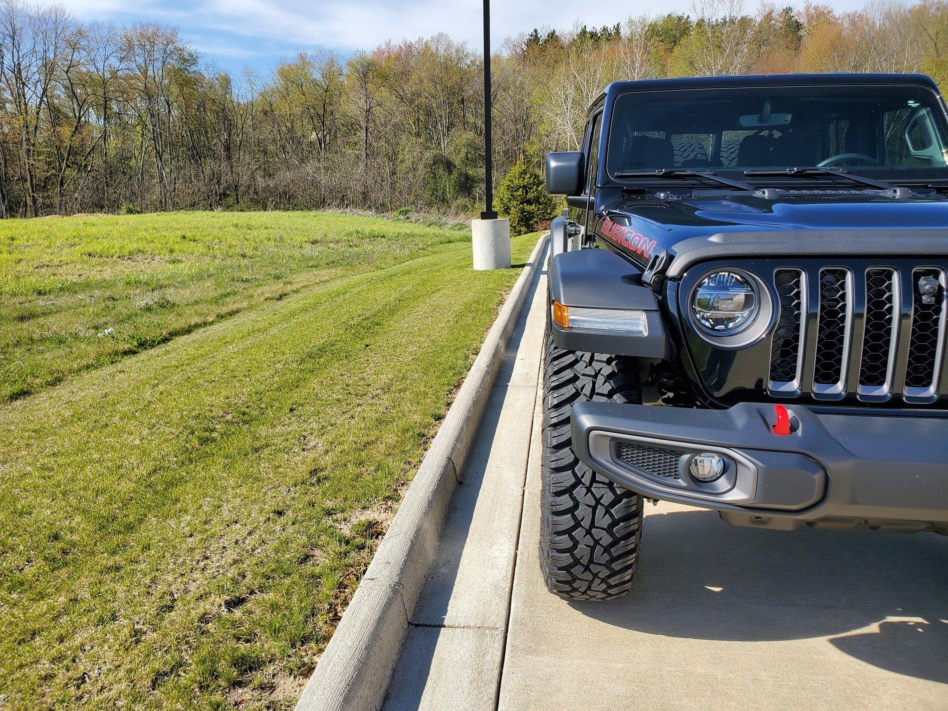

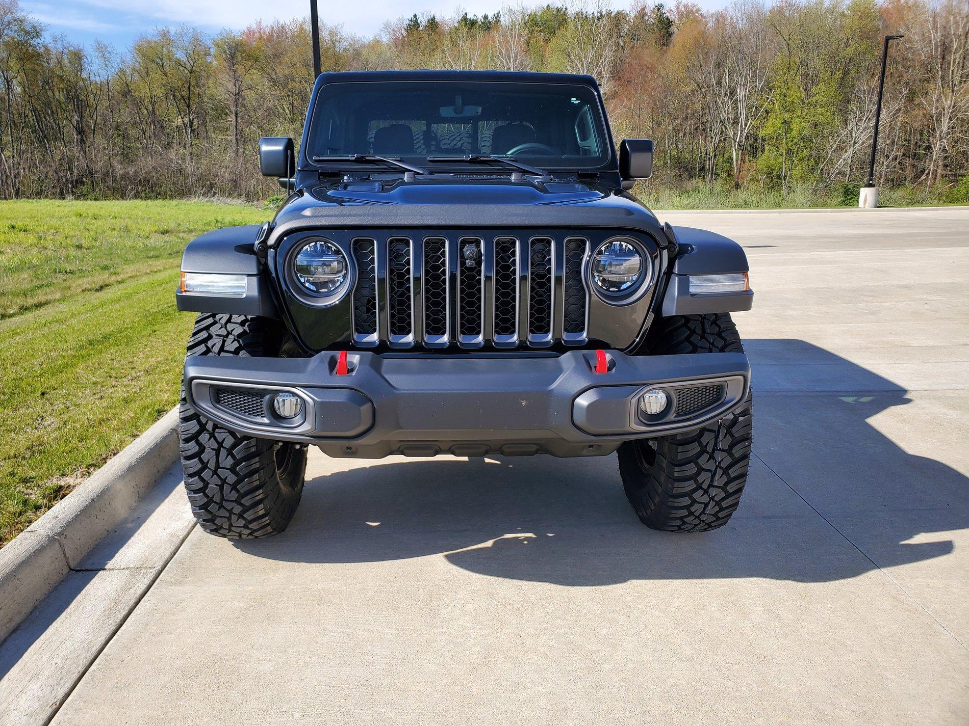

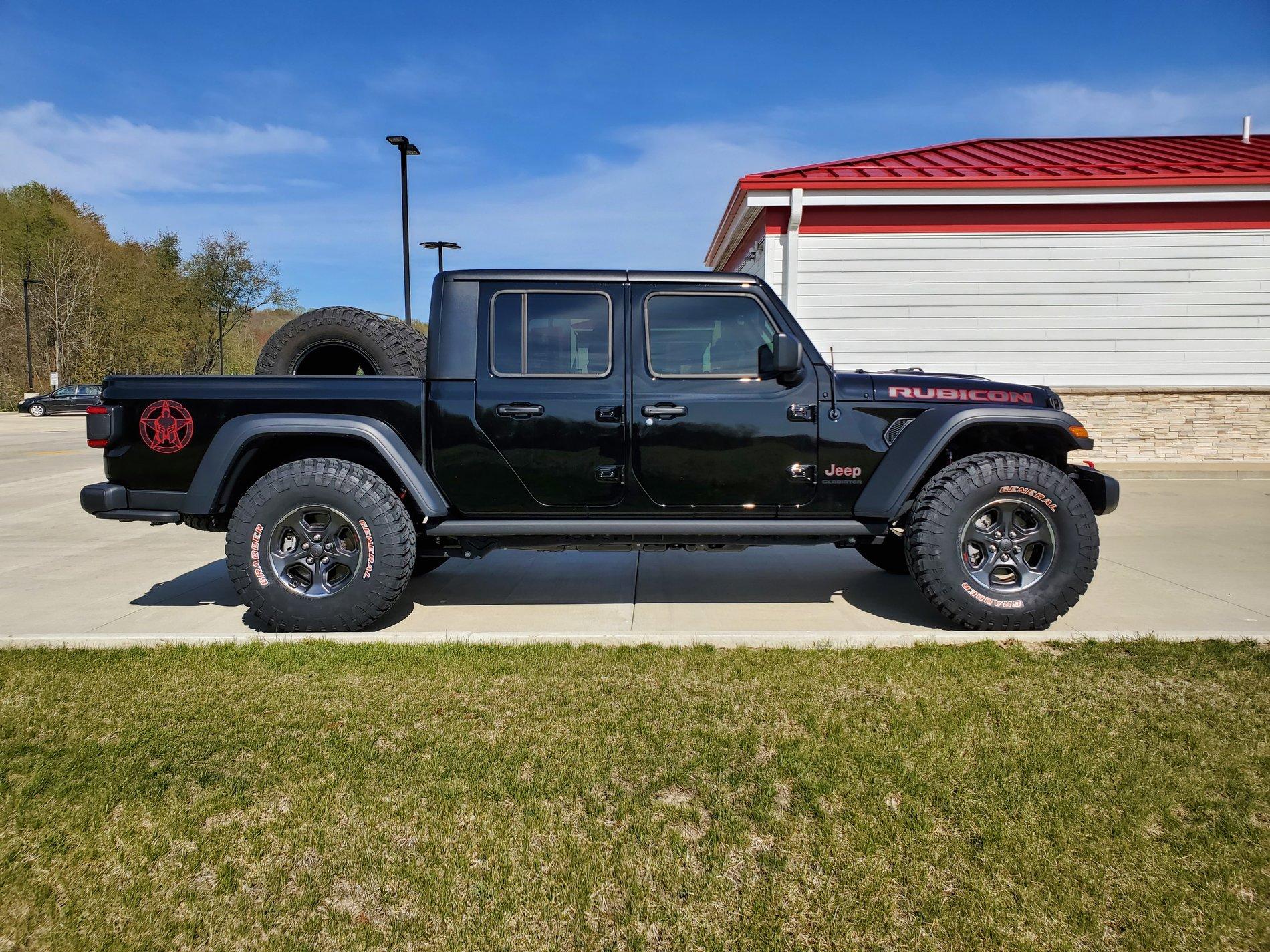

Here's mine. Stock suspension and tires with the stock Rubicon/higher fenders. Hope this helps.
have you corrected with wheel spacers to accommodate the 37s on stock wheel?
I did not add spacers. I had the plastic Rubicon bumpers and had no rubbing at full turn.
Here is a shot down the truck...
Jeep Gladiator 33" vs 37" tire performaces 20200506_165048
Jeep Gladiator 33" vs 37" tire performaces 20200506_165041

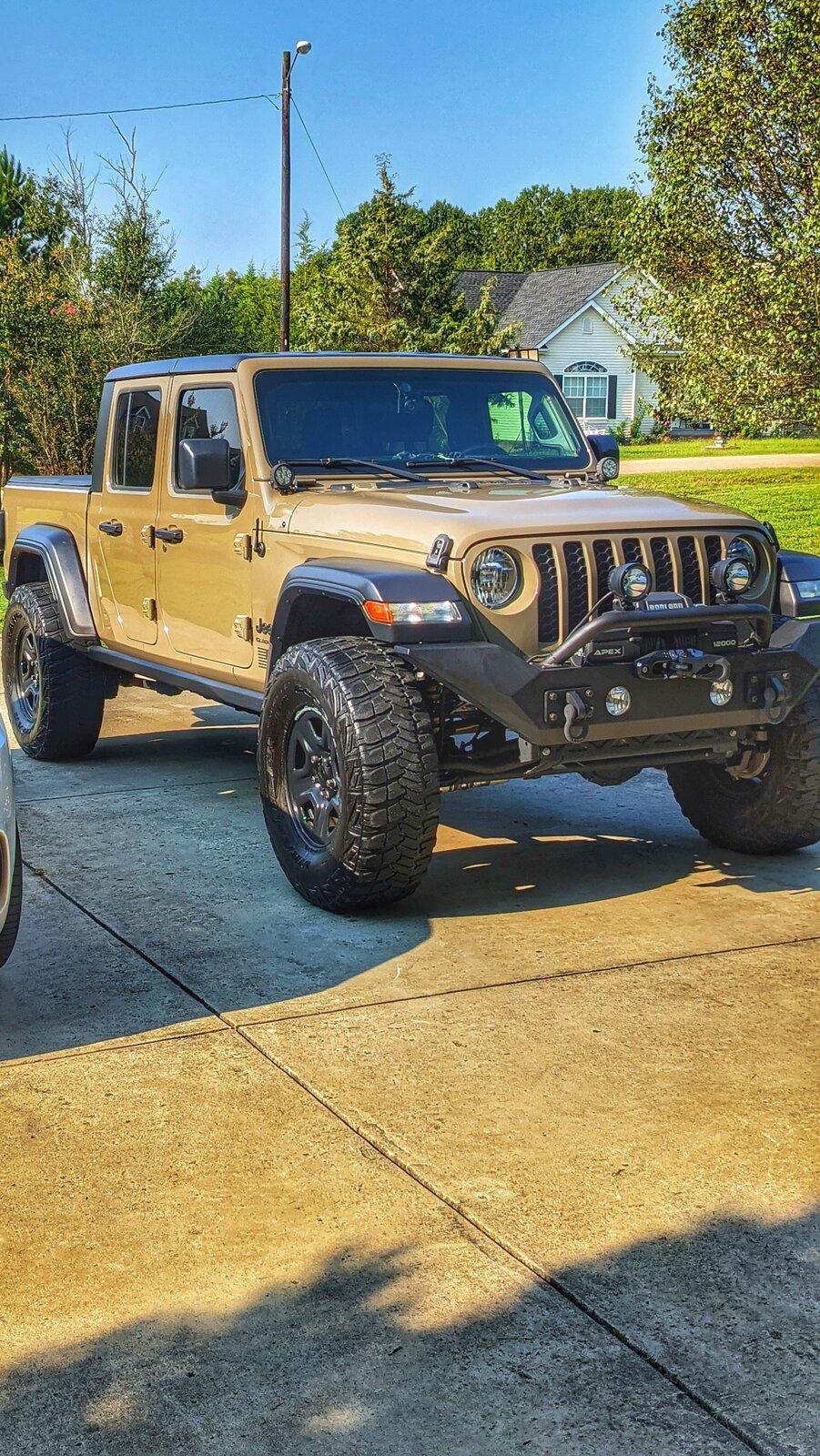

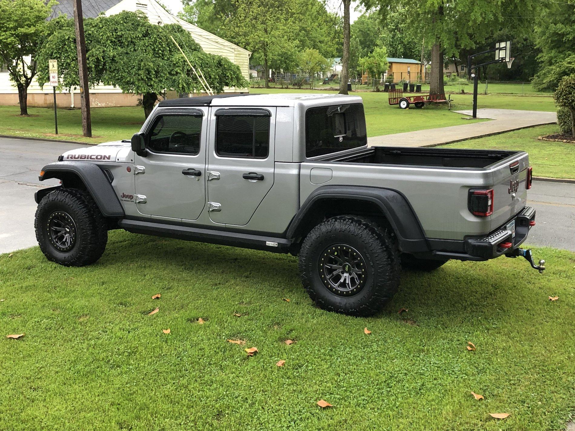

Also here are some pictures comparing the 35's to the 37's. I'm real happy with how it performs on the 37's and have seen no need to regear. I towed about 5,000 lbs of rock and trailer combo with it and it did great.
35's
Jeep Gladiator 33" vs 37" tire performaces PXL_20201219_123525410
37's
Jeep Gladiator 33" vs 37" tire performaces PXL_20210825_134024483.PORTRAIT-01
