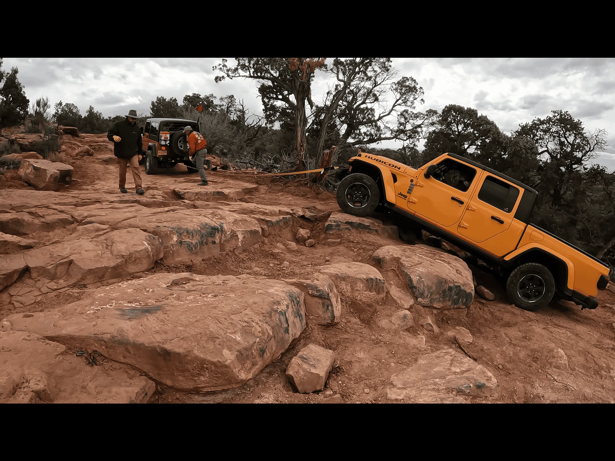

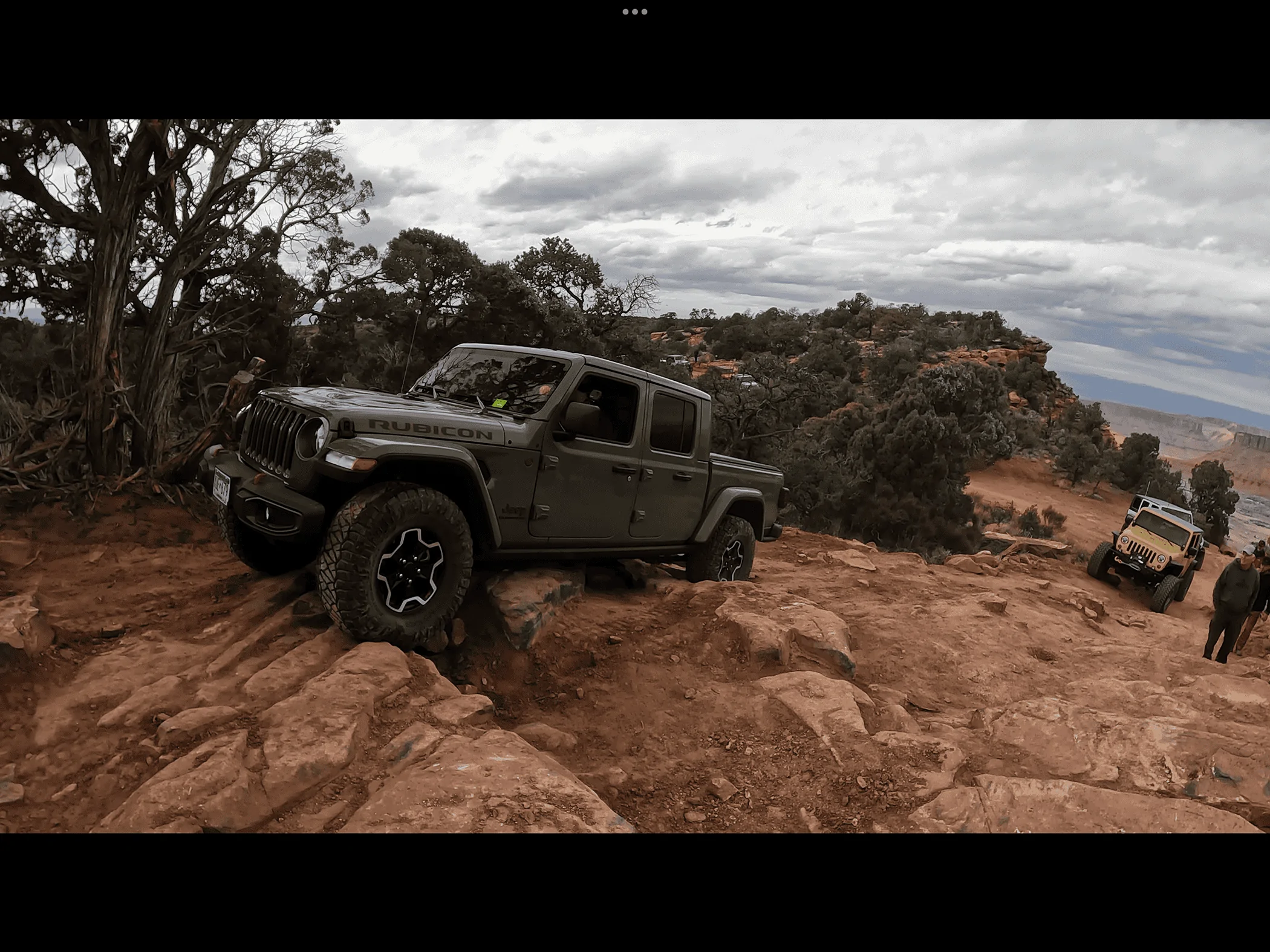

IDK how true this is in your case, but these are two major factors I encountered when choosing my tires For the ‘24 Easter Jeep Safari:
- My insurance guy is a Jeeper, and he informed me that putting 37s on my stock rims would be enough to void any warranty claims if the adjuster noticed. He strongly encouraged me to either get 35s, or do the thousands-worth of other mods necessary for 37s… so, I went with 35s.
- In choosing 35s, I was informed that “only Nitto Ridge Grapplers are warrantied for ‘said’ rim size,” so if there was any manufacturer defect, I’d either want Ridge Grapplers or a different wheel. (I should note that, at the time of purchase, the Ridge Grappler had been discontinued, and he didn’t yet have specs, in this regard, on the newer version: Recon Grapplers.)
As for the weight and stiffness… I don’t notice, but my mpgs dropped from around 18 to around 16 for daily driving (at 45psi). The one thing I did notice right away is that the 35s DO rub when I turn the wheel a seemingly-natural rotation. I quickly adjusted to make wider turns, so I don’t notice that any more unless I let someone else drive, but I’d imagine you would need to make even wider turns with 37s and no other mods.
As for the performance off-road… I’m in an “otherwise-stock” JT Rubicon, and I was fortunate enough to be the very-front vehicle (behind the Leader) for Porcupine Rim Trail all the way up until the lunch break. We had several prolonged rests before then, and then - right before lunch - the Leader walked up to me and asked if it’s okay to let another vehicle in front of us. I agreed, and after lunch I quickly figured out why they did that. It was a bone-stock JT Rubicon that couldn’t traverse the ledges without a tow strap (See ‘Yellow’ pic). It really made me value my purchase, as I had a little belly rub but never even worried about getting stuck.
So… IMO… go with 35s unless you’re definitely needing 37s and are ready to invest; but, what do I know, really? I’m just a newbie recycling info here.
