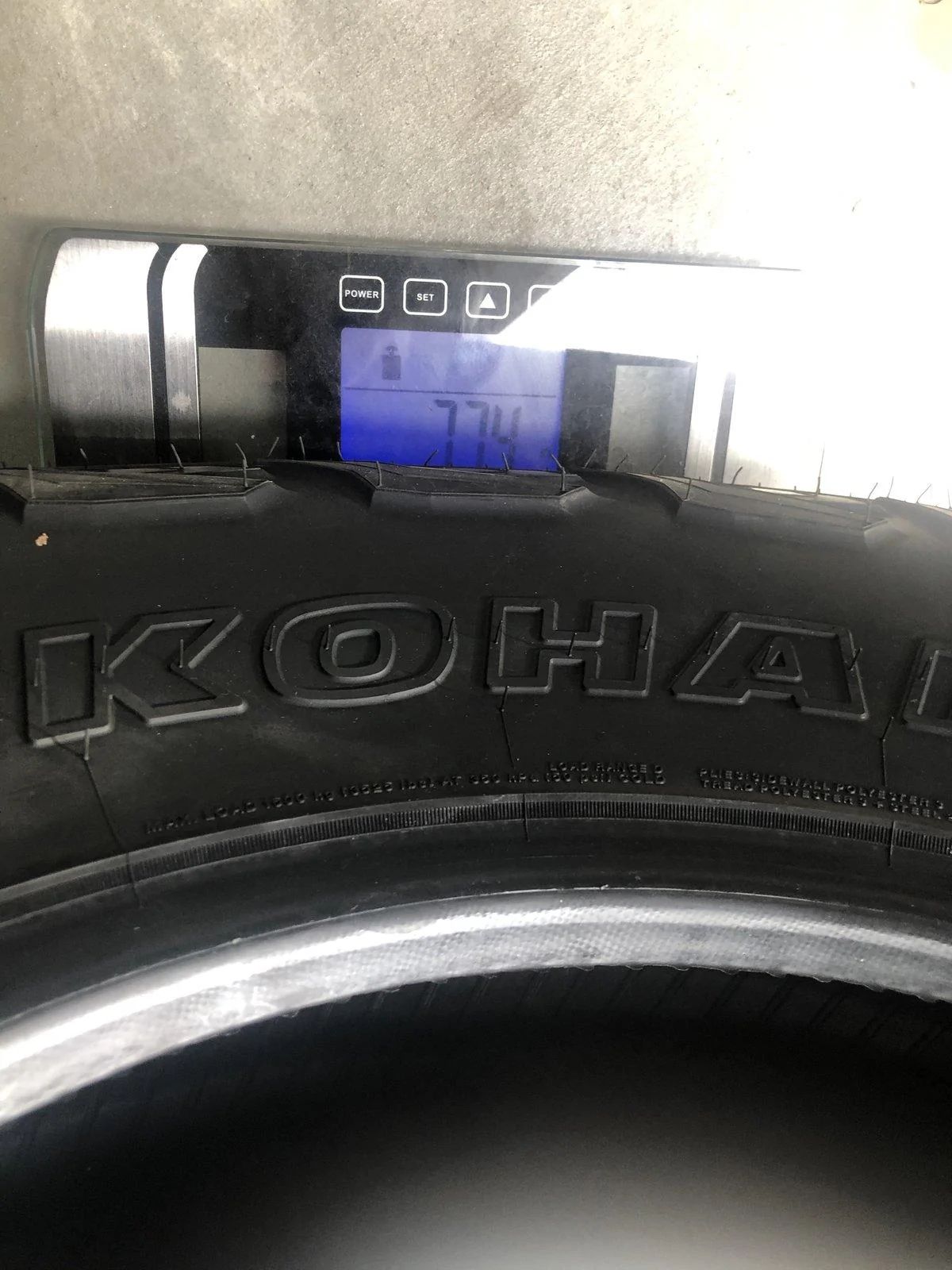

Would appreciate a photo of this, as I believe this would be a unicorn set of 37” KO2’s(if ever found)…… ??
Add milestar Patagonia XT’s 37x12.5r17 76#’s and I threw one on a scale they ranged between 76-78#’s across 5 tires. Balancing weight took 2-2.5 ounces each.
Measured height on an 8.5 is 36-5/8’s 35psi
Here you go:
Jeep Gladiator 37 inch Tire Weight (by brand) Screenshot_20231223-213937~2
But you are correct, these tires measured 35.5" (loaded and at 30psi) mounted on 17x8.5" wheels
