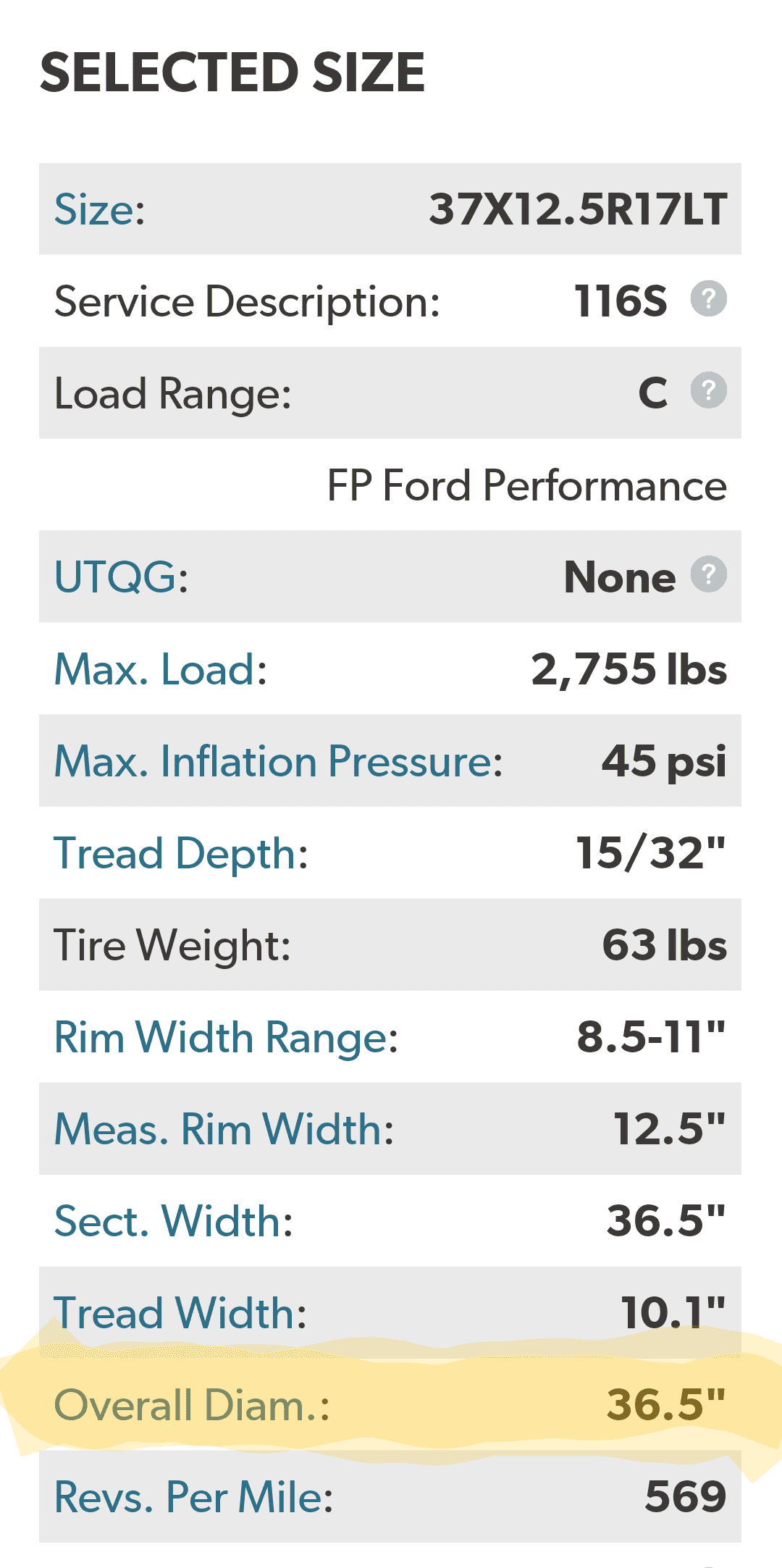

Here you go:
Jeep Gladiator 37 inch Tire Weight (by brand) Screenshot_20231223-213937~2
But you are correct, these tires measured 35.5" (loaded and at 30psi) mounted on 17x8.5" wheels
