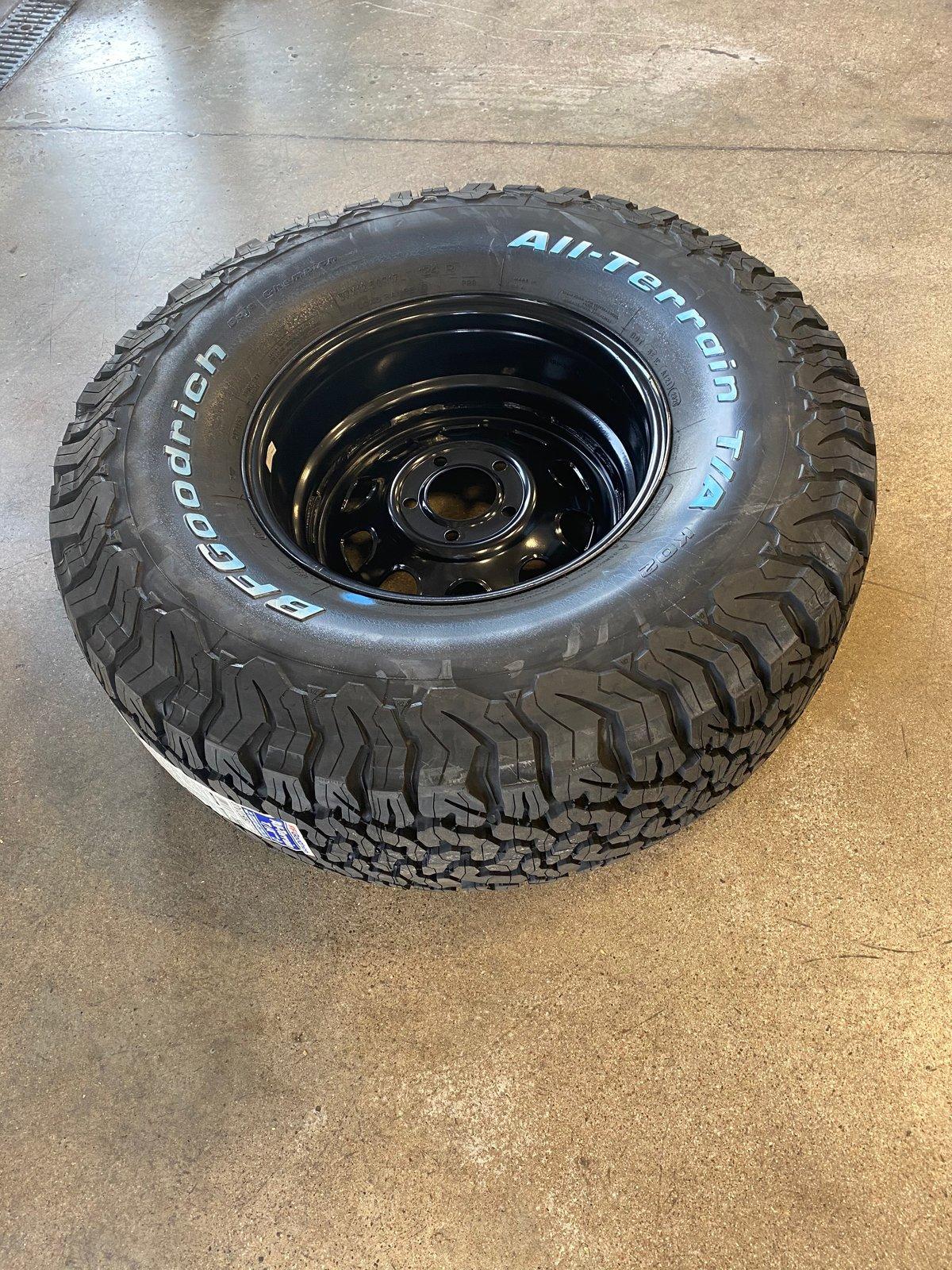

Big thanks :handsinair: to Joel Nunez, Store Manager at @Discount Tire in Mesa, AZ, for all his help with my spare tire program :like: I needed a spare tire/wheel that I could use rather than the factory spare that was nothing more than dead weight underneath the Gladiator.
Joel helped my by getting me a cost effective steel wheel that has the same bolt pattern and similar backspacing to my Fuel Zephyr wheels. And we went through the list of tires from this thread and I selected the 37x12.50R17 BFG All Terrain T/A KO2 tire which his team installed on the black steelie wheel.
I went to @Discount Tire and Joel and his team lowered my Falken Wildpeak factory spare, and attached the new spare wheel and tire and cranked it up under the Jeep Gladiator. It fit quite easily - more easily than I thought it would - and I was outta there after paying my bill.
The new spare before being put away. Hopefully this is the most sunlight this virgin tire and wheel will ever see...
Jeep Gladiator 37” spare tire - list of tires that fit under the bed BFG All Terrain T-A tire - 1
