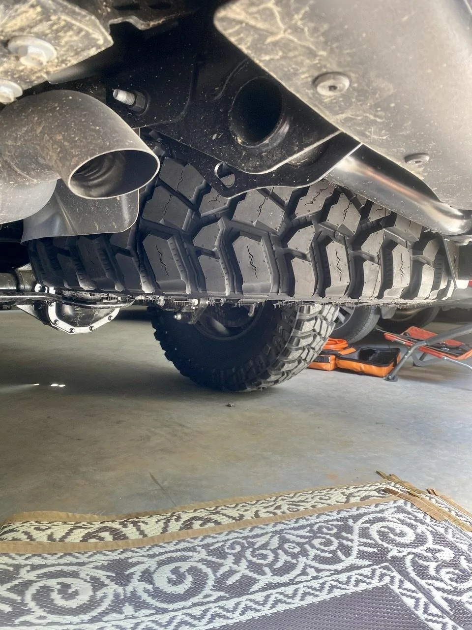

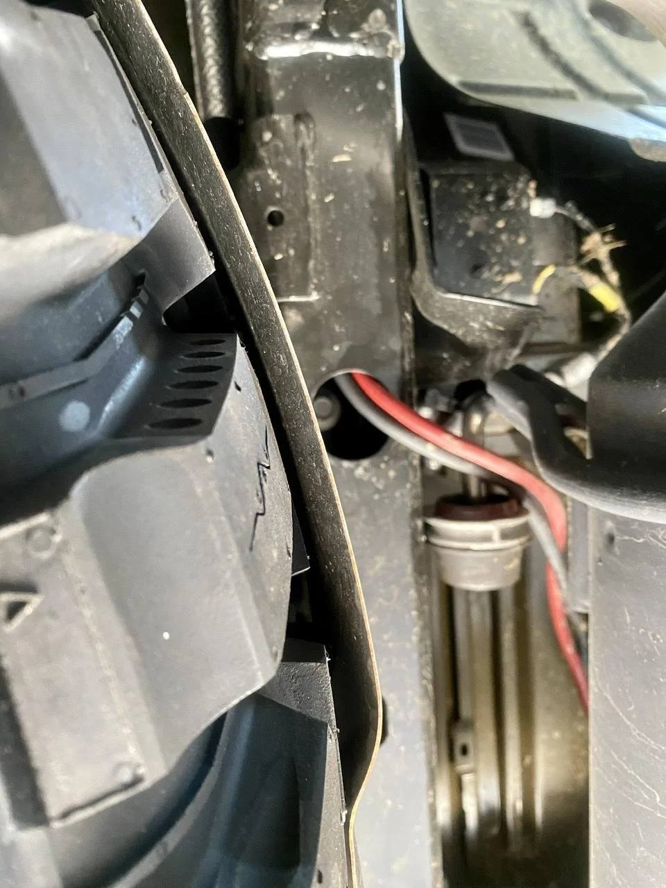

A 37x12.5x17 Cooper STT Pro on factory granite crystal wheel does fit but only at 25psi or less. I plan to rotate 5 so I think it’ll be fine after one rotation, maybe 2. Seems to be on the large side of the 37’s especially on the stock wheels.
Thanks for the photos, seriously thinking abut the STT, you replaced the steelie with a factory wheel correct? I will be replacing mine with a 17x9 so I think I should be good to go as well, or at least I hope anyways.
That’s correct I replaced with a factory wheel and it fit.... barely.
Yeah it looked very snug... I got some time before I get tires, so I will consider this, like the idea of a five tire rotation, but if I just find a 37" used I could save on the cost of one wheel and tire... and use the spare as just that a spare... Options Options, its always something... LOL

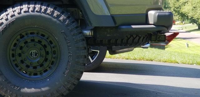

37” Wildpeak MT fits aired down to 18psi on the stock rim
Jeep Gladiator 37” spare tire - list of tires that fit under the bed 2C046558-96D3-4445-819C-43F888D35074
Jeep Gladiator 37” spare tire - list of tires that fit under the bed EC161659-1D9B-44EE-B8A3-D365B5D32315

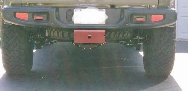

I fit a 37x12.5R17 Milestar Patagonia on the stock steelie under mine. It was tight and I did air it down to about 30 but doesn’t hit anything and works well.
