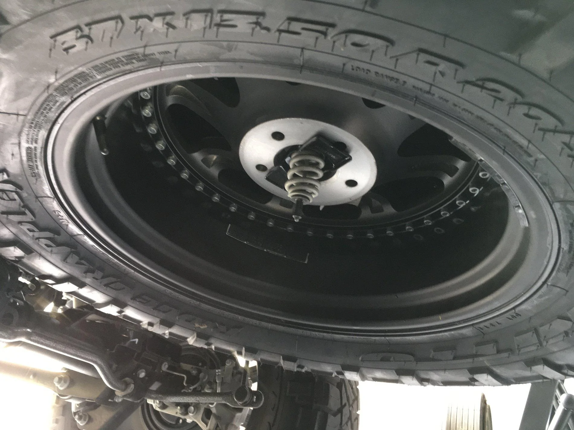

Big thanks :handsinair: to Joel Nunez, Store Manager at @Discount Tire in Mesa, AZ, for all his help with my spare tire program :like: I needed a spare tire/wheel that I could use rather than the factory spare that was nothing more than dead weight underneath the Gladiator.
Joel helped my by getting me a cost effective steel wheel that has the same bolt pattern and similar backspacing to my Fuel Zephyr wheels. And we went through the list of tires from this thread and I selected the 37x12.50R17 BFG All Terrain T/A KO2 tire which his team installed on the black steelie wheel.
I went to @Discount Tire and Joel and his team lowered my Falken Wildpeak factory spare, and attached the new spare wheel and tire and cranked it up under the Jeep Gladiator. It fit quite easily - more easily than I thought it would - and I was outta there after paying my bill.
The new spare before being put away. Hopefully this is the most sunlight this virgin tire and wheel will ever see...

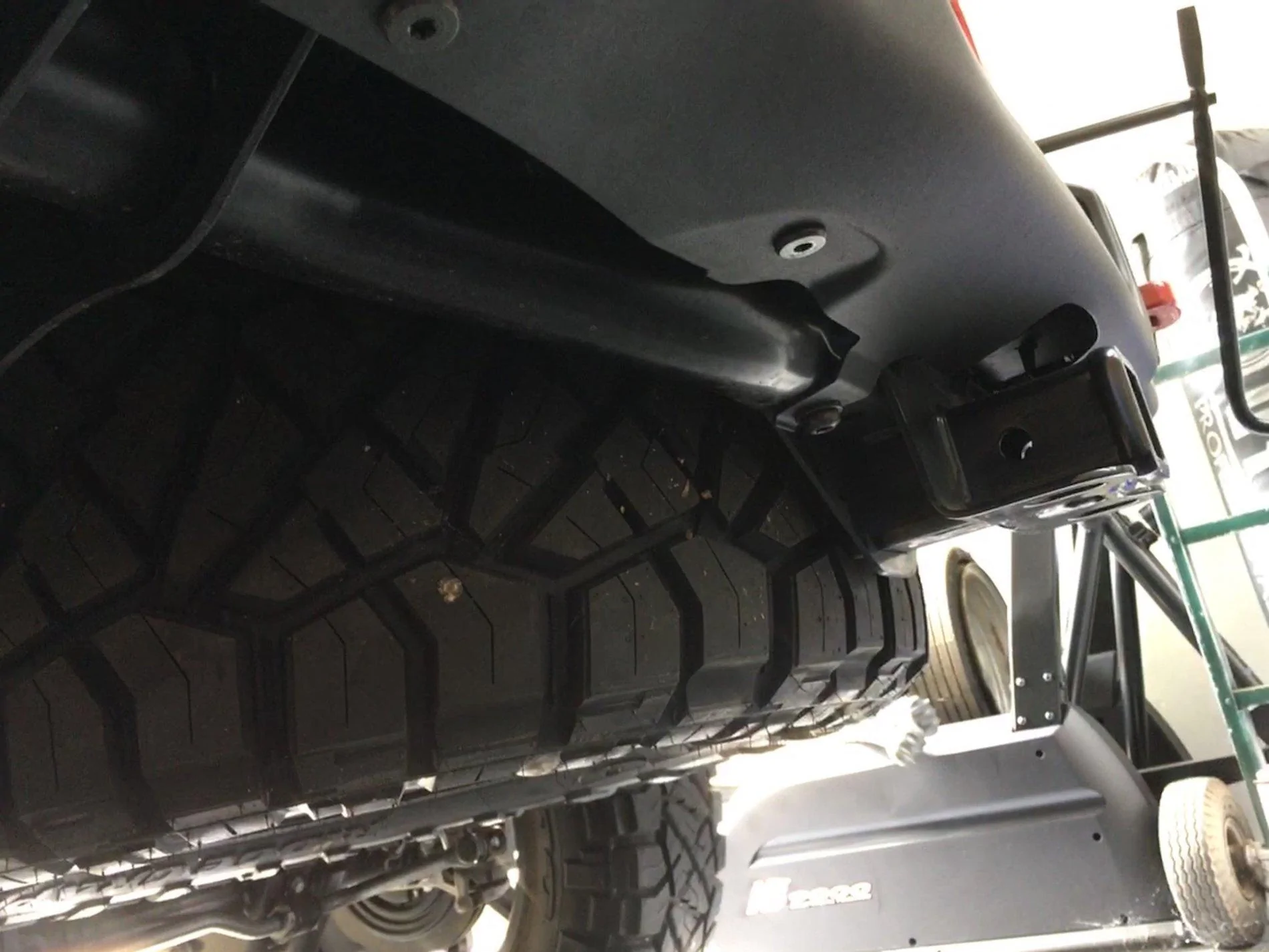

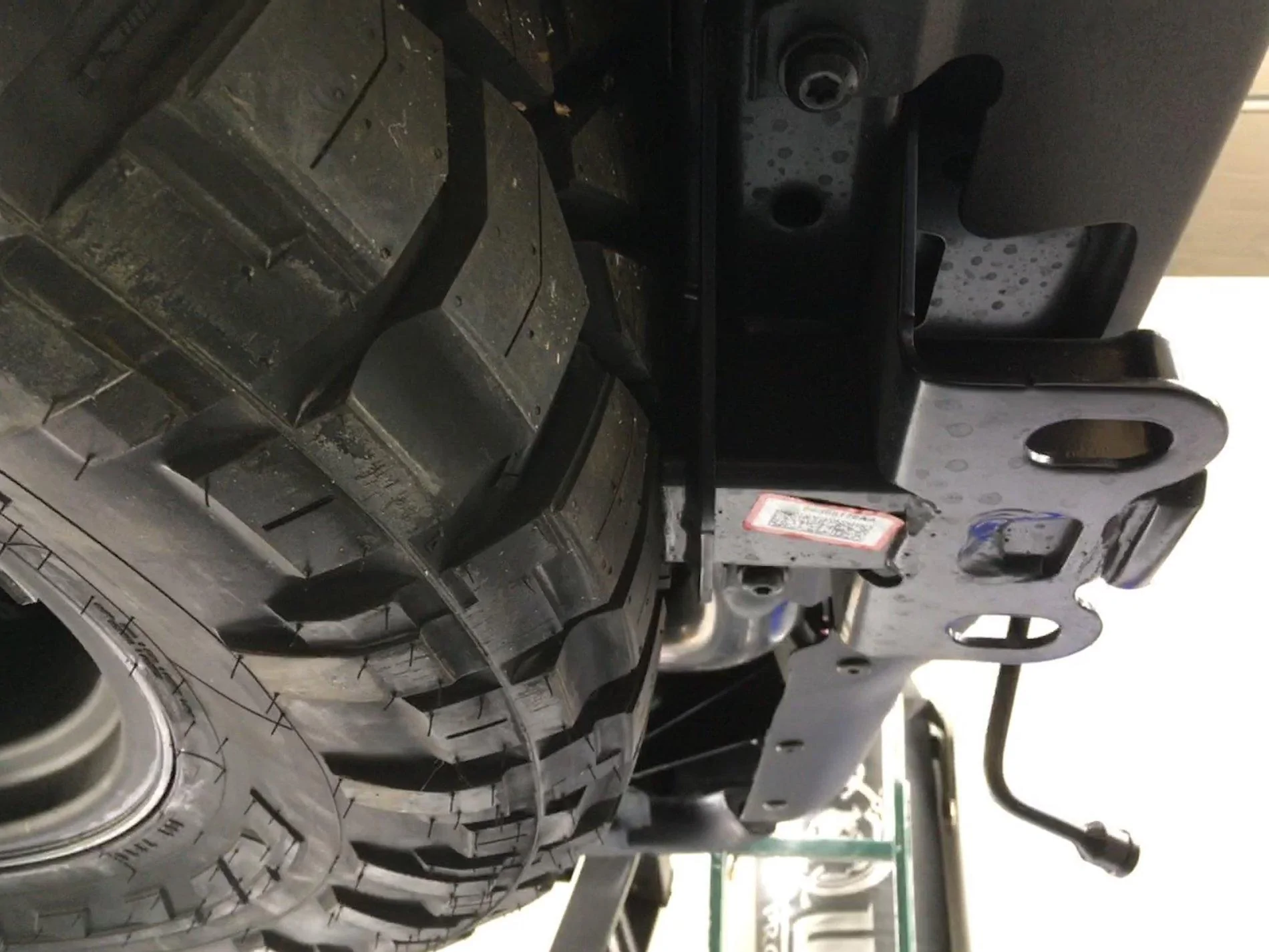

By the way, this is a 37/13.50-20 Nitto Ridge Grappler.
Tight, but fits aired down.

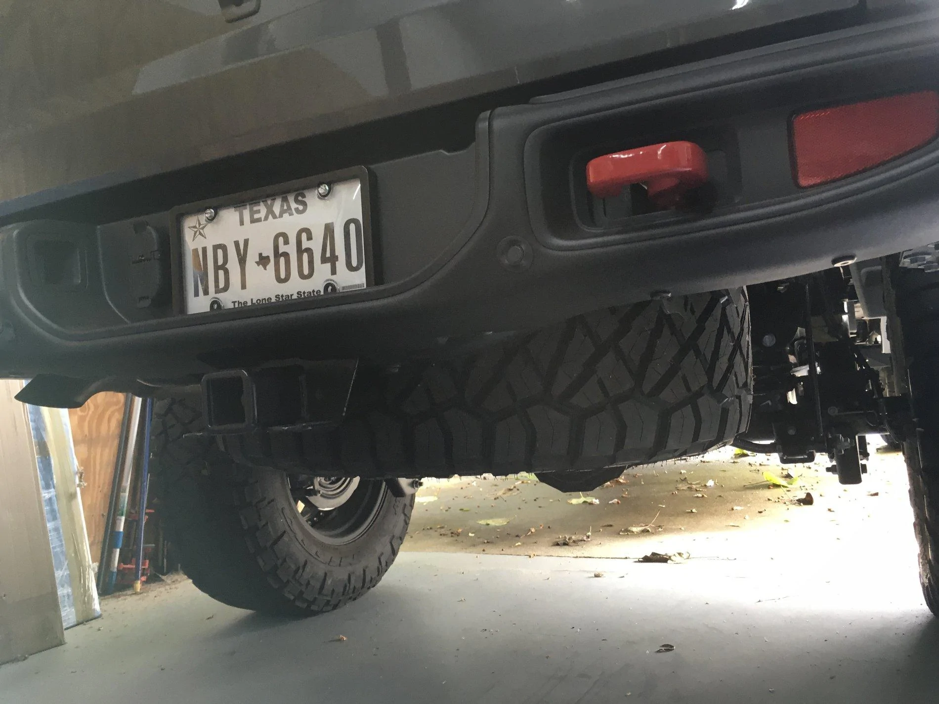

Just to clarify, I'm running 37 x 12.5 x 17 Milestar Patagonia M/T's on my Rubicon, 1 1/2" leveling kit only, bone stock in the rear, no rubbing and still getting 17.5 MPG's @ 75 MPH on the highway!!! And yes the Milestar fits in stock spare location!
What is the measured diameter of the Milestar 37x12.50xR17? Online shows 36.8, but I'm wondering what actual PSI under a jeep would measure?
