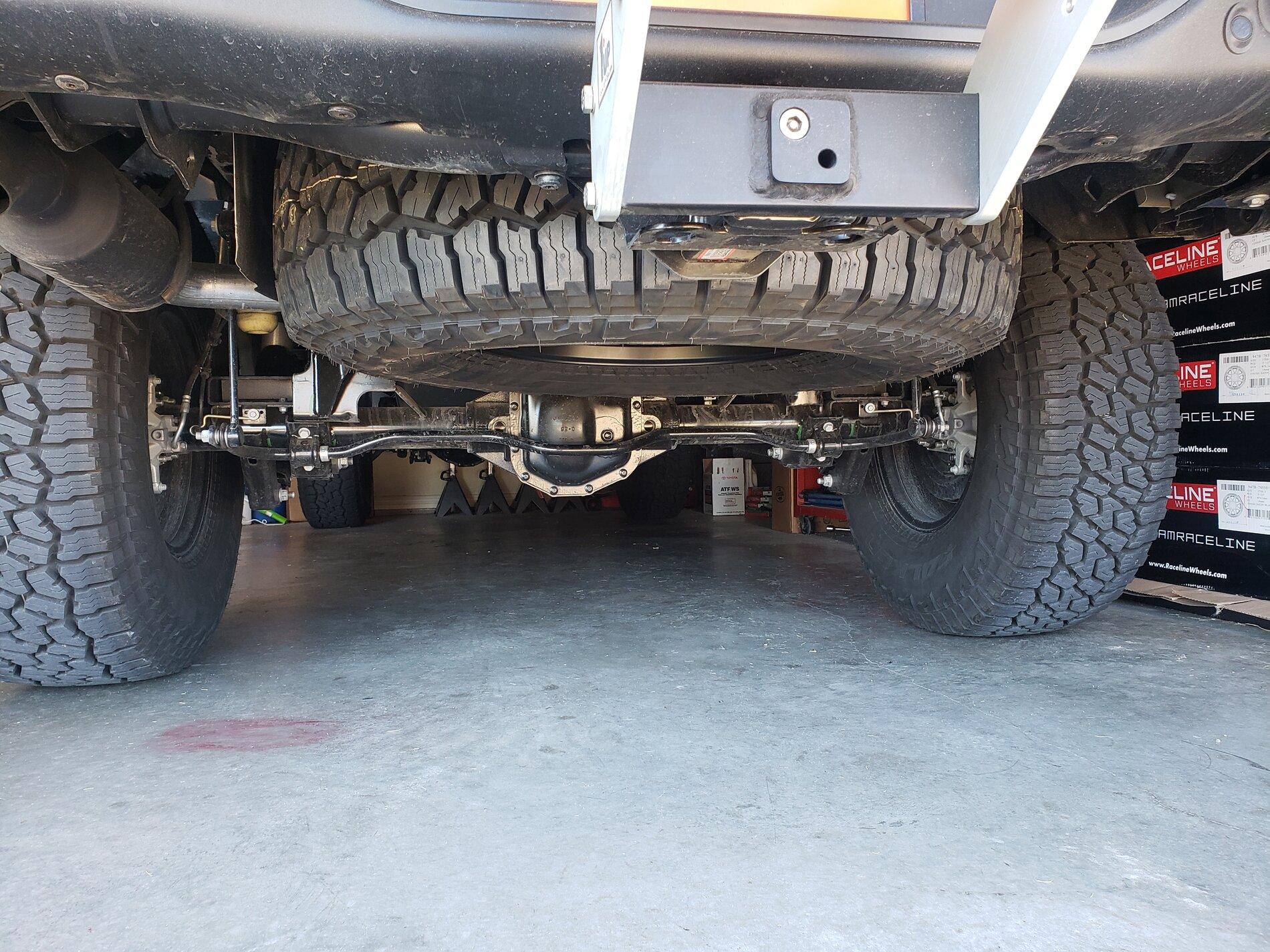

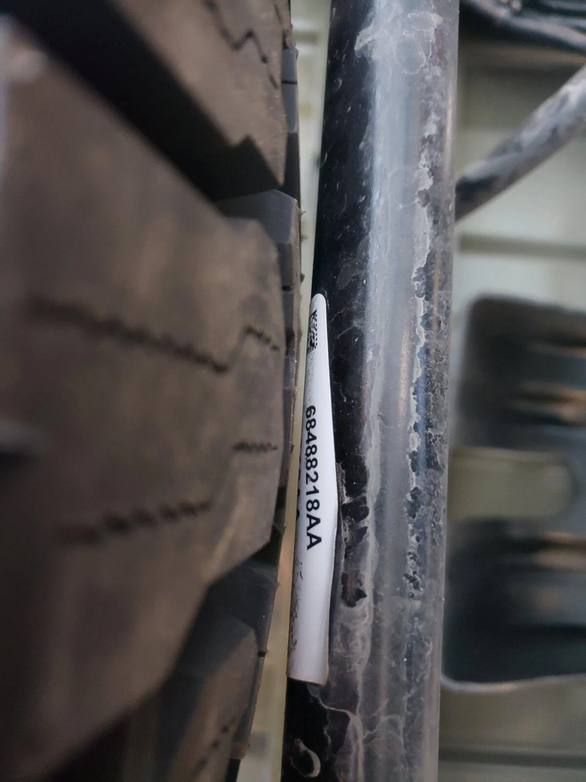

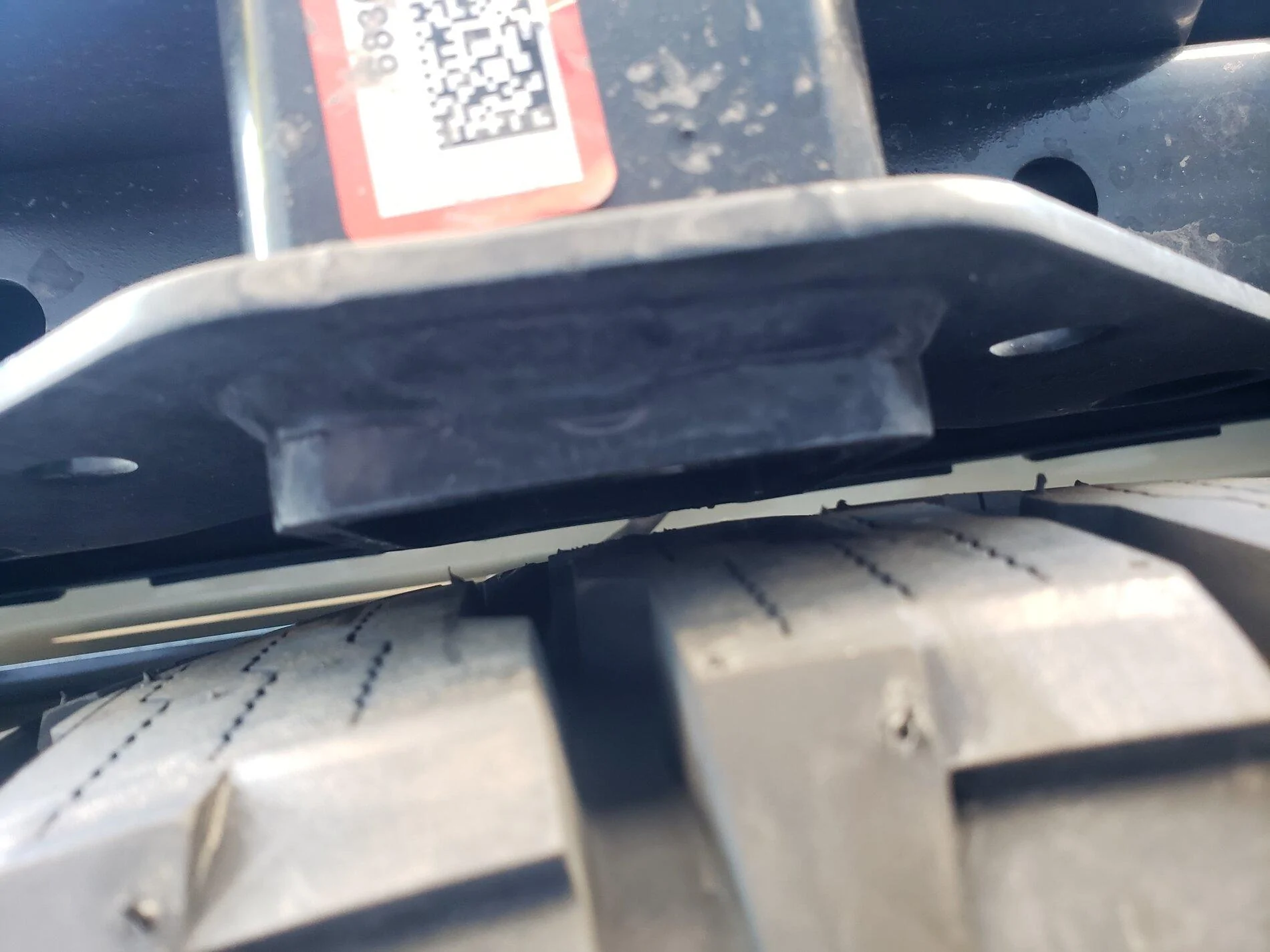

It's tight, but I got the spare up there with 37psi, 37x12.5r17 Falken A/T3W. Wheel is mounted pretty side up. I may let a bit of air out later.
Jeep Gladiator 37” spare tire - list of tires that fit under the bed 20201130_125451
Holy cow man that's close, lol ... I'm jealous, I need to measure but I'm guessing my 37's are 38's but the way it fits
Yea I think Toyo runs higher. I had a set of 255/85/16 on my KJ and they were 33.5

NEXEN TIRE ROADIAN MTX 37X12.5 aired down to 25psi FITS
With Heat shield. It's snug but fits.
