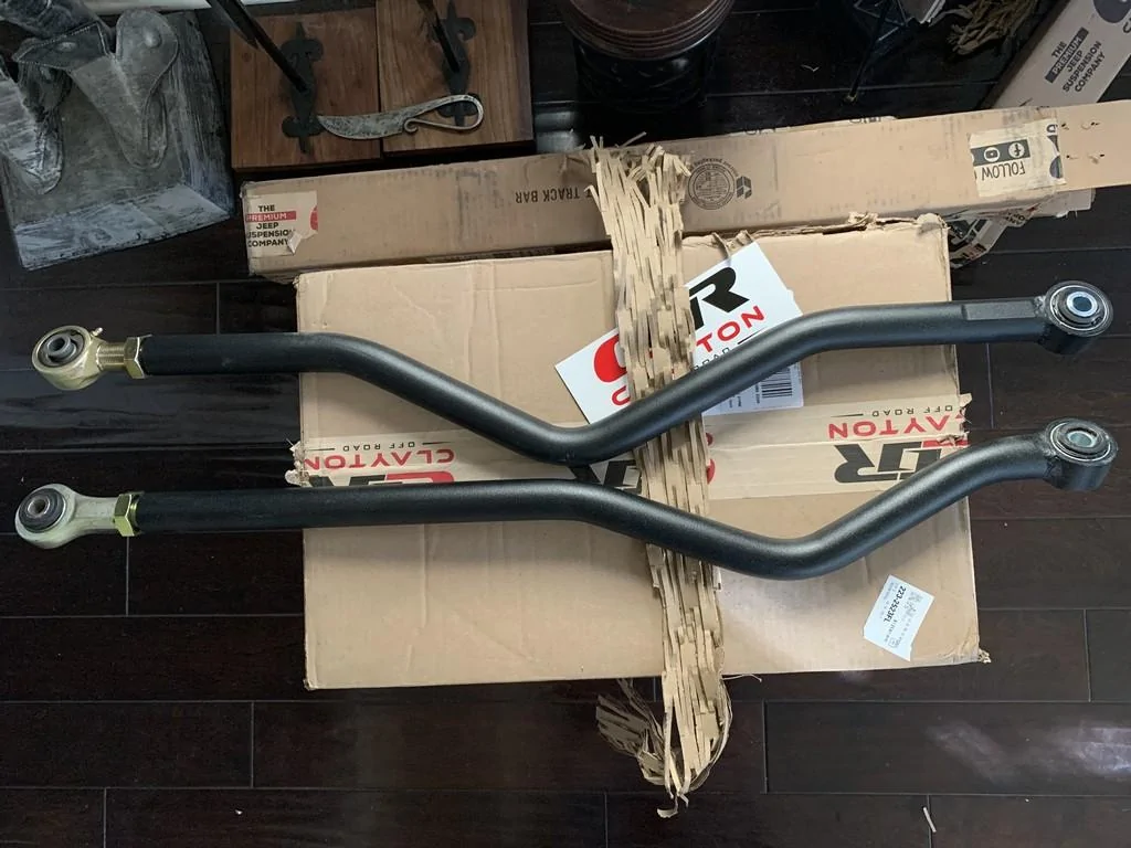

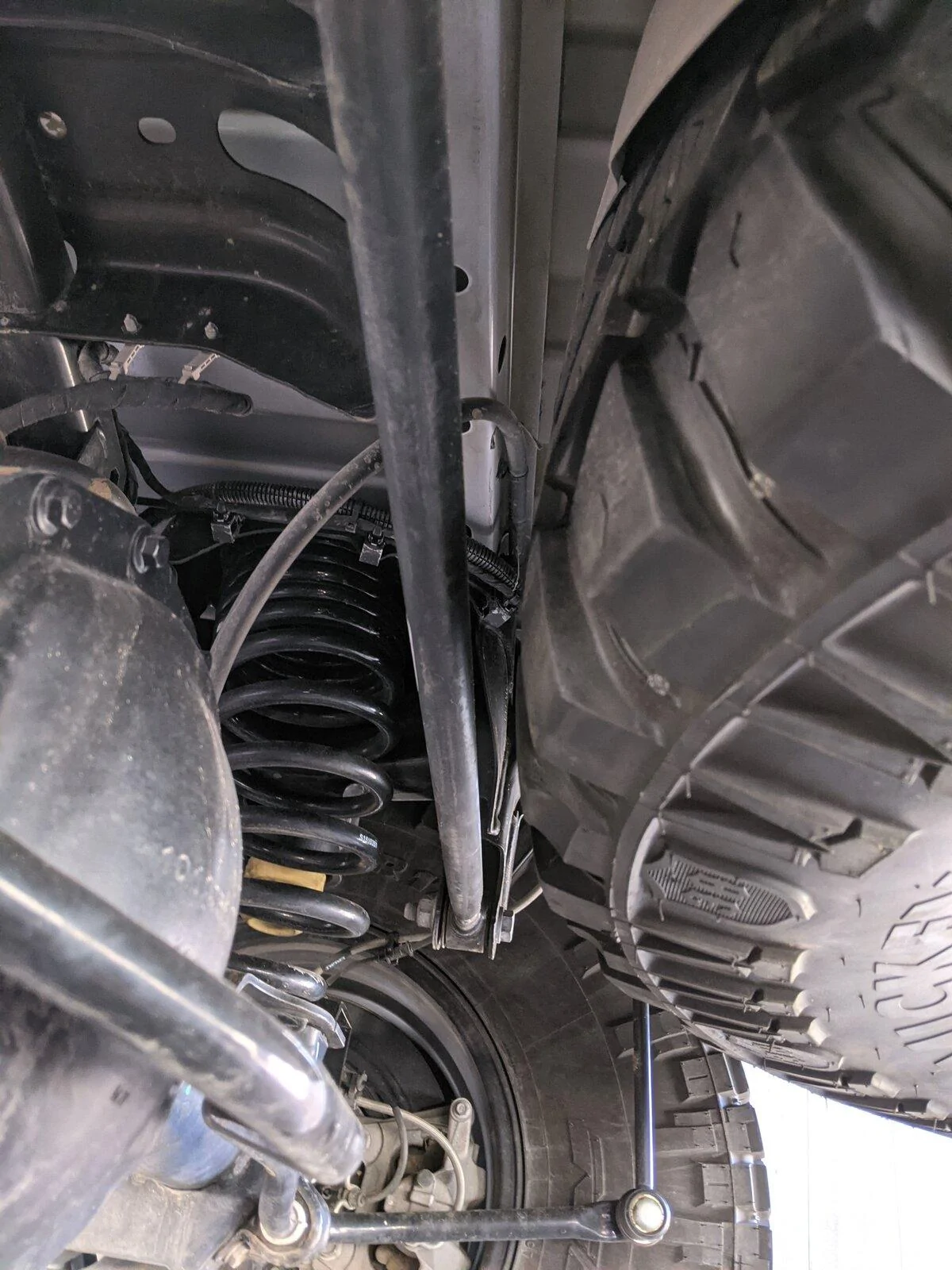

Here it is ! New Clayton Overland Plus kit front and rear trackbars. The new Rear track bar for the Gladiator to clear a 37" spare is on top of the pic. Definitely has a bend in it !! Yea !
Jeep Gladiator 37” spare tire - list of tires that fit under the bed {filename}
awesome. Just awesome. Pics once installed bro!!

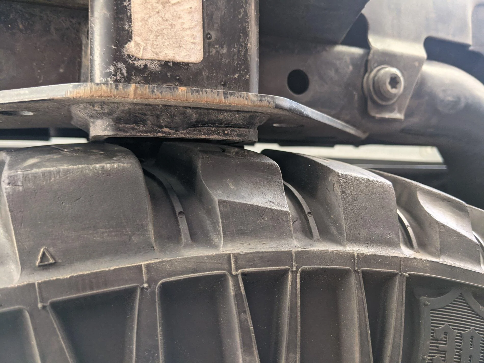

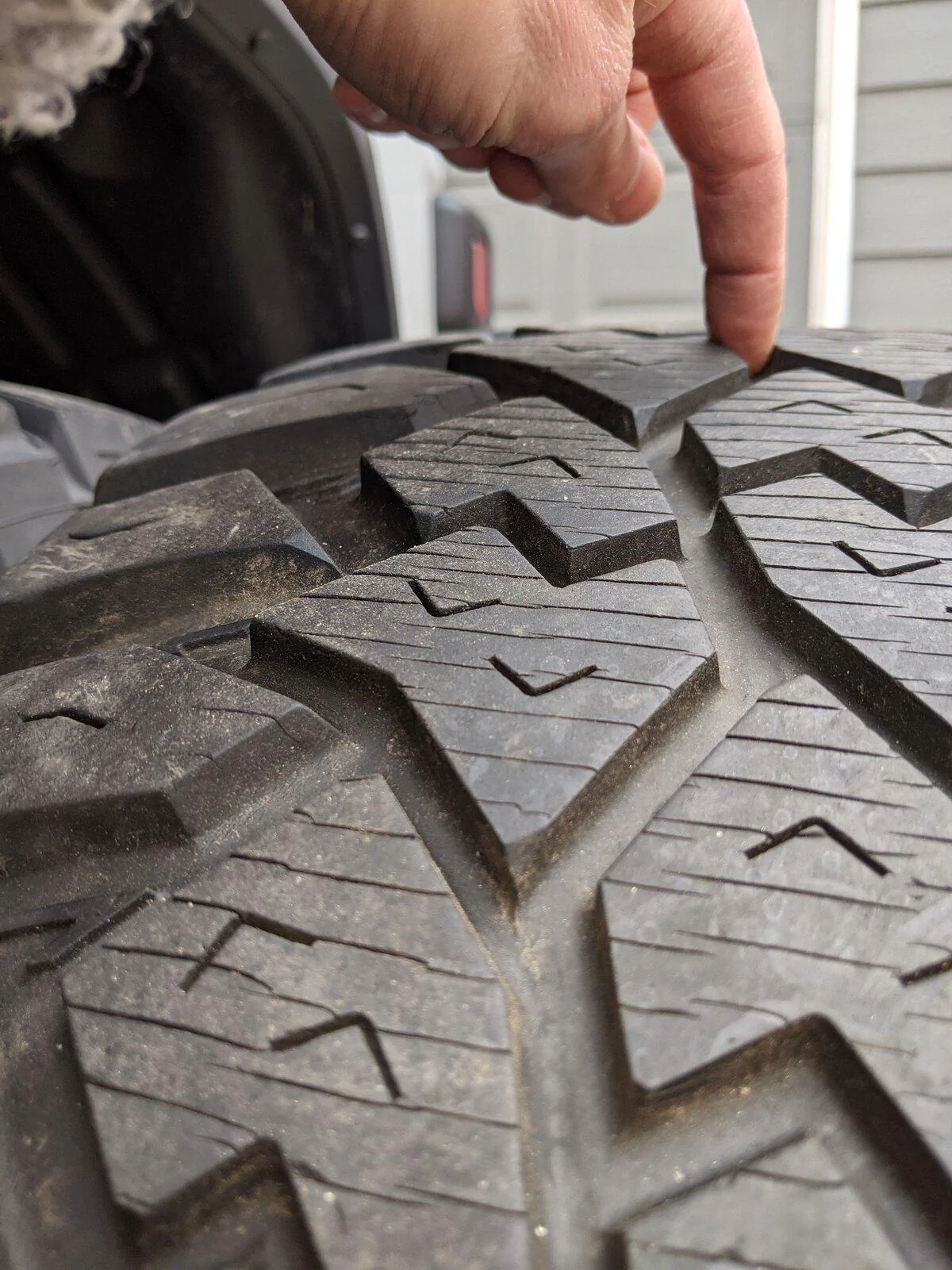

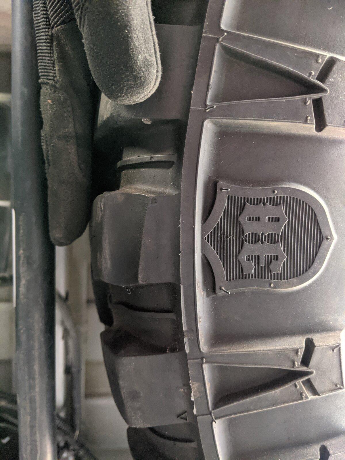

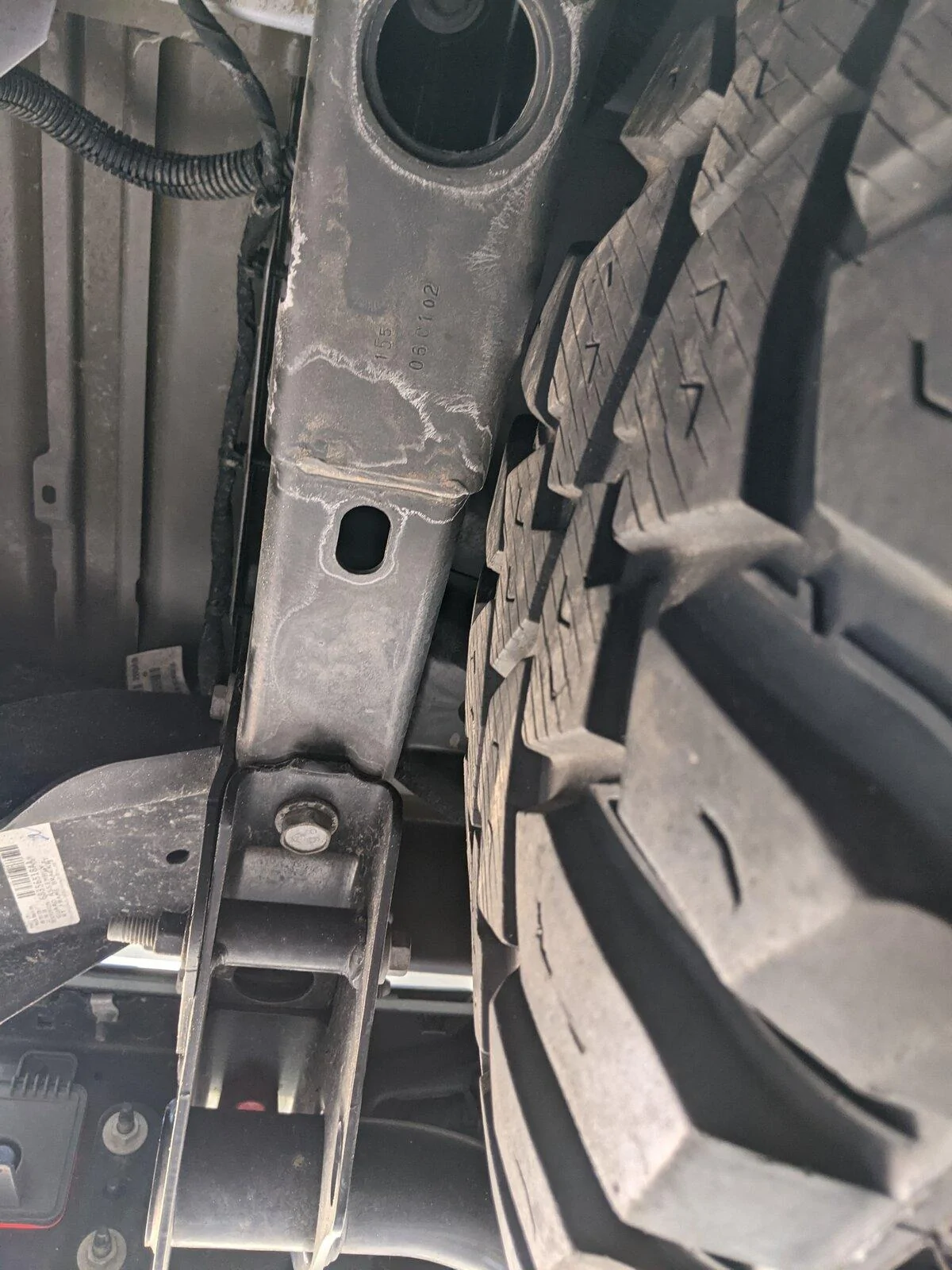

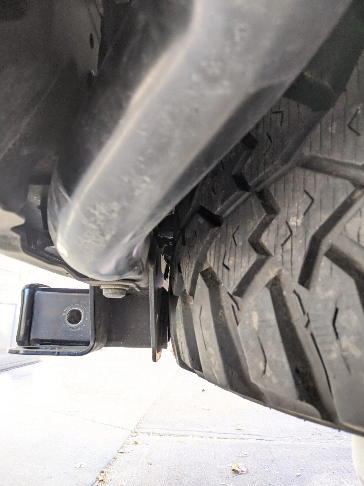

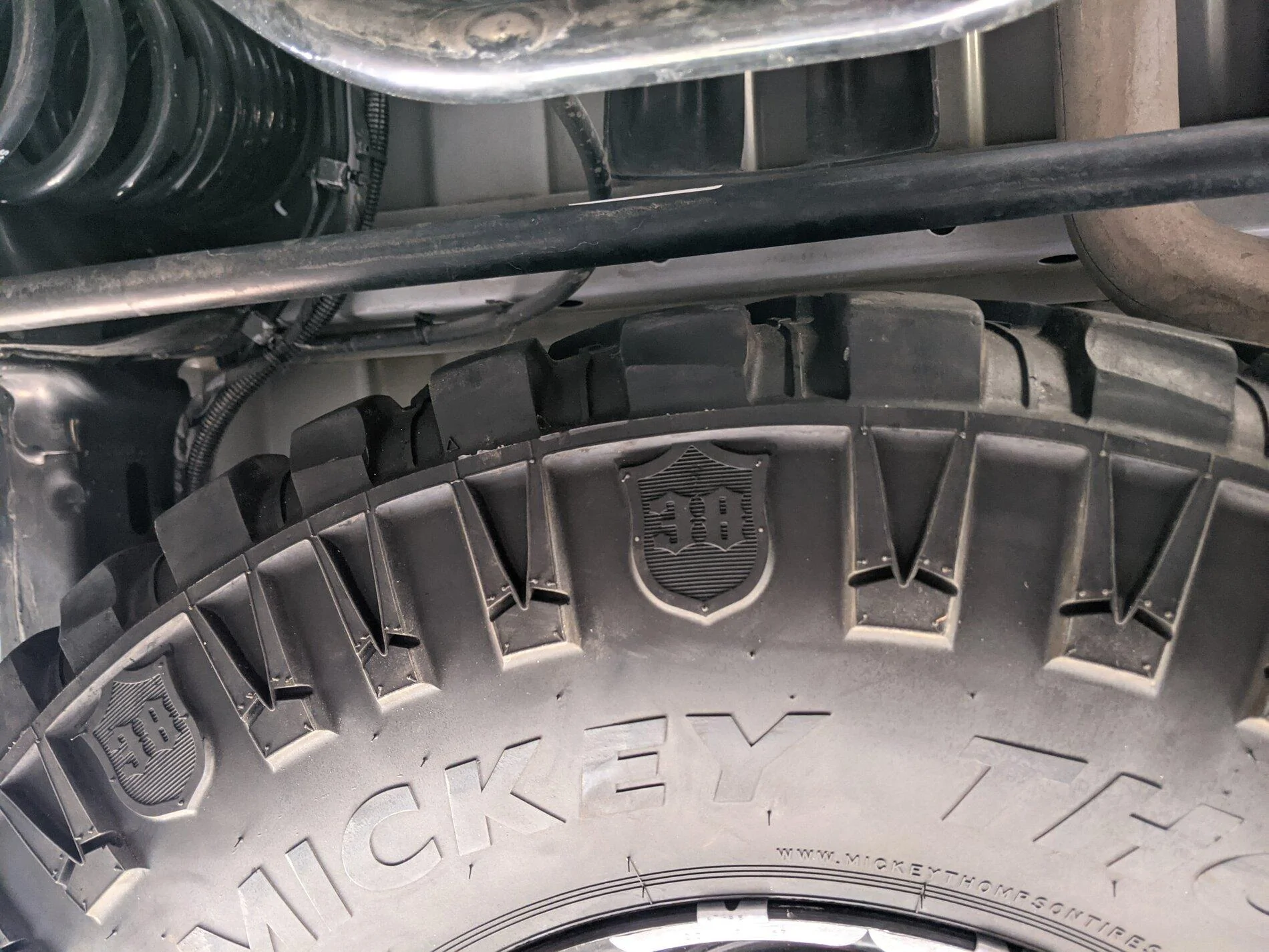

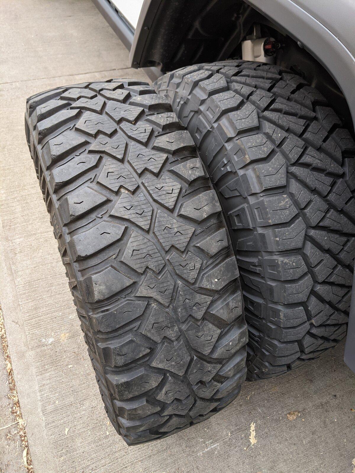

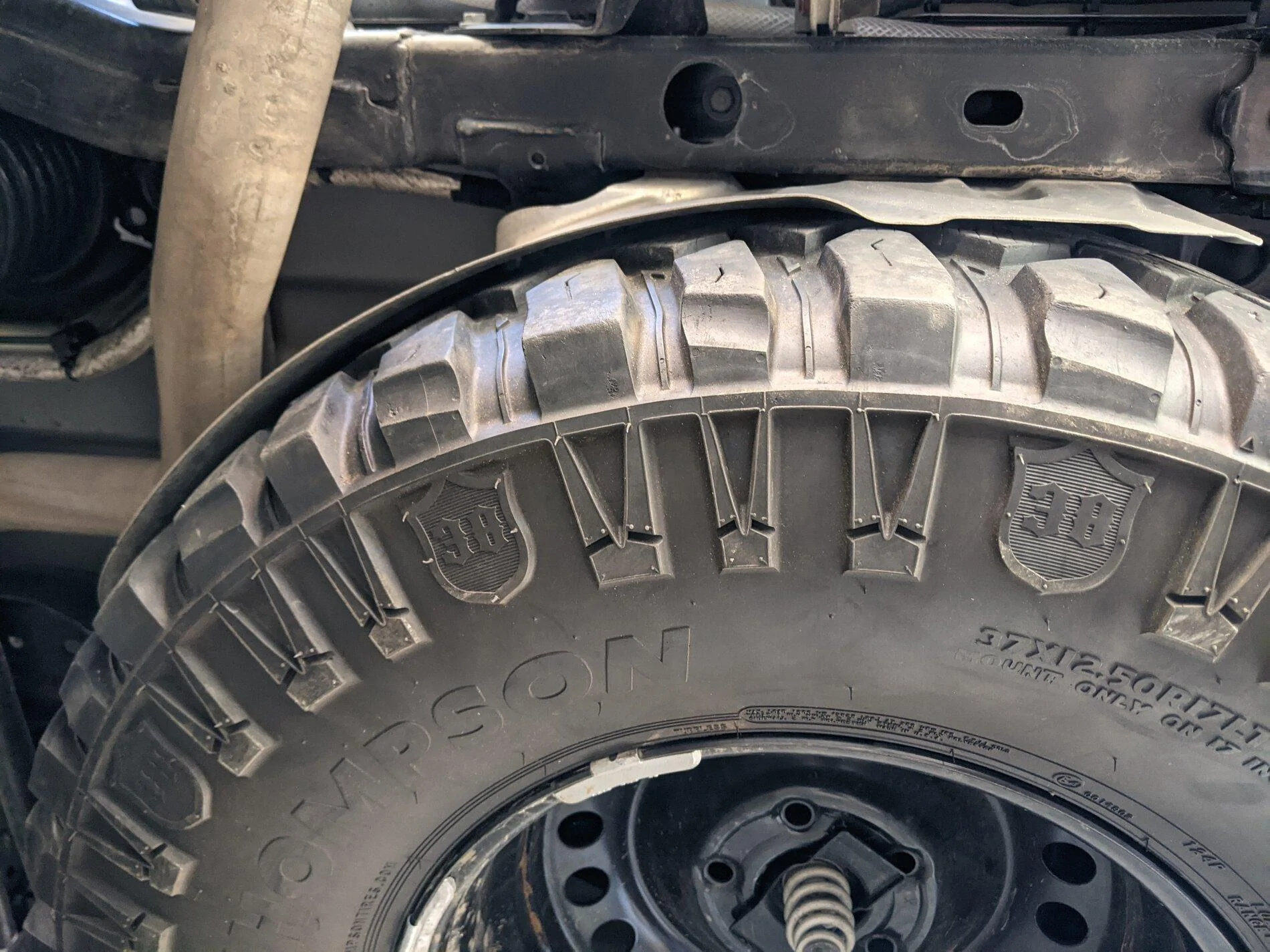

I found that a (used) Mickey Thompson Deegan "38" MT in 37x12.5x17 fits perfectly on an OEM steelie. There was no drama lifting it into place and it clears the track bar with flying colors. It touches the rear hitch but it's not "jammed" against it. Fits the frame rails as well. I wasn't expecting this nice surprise :)
Please note this is NOT a 38 inch tire... the model is a Deegan "38".
NOTES:
1) OEM steelie 17in
2) Mickey Thompson Deegan "38" Mud Terrain (37x12.5x17 Load D)
a. 10psi - I just picked a random low psi for install as I have an on-board compressor
b. 10/32nd tread depth (~8mm).... yes it's a used tire but not bald by any means
3) dropped my rear Clayton springs by 1/4" of lift (guessing this wheel combo is ~130lb?)

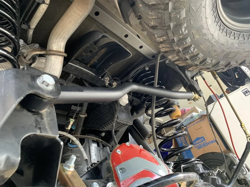

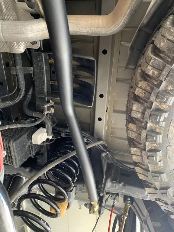

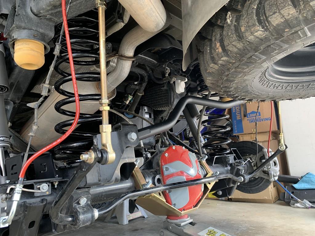

3.5" Clayton Overland Plus kit installed. Great Kit ! Top Quality. Here are some pics of the track bar installed, but, with my 33" spare. I will update in a few days when I get my 37s.

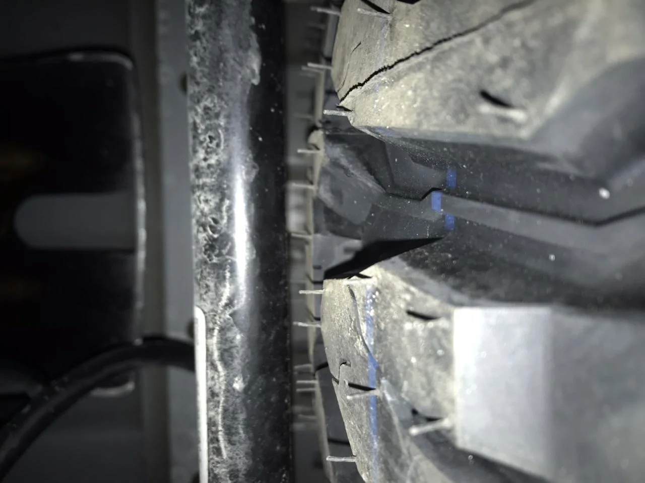

So I just fit Patagonia 37x12.50r17. 17x8.5 wheel. I aired it down to 10 psi.
With that, the tire has 1/4" gap to the track bar. Is this OK?
I don't know the suspension mechanism and how track bar moves.
