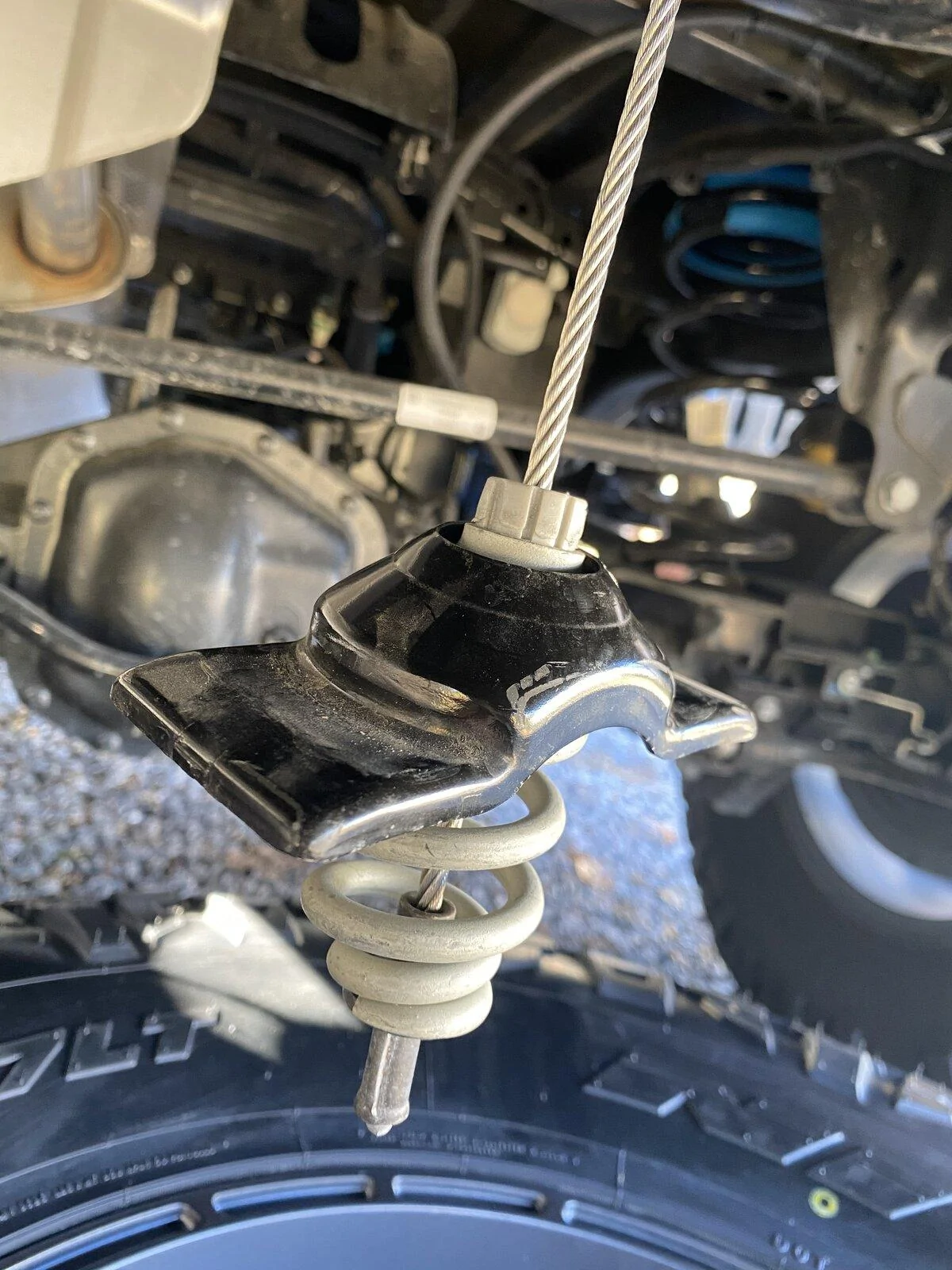

tried asking on another thread but maybe someone here will know... trying to store my 5th wheel (Fuel Shok) and 37 in factory location but the black bracket that pulls through the hub isn’t long enough and keeping popping out when I start winching. see pics. any thoughts?

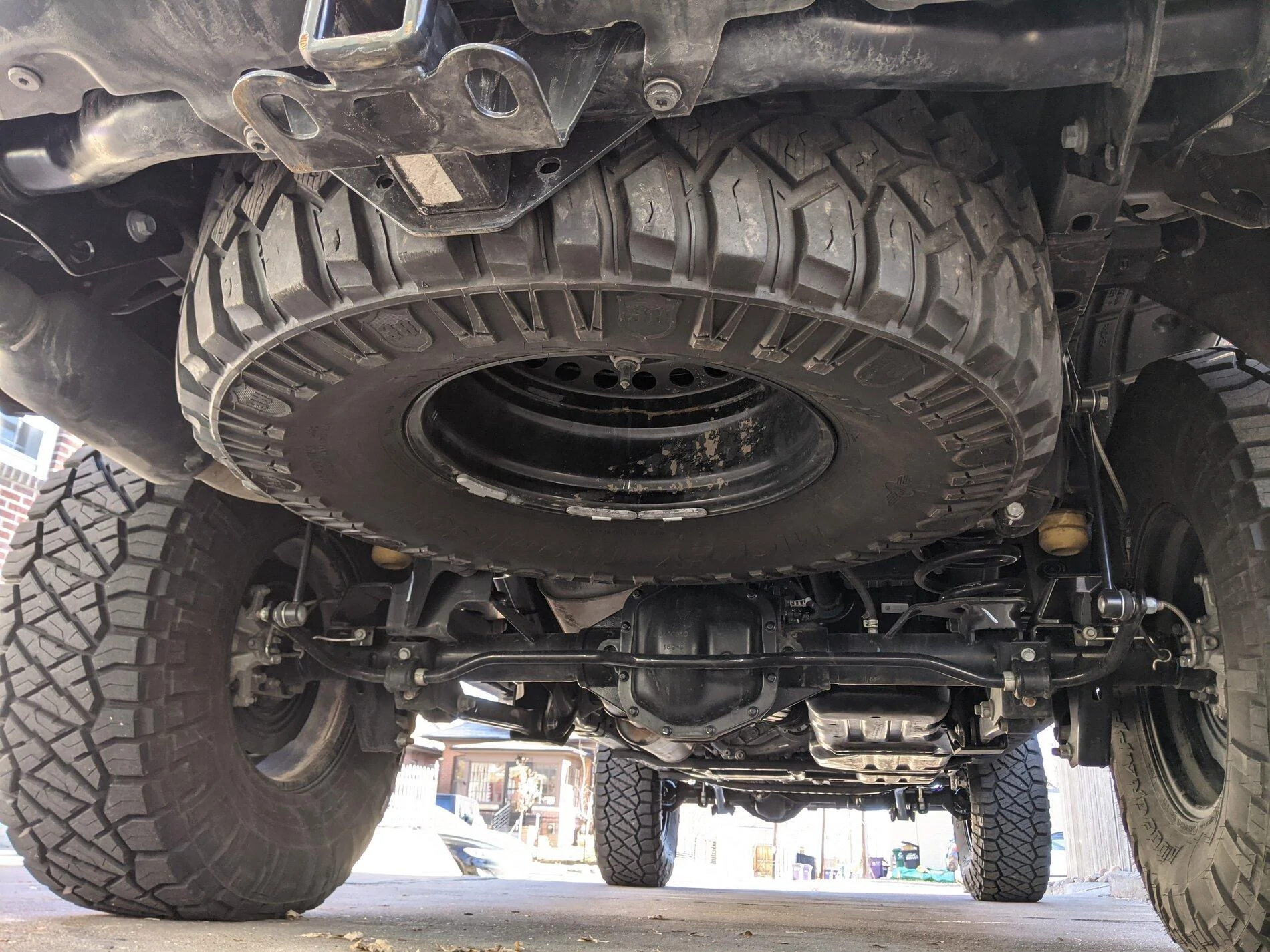

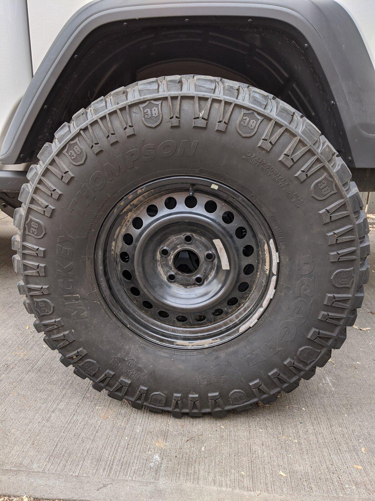

I found that a (used) Mickey Thompson Deegan "38" MT in 37x12.5x17 fits perfectly on an OEM steelie. There was no drama lifting it into place and it clears the track bar with flying colors. It touches the rear hitch but it's not "jammed" against it. Fits the frame rails as well. I wasn't expecting this nice surprise :)
Jeep Gladiator 37” spare tire - list of tires that fit under the bed 101BDBFD-073A-4305-8124-25E06570583C
Also found a used 37x12.5x17 MT Deegan 38 for sale on the local classifieds. It functioned as a spare on a JKU Wrangler so there's plenty thread which might mean it might not fit as well as yours.

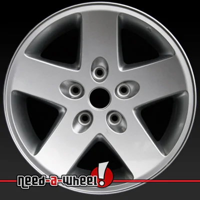

Its currently mounted on an older 2007-2013 JK Rubicon rim pictured below. Can anyone confirm this style of rim will fit on the JT? Offset is 44mm+ which is typical of all JK/JL/JT stock wheels but I don't want to assume only to find out one day when I need to use the spare...it doesn't.
