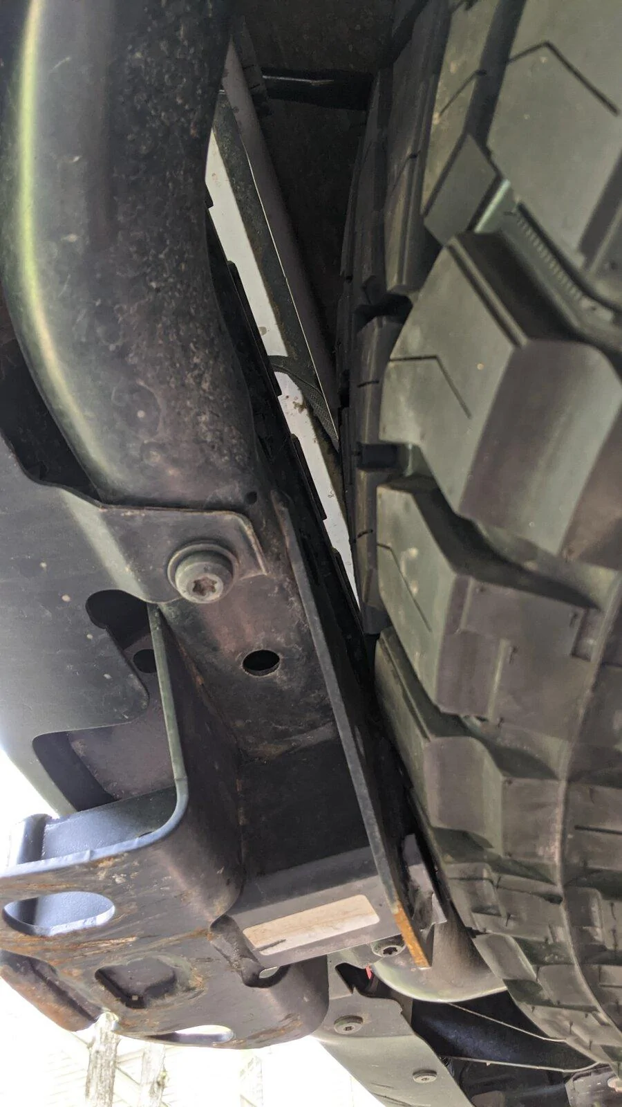

That 37s should be just fine in there. At what point does the frame become an issue for 40s? And since the frame there is not really load bearing, just supports the bed and is part of a very long rear crumple zone... what about notching it horizontally?

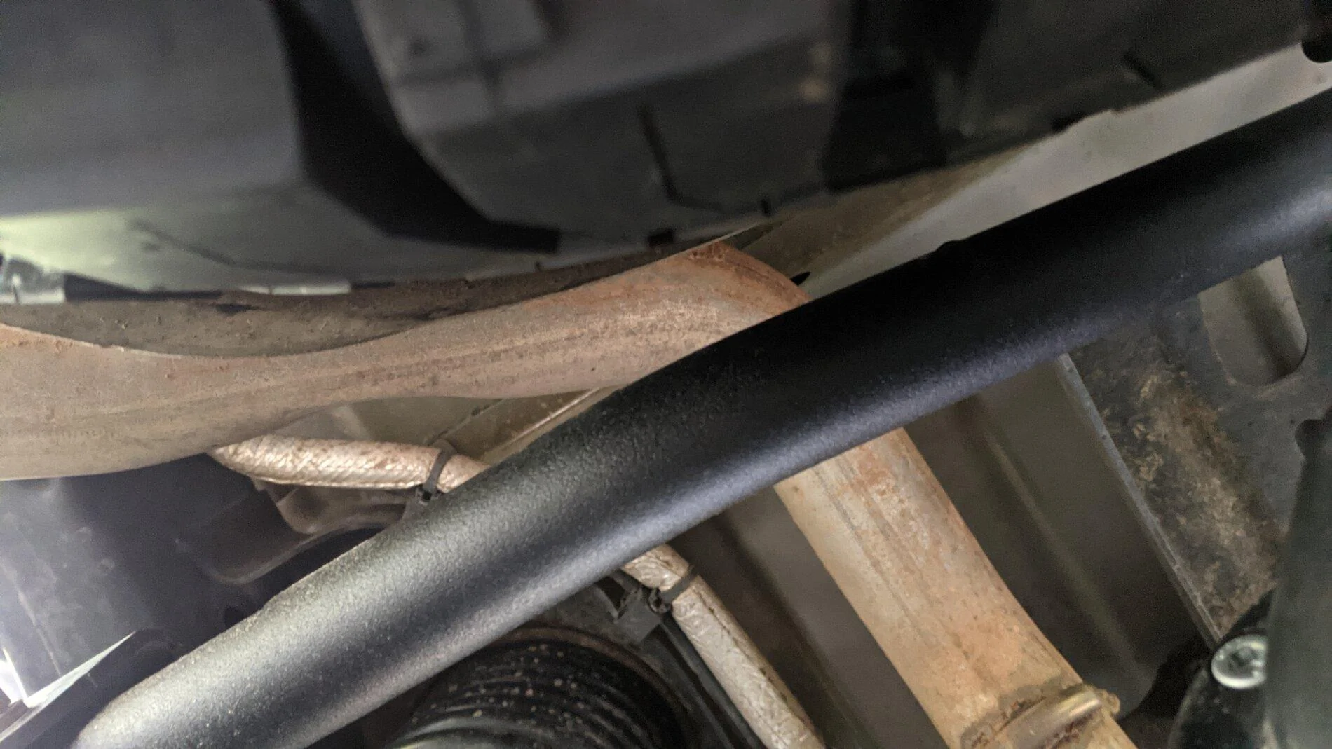

I found I did not need to remove the heat shield (Milestar Patagonia), I just removed one of the 2 nuts at the front and loosened the other. This allowed the shield to move out of the way just enough.

That's what I am saying, why not notch those rails? Super minor notch needed to go from 37 to 40. 1.5" each side, call it 2" to be safe. Shouldn't affect much.

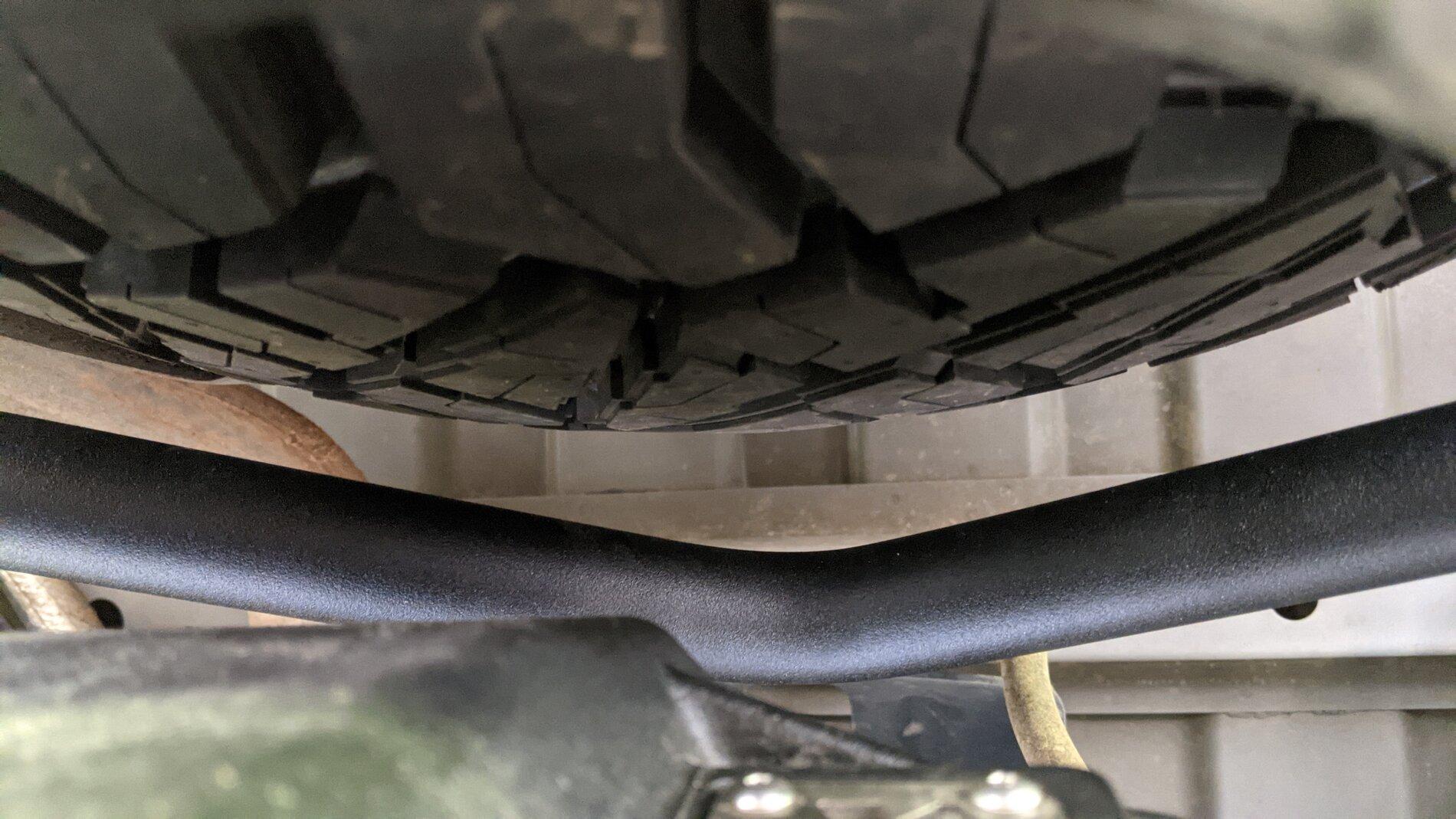

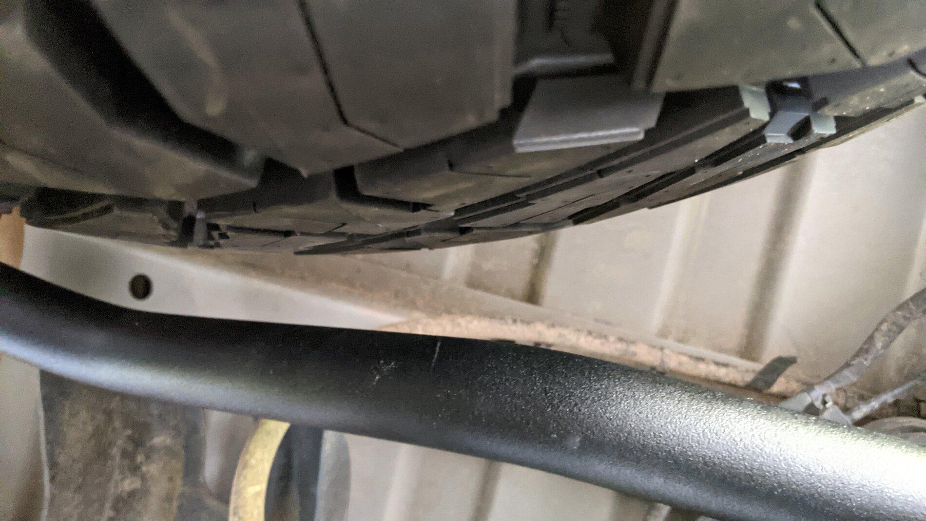

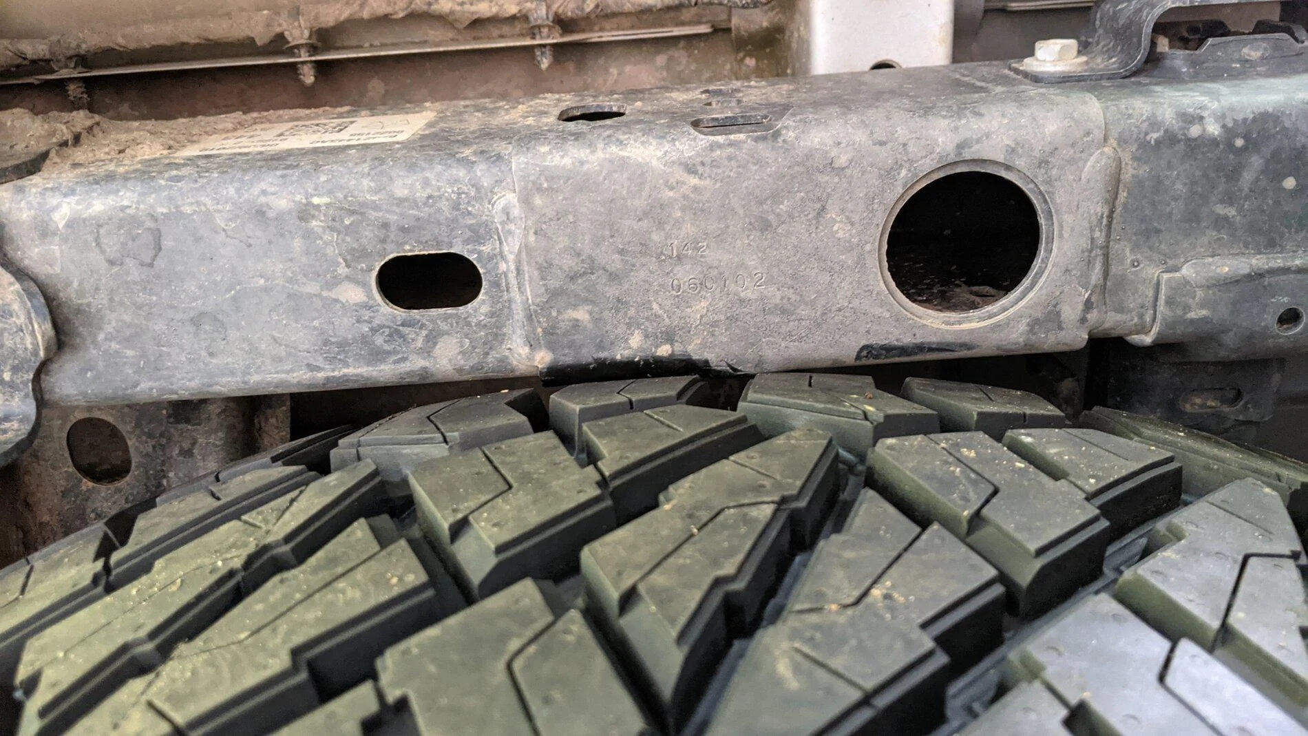

A 37x12.5R17 Cooper STT Pro does barely fit. When comparing it side by side to the goodyear it was slightly smaller.

I was successful with the Coopers also. Had to get a wheel that worked though. The KMC wheels I have had a center hole that was too wide. Picked up a cheaper spare wheel and all fit like a glove.
