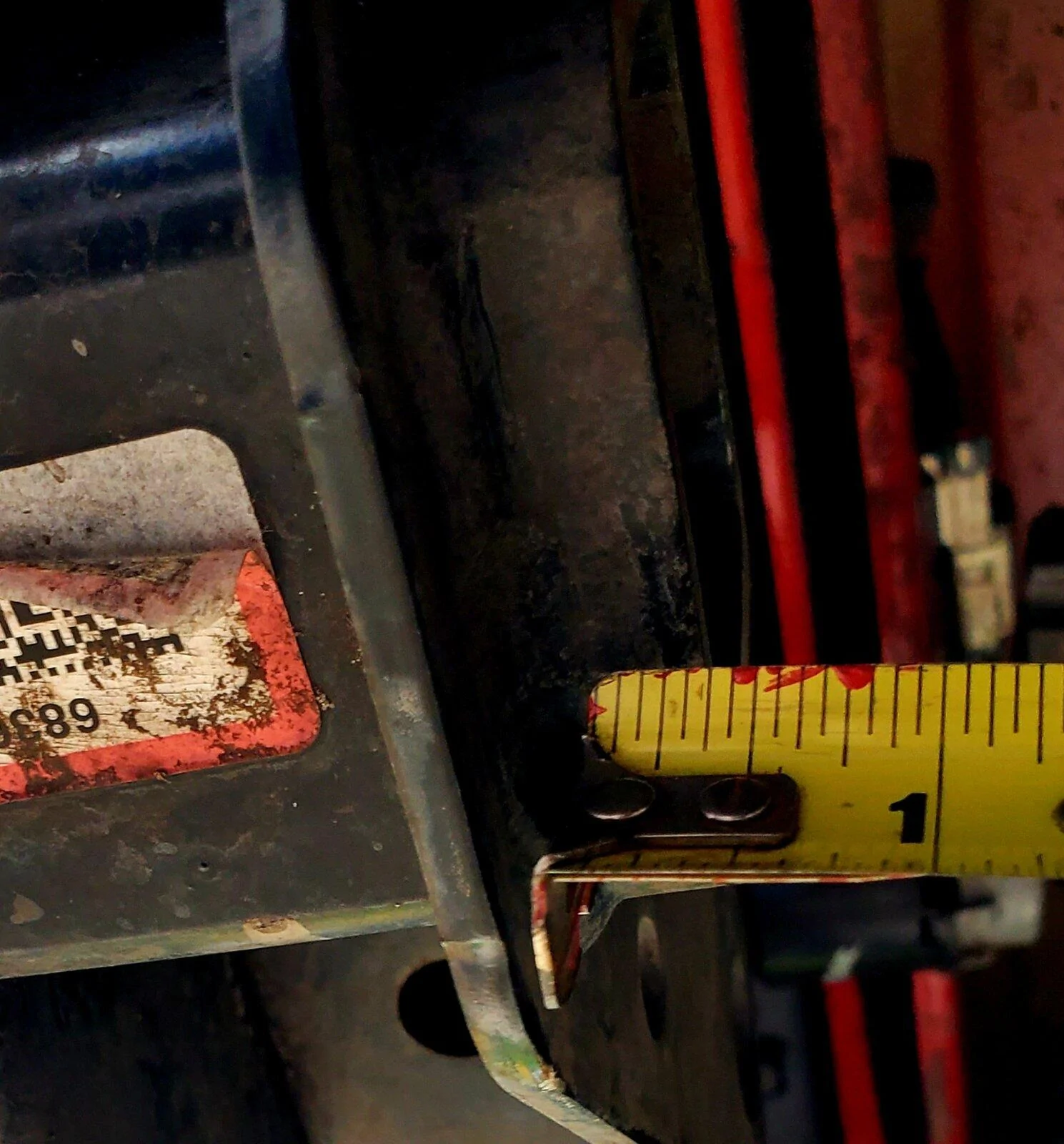

Are there and vendors that offer a receiver hitch with a different profile that would give us more room for a 37?
Tommydogg
Tom
Feb 25, 2020
Florida
2020 Jeep Gladiator, 1993 Ford Mustang, 1995 Ford F150, 2015 Ford Mustang GT
Has anyone ground down the inside of the square tubing that makes up the receiver. It Looks like you could gain about 3/8ths of an inch if you ground it down to the weld.

37x12.5r17 Mickey Thompson trail boss a/t on stock steel wheel doesn’t not fit, gonna get a Clayton track bar and grind the trailer hitch extra fat and it should fit then

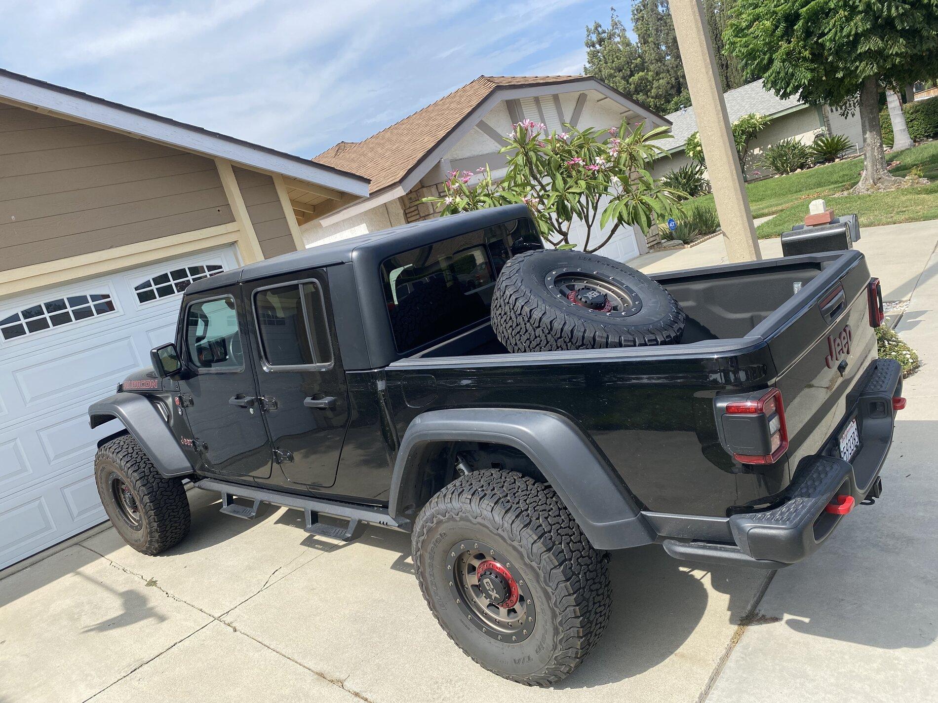

Gotta watch that track bar. But lets just say you get that big 37 to fit…. I’m curious on how long that spare tire hoist would last with the addition weight. Idk.. maybe I’m over thinking it.
I personally went with a bed mount. I think it makes it look aggressive. Especially when the tops arw off and the adventure doors are installed.
i just installed yesterday. Headed to gold mountain soon for a quick little run to see how durable. So far so good though.

I grinded off the extra fat on the trailer hitch and installed claytons rear track bar. Mickey boss a/t now fits under the bed

Looks good if you're into that kinda thing. Personally I bought a Jeep Gladiator because it's a pickup truck with a box that can carry stuff. That tire eats up >½ usable space and doesn't exactly help the view out the rear window.
A Wrangler would actually end up having more storage than a tire in the bed setup like that.
