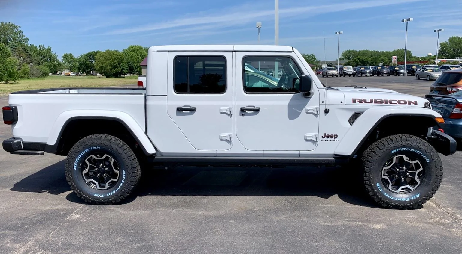

Picking up my Rubicon tomorrow. Here’s what it looks like with a Alloy USA 1.5” leveling kit / 35’s (35x12.5x17)
That looks great! Could you measure the height of your Jeep at the highest point of the cab?

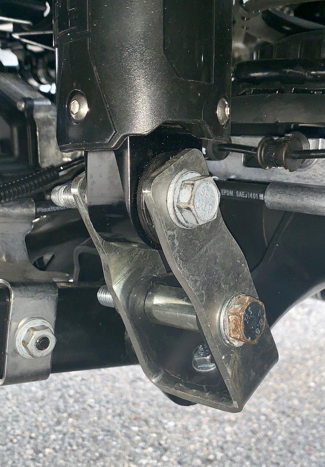

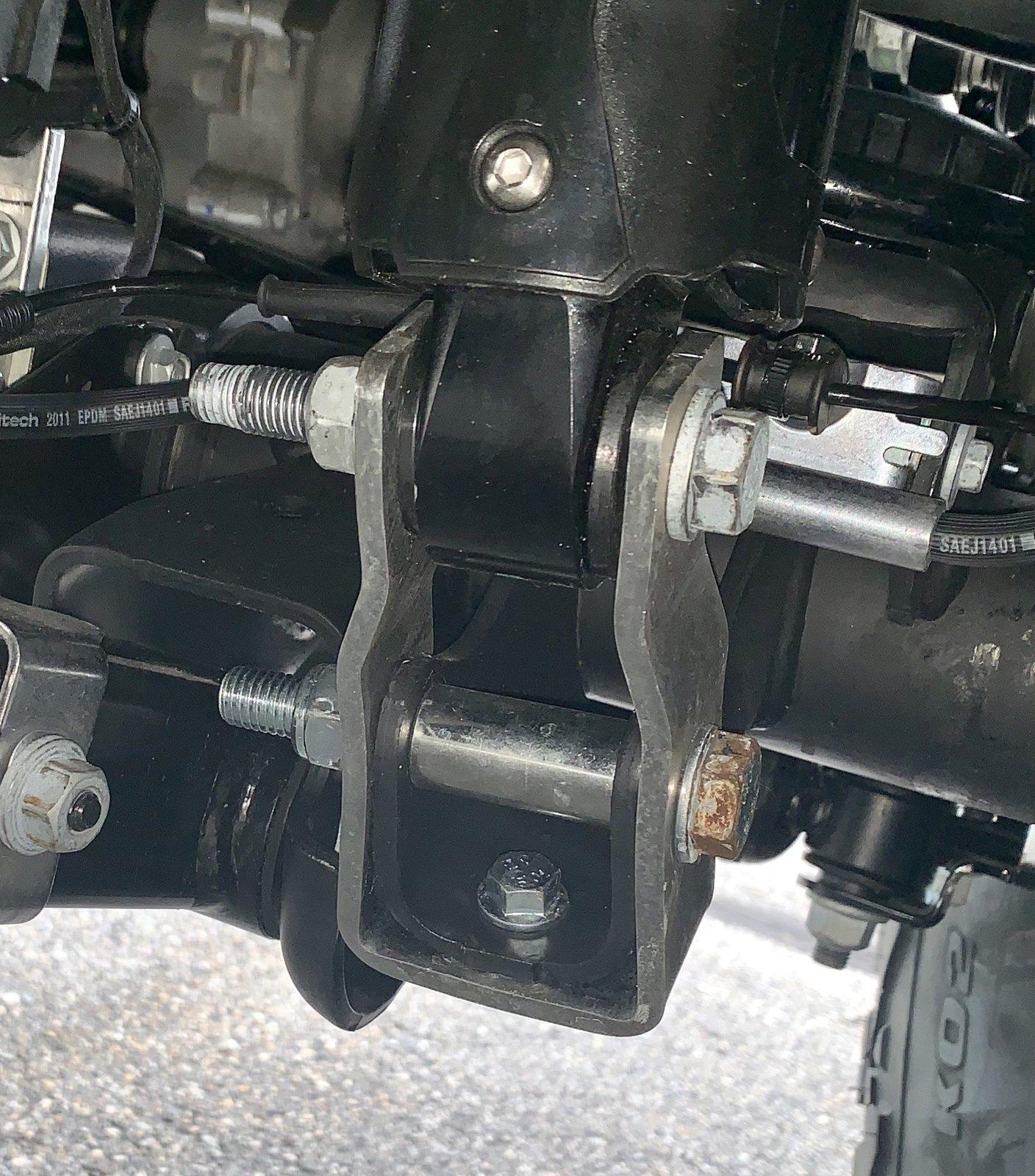

Looks awesome. How are those shock extensions? Quality or iffy? Wanting to buy same kit so any info u can provide would be greatly appreciated.
I just installed the kit on mine tonight. No complaints or concerns. Directions would have been nice but not necessary. Don't reinstall the rubber isolators on the front, the poly spacers in the alloy kit are not designed to be used in conjunction with them
That was my biggest concern before getting the kit. The extensions should do a good job and I don’t have any hesitation using them on just a 1.5” level. I’d be “shocked” if they ever failed (sorry had to do it).
Lol. Can’t pass up a chance to be funny that easy. I appreciate the info. Gonna order today. Happy Jeepin
Thanks for the input. Seems there is confidence in the kit. Gonna give it a whirl.
