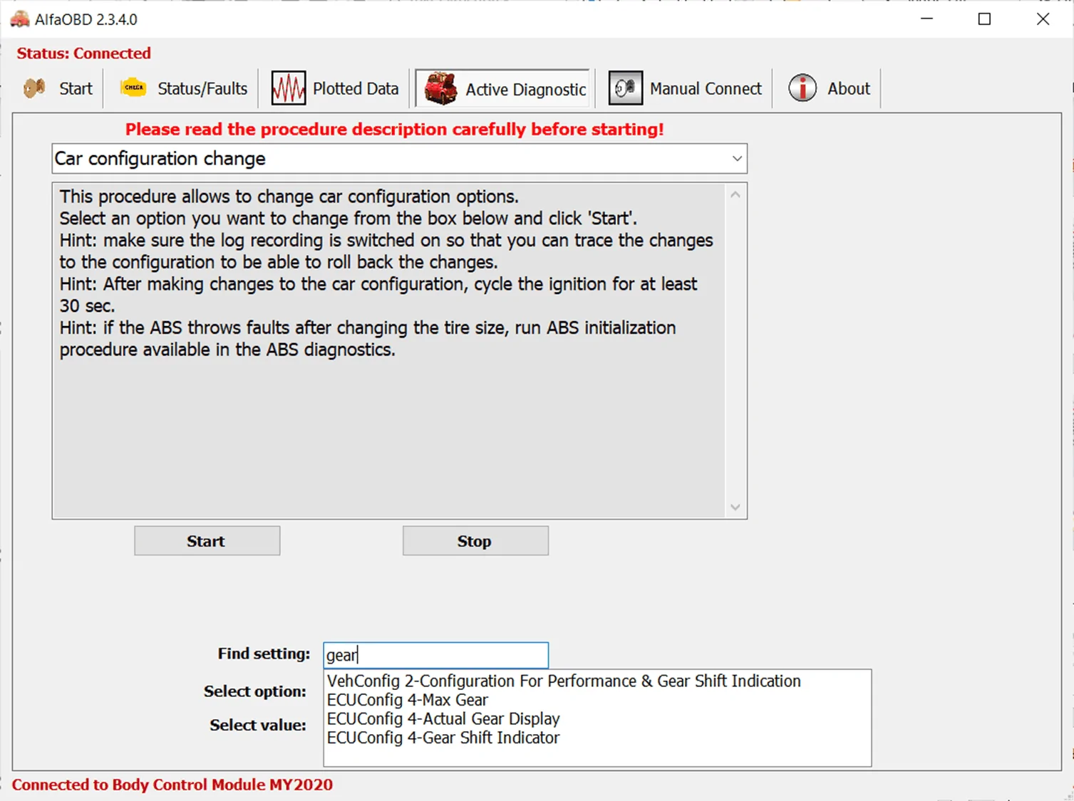

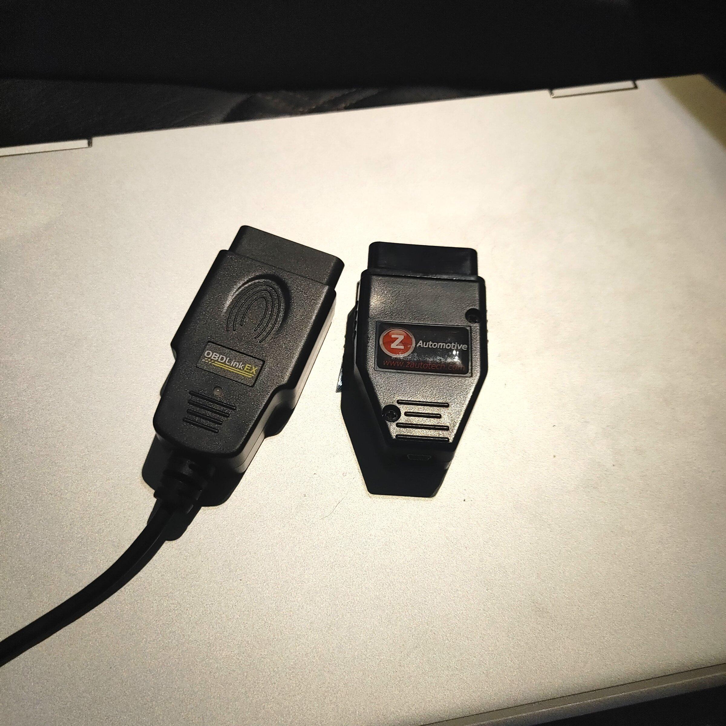

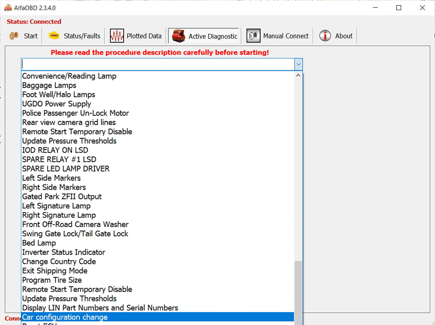

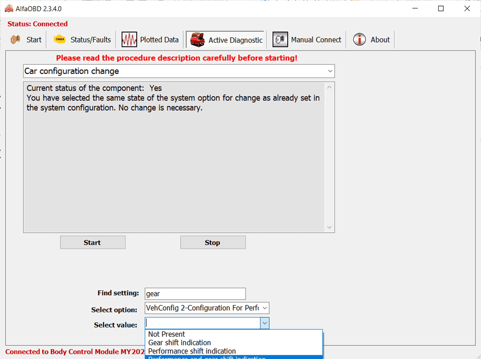

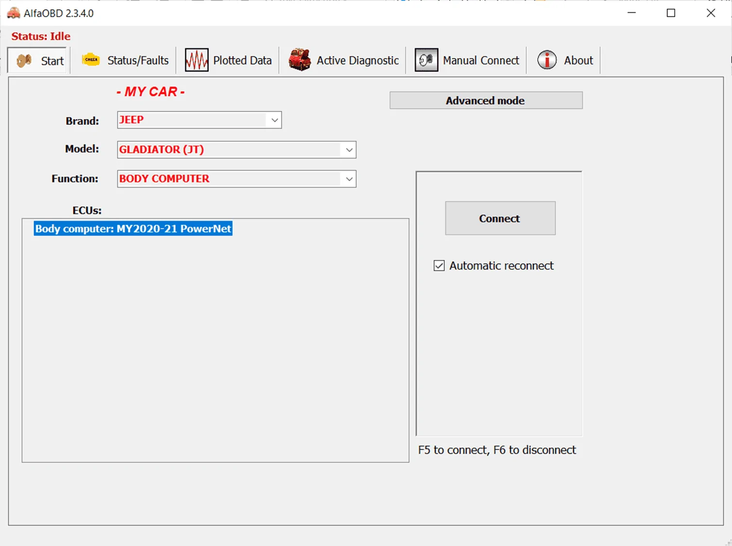

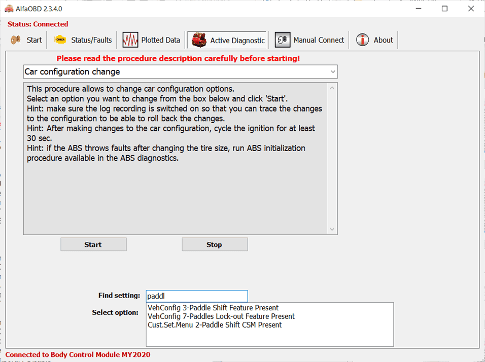

Here is my adapter next to my tazer. I am using the Tazer security block
I was unable to get my VeePeek bluetooth and bypass cable to communicate with Alfa OBD on my android app so I ordered the recommended OBDLink MX+ adapter and it hooked right up today through the OBD2 plug! Not sure if it can bypass the security or if it just used the Tazer as the bypass?
Looks like everything is functioning as designed.......
Thanks to @DC3 for figuring this out and @DAVECS1 for the tech to get it going!
