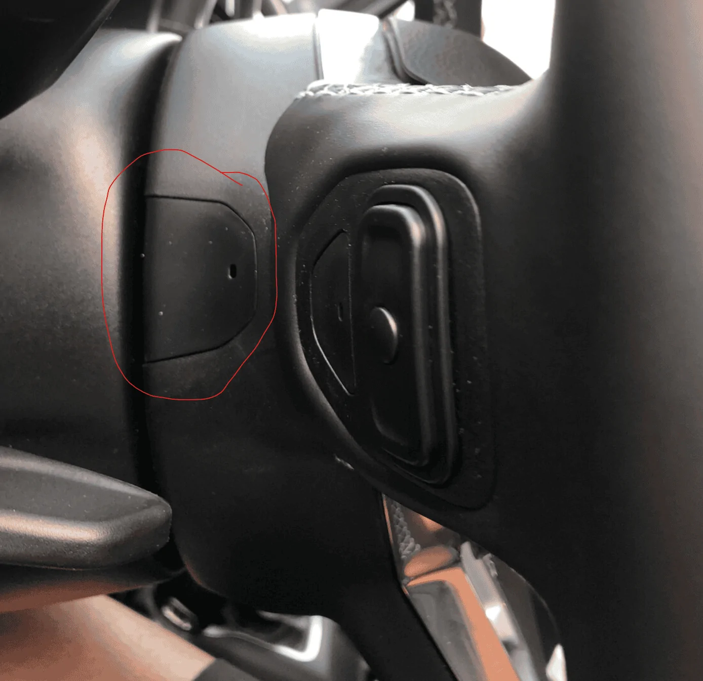

Update: Ordered and should be about 10 days wait on the parts (didn't order a steering wheel). The paddle shifter screw covers are still a mystery. The parts department still pulls up the same one as the OP had but that cover actually goes on the side of the steering wheel (see picture). Apparently, the covers that we need don't exist in any parts diagram. I sent a detailed explanation of what we are looking for, with pictures, to the parts people. Will update everyone if I strike gold.
That cover gets reused as the mating rear cover just transfers over to the new steering wheel.
The smaller cover on the back of the non paddle shifter doesn't fit the larger opening of the paddle shifter unfortunately. I was just showing where the covers go that the OP tried.
