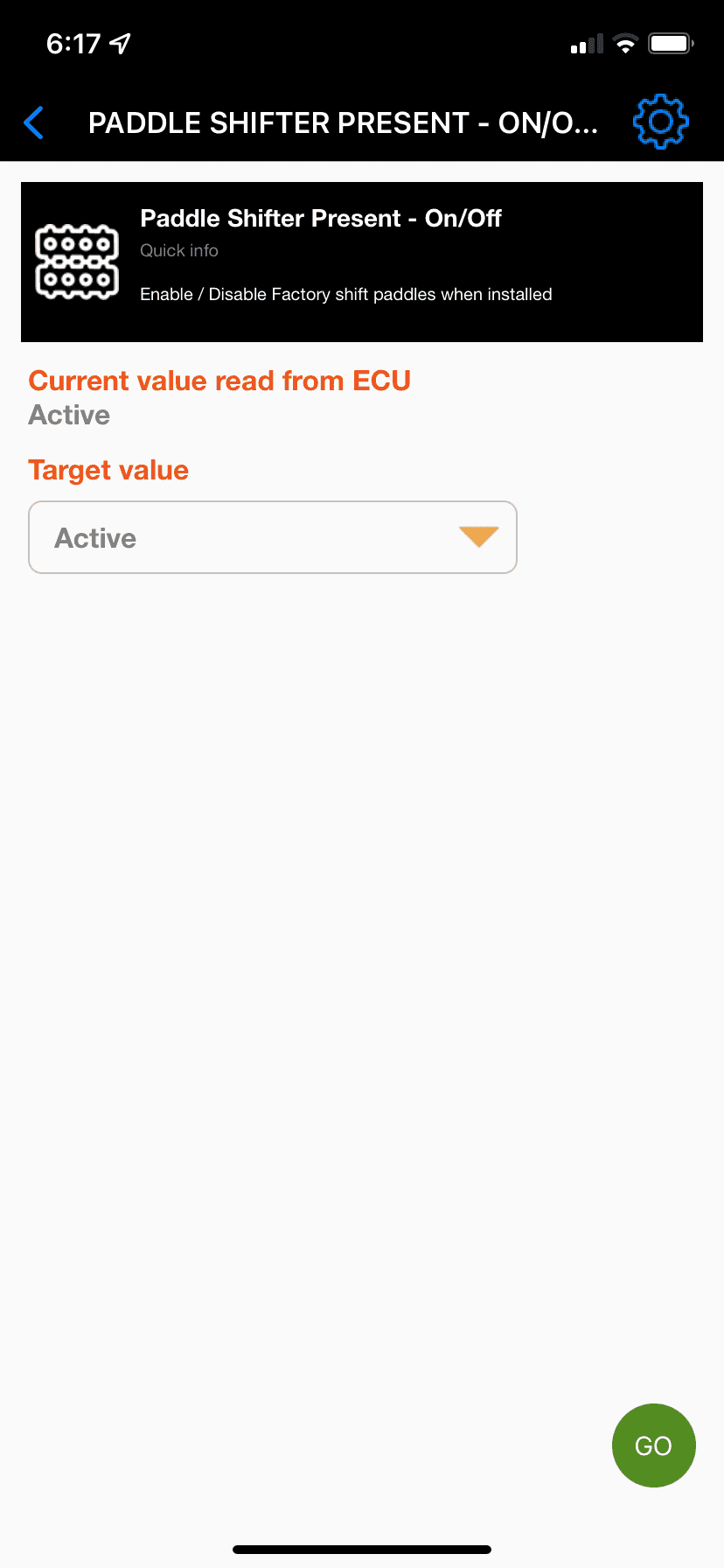

Has anyone used the JScan app to successfully enabled the paddles? I’ve got everything installed and I’ve enabled the paddles in JScan, but the paddles aren’t working. Am I missing something?
What menus did you use, can you screen shot them, also make sure you power cycle a couple times. I was pissed my first drive too. Then they magically worked, I attribute to the beer I drank thinking about it.
Do you have Jscan screen shots? From what I understand, there are two settings that need to be set using AlphaOBD so if you're only doing one of them in Jscan it may not work. It also took a couple of key on/off cycles for my settings to take affect.

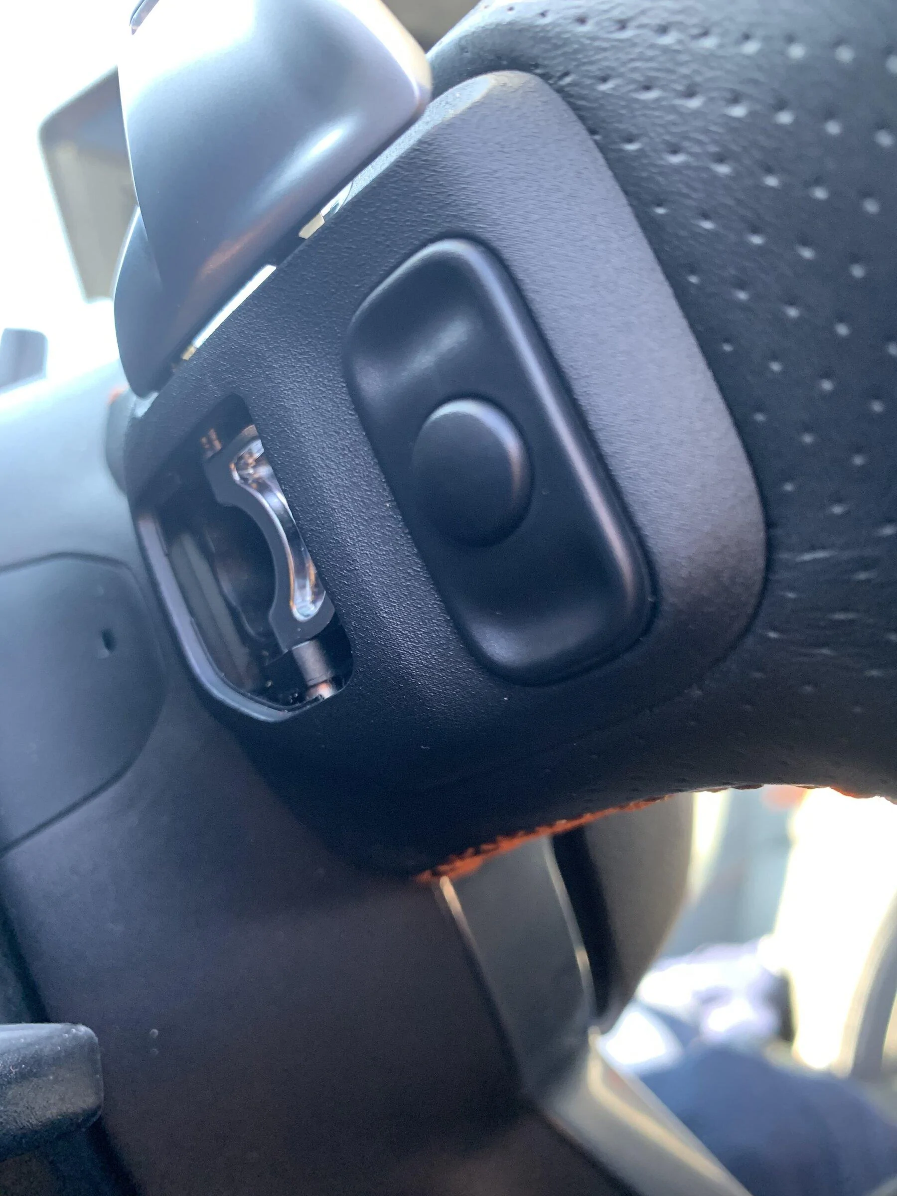

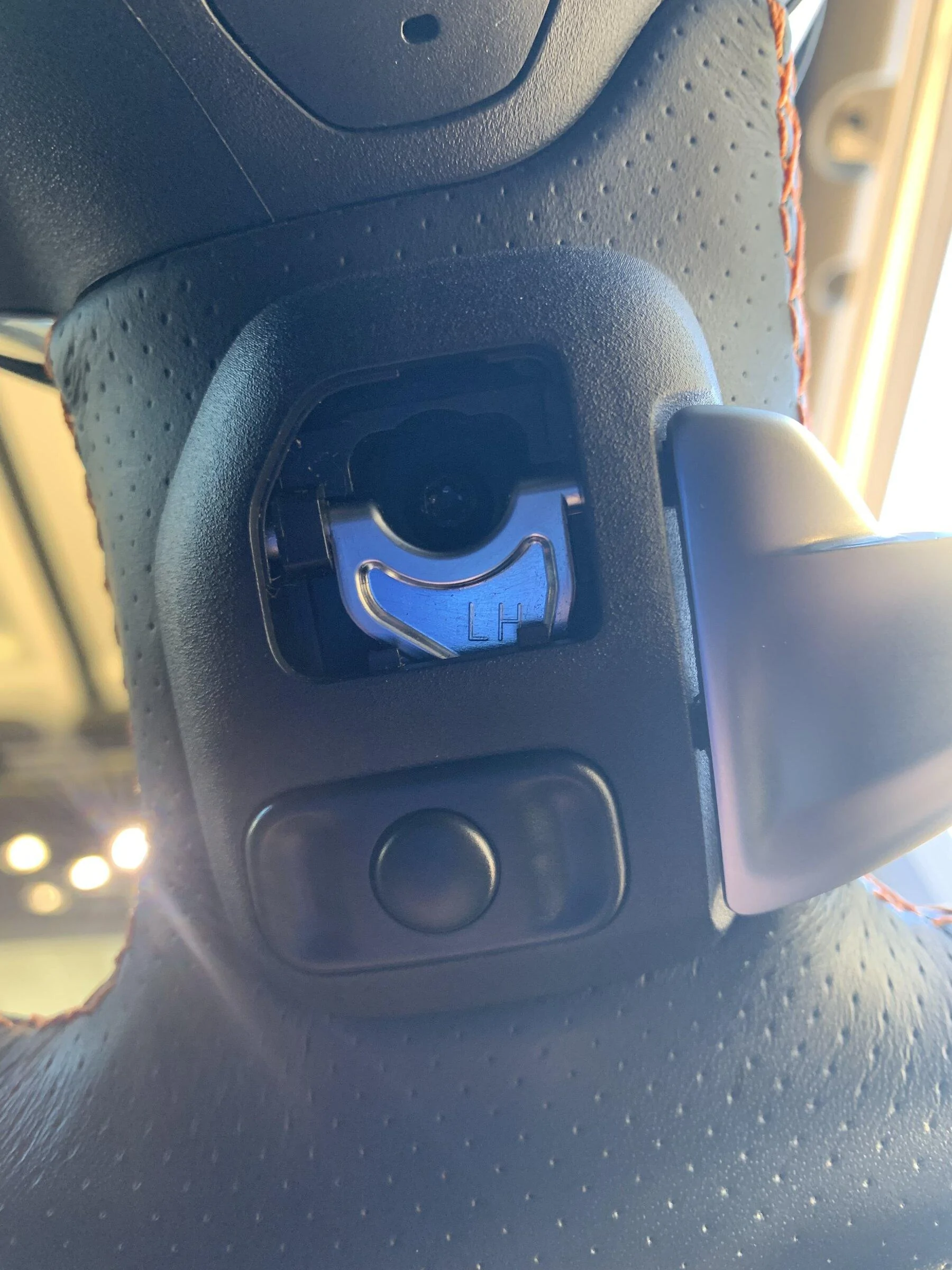

1 down one to go, :)
Looks fancy, espically coz of the punched holes unlike stamped ones of SRTs.
waiting on back order, another paddle & wiring.
did a test fit on Mojave wheel & it seems to fit good enough, will be trying Jscan to activate once i get the back order parts
So I activated the paddle shifters in two locations, under Misc settings and User settings. I don’t know what the difference between them is in JScan, I think one was paddle shifters, the other paddle shifters cms. They were the only two settings I could find relating to the paddles.
move cycled through a couple of times already, I’ll check it again tonight when I leave for work
Did you have to do any cutting or trimming to get the paddle shifter to fit into the factory Mojave wheel hole? I think some kind of foam or rubber filler piece to fill that gap where the bezel sticks over would be good as well.
Did you do an ECU reset afterwards? I know sometimes that helps.
i didn’t do anything, just popped the old audio control & and put this paddle in, i am still waiting for wiring & right side paddle so didn’t even take the wheel out.
I’m sure it will fit better once i take the wheel apart next week

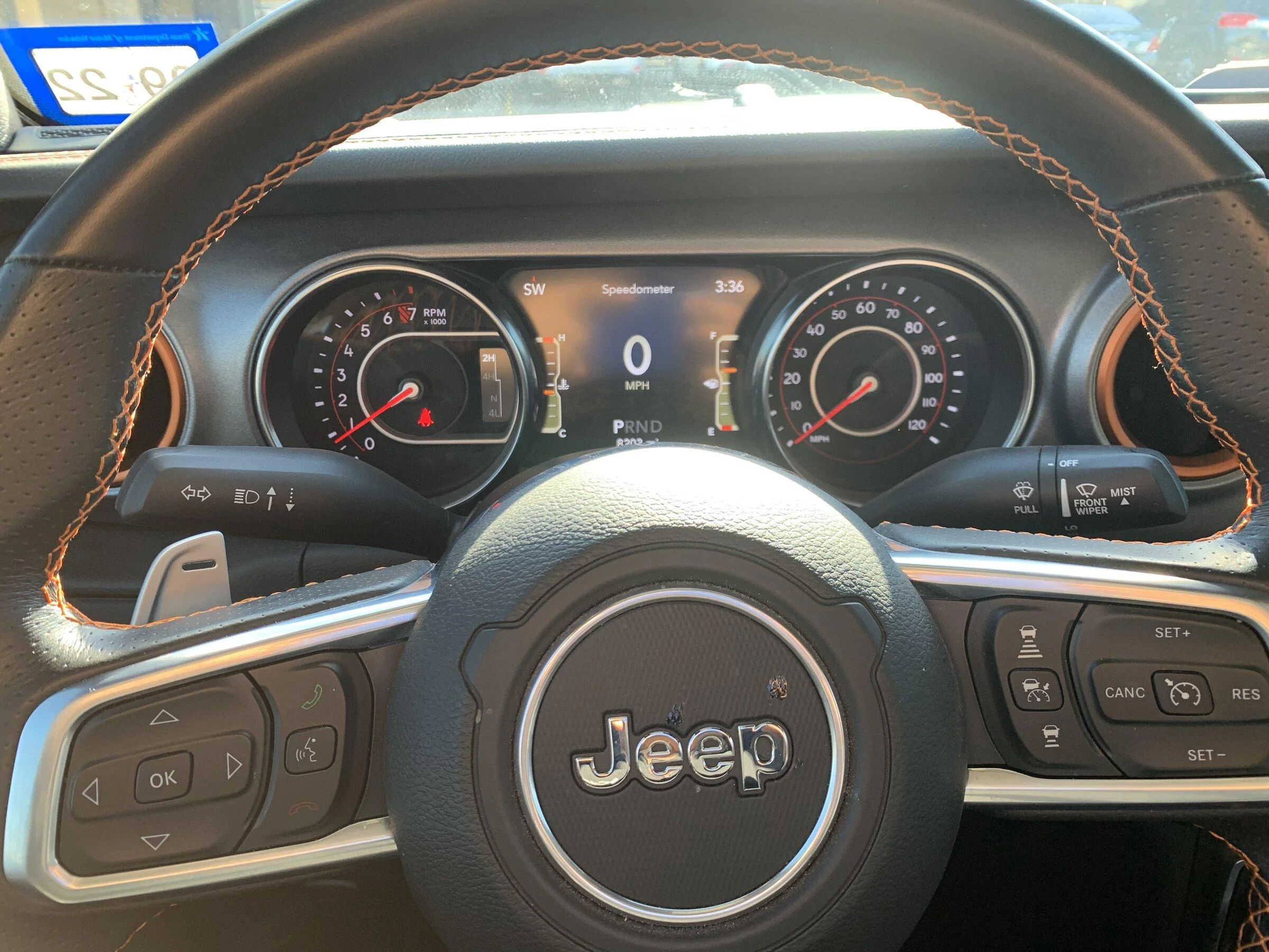

Sorry if this has been covered but I just read through the whole thread and I am unsure. I like my Rubicon steering wheel. I would love to just add the paddle shifters. Is that possible or do I need to get either 392 or Mojave stee wheels?
DC3
DC3
Carl
Jul 14, 2020
47
367
938
Willmar, MN
dilabs.cc
'21 JT GDE Ecodiesel, 22 Polestar 2
engineer
You can fit them to the Rubicon Wheel but they will sit a little proud like the Mojave above.
