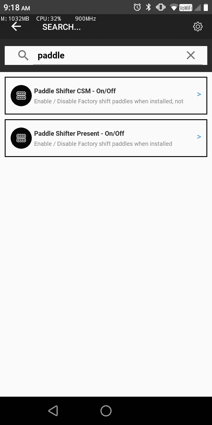

So JScan has failed me so far on the paddle shifters. After activating them in the only 2 places I could find in the app, restarting all the ecu’s, power cycling the gladiator a few times, and driving it to work for a couple of days now, still no working paddles. I know the paddles aren’t defective, I can adjust the radio just fine with them so there’s that. Guess I’ll have to try AlfaOBD next
For clarification, I’m using the JScan app on an iPhone connected through Bluetooth to an OBDlink MX+ connected to the Jeep through a security bypass cable.
That's disappointing as I've got the same setup and was planning on using jscan.

These are the options that come up on the android version.
Jeep Gladiator 392 Steering Wheel Retrofit Screenshot_20220216-091841
