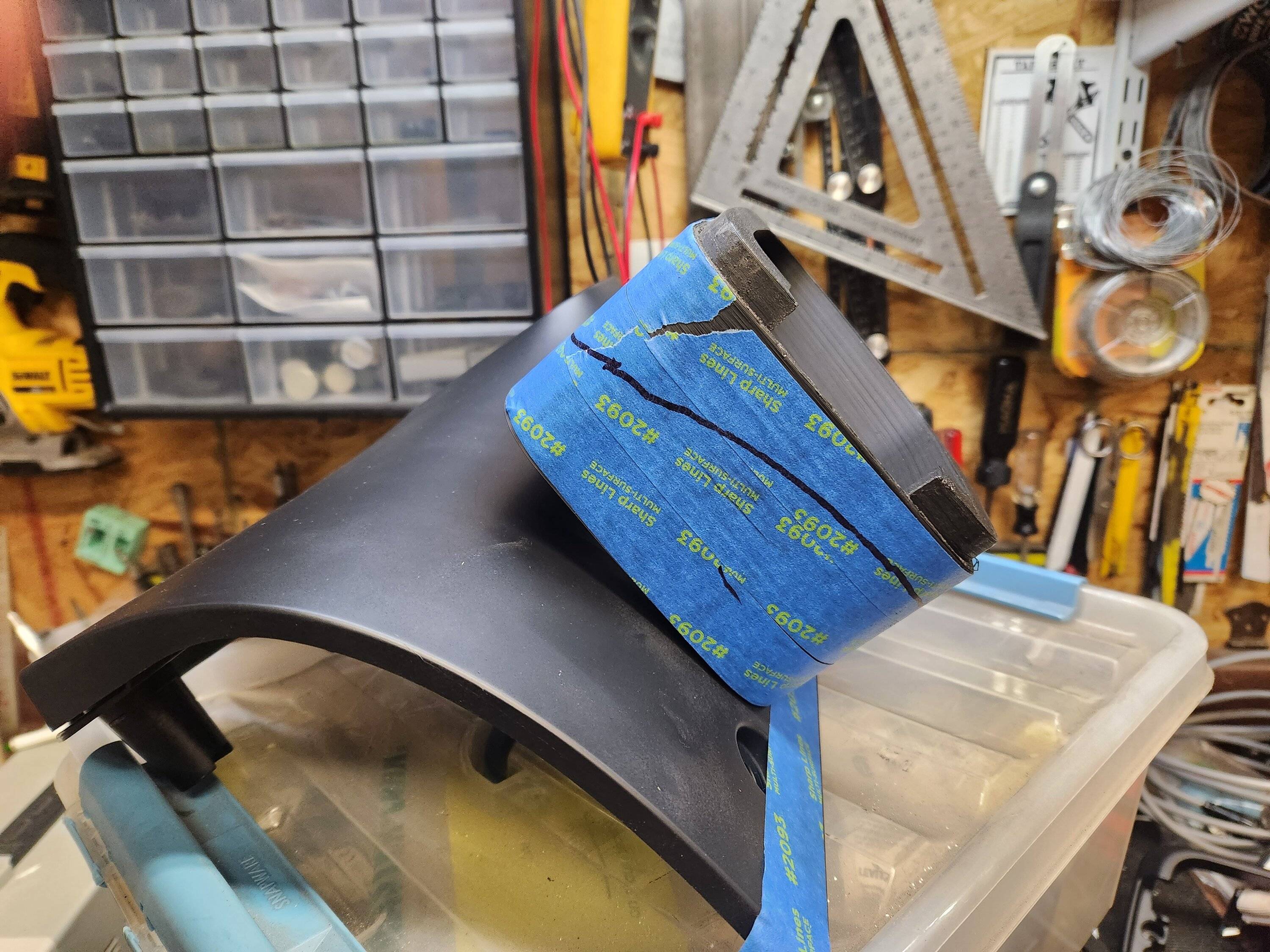

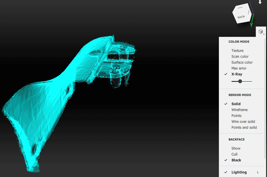

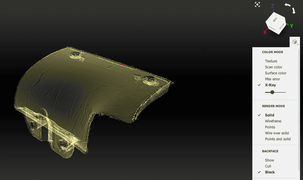

progress .... This is the first time that I have hated my paint choice (granite crystal) .... things that make optical scanning more difficult ... dark colors, specular reflection (e.g. metallic flecks in paint), shiny ... really, really wished that I was working with a white cowl ... some blue painters tape made the above possible
b-roc
Broc
Aug 28, 2020
318
481
Denver, CO
2021 JTM
driver's side was faster since I skipped right to the blue tape
Now to put my truck back together ... damn does it whistle at highway speeds without the cowls!

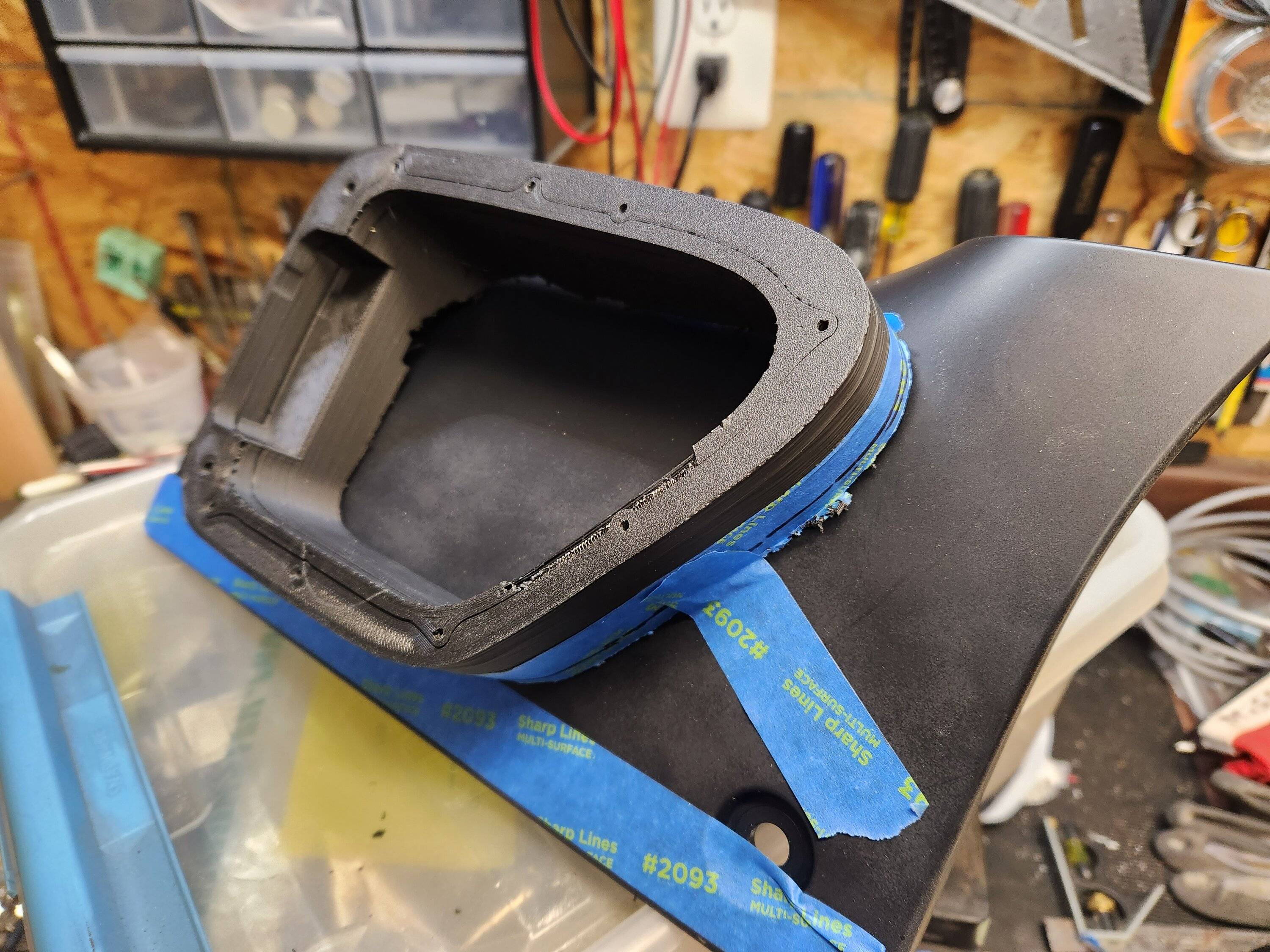

Just came across this thread, this is something I've been wanting to do as well.
Currently my goal is to get air, winch connector and a switch for my scene lights.
I bought a Mojave cowl, 4xe door a while back and I've been messing around in CAD with a design for "merging" the parts.
I did a preliminary print to do some initial mock ups to figure out how I wanted to place the port...
I'm using PLA for the mockup, but I will be (probably) using ABS for the final part. Possibly CF, but not sure yet.
Let me know if the mojave cowl scans that I have could be helpful... happy to send them your way
