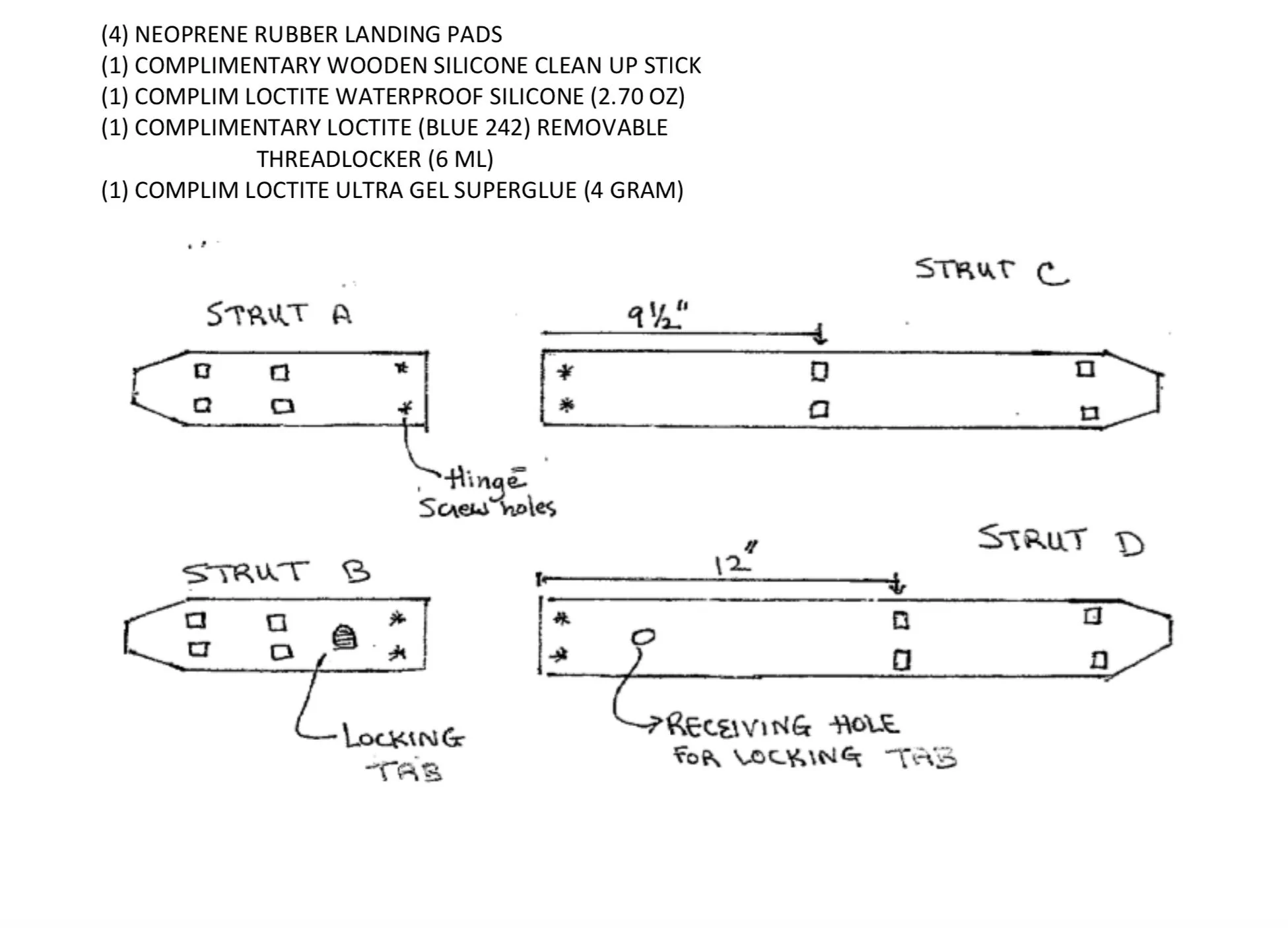

I totally get the convenience, but it's also going to kill any ability to trade or resell that hard top if you want to later on. Beauty of things like the Sunrider is that they are reversible. For me, the ability to undo whatever I've done is worth it.
This kit requires you to get things perfectly aligned, drill holes, and if you end up being off on those alignments it's going to be all sorts of weird to use. That might be okay for some folks, but for me that's a lot of risk for something I can't undo. On an older Jeep? Sure. But not on ours, not yet anyway.

I get why someone would come up with this type of solution. But there’s no way I’d be drilling holes into my freedom panels. As someone else mentioned if you get the alignment of the hinges off by even a little bit it’s gotta be extremely awkward to use and probably won’t seat right again.

I've got some thoughts.
Improvements:
1) locking the hinge doesn't keep the top from bumping. The hinge has very little leverage. You need something at the "front" edge of the top (now the rear most edge) to hold it down.
2) You need some kind of rubber bumpers or stand offs to keep things that shouldn't touch from touching
Questions:
1) what are the hinges made of? How are they coated? Will they rust? Will they produce rusty water that runs down the side of the jeep when it rains.
2) are the attachments just screwed into the fiberglass or are they through bolted? What is the chance they will not work loose if they are just screwed into the fiberglass?

It's a novel idea, but executed pretty crudely. Instructions, drawings, etc. are crude as well. Everything needs refining before I drill holes in my roof.
Also, if I understand the installation correctly, the deal breaker for me is that you lose the ability to remove the freedom panels completely. You can ONLY flip them back. Perhaps a solution would be to come up with removable hinge pins, but I do not think what's provided now has that feature.
Someone who really wanted to drill into their roof for this should be able to find hinges that use a cotter pin, or even a bolt like our doors.
Mad respect to anybody who starts their own business but I agree with you. Great concept needs more refinement and start with the instructions.
