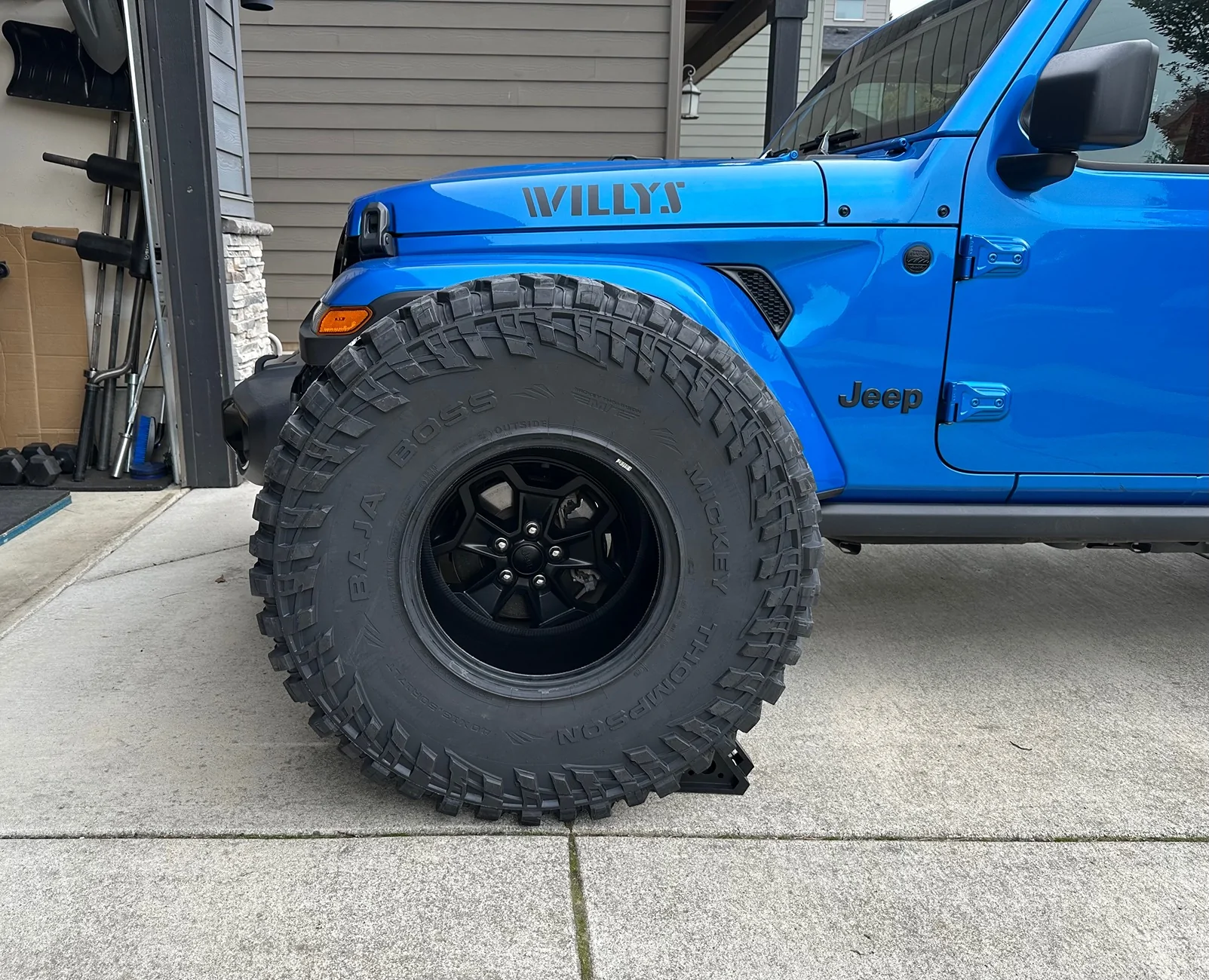

Who is running 40s on narrow track axles? I’d like to know how close your tires get to the front lower control arms at full steering lock.
I’ve had some conversations with people who’ve done it and I’ve gotten mixed responses. Some say it rubs, some say it doesn’t. Depends on wheel specs I know, and also whether or not their lower control arms have any lateral bend for clearance (like the factory arms). Most people are running 17x9 -38mm/3.5 BS with 40s so I’m gonna guess the lower control arm design might be the difference between rubbing or not rubbing. And before y’all tell me not to do it…. Too late. It’s happening.

Jokes aside, it’s because I don’t have wheels yet. Also trying to make a decision on which control arms to buy and get a lift installed soon.

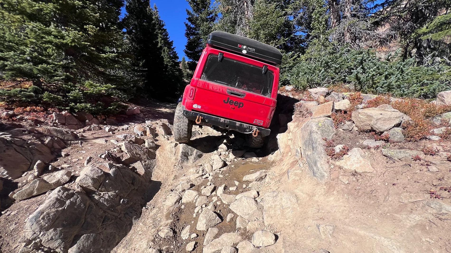

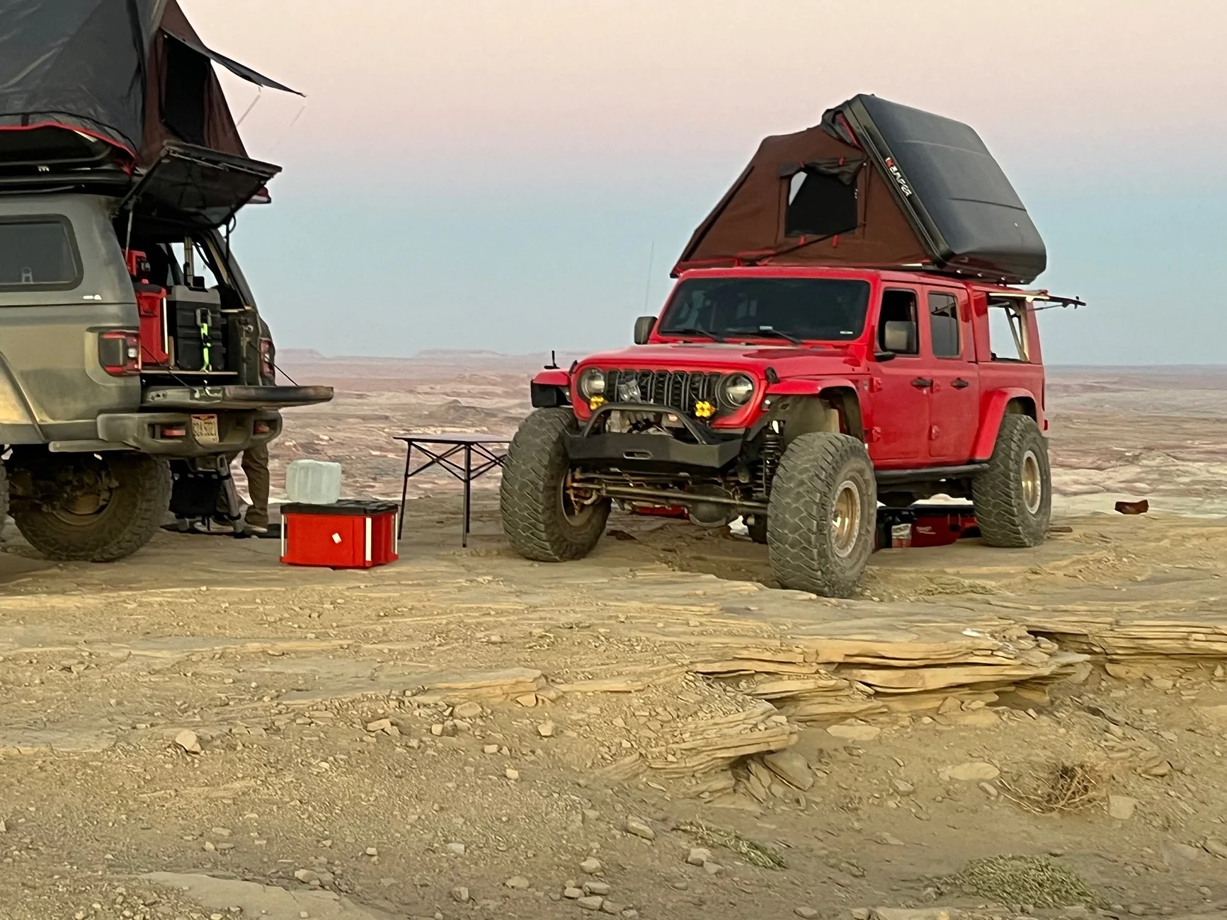

Hell yeah. Love it. I have some questions:
Did you need wheel spacers for clearance? Does it rub at full lock? Which front lower control arms are you running?
3.5” backspace wheels / no rub / rock krawler
