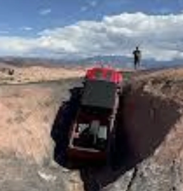

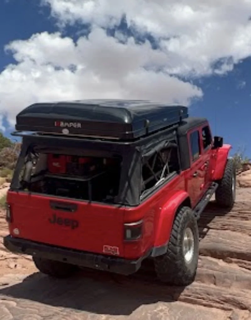

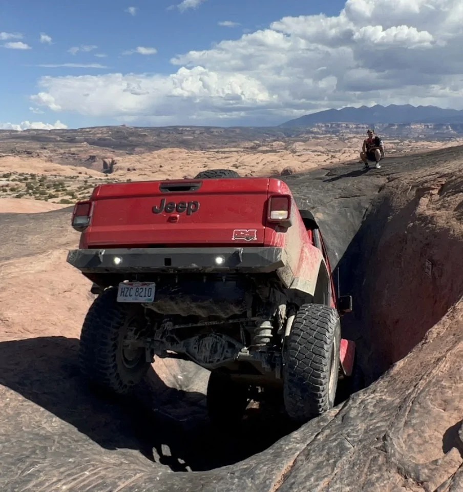

I’m at 2” added bump up front / chopped rubi flares - narrow - 40”. Gets wheeled😁
Jeep Gladiator 40s on narrow track axles? IMG_5888
Jeep Gladiator 40s on narrow track axles? IMG_5889
Jeep Gladiator 40s on narrow track axles? IMG_5890
Jeep Gladiator 40s on narrow track axles? IMG_5891
