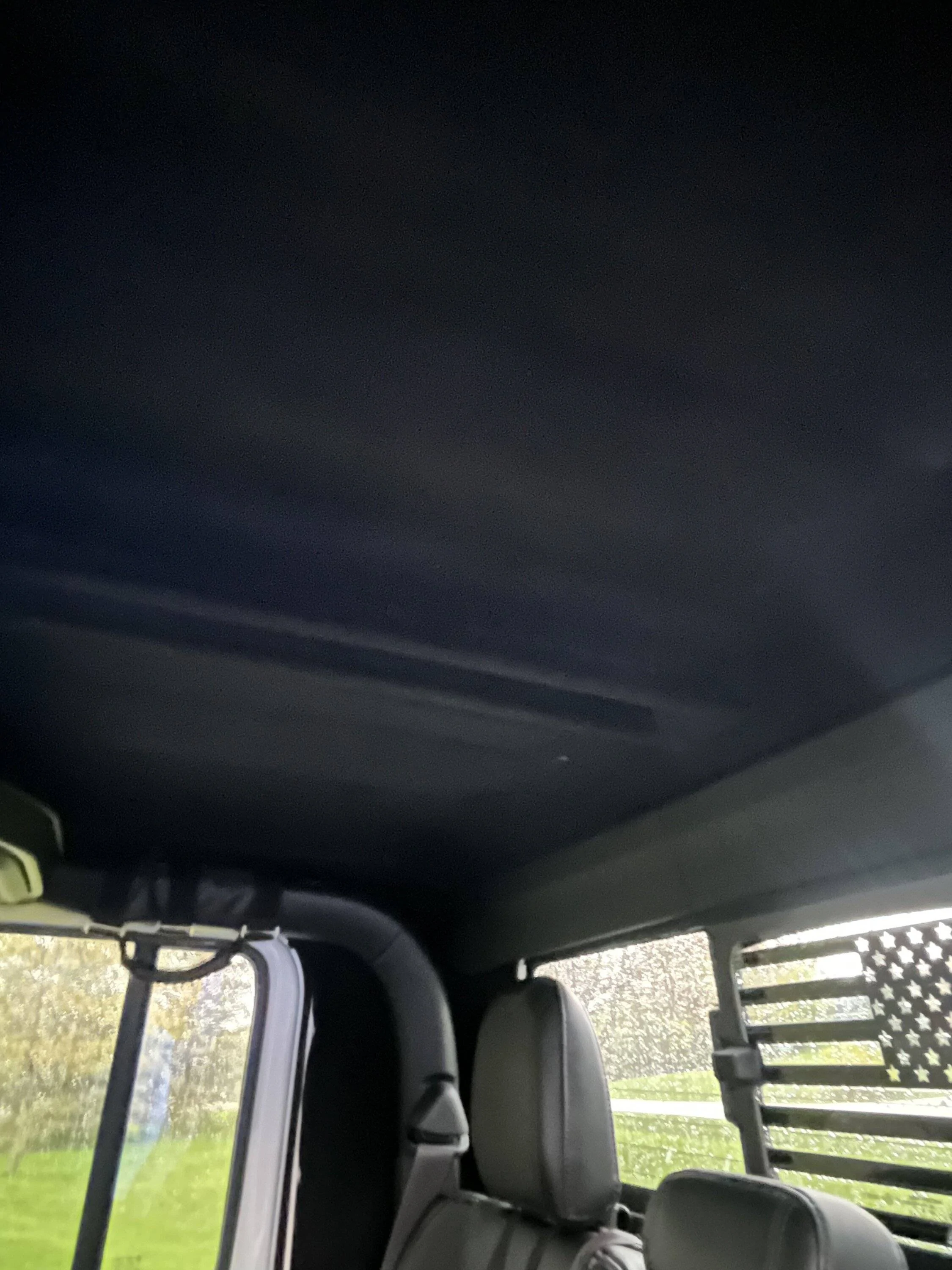

My coverking headliner came today and thus far, love it. Sound deadened the entire cap. Went from 70-72 decibels to 65 @ 70 mph.
Jeep Gladiator Coverking headliner installed with sound deadening material. Lowered sound decibels in cabin significantly 2A2071D0-95DB-4263-99BE-2C16F3F1B2FD
Jeep Gladiator Coverking headliner installed with sound deadening material. Lowered sound decibels in cabin significantly 05B50801-CB12-4DE4-A98C-B465F8BA7997

I only see 2 pictures of the sound deadener. Any pictures of the finished product?

I’ll get some better pics but here’s a couple. It really gives the interior a more finished look, the stereo sounds better and wind noise is reduced from the top of the freedom panels. It wasn’t a perfect fit after the sound dampener was added, but it’s pretty close. I’m going to pull the entire interior out and sound dampen the floor and doors.
Should make a huge difference in road noise and make business trips with colleagues a bit quieter.

Interesting results. Thats a significant improvement.
Side note. As long as the predominant scent when opening my doors remains the off-gassing of poly or vinyl ester resin from the composite top, I could live with that look and be satisfied. I might still have my wife throw some shag carpet or something equally classy over it, just to try and keep up the refined pretense.

Posted before seeing your pic. It does look impressively well done. I might say even better than shag.
I’ll retest today but based on drive #1 it’s a big improvement, no more echo chamber off the hardtop. They say 2-3 decibels down with just the headliner so I think the sound dampener made the difference. Took 5-6 hours to do everything.

One other thing. I did have almost full coverage of the sound dampener on the freedom panels too. That pic wasn’t the finished coverage. I figured if I’m taking the time to do it might as well do it right!

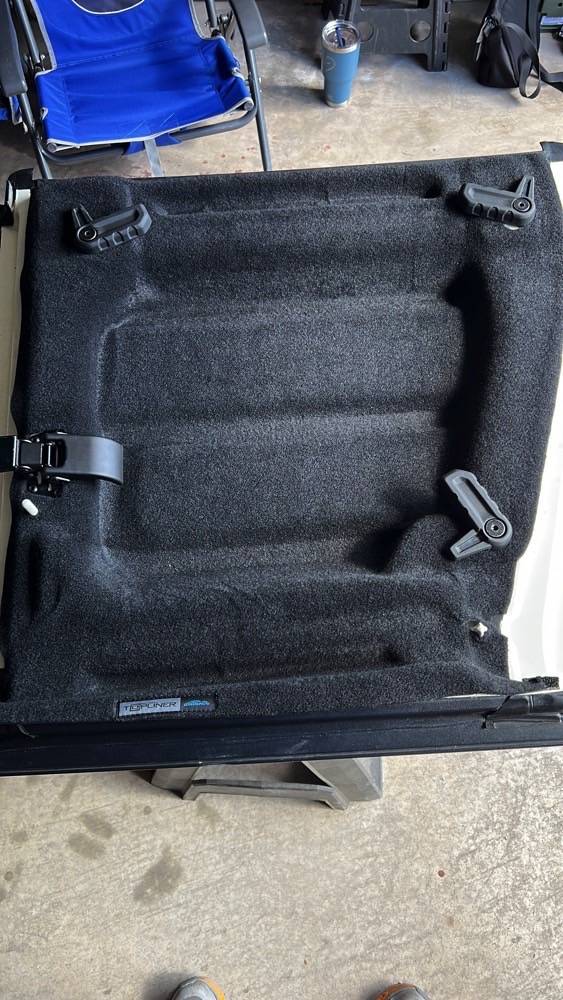

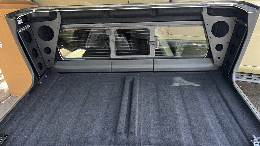

Not to steal thunder but I will echo the OP's findings. I did the same thing about 2 weeks ago and the results are perfect. I wish this was a factory option. Here's some pics. Mine was a bit more complicated than than @Mflowers11 only because I had to make things fit with the Rhino Rack Back Bone bits and bobs.
I covered everything although this picture doesn't quite show it. I used painter's tape to make forms to cut the Boom Mat to:
Jeep Gladiator Coverking headliner installed with sound deadening material. Lowered sound decibels in cabin significantly 06_HardTop01
Definitely worth buying the rollers to use to tamp down the sound deadener and the carpet. I used extra 3M VHB tape to get more adhesive coverage than the provided adhesive:
Jeep Gladiator Coverking headliner installed with sound deadening material. Lowered sound decibels in cabin significantly 06_HardTop02
Now the Back Bone complications:
Jeep Gladiator Coverking headliner installed with sound deadening material. Lowered sound decibels in cabin significantly 06_HardTop03
Jeep Gladiator Coverking headliner installed with sound deadening material. Lowered sound decibels in cabin significantly 06_HardTop04
Looks pretty good and the off-gassing smell only lasted a day or two.
Jeep Gladiator Coverking headliner installed with sound deadening material. Lowered sound decibels in cabin significantly 06_HardTop05

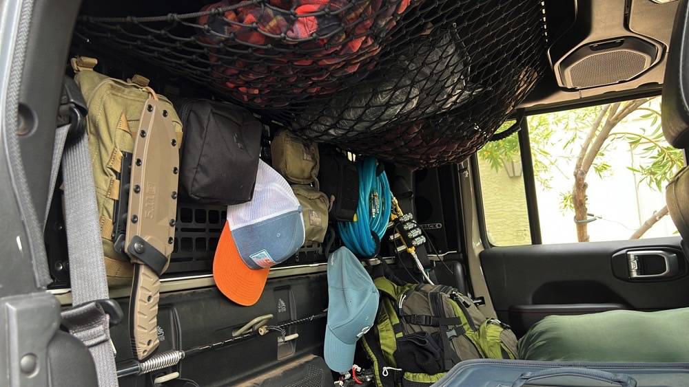

Not that you can see the TopLiner once my molle panel and attic were reinstalled:
Jeep Gladiator Coverking headliner installed with sound deadening material. Lowered sound decibels in cabin significantly 07_MollePanel02

OK, come and do my wife's JLU now and if that turns out, might turn you loose on my JT.

What did you use to make that attic?
