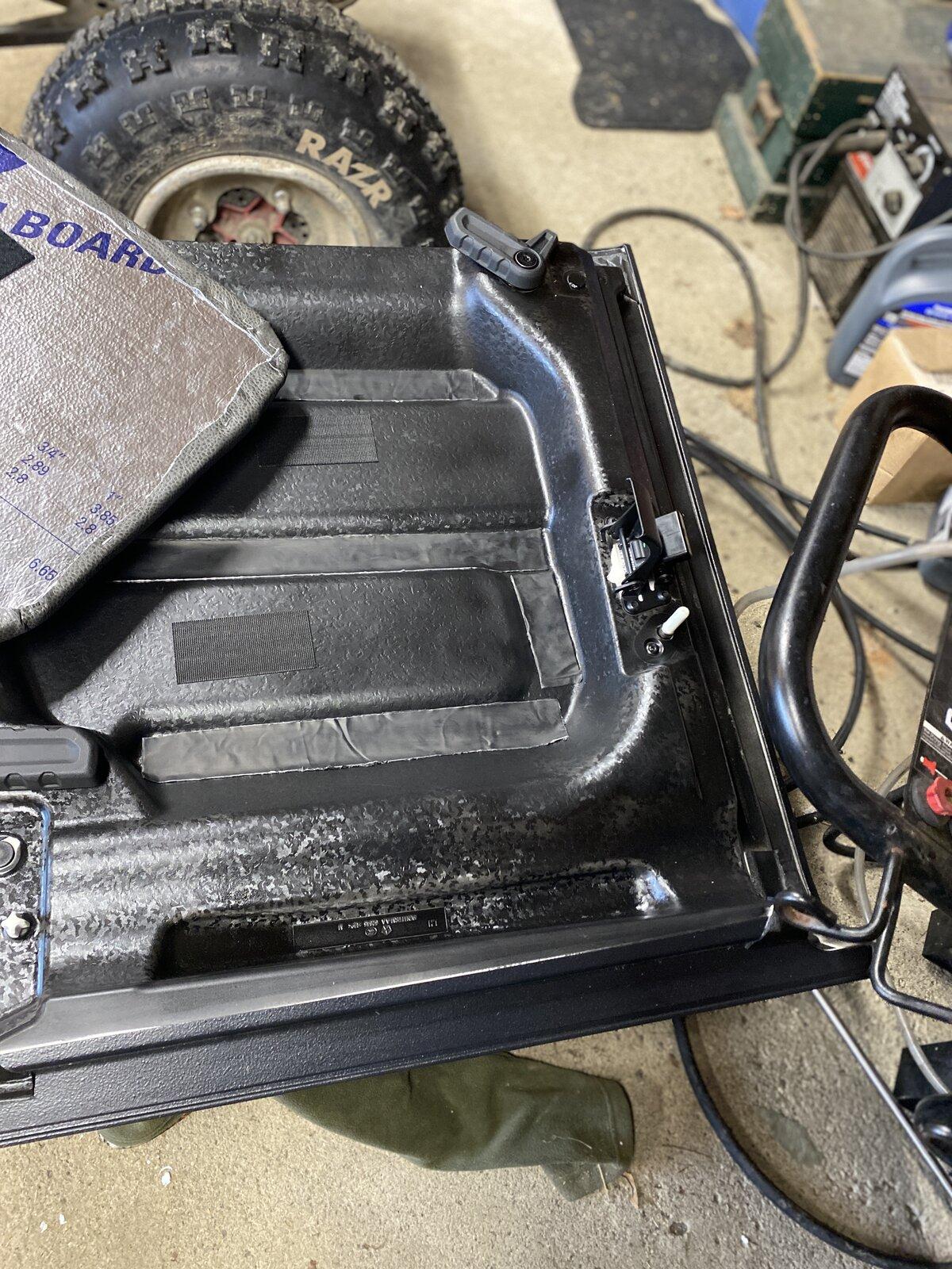

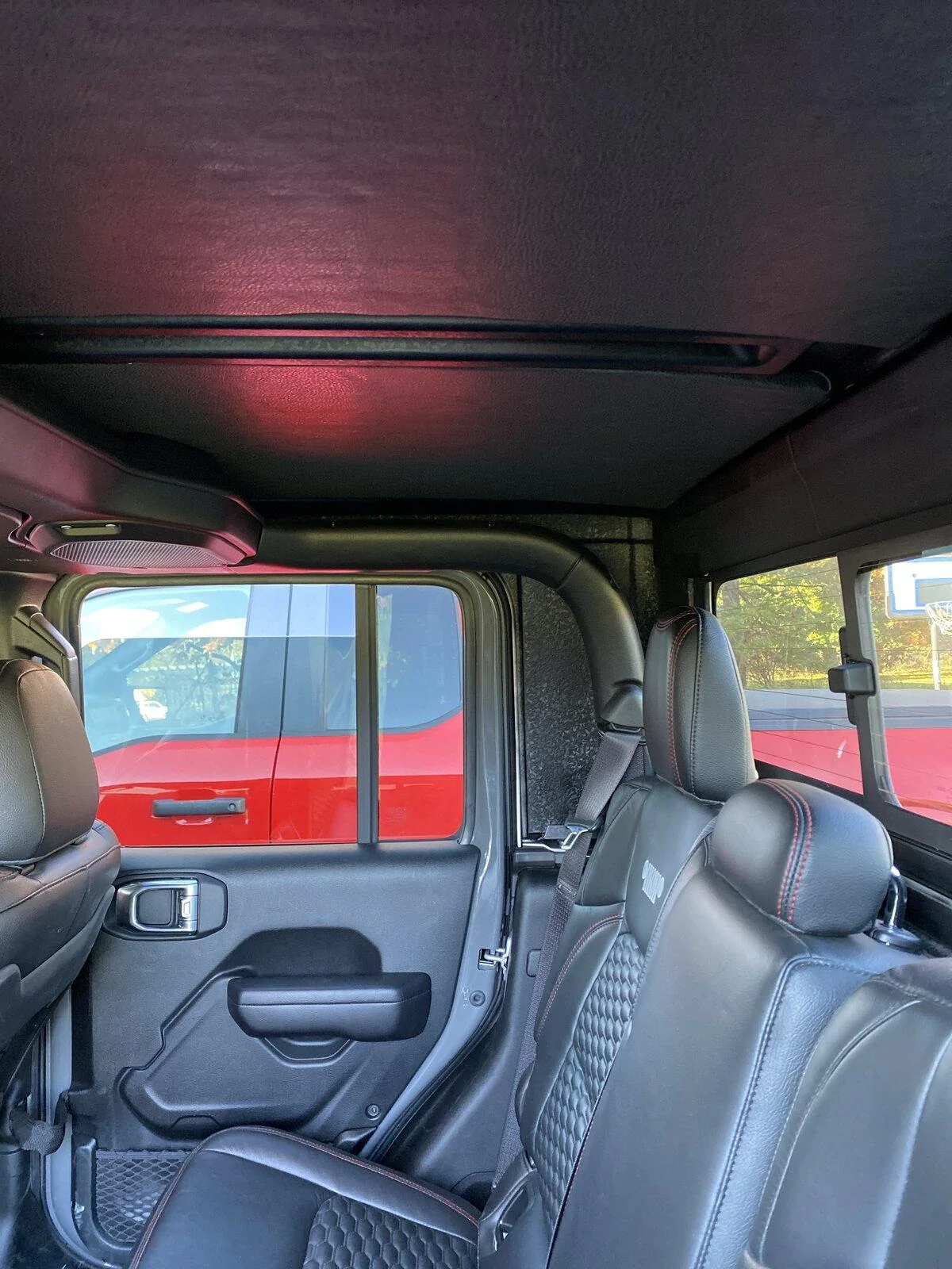

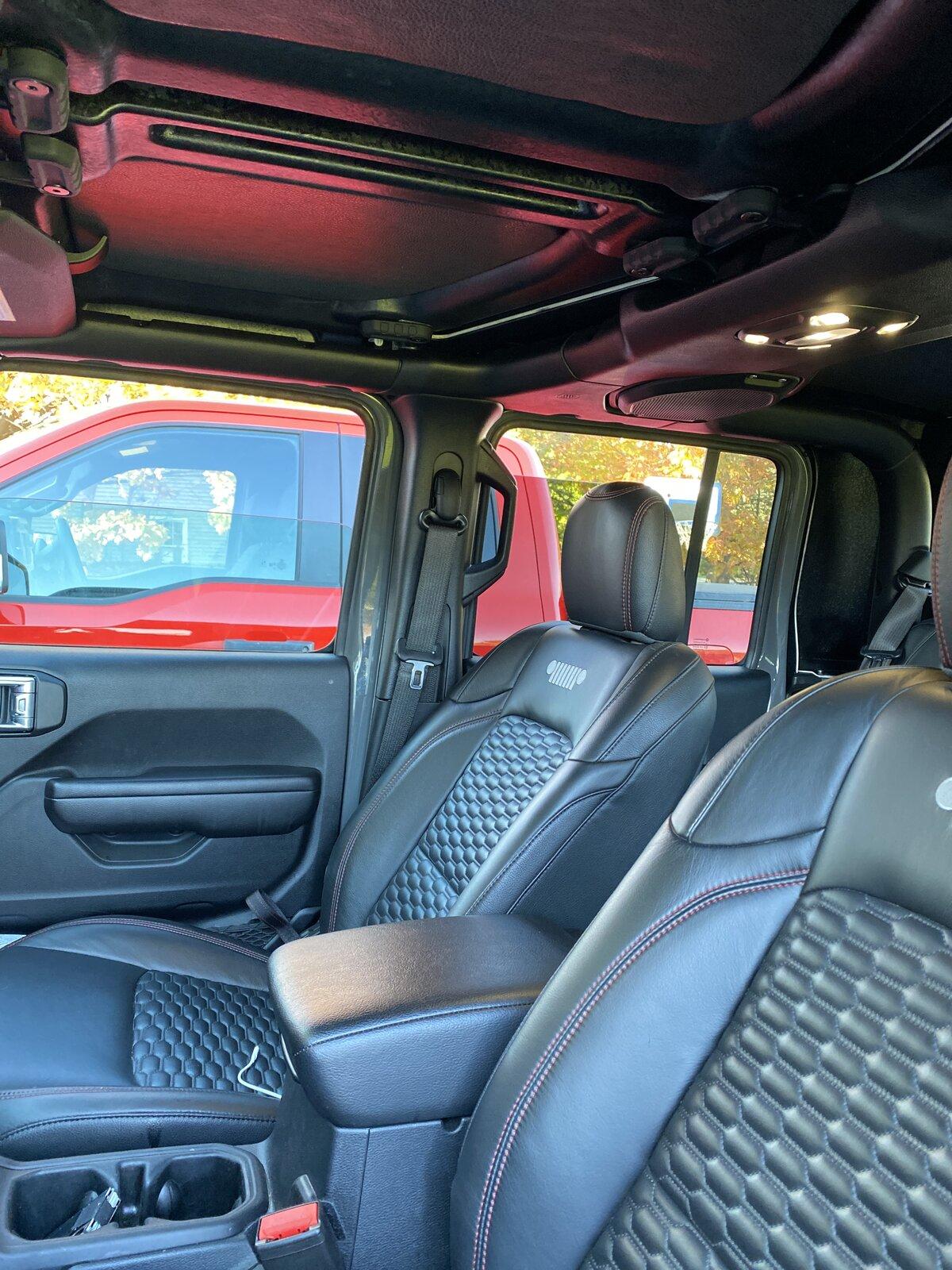

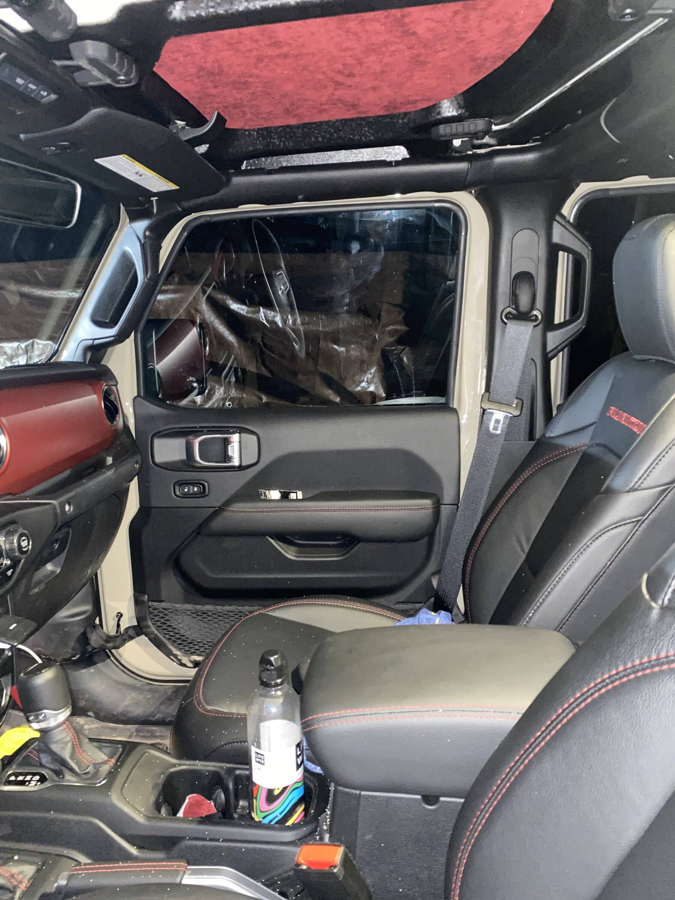

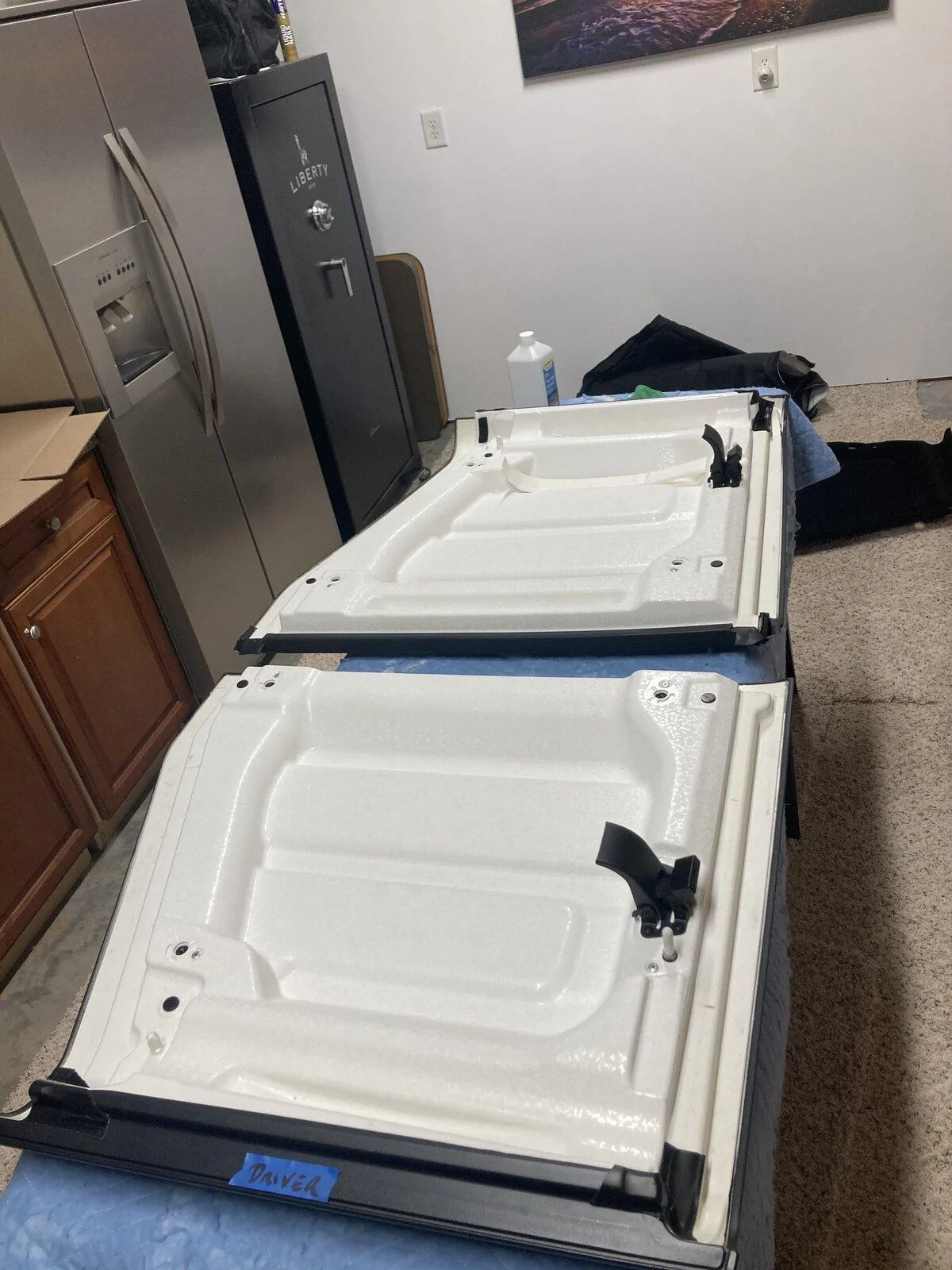

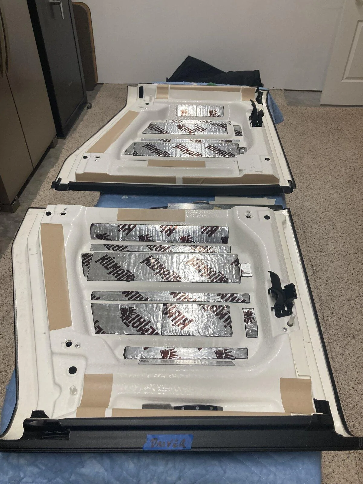

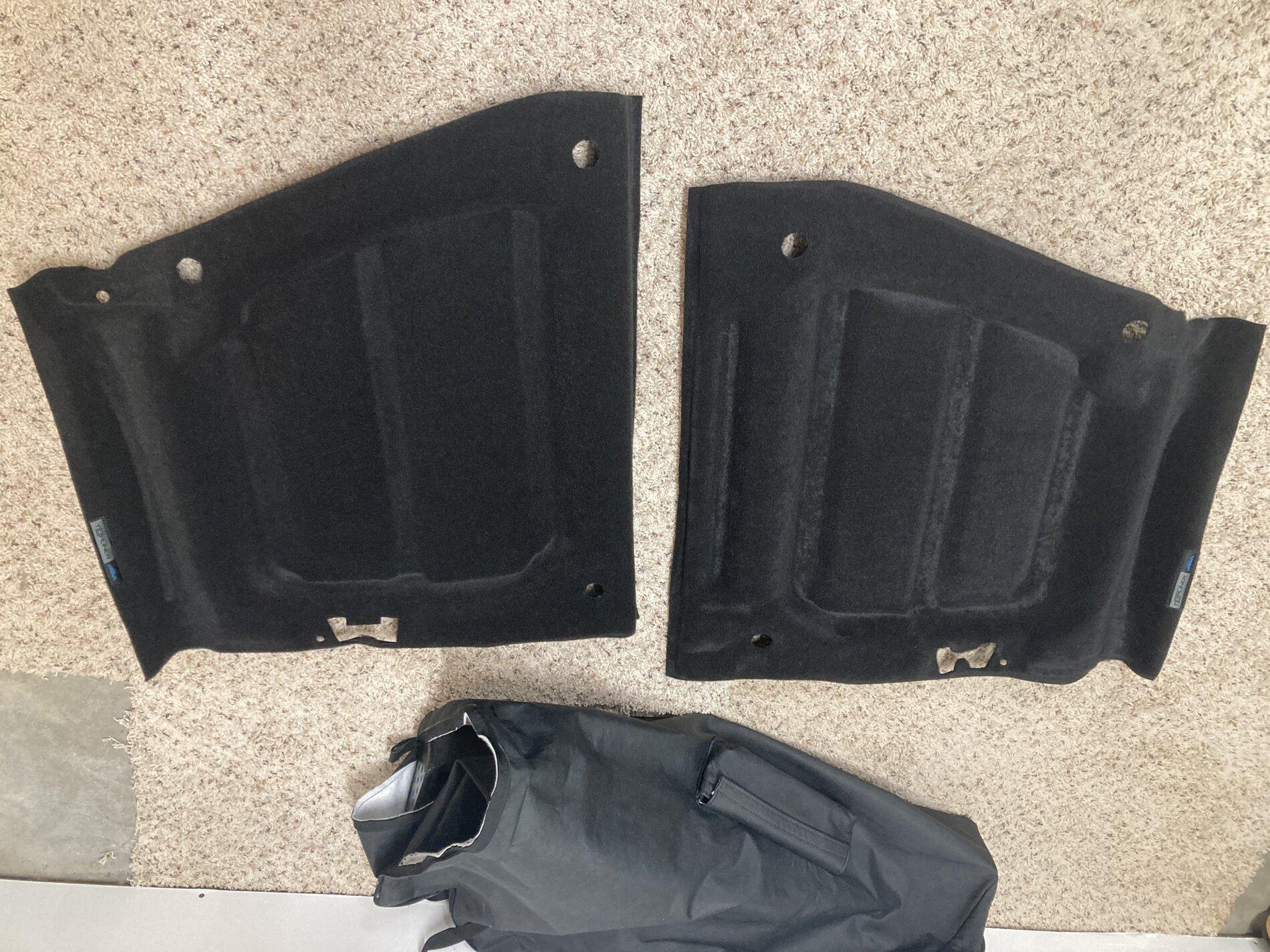

I built my own headliner, painted the freedom top and put sound deadener on the panels. I had some second skin laying around from a past project. Sound system sounds better an road noise is reduced

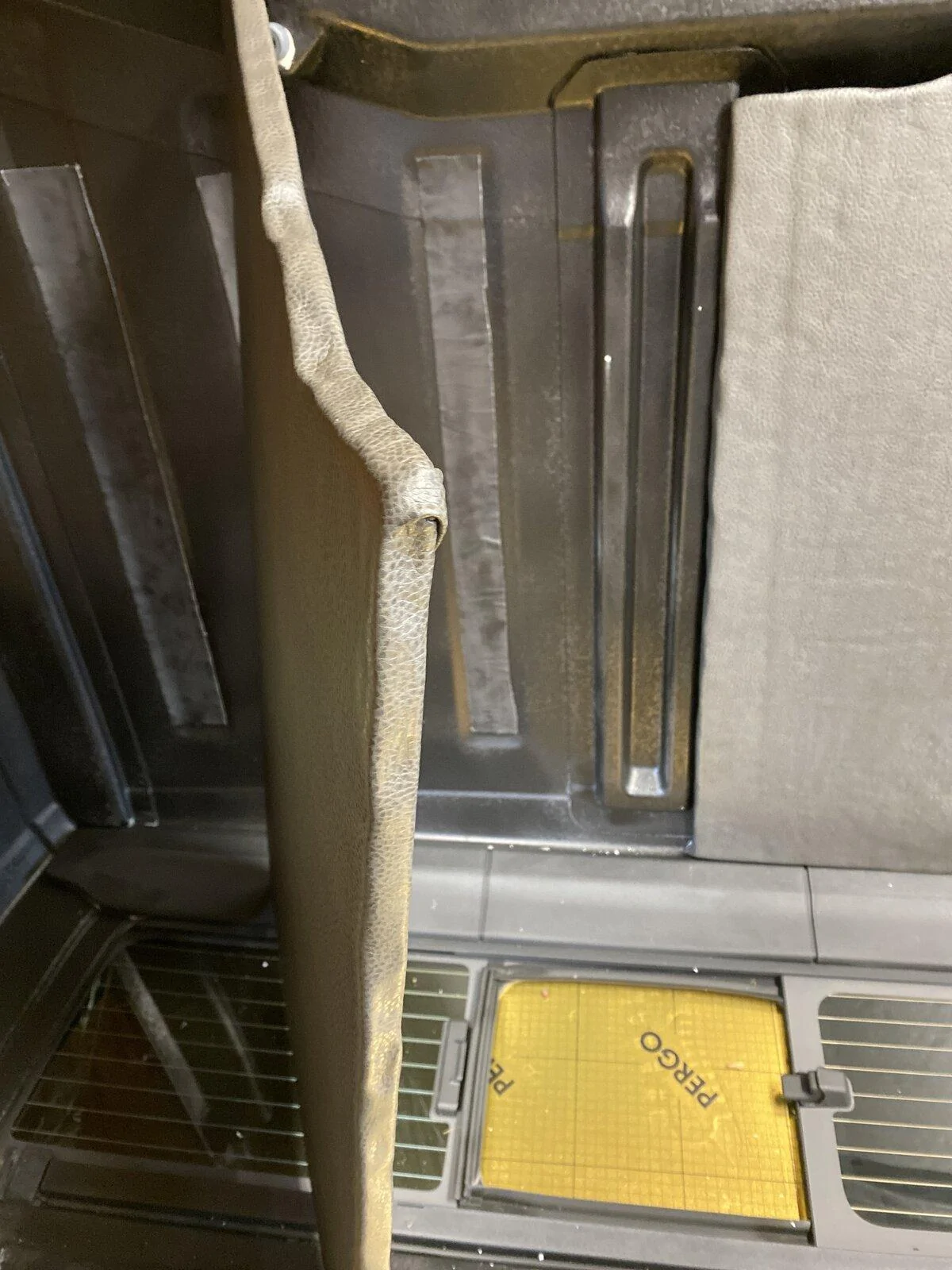

New Jeep similar treatment

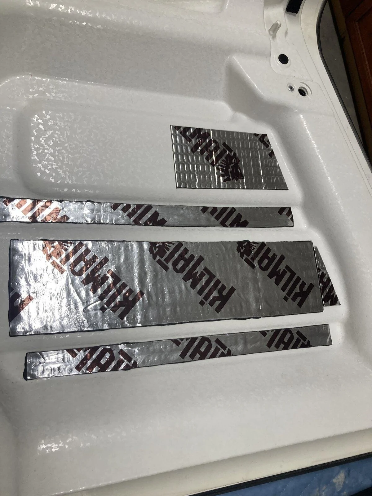

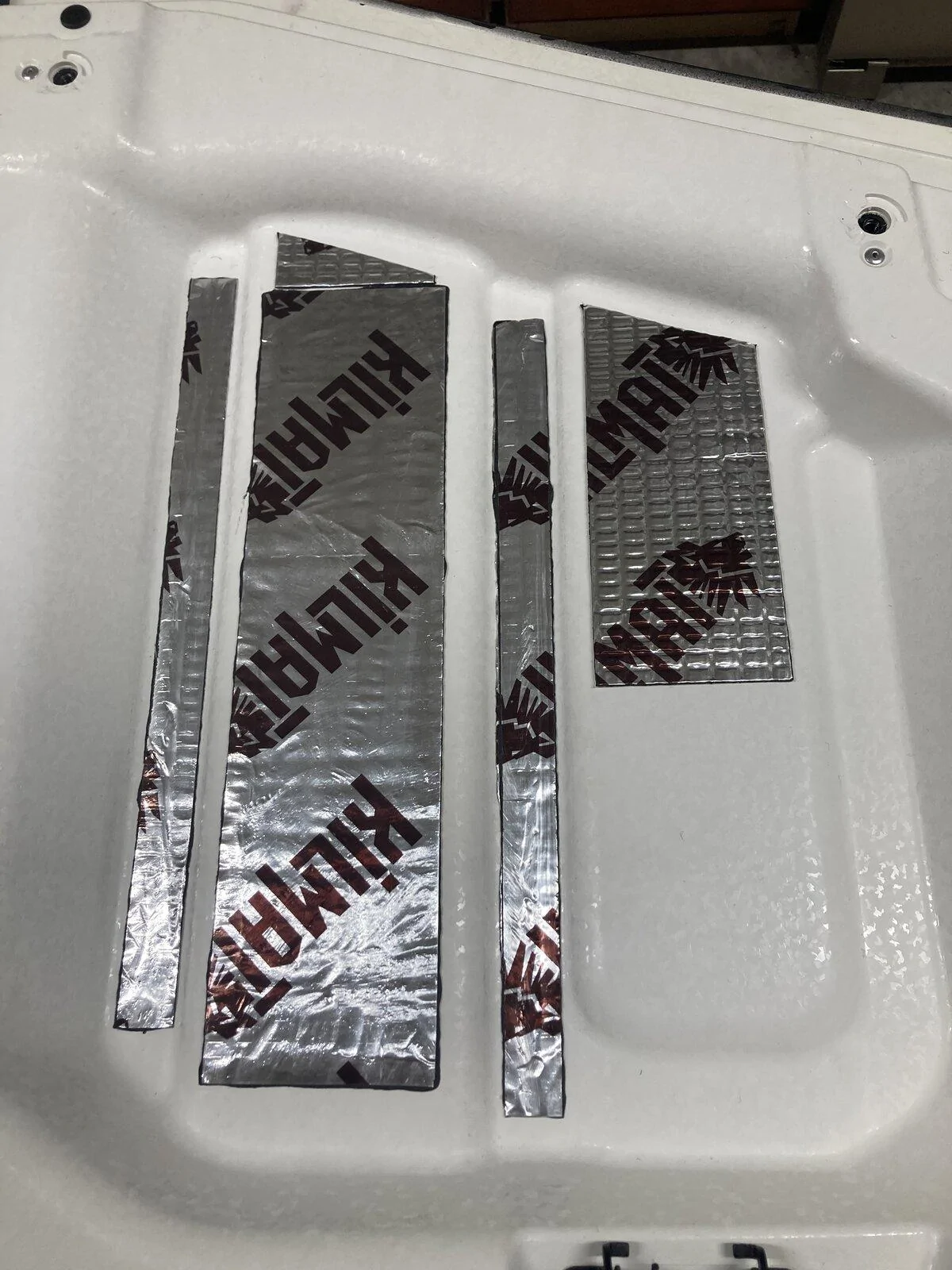

[edit] By the way a quick wipe with acetone or xylene will remove the killmat writing on the material. [/edit]
So I did my entire hard top both wings and the rear cap in killmat, like every square inch, had to buy new compass and sxm antenna that I mounted to the cowl panels because the killmat blocked their signal.
I also finished them off with black sound absorbing paint. Honestly it looks like shit, overlapping joints inconsistent thickness, nothing IMO really bad it just looks like a guy did it in his garage. :)
Point is it rocks, not only does the killmat block out and make the panels far more solid for the road noise, it blocks a ton of the radiant heat and cold those panels used to ignore.
I would do it again in a heartbeat. I might snap some pics tomorrow for show and tell.
I have tried twice to cover the panels in headliner but I have quickly found out that most of the headliner adhesives contain a solvent or two that just melts the sound paint and doesn't allow anything to stick to it so yeah just rocking the rattle can look for now. Honestly as many people have been in the jeep they don't notice it.
this was the paint, prolly useless but I wanted black to cover the silver killmat so why not use sound deadening paint.
