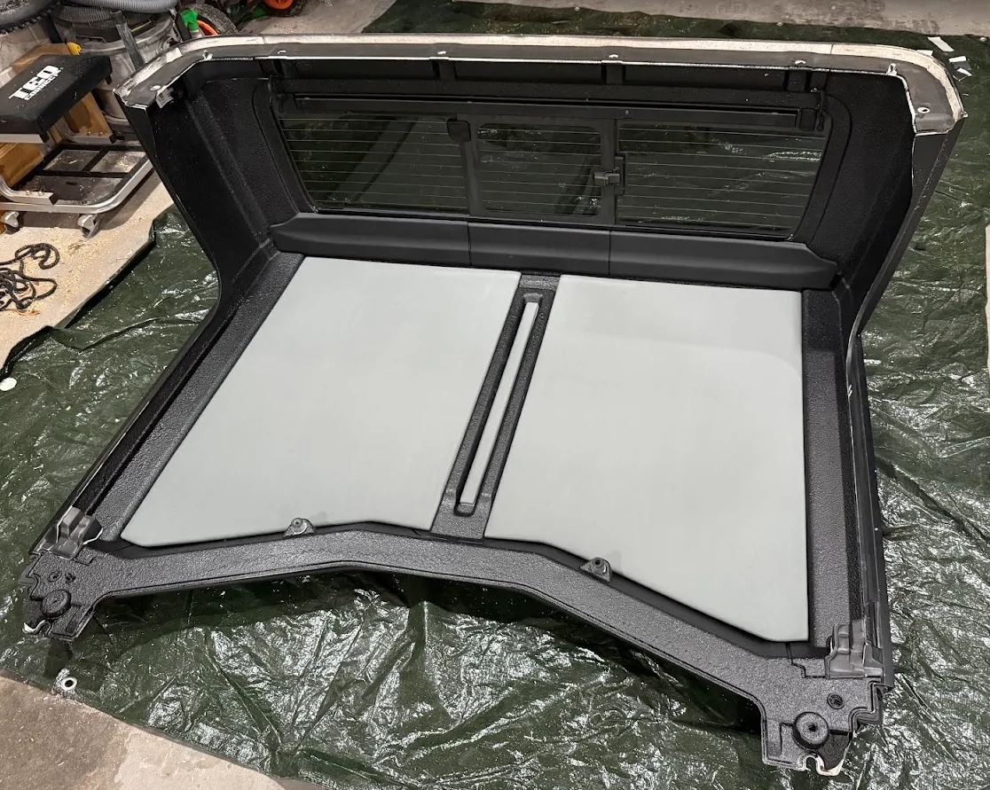

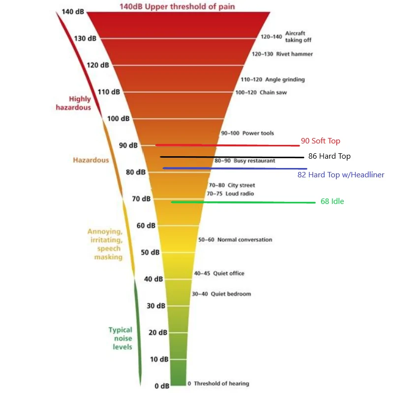

Following up on this thread, I decided to take a road trip and grab a used top from Alabama. I used the trip as an opportunity to test sound levels. Keep in mind idling registers at about 68-70 dB, so you can't really go lower than that.
All the numbers below were at the same speed, on the same road, with minimal cross-winds:
Soft Top: 88-90 dB
Hardtop: 84-86 dB

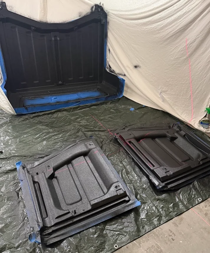

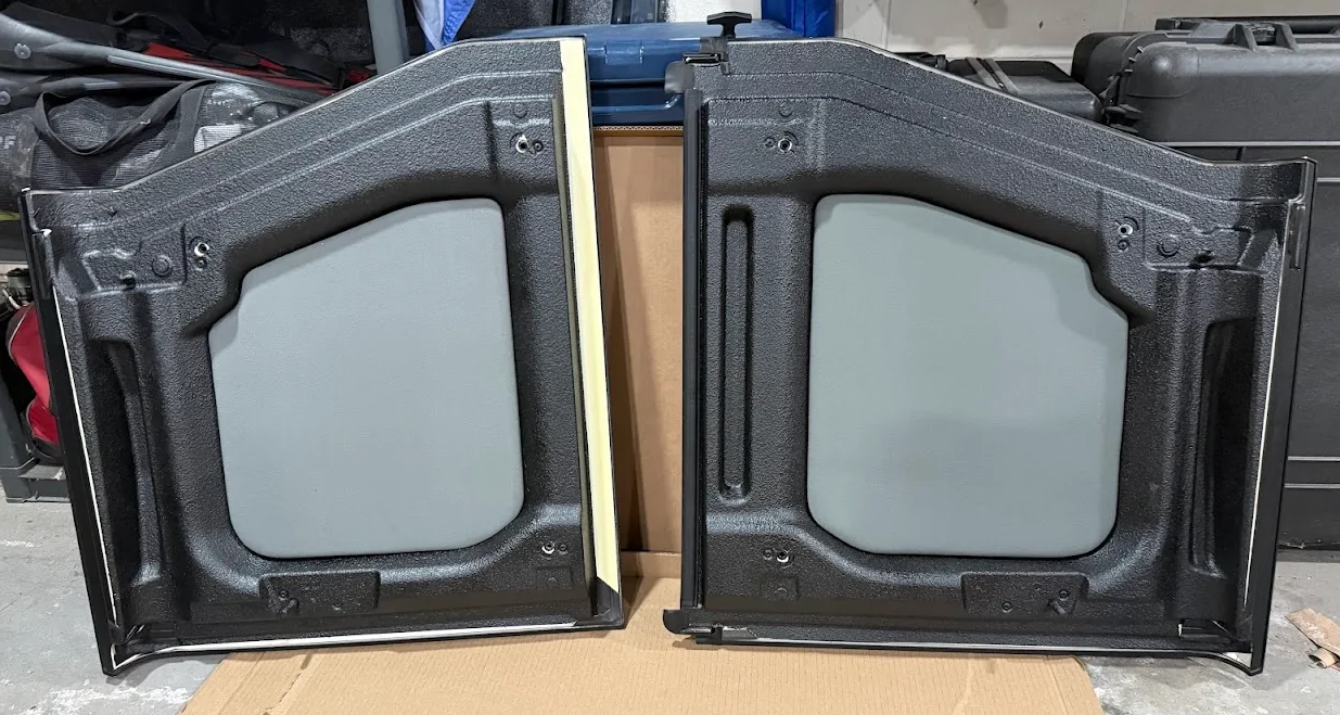

I then took what @starrskream did with the Boom Mat spray and re-did the interior with that, Hothead Headliners, and the Sound Assassin strips (see photos below). That brought it down to about 80-82 dB!
DISCLAIMER: This was measured with a cell phone, which is inherently inaccurate. Use as reference only.
Jeep Gladiator Hard-Top Sound Reduction vs. Soft Top 1762363554981-0v
Worth noting that although raw dB may not look like much, it's not a linear scale, so 90 to 80 is a LOT more than 80 to 70. Also, it doesn't consider the frequencies that get suppressed, and I can tell you that the ones it does suppress make for a much nicer in-cab experience.
Here's the sound dampening I did. 2 layers of Boom Mat on the entire top, plus the grey Hothead Headliners over Sound Assassin strips. It was a weekend worth of work, but paid off in my opinion!
