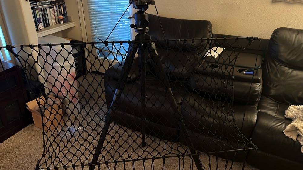

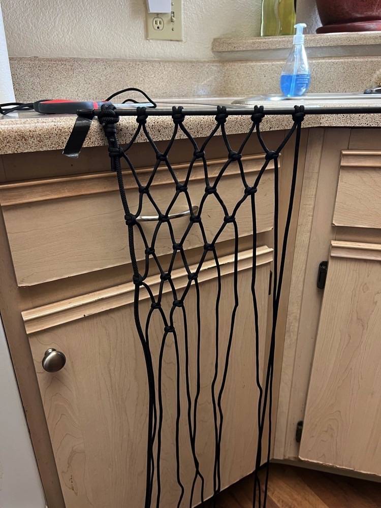

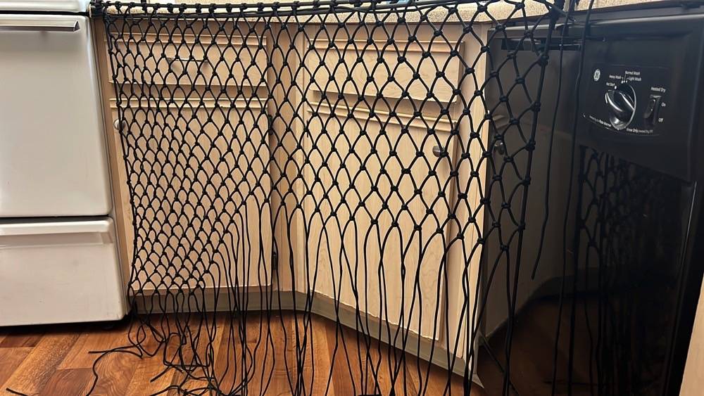

@RedBearon I figured I throw some pics in for you now that I'm back from the wild.
Old carbon fiber tent poles cut to the correct length to span the back of the Gladiator. 6mm rope to provide a non-stretchy end and to attach the paracord to. Start weaving (there are a lot of YouTube videos on how to weave a net, just have to find the style you like):
I wound up attaching the rear pole to my Rhino Rack Back Bone and the front is tied off to a couple of bolts on top of the roll cage.
Hijack complete....

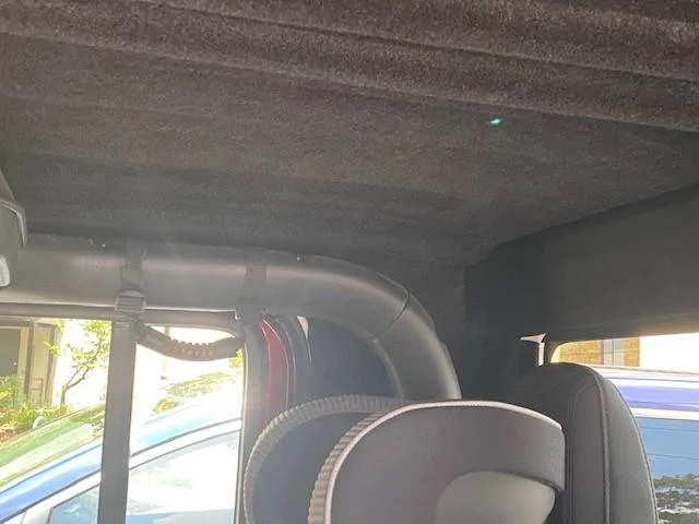

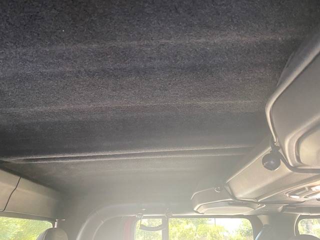

I've had the Coverking headliner in for almost 2 years now and it has helped not only with sound but also with temperature control in the cab. Also noticed that my music sounded better with the headliner installed. I agree with the OP that the directions need some work. Extremely thankful for You-tube in supplementing the directions.
