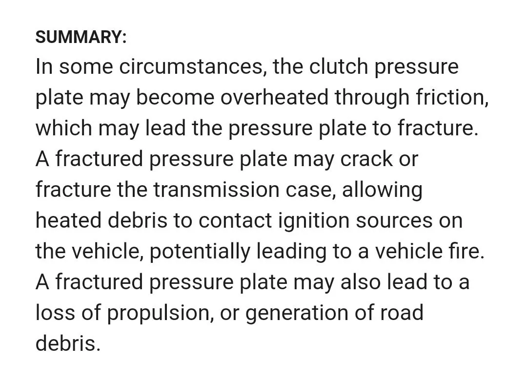

I anyone wants to join the sister forum and dig further in regards to this specific issue. It's free. Yes, the clutch / pressure plate can overheat and grenade. There has been more than 1 documented incident.
I'm sure it can. On this side, all I'd seen was a lot of folks burning up the stock weak clutch. I wonder if this particular Jeep was ever in for the recall or not? I had planned going Centerforce or SB if/when the stock clutch goes out on mine.
