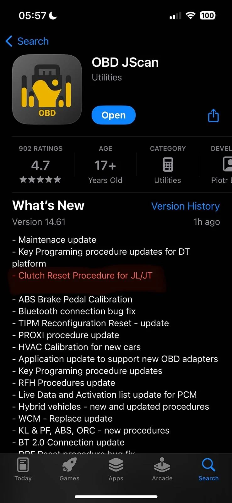

JScan update is out!
I just reset mine and service transmission light gone. FYI ?

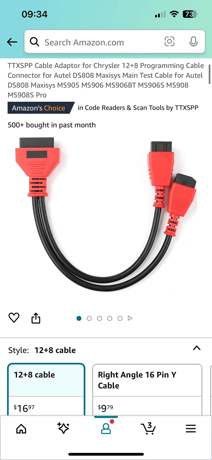

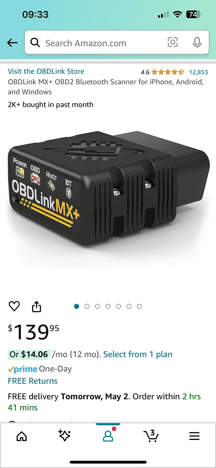

Hey Birds, where did you buy your jscan?
Birds83
Nick
Sep 27, 2023
239
164
Richmond
2023 Gladiator Mojave & 1997 Jeep TJ
Purchase the adapter and Bluetooth scanner from Amazon and then you down load the app JScan and it’s $20 for the license for your vin.
