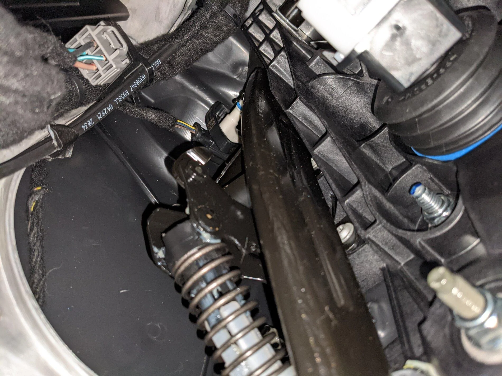

Any chance you could take a pic of the general area where I should look? My symptoms are the same ish, without any codes.
This is the best picture I could get, looking up along the clutch pedal I assume it's the small connector with brown/blue/yellow wires. I didn't see anything on the engine bay side of the firewall that looked promising. In hindsight, I should have asked the dealer tech to show me exactly what he did.
I would locate that plug and give it a firm press to see if that helps.
Let me know how you make out!
Hi SillyWilly's,
Thanks so much for this picture! I wouldn't have asked if I had known how difficult it is to see in there! I appreciate it. I did get up in there, and things seem solid. This whole thing is so weird. It's crazy that this problem isn't getting any worse. It only doesn't start about once every couple weeks. This most recent time (Saturday), jumping it didn't work. I happened to have all my JScan stuff on me, so I went in and changed a random setting, then changed it back. Coincidence or not, that did the trick as it started right up. Been fine since. I have another appointment at a different dealer the Monday after Christmas. We'll see. Anyway, thanks again for your efforts!
