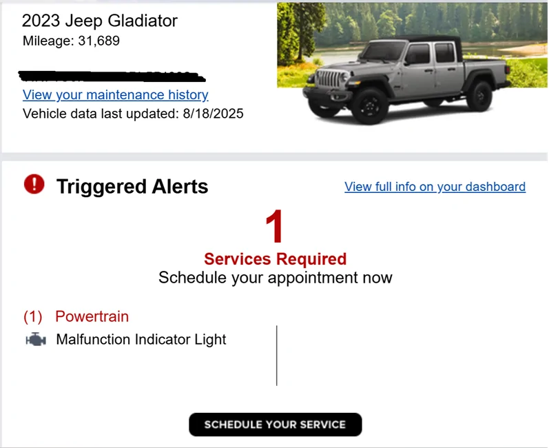

well I'm stumped looked at my jeep app to see what warranty I got left it said I have power train & basic. here a pickle for you to ponder after battery installed checked volts down to 13.8 okay now auto start/stop still said not ready, so I drove it hard for hour. and come to last stop light the dang thing came on then after that it didn't, but no check engine light. and I get an e-mail from mopar jeep service saying vehicle malfunction issue with power train with the check engine light icon on it, to call my dealership. I'm like really think you're a bit late about the check engine issue. lol. and according to my jeep app everything okay far as Maintenace goes. well at this point ugh guess I have them check it out knowing my luck they need the car for a few days. so it seems to work when it wants to after driving for a hour or more then it goes off again. it seems to be stuck on stupid =)

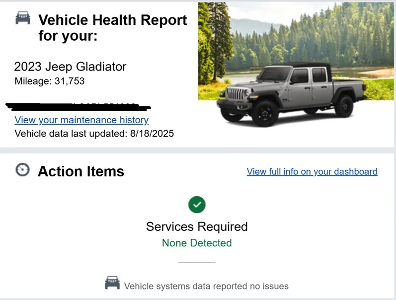

All icons are there. Apparently this morning it was working again like normal. No errors only thing I noticed was the voltage drop to 12.8 which is still good. Yesterday it was 13.8 which could have been from the long driving. See how it goes. Guess it needed to figure itself out
