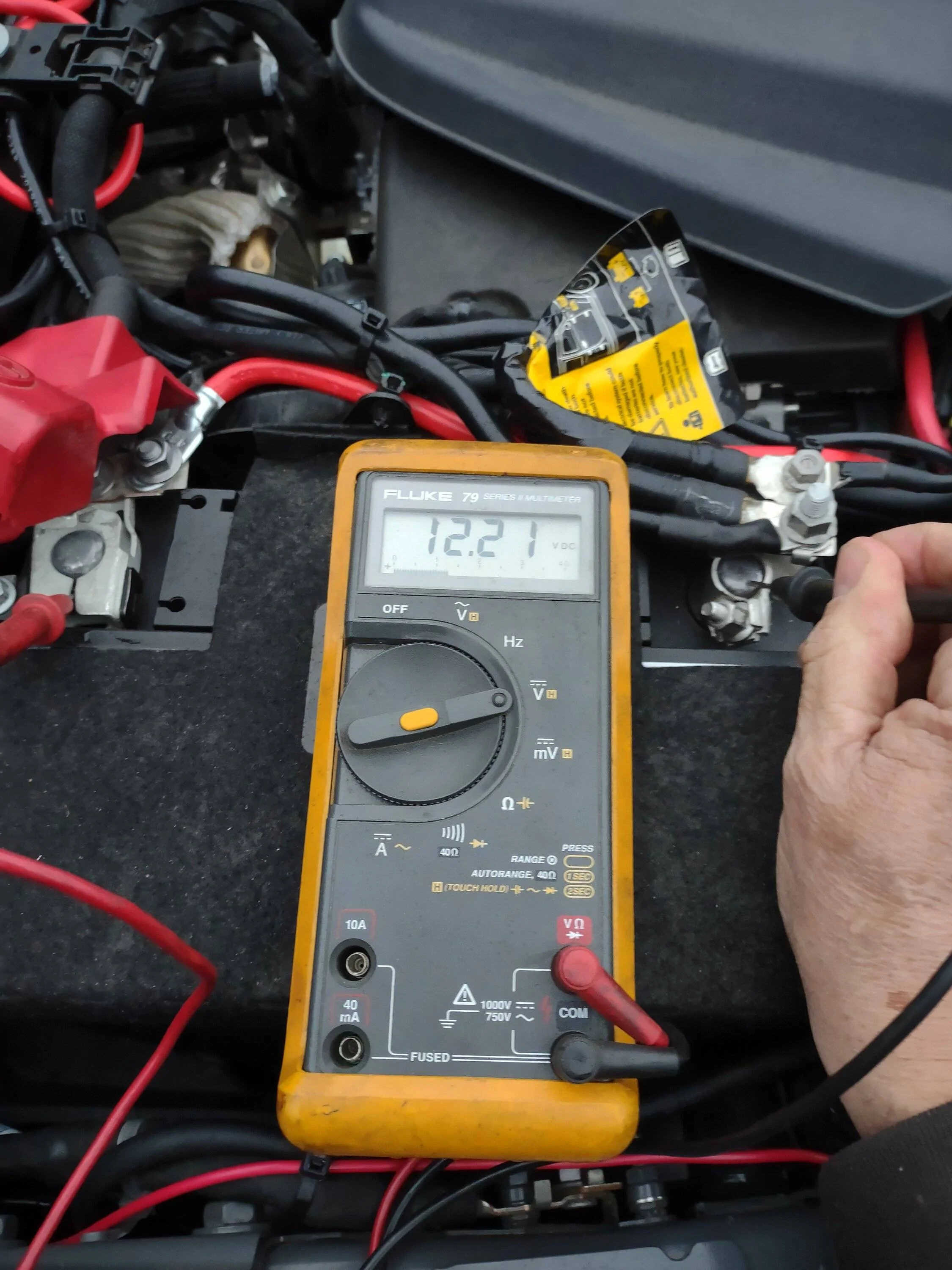

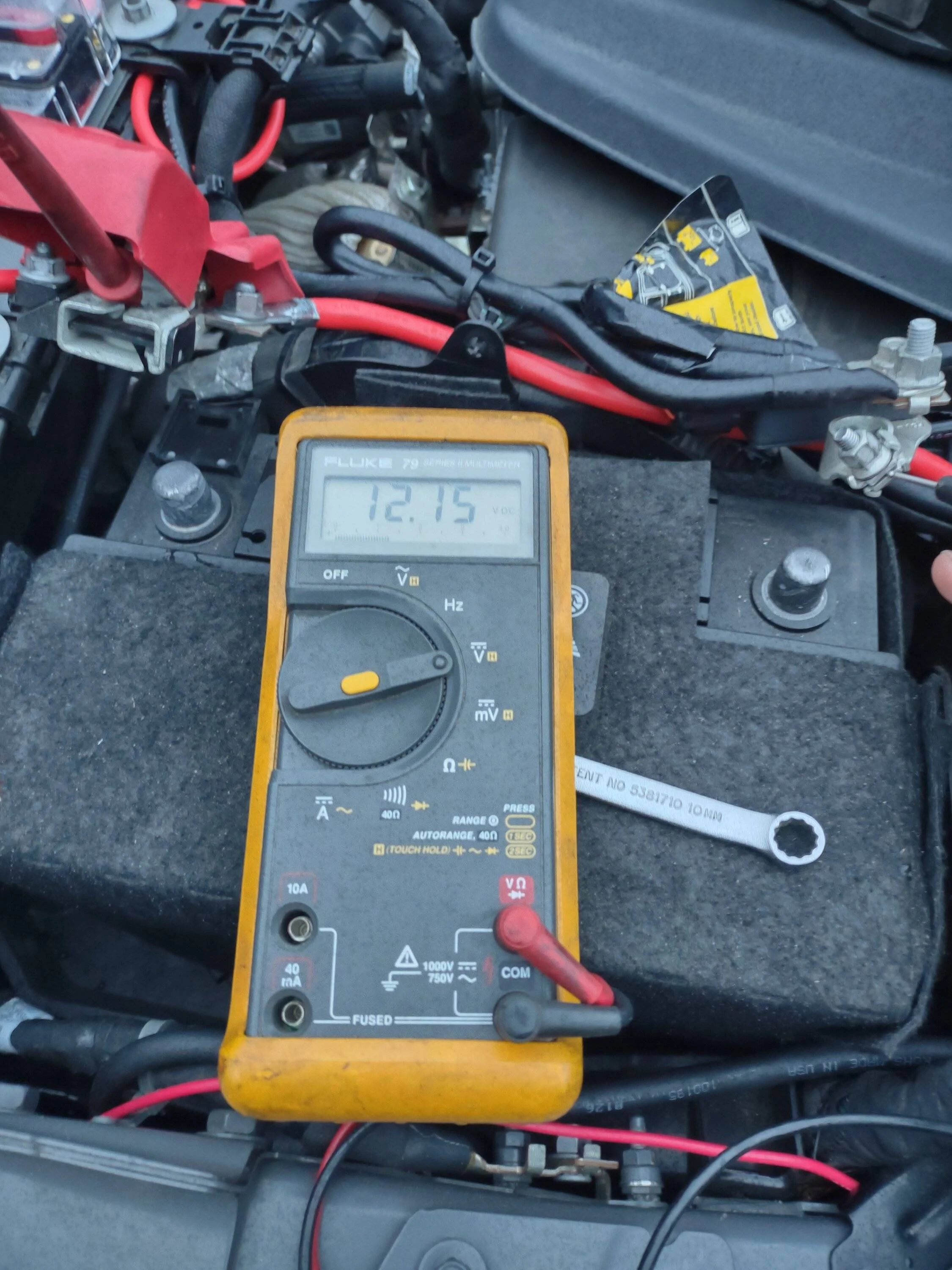

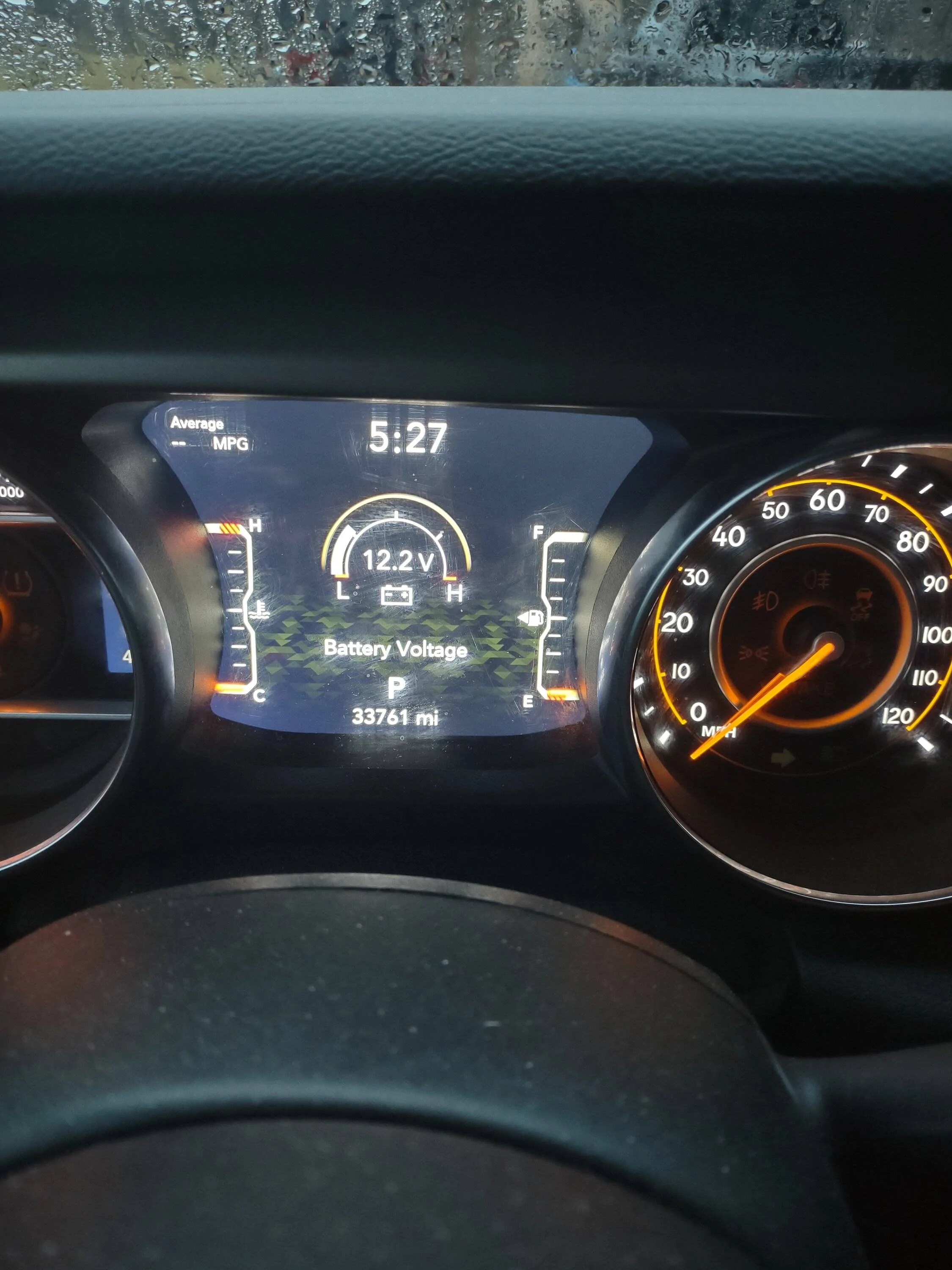

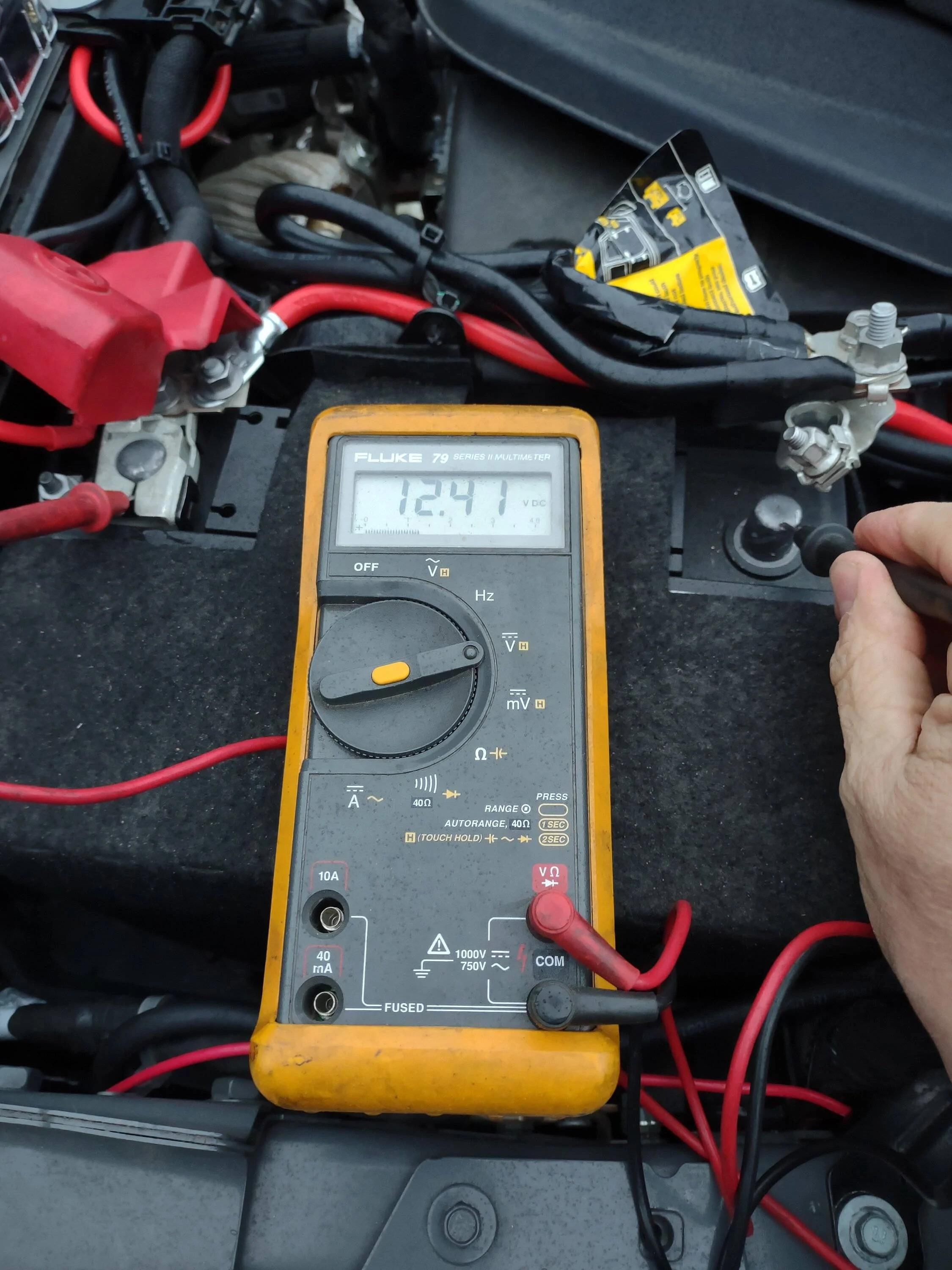

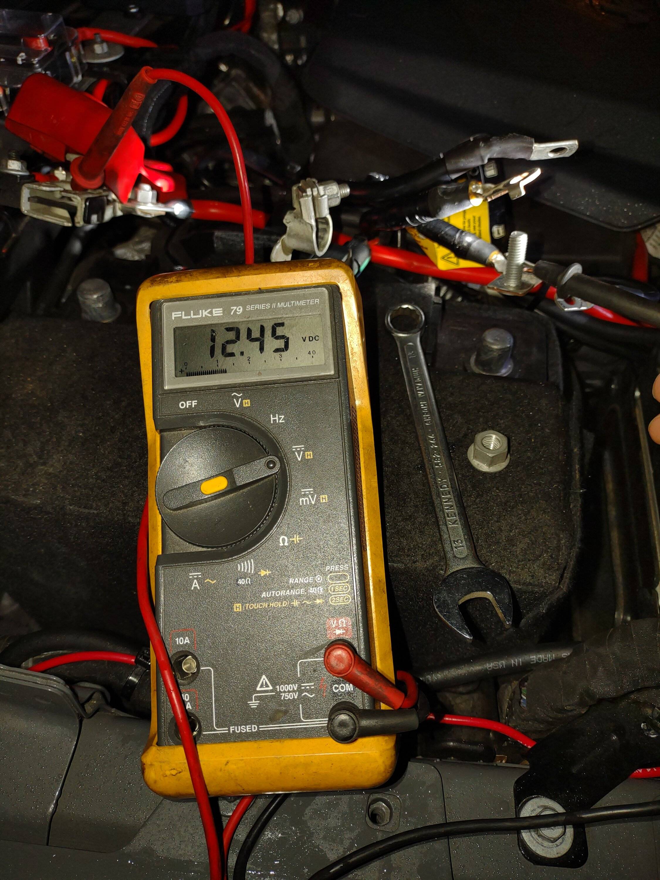

Here are the readings I got, truck has been setting for a day, will have to compare these readings to those after running for an hour or so. A correction to my earlier post of 12.1v was with the door open, voltage was a whopping 12.2 with the door closed.

What's happening in that last picture is that the aux battery is still fully in the system and powering the load of the electronics as long as the two black original factory cables are connected together.

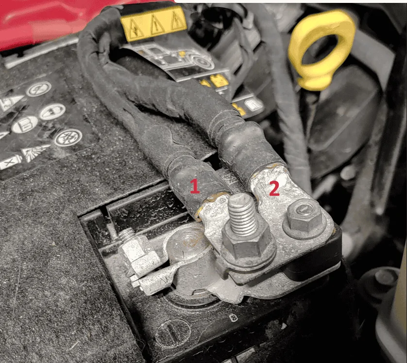

The aux battery ground comes up and goes onto the IBS that is clamped on the main battery negative terminal. Then the body/chassis ground cable from the fender connects to that. So the aux battery is grounded because it's still connected to the final ground cable.

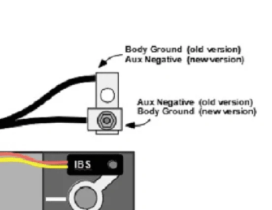

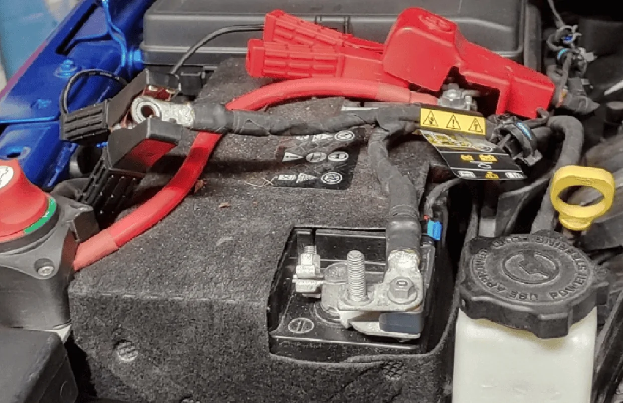

On a 2020 like I had, in this picture, the cable numbered 1 was the aux negative cable and the cable numbered 2 was the ground from both batteries to the fender.
Jeep Gladiator Auto Stop/Start Stopped working. 1674428333744
2021 changed that. Now cable I have marked with 1 is the chassis ground cable and 2 is the aux battery ground/negative cable.
To unground the aux battery and take the load off of it, you have to take off the nut that holds these two cables together.
This is how you charged the aux battery and measured aux battery voltage in a 2020 -
but for 2021 and later, you need to take the other cable off the IBS and use it to measure the aux battery and charge it.
Jeep Gladiator Auto Stop/Start Stopped working. 1674428526198
Jeep Gladiator Auto Stop/Start Stopped working. 1674428610879

Man, you are a quick study!
Low - meaning not fully charged, but not horrible, either.
If it was mine, I'd go for a charge of each individually, leaving the IBS off the battery/disconnected while doing so, to reset it, and going from there.
But it sounds like a dealer trip may be in the near future.

Yeah man, thanks. I too believe 12.4v is a touch low but not excessive. Even though it is a headache on both sides, this is an issue that needs to be solved, though sometimes I think it is costing me more than Jeep.
Now, old school logic says that an increase in voltage = decrease in amperage and I would like to think that 14.8 volts is towards the upper end of charging and at this point amperage should be next to nothing, trickle at most.
At this point, since no bells and whistles are going off, things could be pointing to the batteries again. Or maybe the alternator is having issues with amperage output. Regardless, the system is being very picky and needs to lower it's standards.
