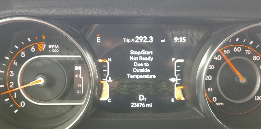

Don't like it? Move to Canada. (see pic)
Like it? Move to Florida.
I've been saying it's cold! Even my truck thinks so LOL

"Stopped working" and "not in a ready condition" are two very different things. ESS is designed to engage only if everything is just right. If the porridge is too hot or too cold, it won't do anything. That's not broken, that's design. There are a ton of conditions that would prevent it from engaging (air temperature, engine temperature, charge state, steering wheel angle, climate control, etc).
The simple fact that it didn't engage doesn't say much. If you aren't looking at the status screen when you think it "should" engage, then you don't know what's going on, and you really can't say it's broken.
40,476
53,954
That's a great point.
People can scroll the cluster screen using the up/down arrow buttons on the left half of the steering wheel. Scroll either way until you get to screen 7. The number shows near the top left side of the cluster display right in front of you as you scroll - then that number disappears after a couple of seconds so you only see what page you are on while scrolling.
Page 7 is ESS status.
I recently found mine wasn't working due to "outside temperature". Those in the midwest, Iowa, MN, ND, SD, and Canada or AK likely knows what that means the past couple of weeks or so -too damned cold!!
(It was 0 (F) while I was driving that day I saw that message)

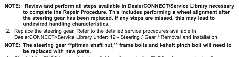

Well as I suspected, visit to dealer to make another drop off.
whilst going over the issue of the no ESS, I read the tech notes stating they only charged the batt and I thought they were replacing. Hence it only lasted Half a day.
I figured since the battery felt cover and my marks had been undisturbed.
Figure the dealer will try cheapest method first. Sadly this frustrates the educated owners at large for rework.
And, since the new steering box was installed, I’m 10deg steering wheel left. Go figure. I wonder if they even bothered with a front end alignment aftwrwards.
Goes in thurs. Will let you know results.
again.
40,476
53,954
Make sure you take in the LATEST TSB for steering. The first several never said to align it. I can see why dealers may not - because in an ideal world what does changing the steering gear have to do with alignment? Nothing - but it can impact steering wheel centering in a less than ideal world. So the latest TSB has instructions to align it and covers that under the TSB reimbursement section. Before that if they did an alignment, or anything except replace the steering gear, they got nothing for that other stuff - they barely got paid for the time it took to replace the steering gear and work the air out of the lines and pump and check the fluid again. There was no time beyond the bare-bone steering gear replacement on the TSB. So most didn't do anything else. It meant lost time/money.
Now they can do it and get paid.
I took mine back with the latest TSB and asked them to please check alignment. I knew it was ok and I had centered the wheel myself, but they did and I got a printout of the current alignment as a baseline if nothing else.

Great advice SP. Hadn’t kept up on all the specifics for that. Always glad we can count on engaged members such as yourself.
is there a separate TSB # or alignment is updated in the original? I’ll go search it.
Thanks kindly.
40,476
53,954
I have it handy - here it is -
Note that this one also specifies replacing the PITMAN nut! The others did not and some members have found the pitman nut loose. They also say replace the pinch bolt (clamps the steering column intermediate shaft coupler to the steering gear input shaft)
Prior versions didn't mention that so the parts got re-used. Not good.
I like that the words **pitman shaft nut** have ** before and after like "PAY ATTENTION TO THIS!"
