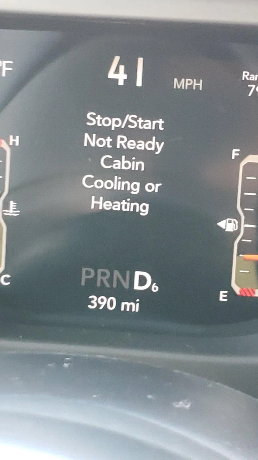

Here is what my dash displays:
Jeep Gladiator Has anyone's start-stop system just... stopped working? 20210101_162827

So here’s something interesting. A while back when I first noticed my ESS stopped working, I read on one of these threads where someone’s dash for their EAS read “battery charging”. When they took it in to have it looked at, one of the nuts was loose on the negative terminal on the main battery and after tightening it, the auxiliary battery started working again.
I thought about this last night while running for some wires for rear lights, so I stopped and took a look at my main battery. I checked the nuts for the two posts and both were tight. While continuing to work, I started thinking about it more and my auxiliary battery issue started around the same time I installed some Rigid lights. The wiring harness that came with the lights fit the small post on the main battery (I think this is the post where the auxiliary battery connects to the main battery. I could be wrong, but someone will correct me). So I thought, what the heck, I changed the fitting on the harness and put it on the larger post.
I didn’t think more about it until I was running errands around town this morning and my ESS started working again. I’m not an electrician, but I’ve always heard if you don’t have a good ground, electricity does strange things.
Anyway, my ESS is back up and running after driving around town for about 10 minutes.
I know there’s bad auxiliary batteries across multiple CFA makes/models, but I would be interested if others with this issues have accessories grounded to the smaller post and if changing it, resolves their issue.
