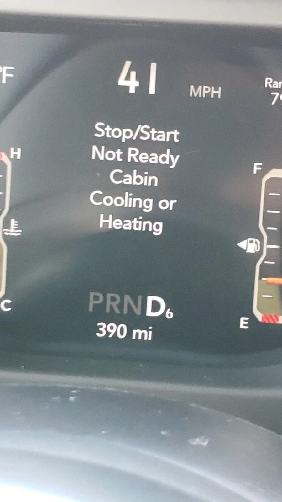

This is what it shows:
Jeep Gladiator Has anyone's start-stop system just... stopped working? 20210101_162827

Disconnected hood pressure switch is said to disable the start stop. Check that
