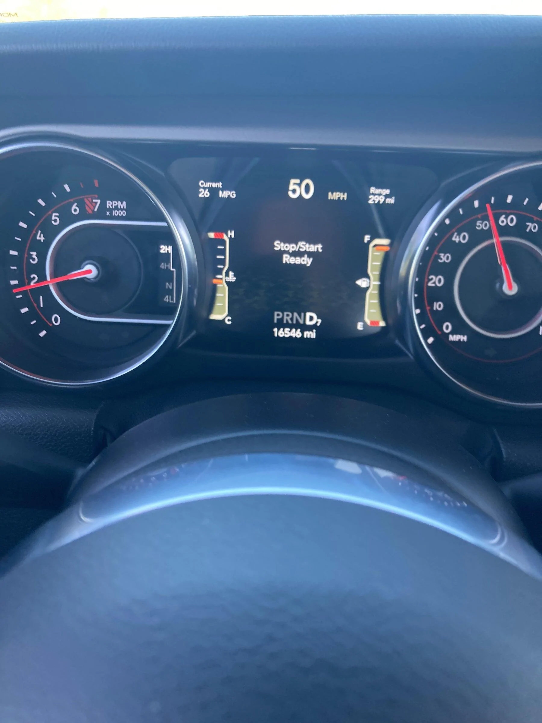

Well I’m back. Alignment was not done, but wheel was straightened. And yes, admittedly they did not have the new TSB. So why wasn’t an alignment done then? Wth. Guess if you can eyeball it and get the wheel close it’s good enough. For now - the steering seems straight. I just wanted it out of there at this point.
and….drum roll…..only charged the batts. again.
Now, It worked in my 9 tests going around the block the other way home. But this is what happened last time, quit again in a day.
Anyway, I’m sure that’s always going to be the first step, charge batts until something fails a test.
Maybe I should consider opening a betting pool for 24, 48 or 72hrs until my ESS is failing again.
For now - this is what I get to see and everything working as it should…
Jeep Gladiator Has anyone's start-stop system just... stopped working? 90E878D2-B11D-4984-9571-B266969A321F
I’m almost certain I’ll be back.

Found more of the techs notes…aux batt at 52% was reason for it not engaging ESS, all charged to 90%. After a few hours …Anyone know what the “fail” batt % might be to warrant full on replacement? Maybe < 50%?
