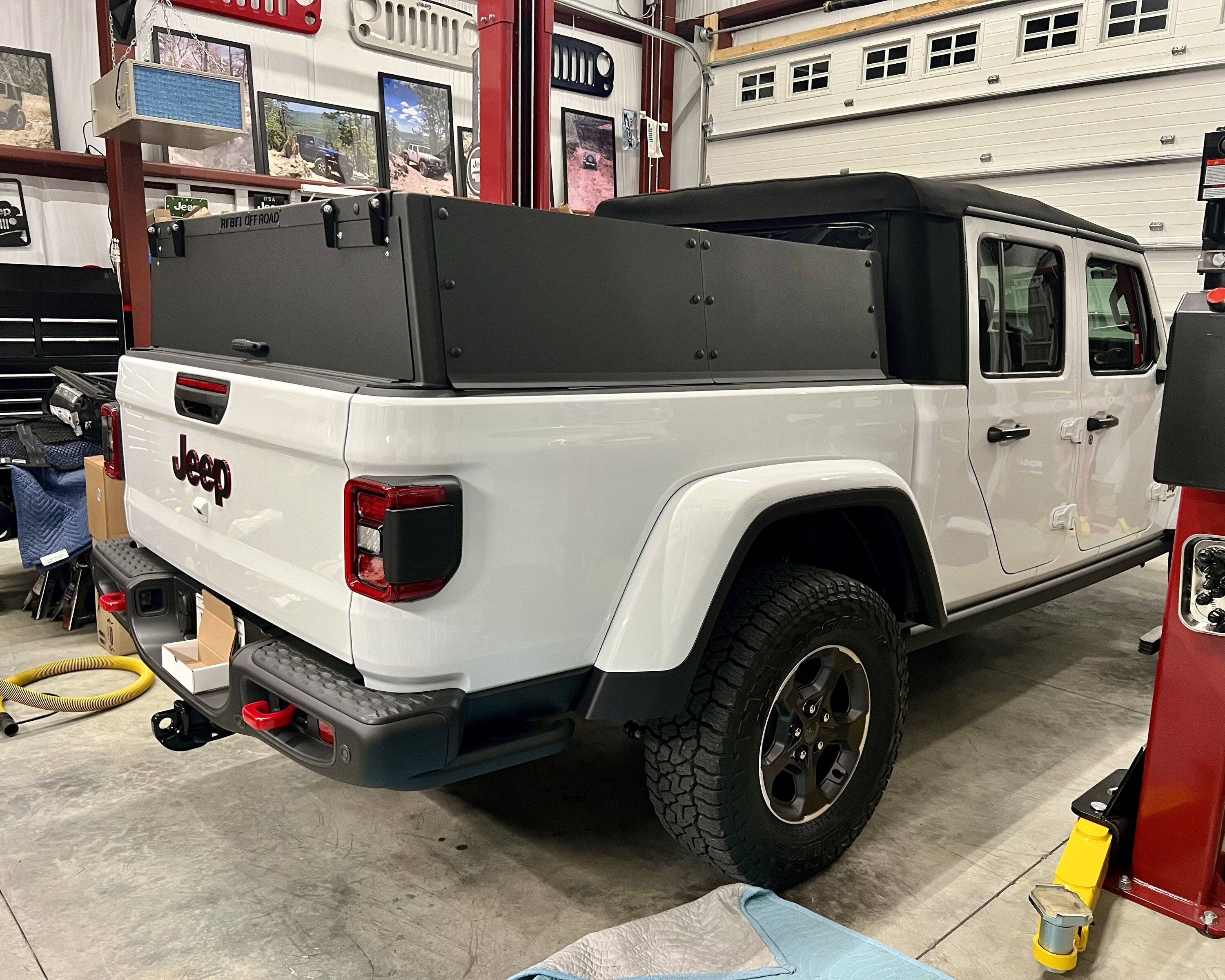

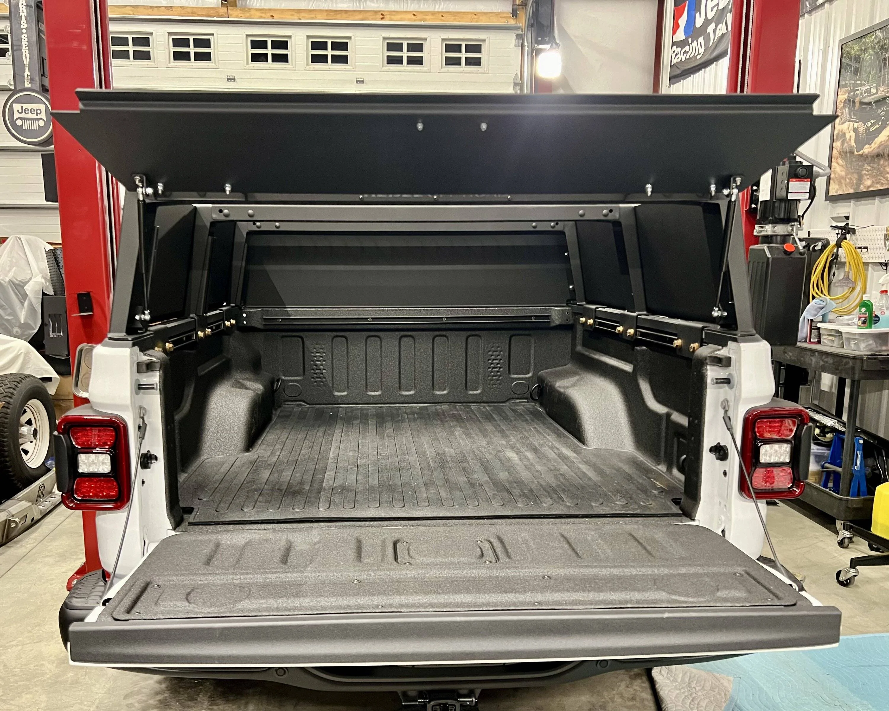

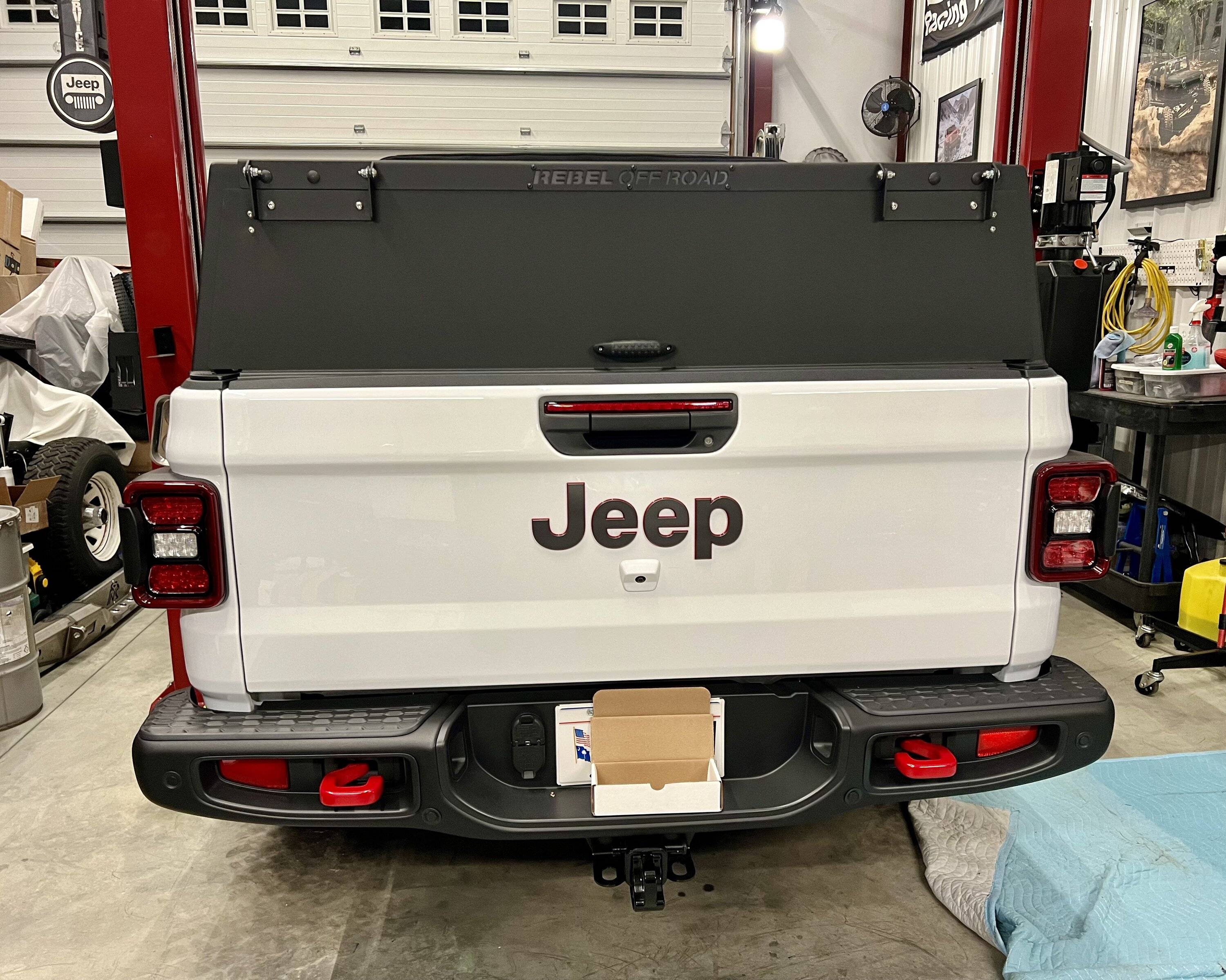

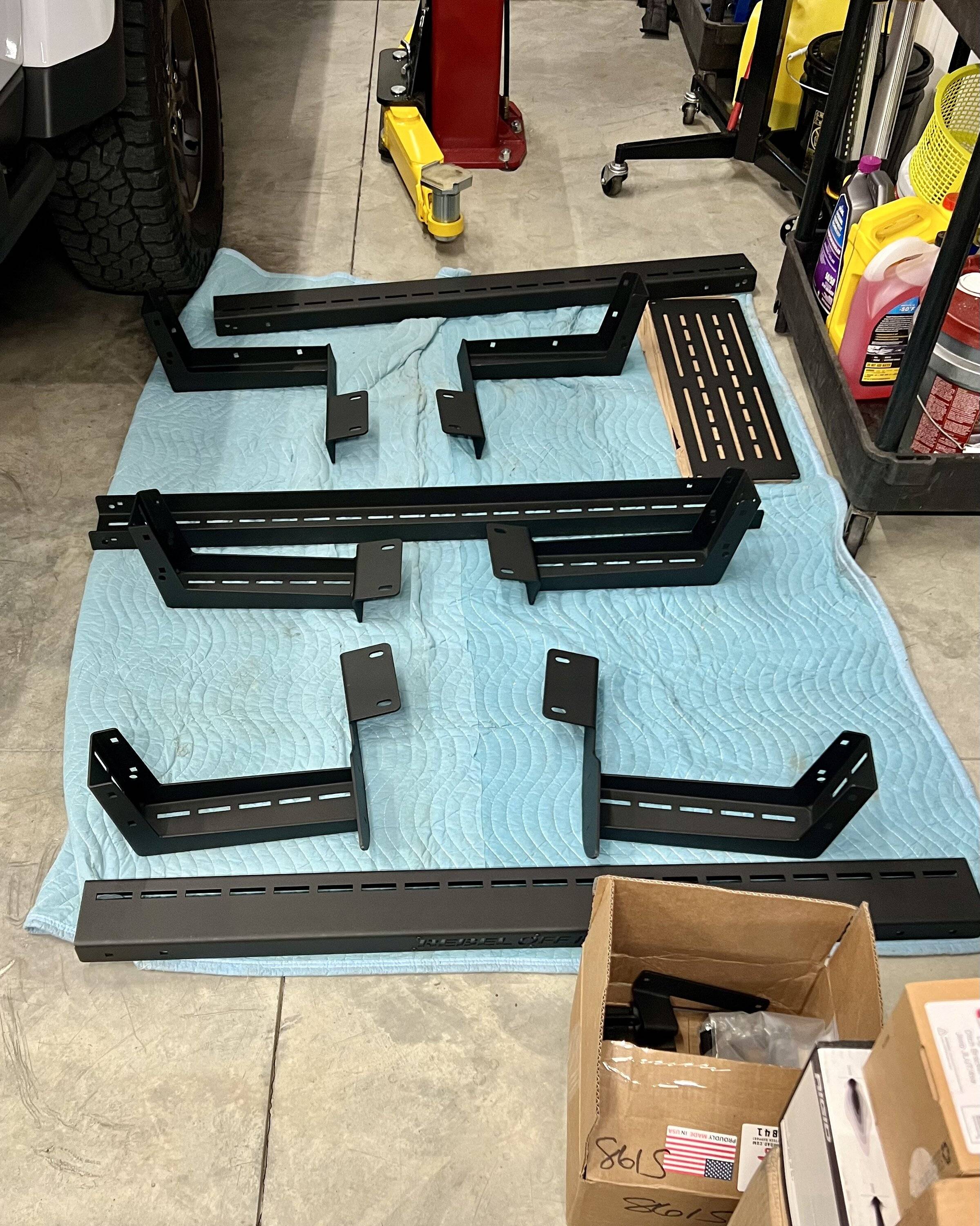

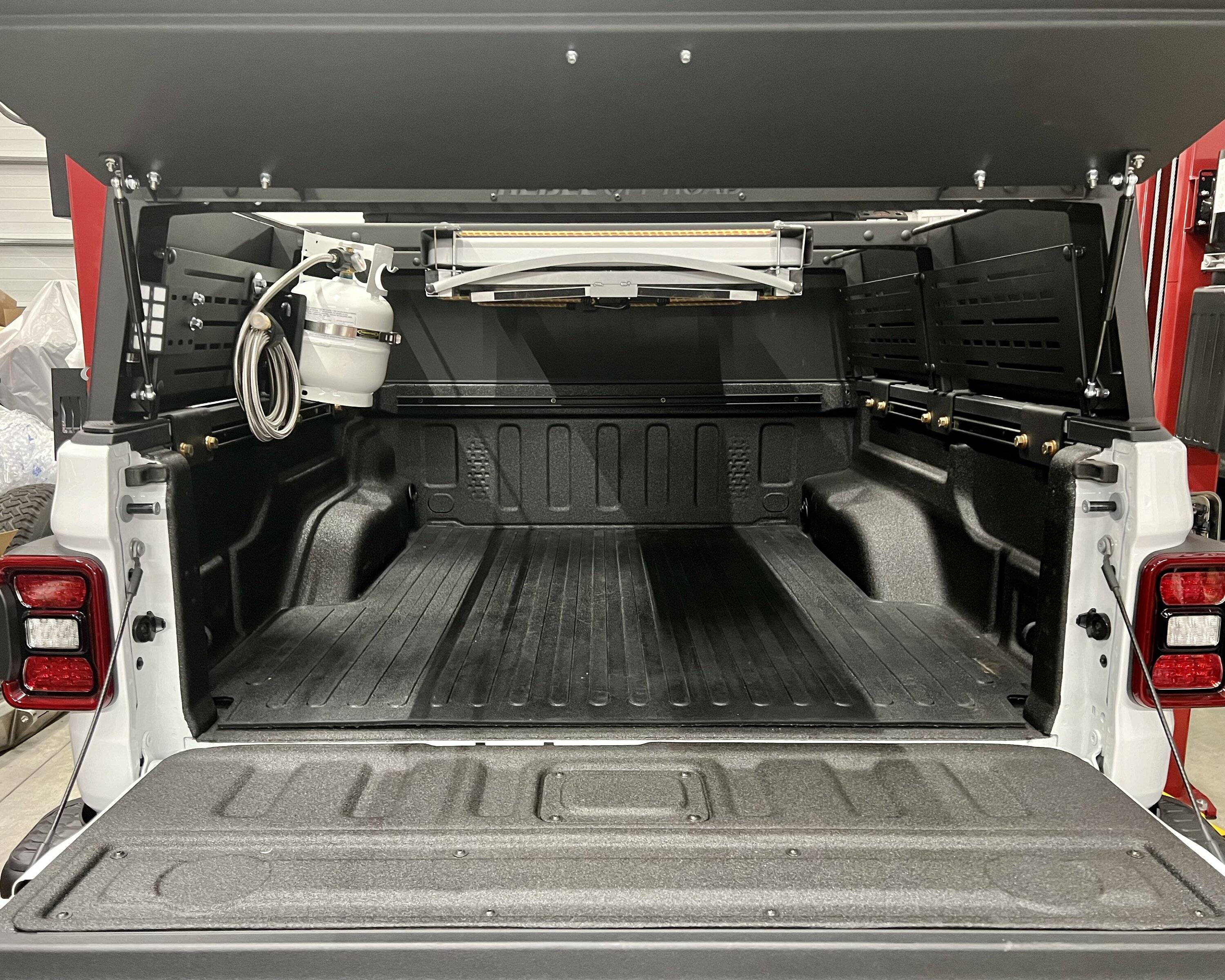

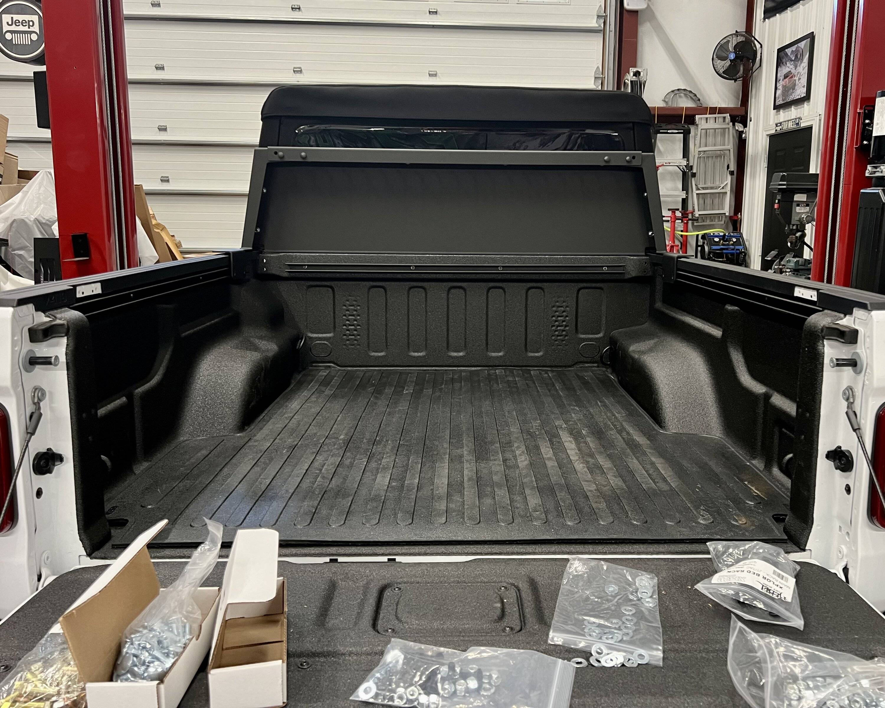

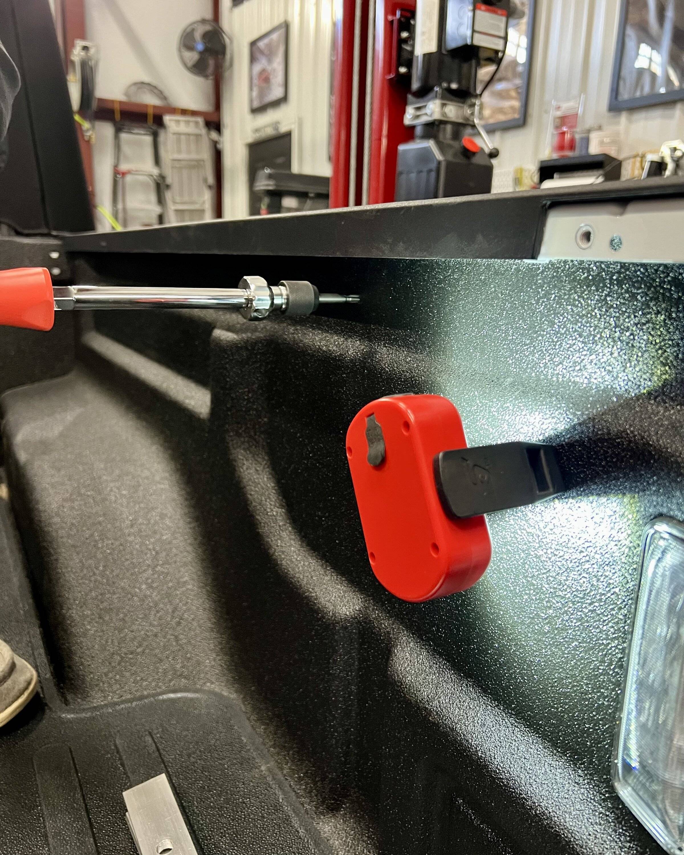

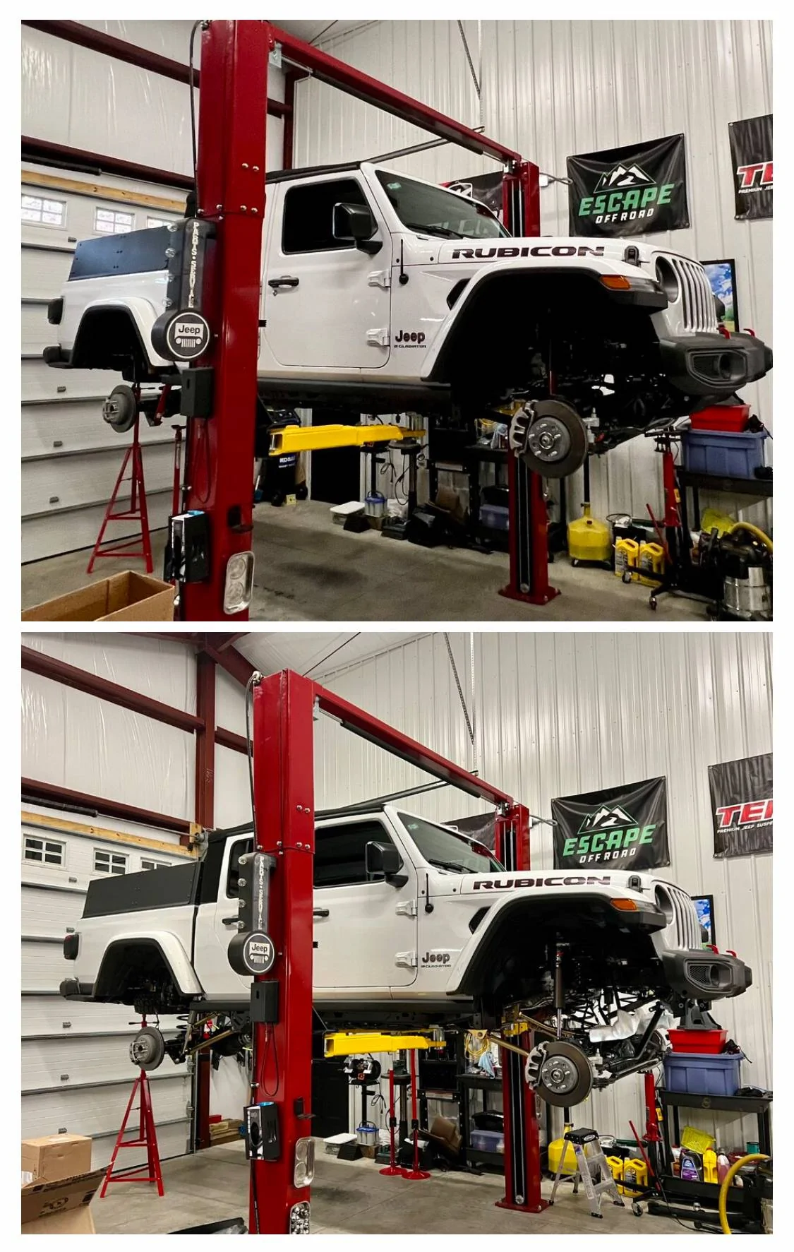

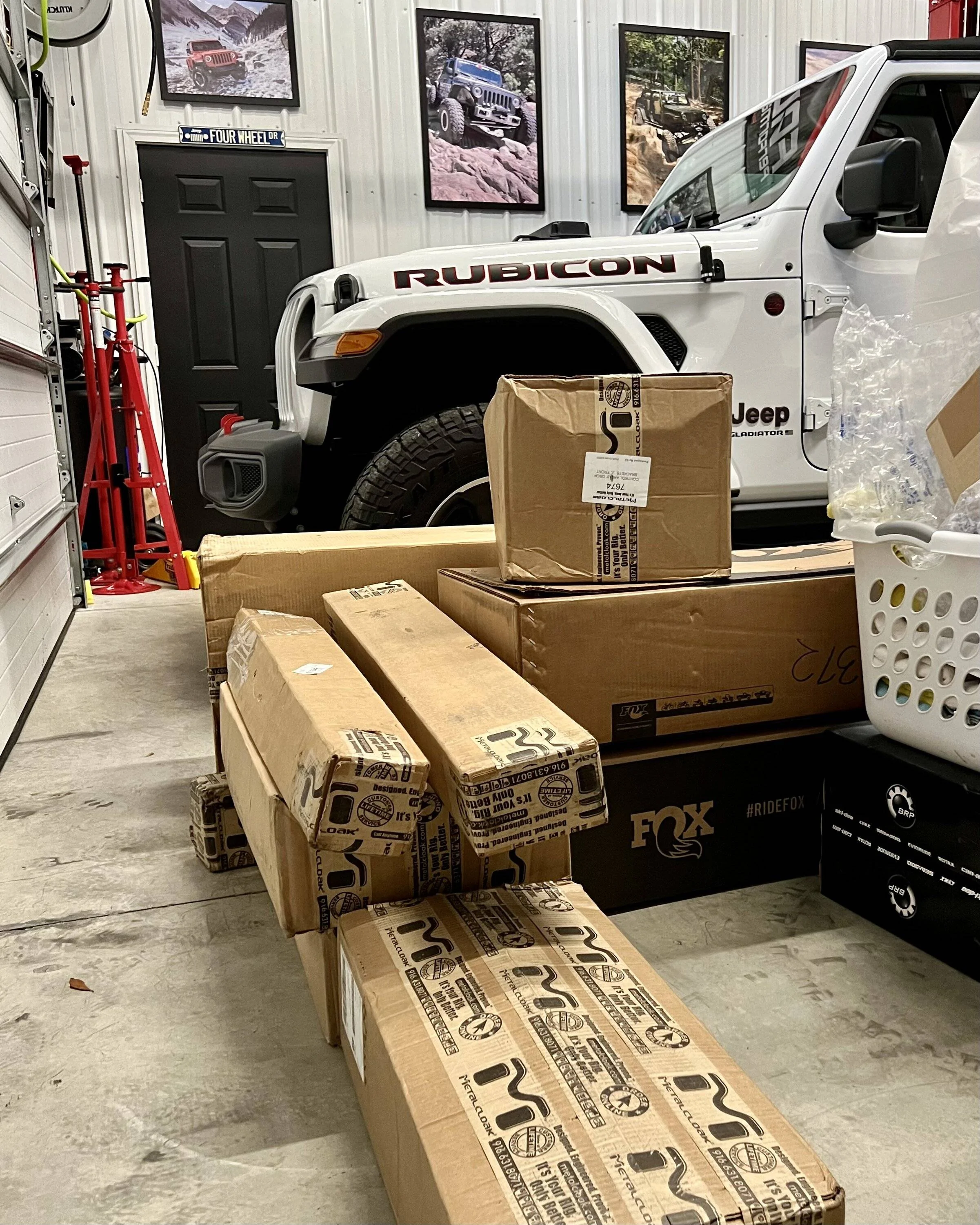

Started tapping factory bed liner out for bed rail bolts. Then unboxing, organizing parts, bolt together in sections. Assemble and adjust hatch including drilling new holes for struts to work correctly.

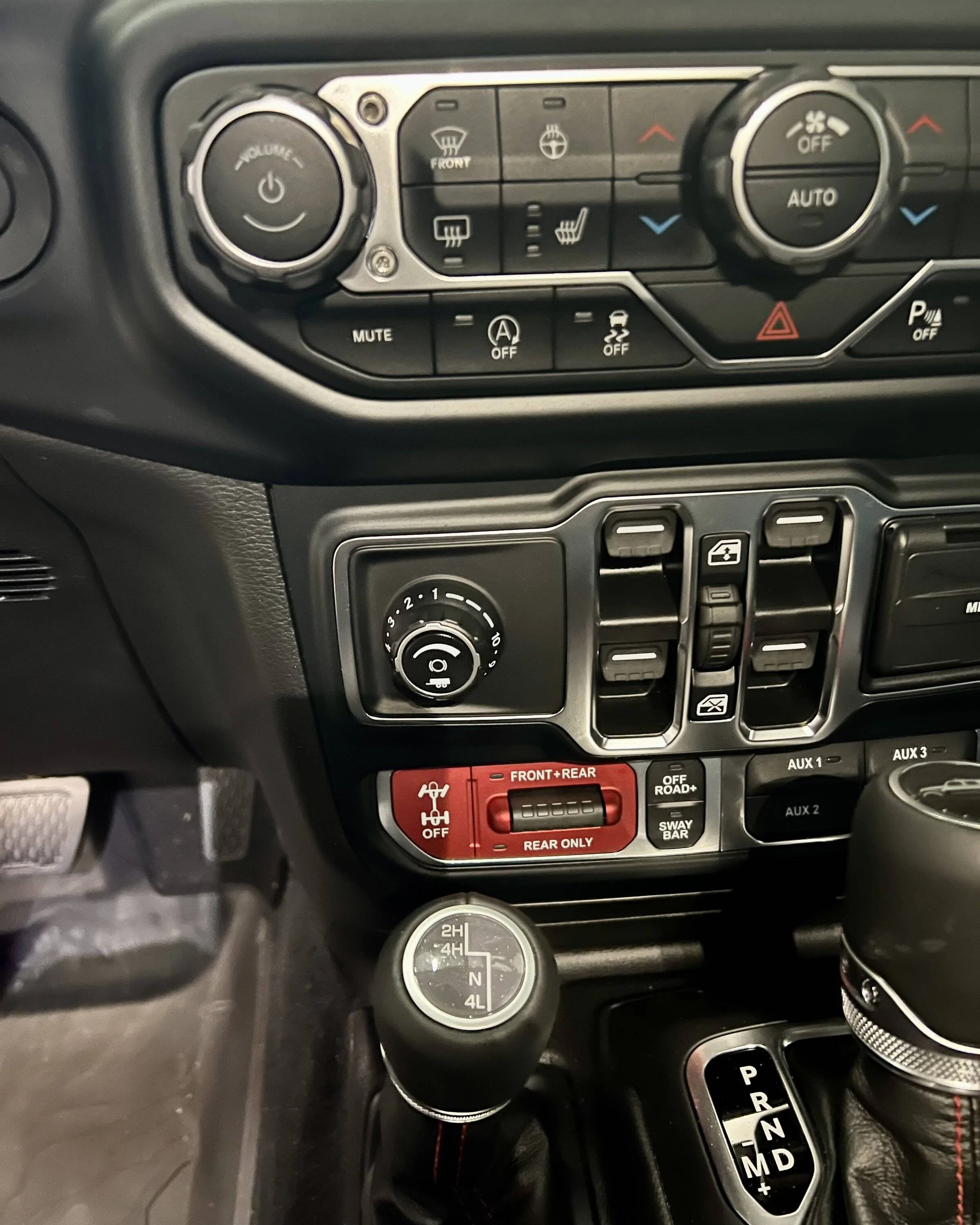

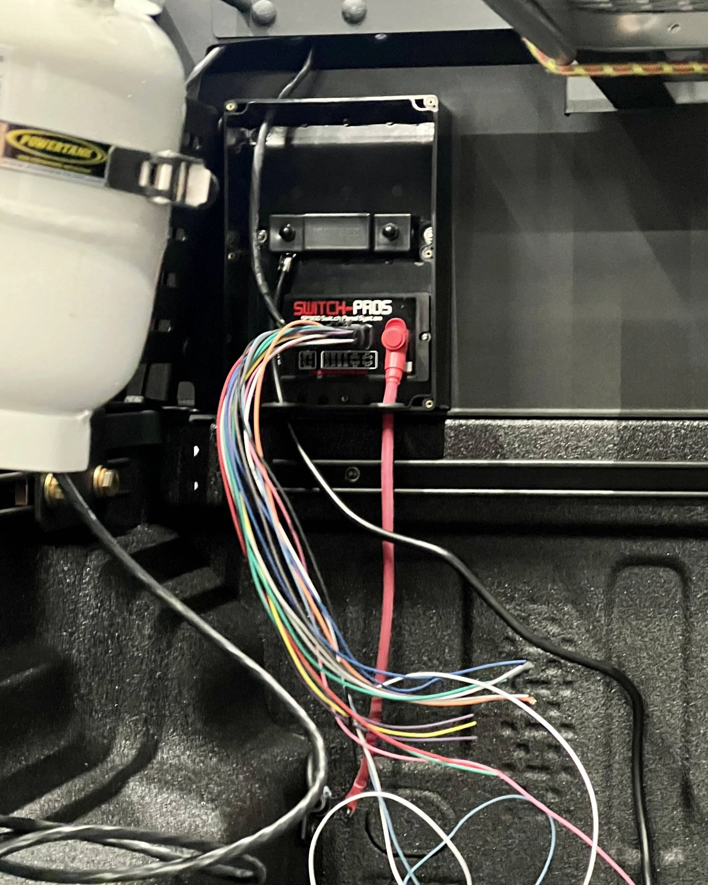

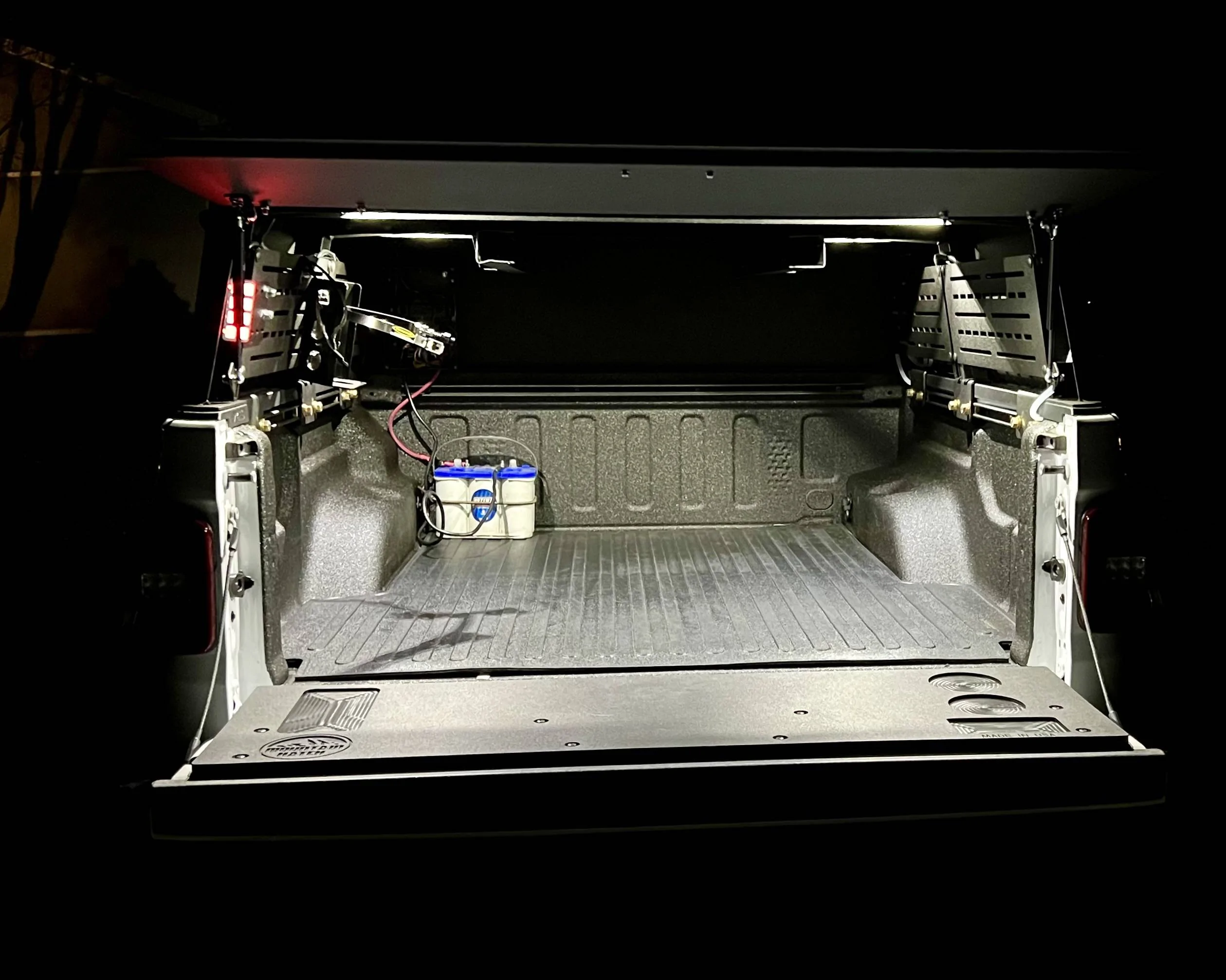

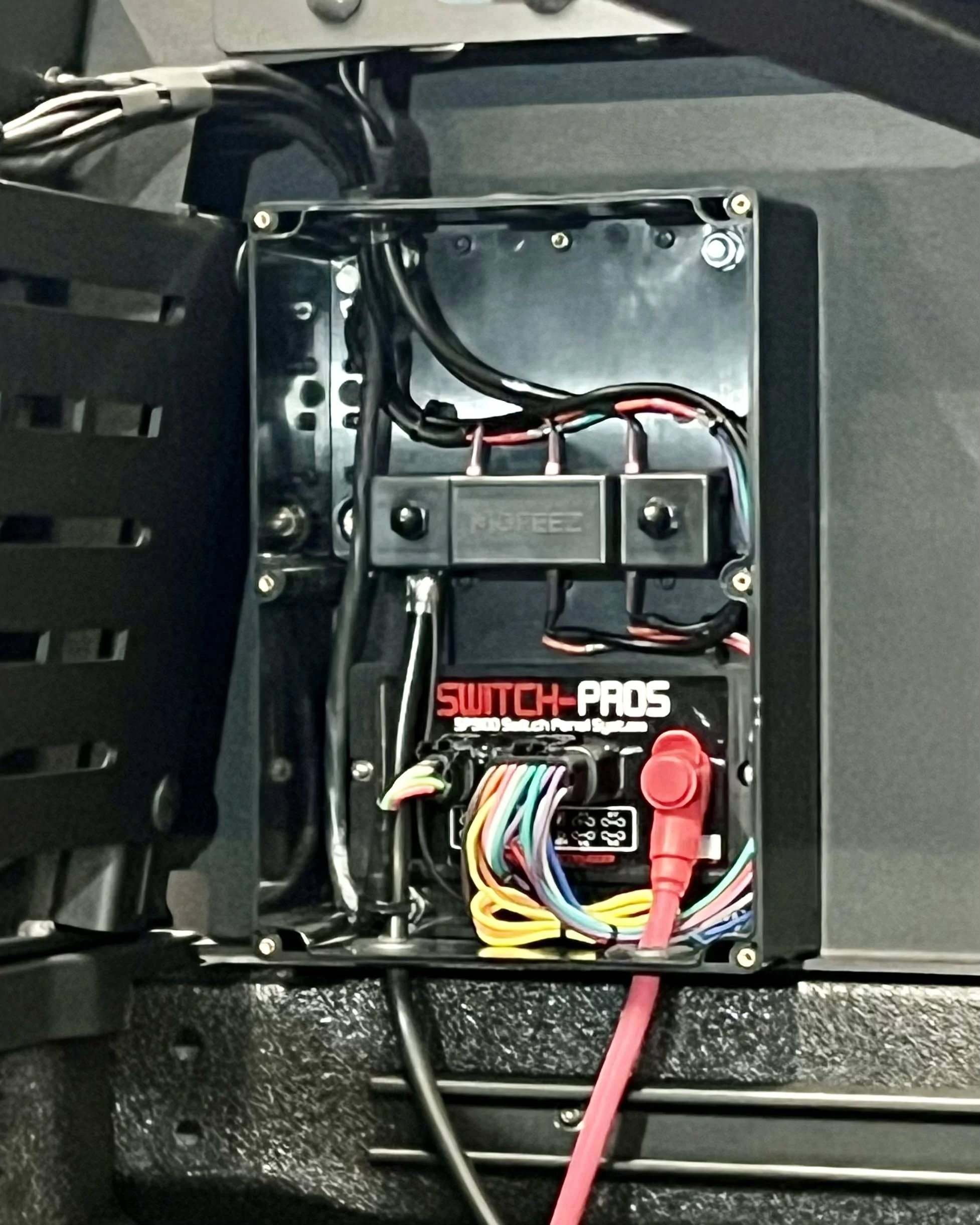

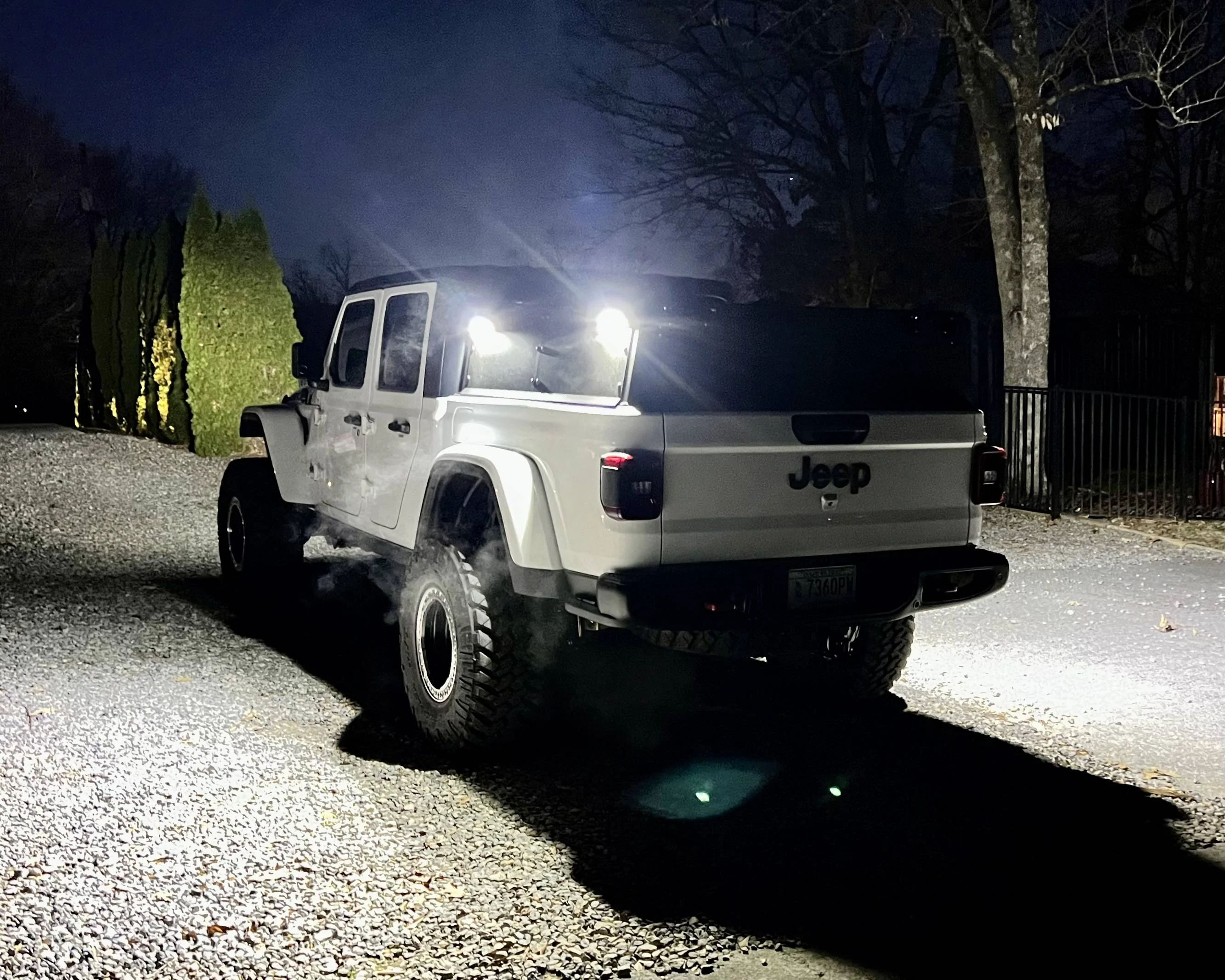

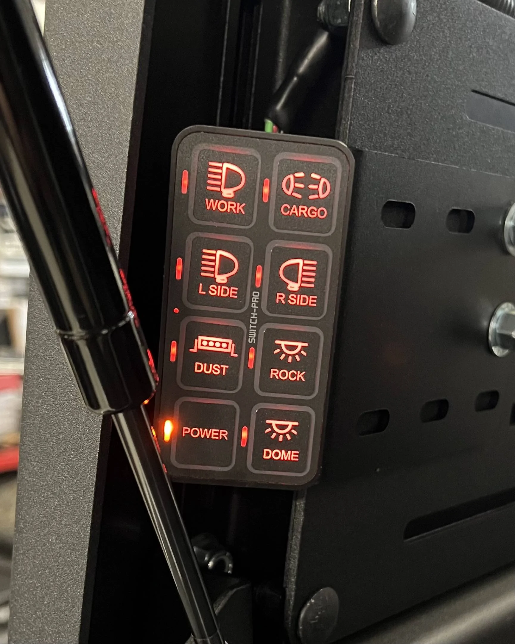

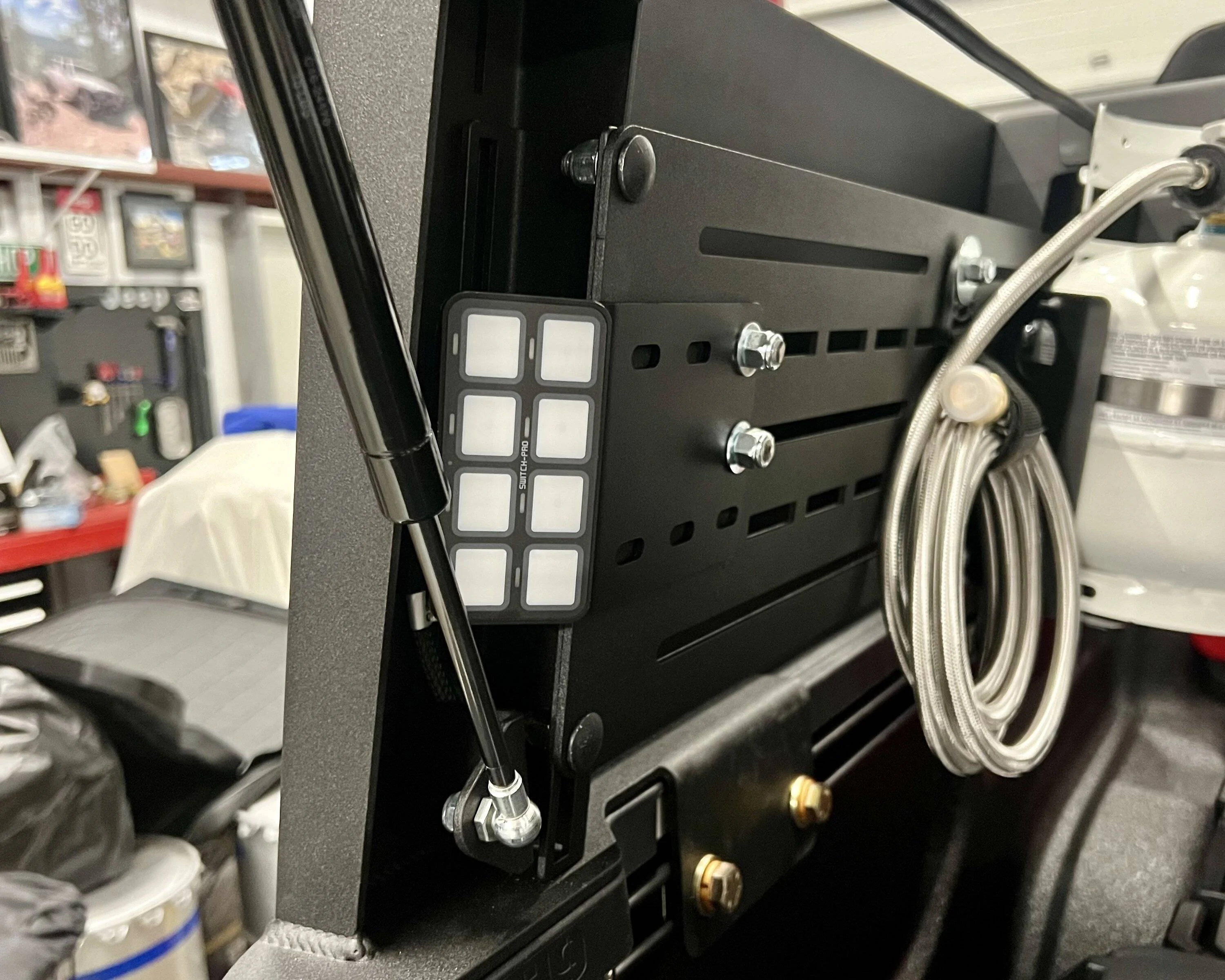

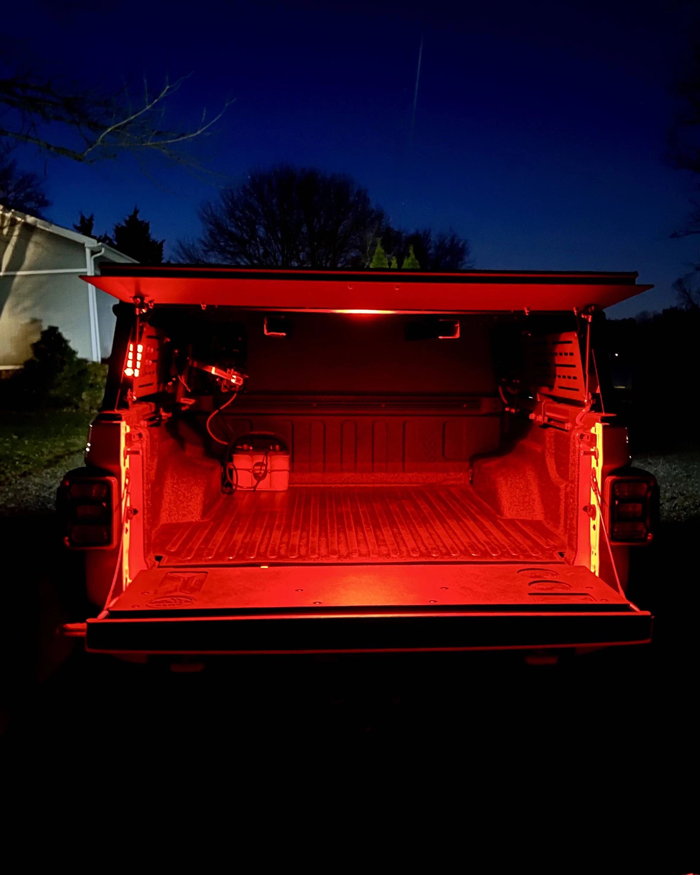

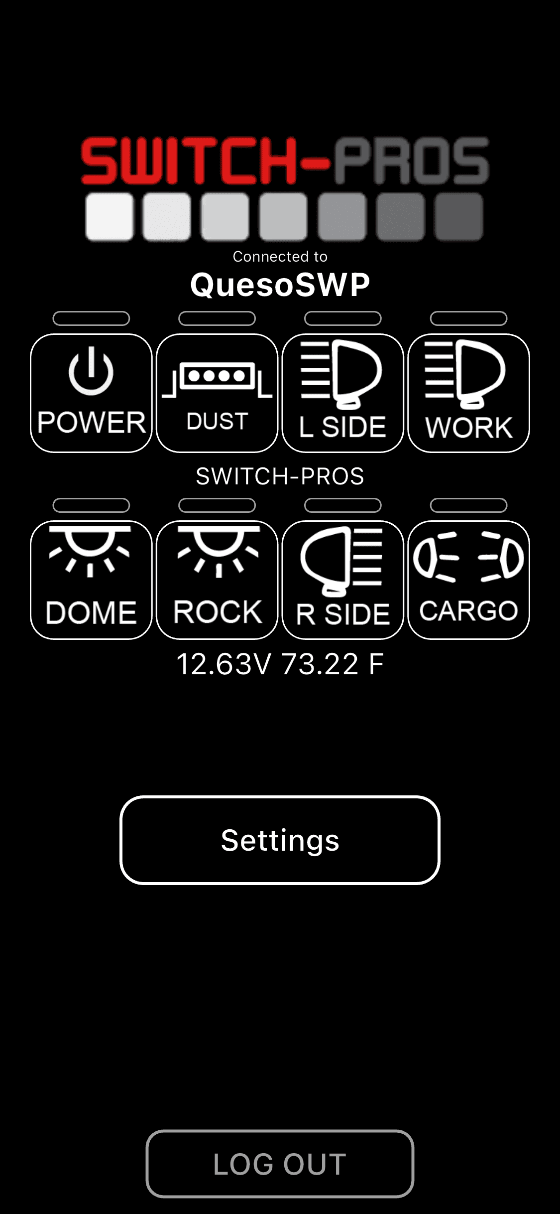

Started on rear light control center. This will manage cargo lights, table lights, scene side lights, chase lights, etc. The Switch Pro system is impressive way to control lights combined with Bluetooth and iPhone App that allows configuration of each switch, triggers, strobe and even dimmers. In the bed are six circuits, left scene, right scene, tail gate lights, cargo lights, red tailgate map light, and Power Switch Pro. Later will be dust lights and rock lights.

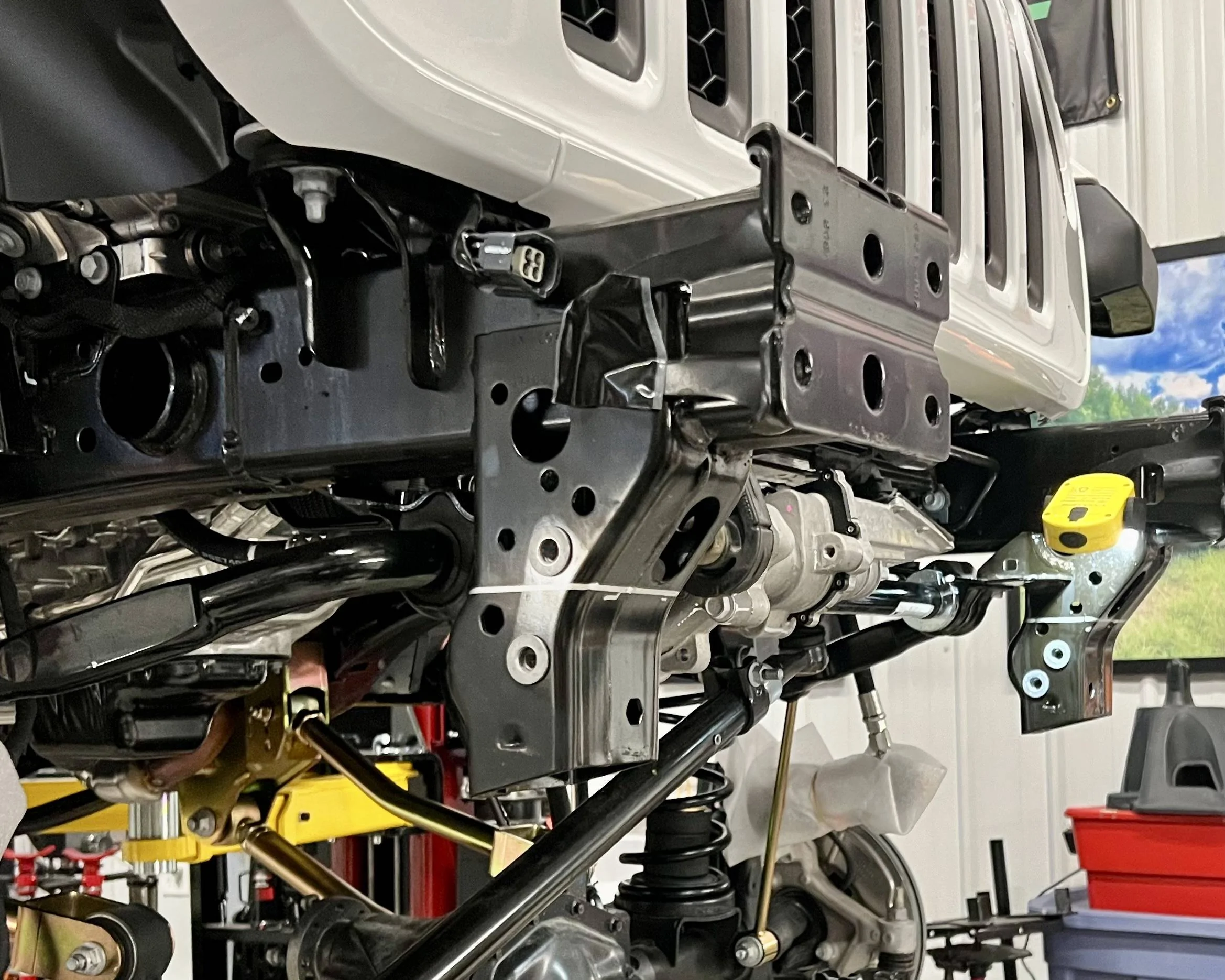

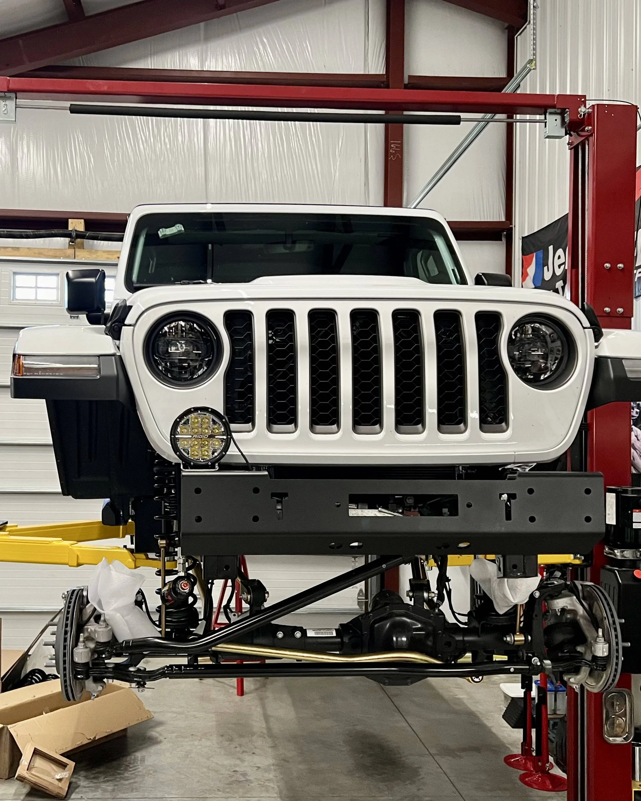

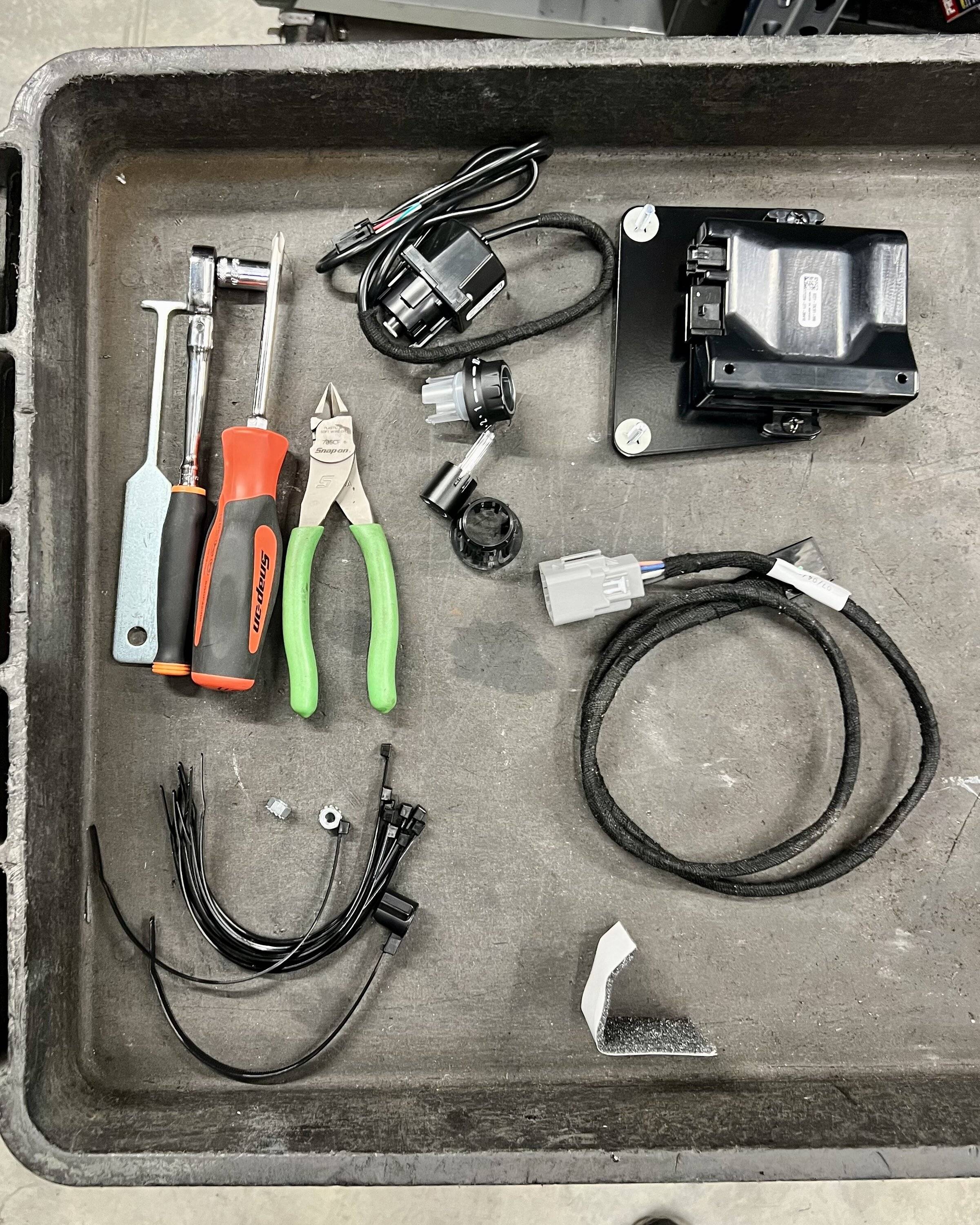

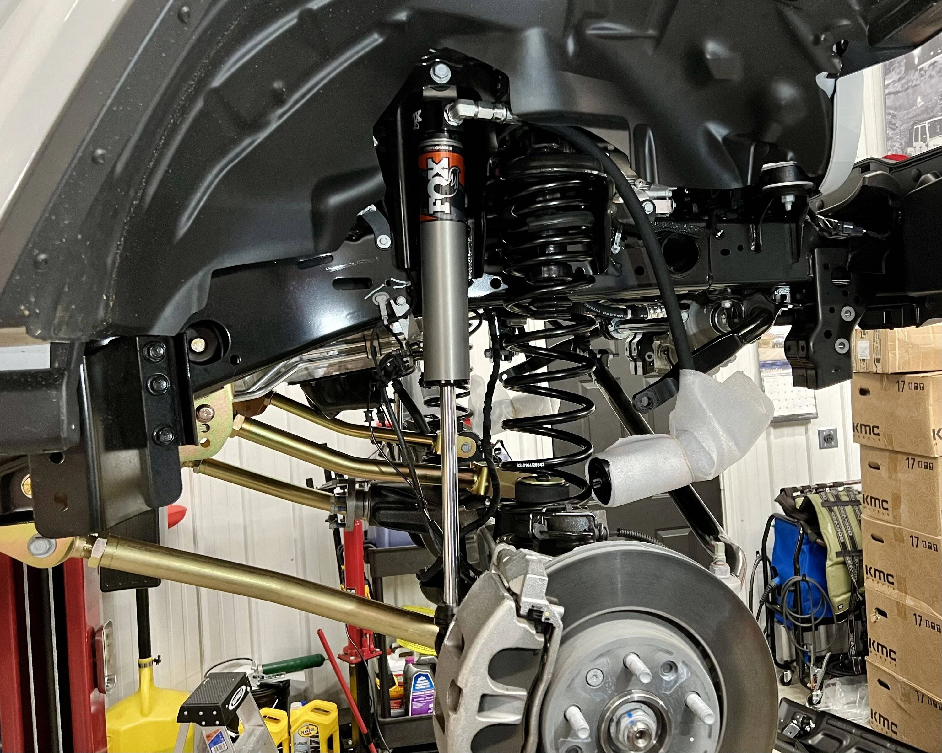

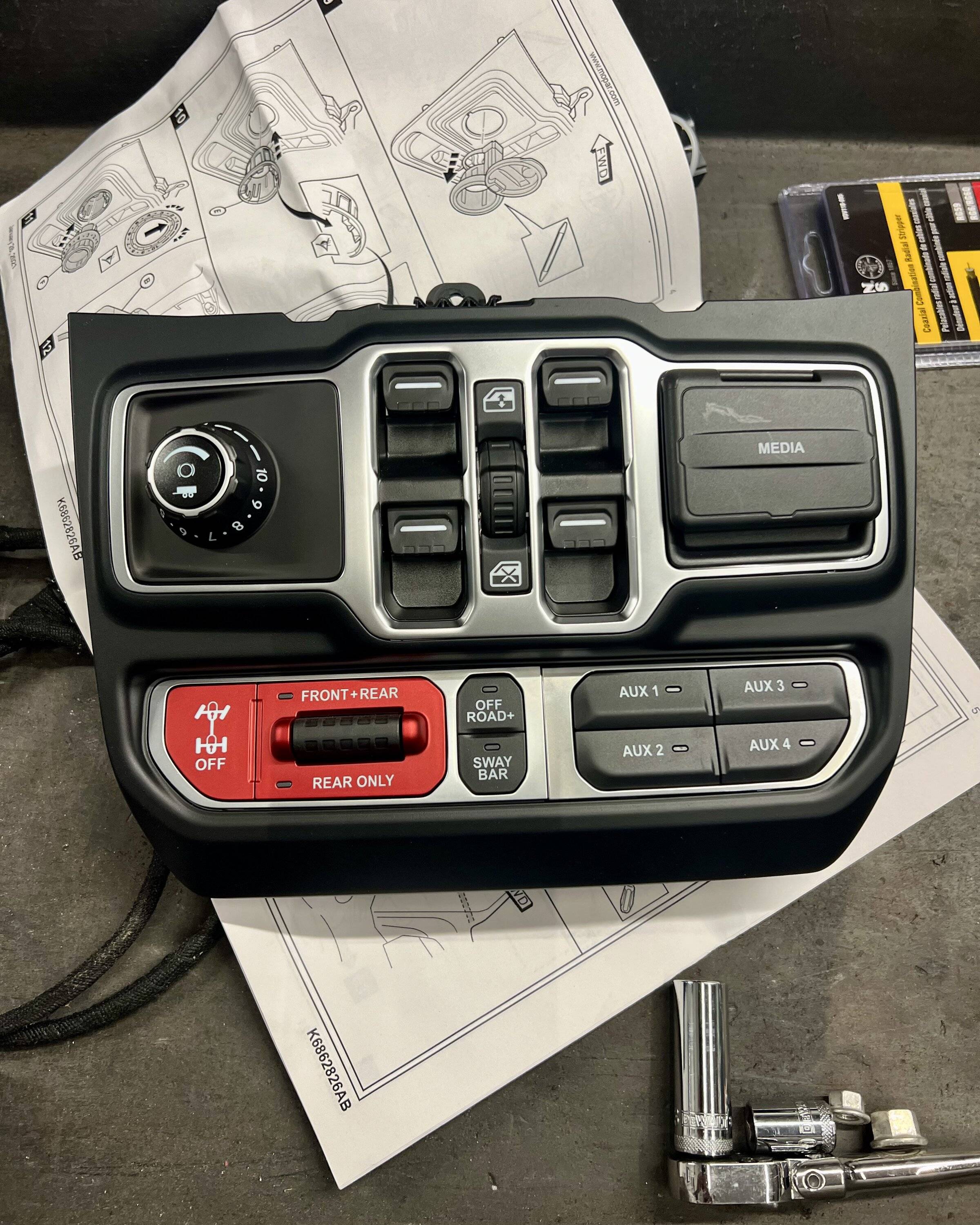

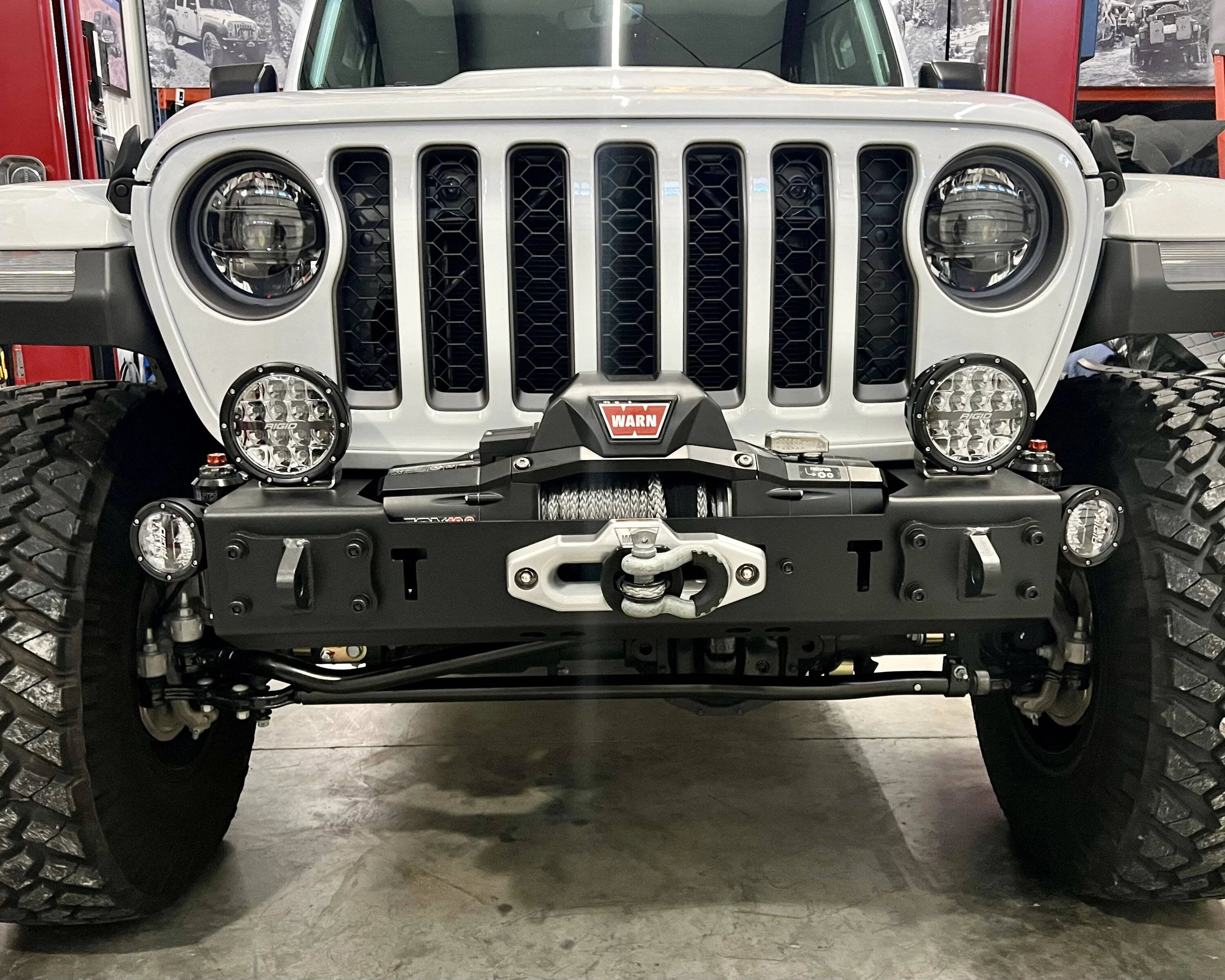

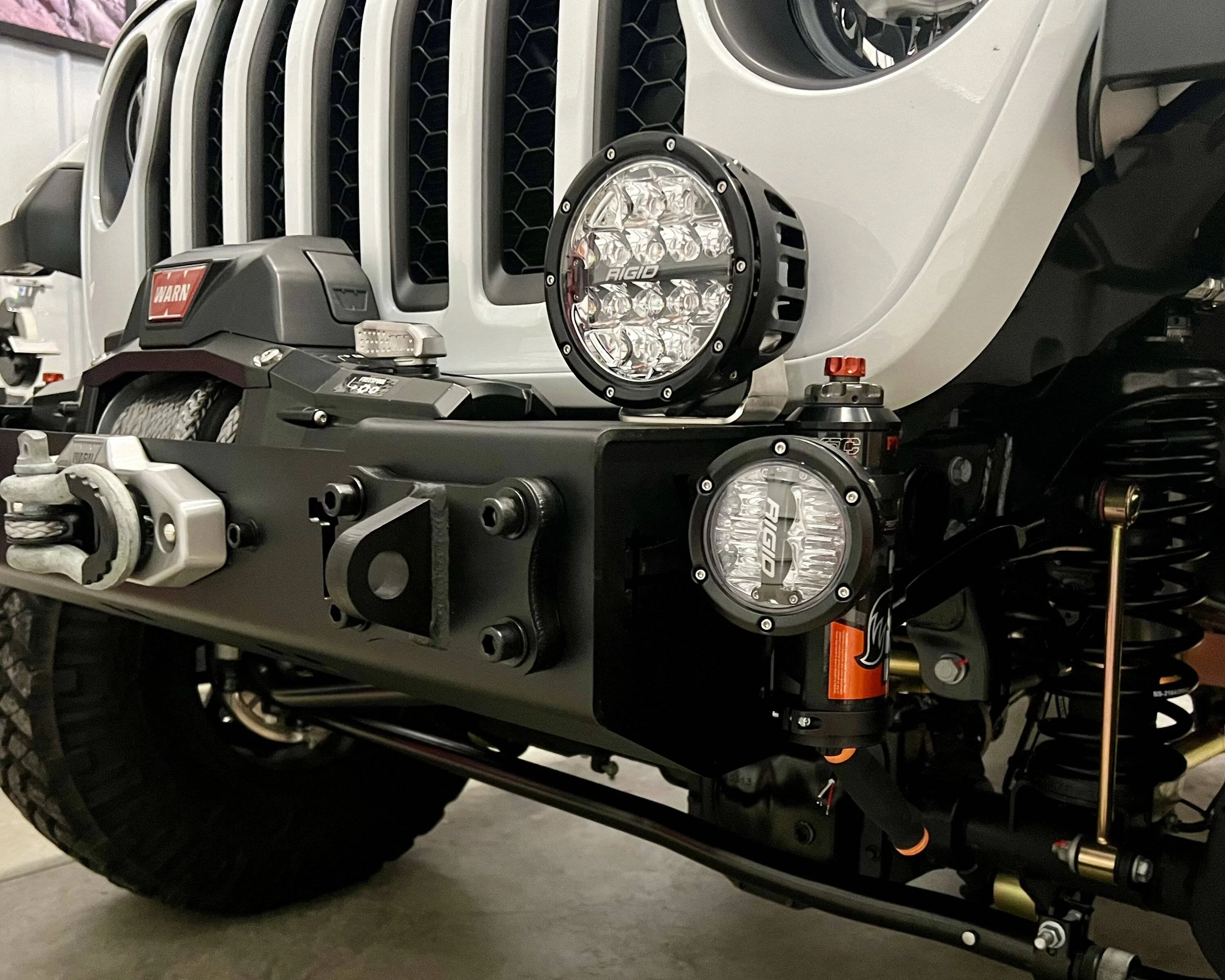

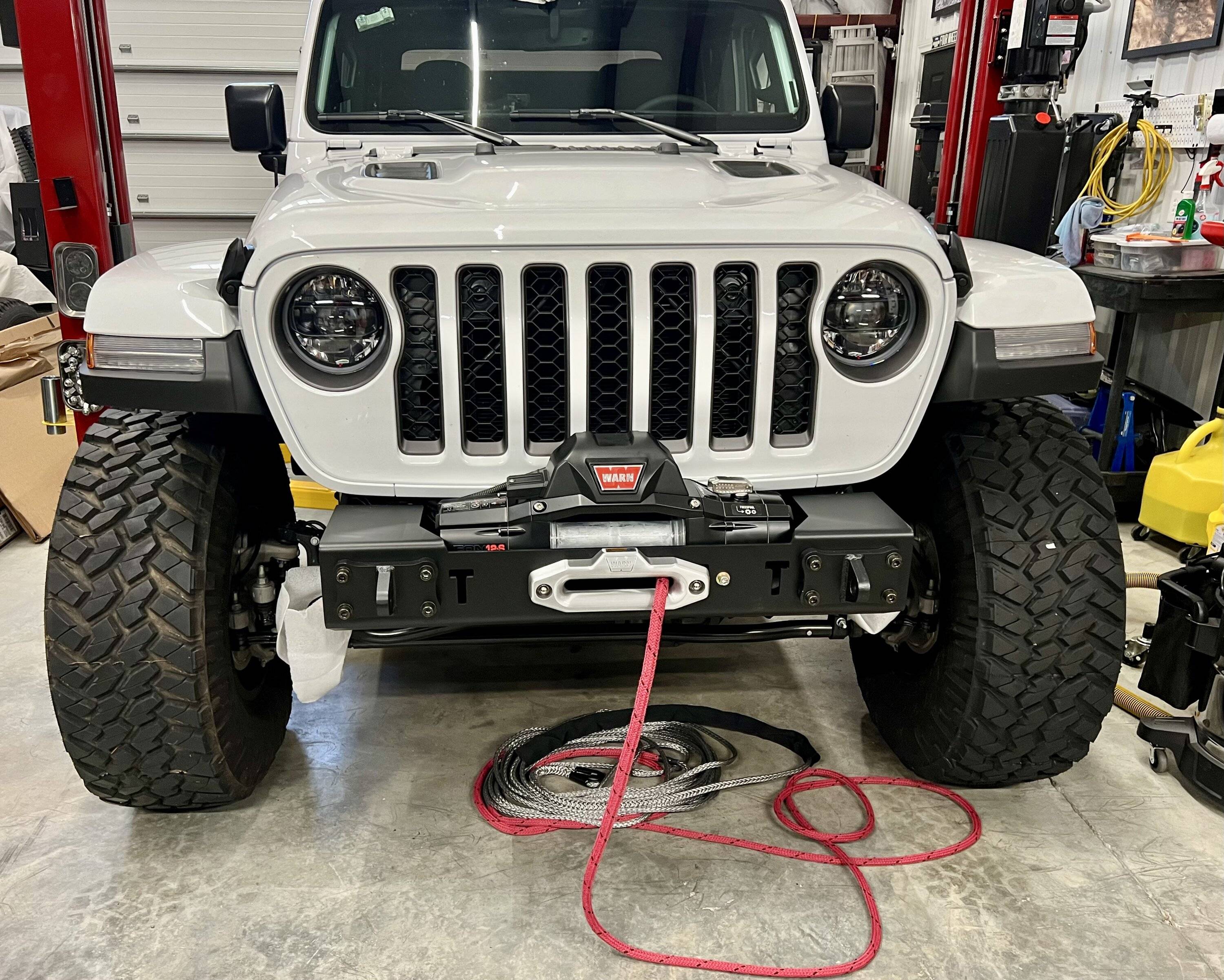

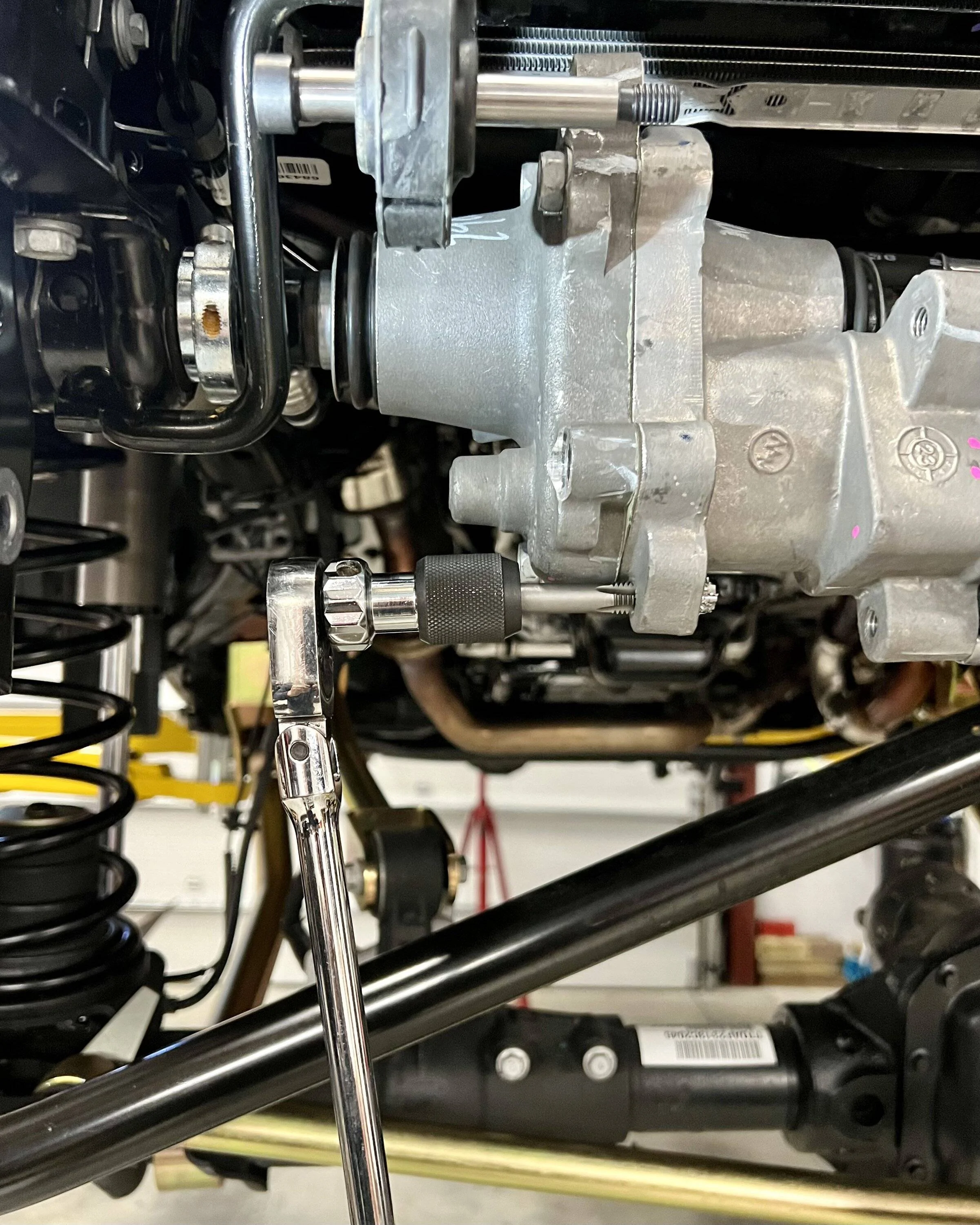

Front Evo Quarter Pounder requires swaybar motor flip and removal of lower factory skid plate horns
