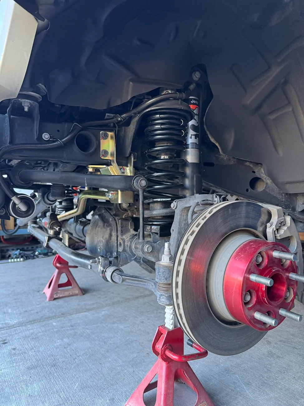

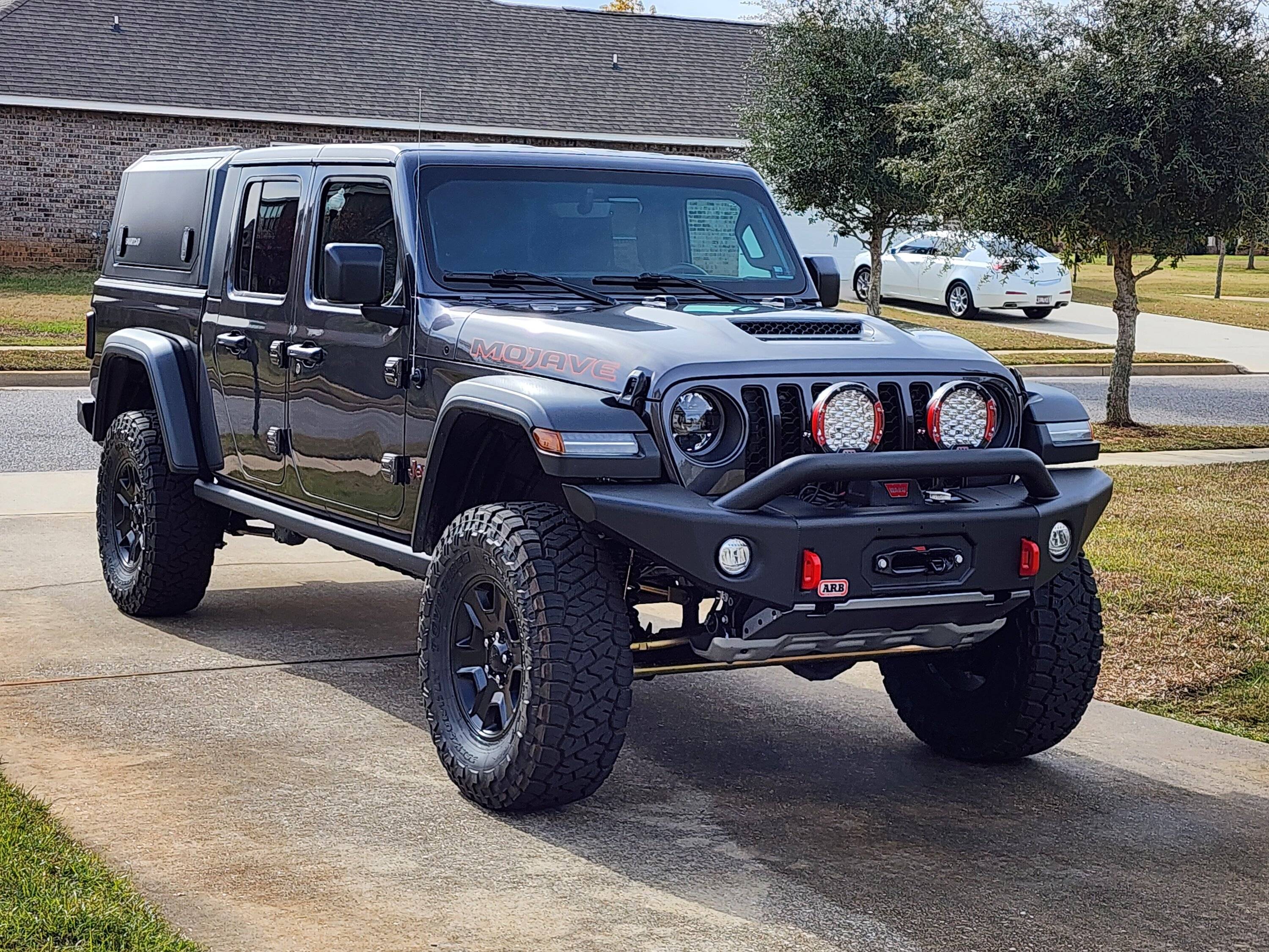

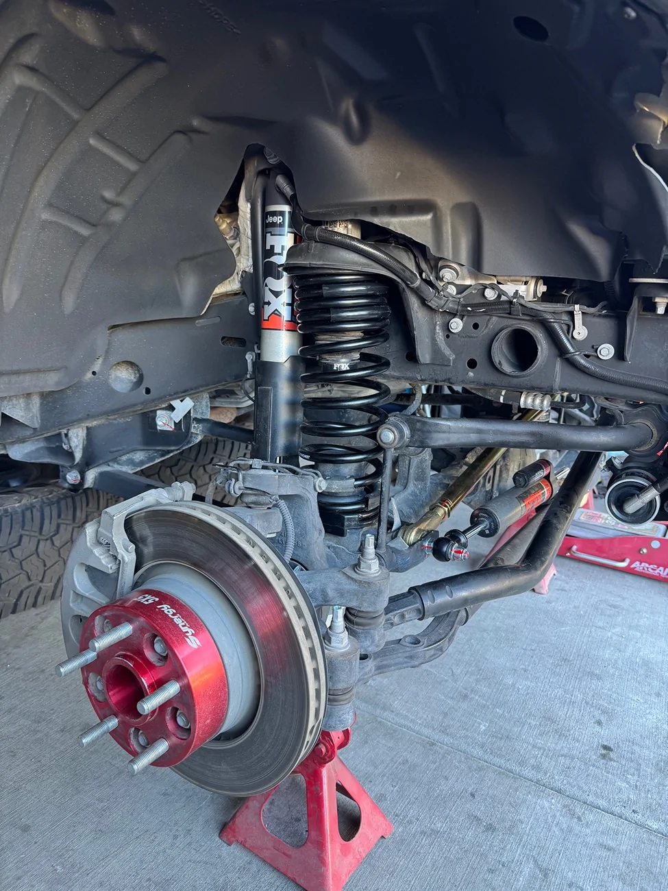

Well, I finally got around to taking some pics of phase 1 completion. 2023 Mojave 3.6, added:
  • Metalcloak 2.5" Gamechanger (with stock shocks)
  • Metalcloak tie rod
  • Metalcloak HD drag link
  • Fox ATS Steering stabilizer
  • RSI Smartcap
  • ARB Full length Bondi front bumper and skid plate
  • ARB Full length rear bumper
  • Warn Evo 10S
  • ARB Intensity Solis 36 spot/flood combo aux lights
  • 813 Fab molle panels for full bed
  • Toyo Open Country RT Trail 35 x 12.50
I have a couple thousand miles on it now, and I love it. Only thing I would consider doing differently is tire size. The 35s look small to me, but i was not prepared to regear a brand new Mojave, but might be in future phases. Prior to the lift and steering upgrades, I noticed some sloppiness in the steering and mile lane wandering, and following mods, I have experienced none to my utter shock.... it drives better than stock. With the lift and larger tires, I saw about 5" of lift in front and 4.25" in rear, inclusive of all the added weight (front added about 250 lbs and rear a bit more with cap and bumper). I was able to re-use Mojave factory skid in addition to the skid that comes with the ARB bumper, but had to mount it a bit lower and fashion some spacers.... I commented on that process in another thread.
Hope you all enjoy, and if you have any questions, I would be happy to help provide info.

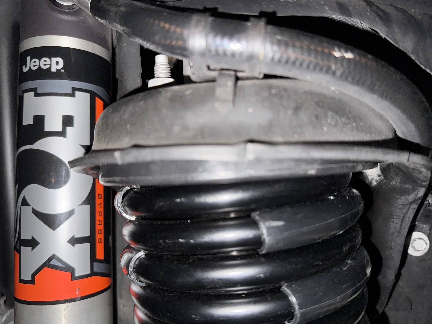

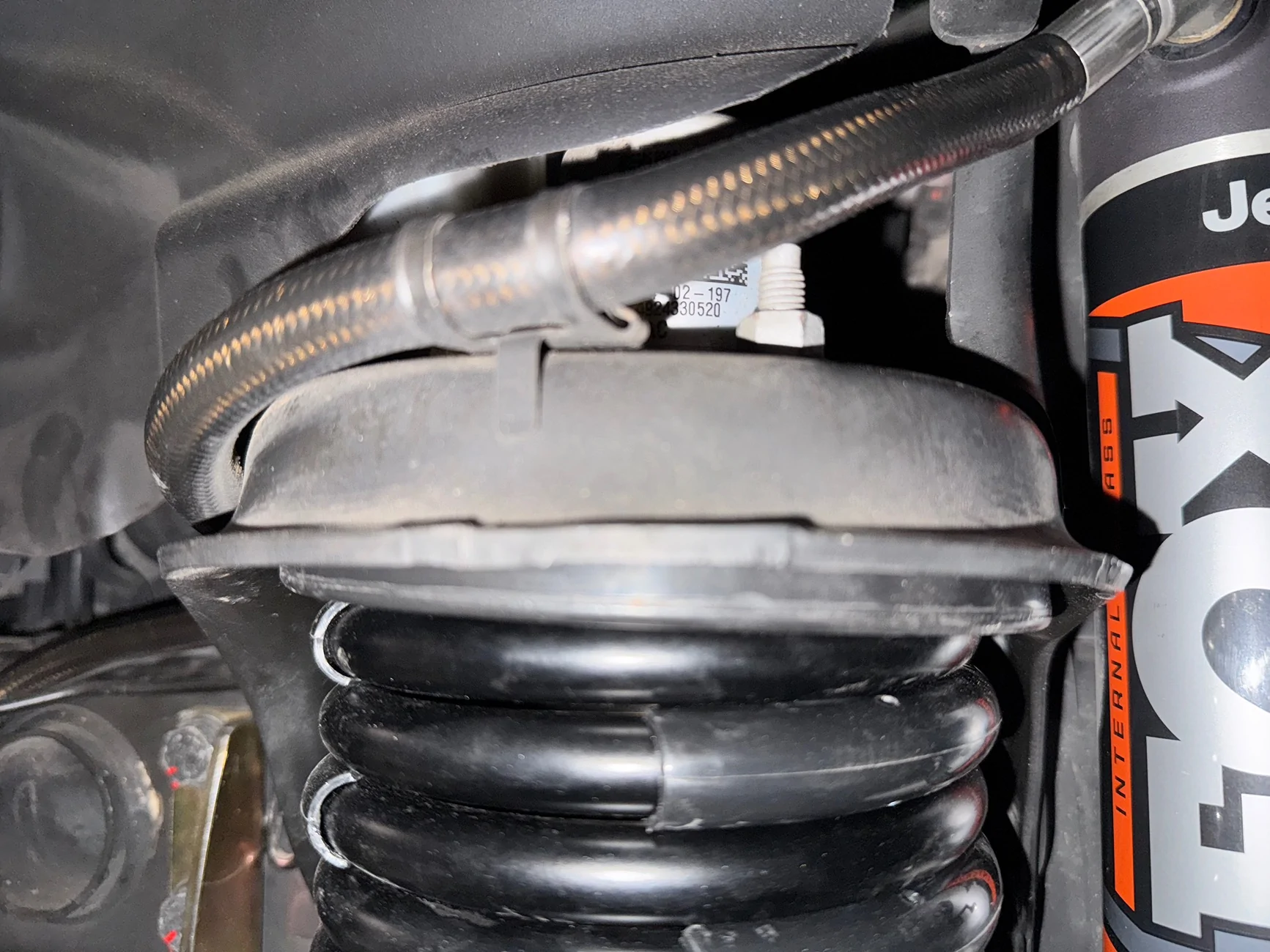

Hello. Have a question for you. I just installed some metalcloak 2.5 inch coils and i notice the upper coil isolators look a little slanted. Maybe it’s suppose to be this way but is yours lower on the shock side like this? Mine also gave me a pretty significant lift, like 4.5 but Itll probably settle a bit.

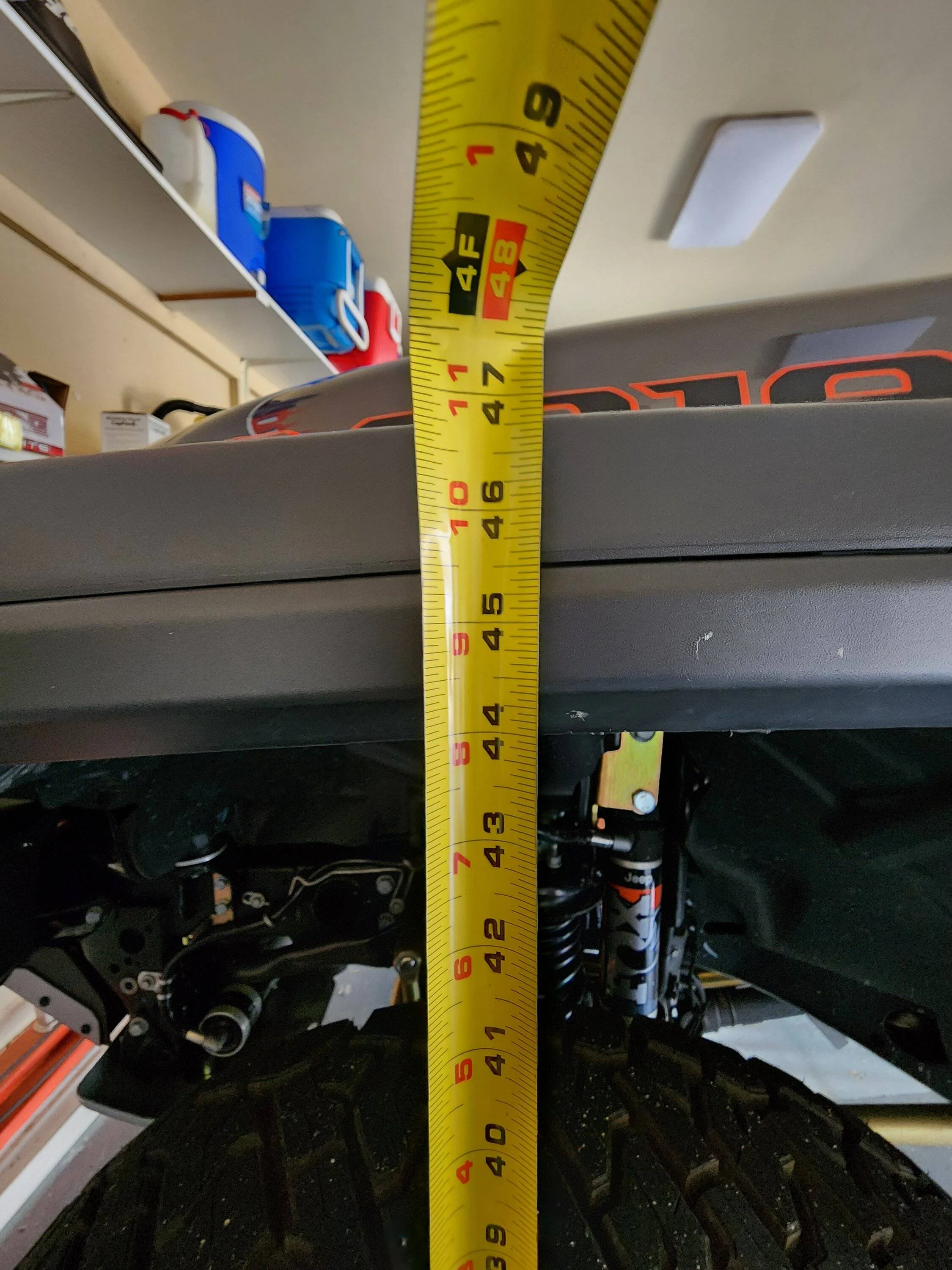

I know this post is a little older now but I'm looking to do the same lift and had a few questions!
1) How is the ride with the lift and factory shocks? I've heard mixed reviews and wanted your opinion.
2) Did you replace the front driveshaft or have any issues with this matter after the lift if you stick with the factory one?
3) Looks like you have the factory wheels, did you install any spacers? I keep reading that you need a minimum of 2" spacers to keep from rubbing at full lock. Any issues with this on your rig?
4) Its been a few years now but any thoughts, comments, regrets with this build?
Thanks for the info and the rig looks great!
