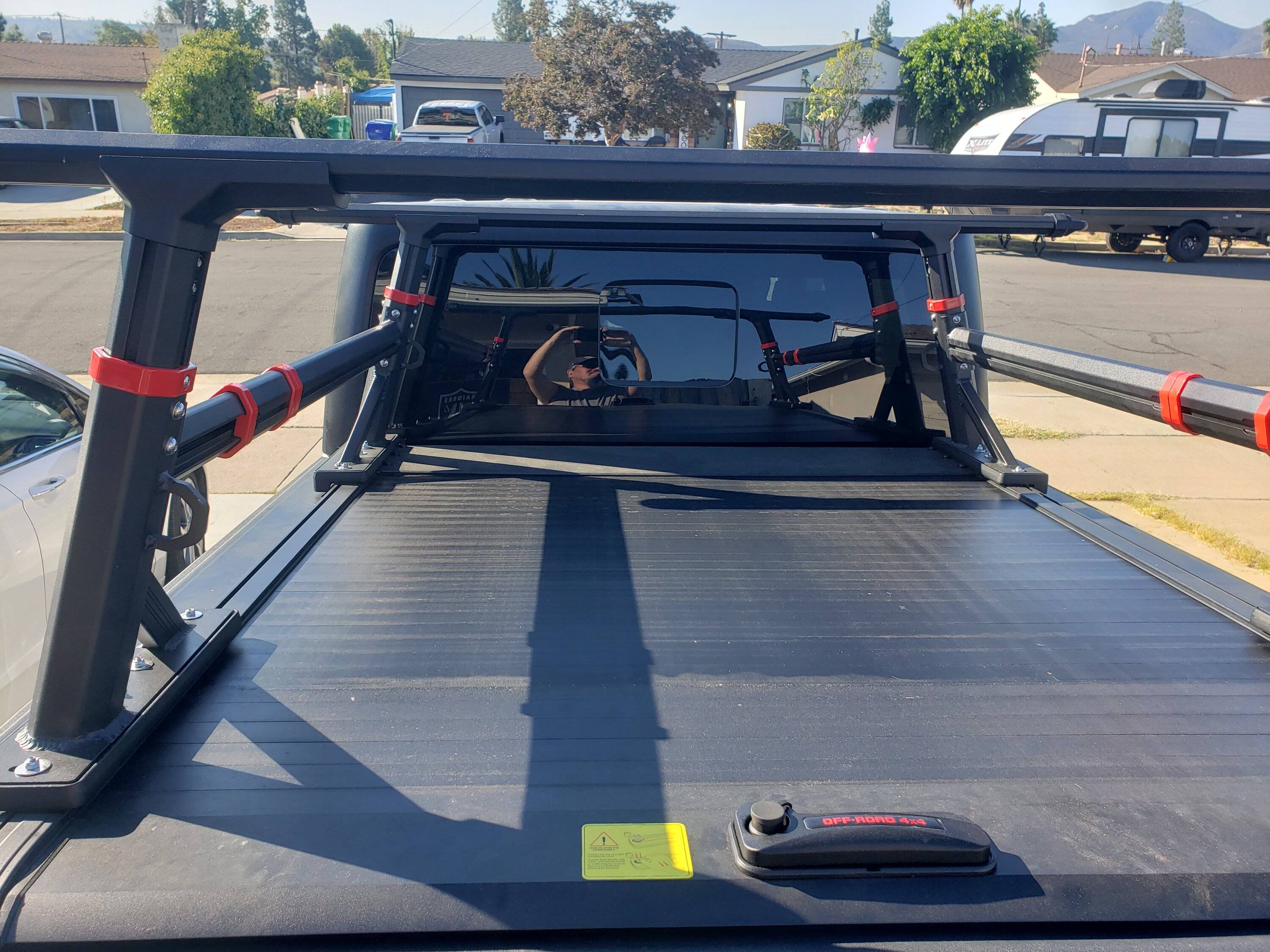

My Antidote retractable keeps everything dry. Why doesn't your rollnlock??
I wish I knew. We've had rain the last few weeks and I went out to a moldy recovery bag and soaked bed rug.
One other thing to keep in mind is never roll it up when there is water on the surface. Once it rolls, the water drips onto the under side and will then drip inside once you close it again. I found that out the hard way during a rain storm when I had to get things out in a hurry.
I really wish someone made a one piece, hinged lift tanneou cover. I had one on a previous truck and it was a great way to have a water proof cover with good security while keeping a completely open bed.
I might be switching to the Diamondback Switchback when I can justify spending the extra money.

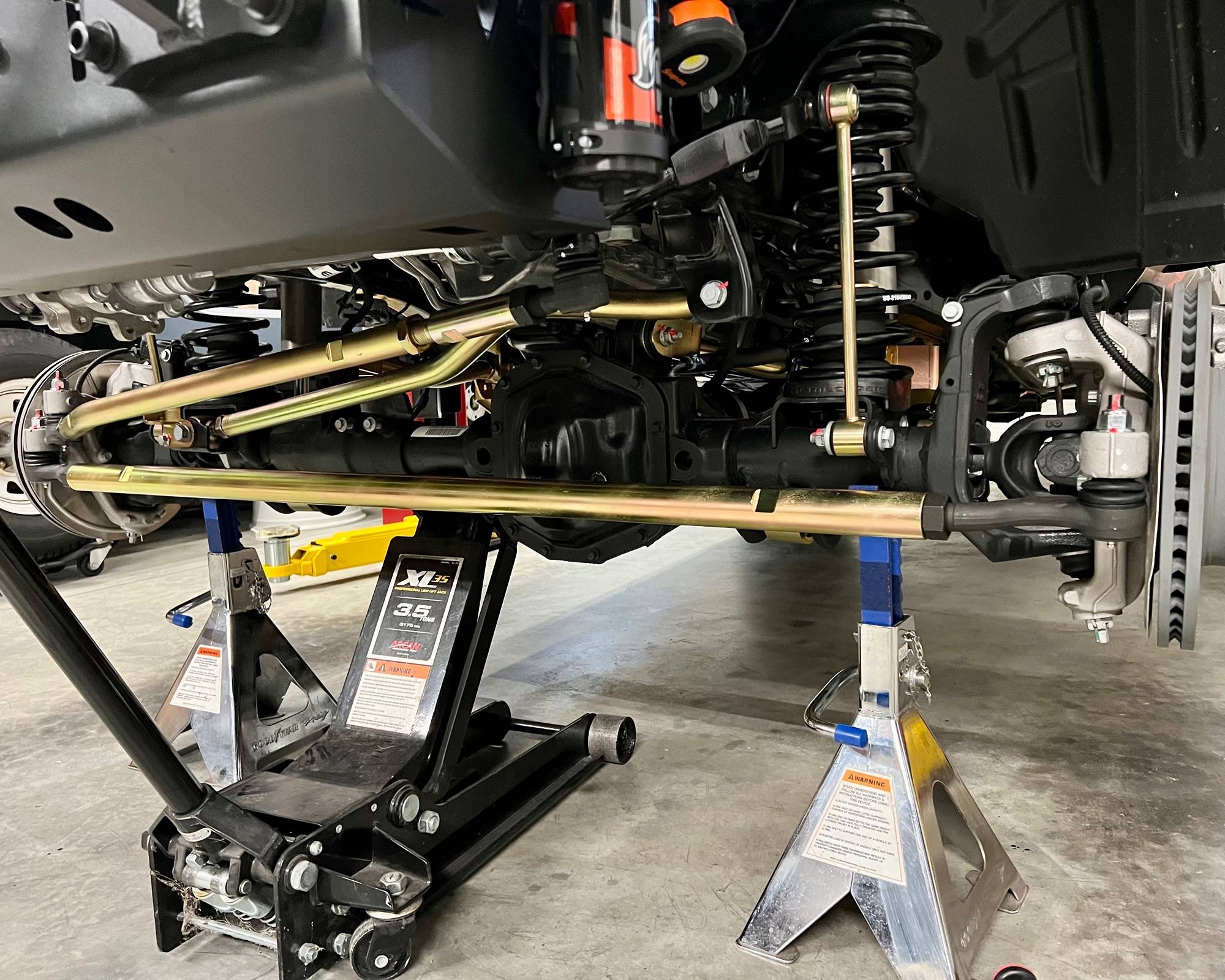

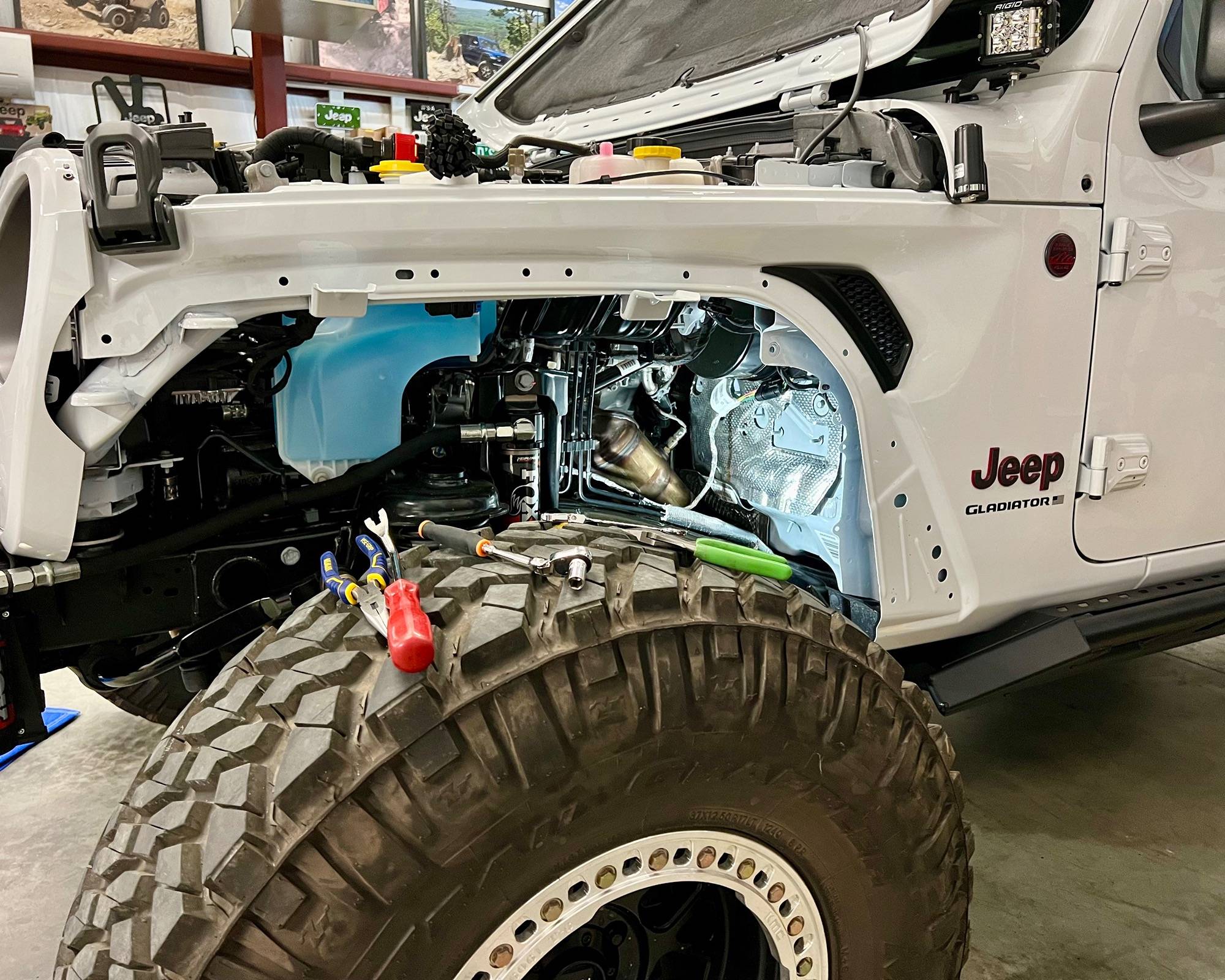

I was delayed in getting the MetalCloak tie rod and drag link installed. The factory drag link end failed with 1200 miles and 37”. So, added the new parts.

Looks good!
I have yet to do steering upgrade as well, so most definitely can relate. ?

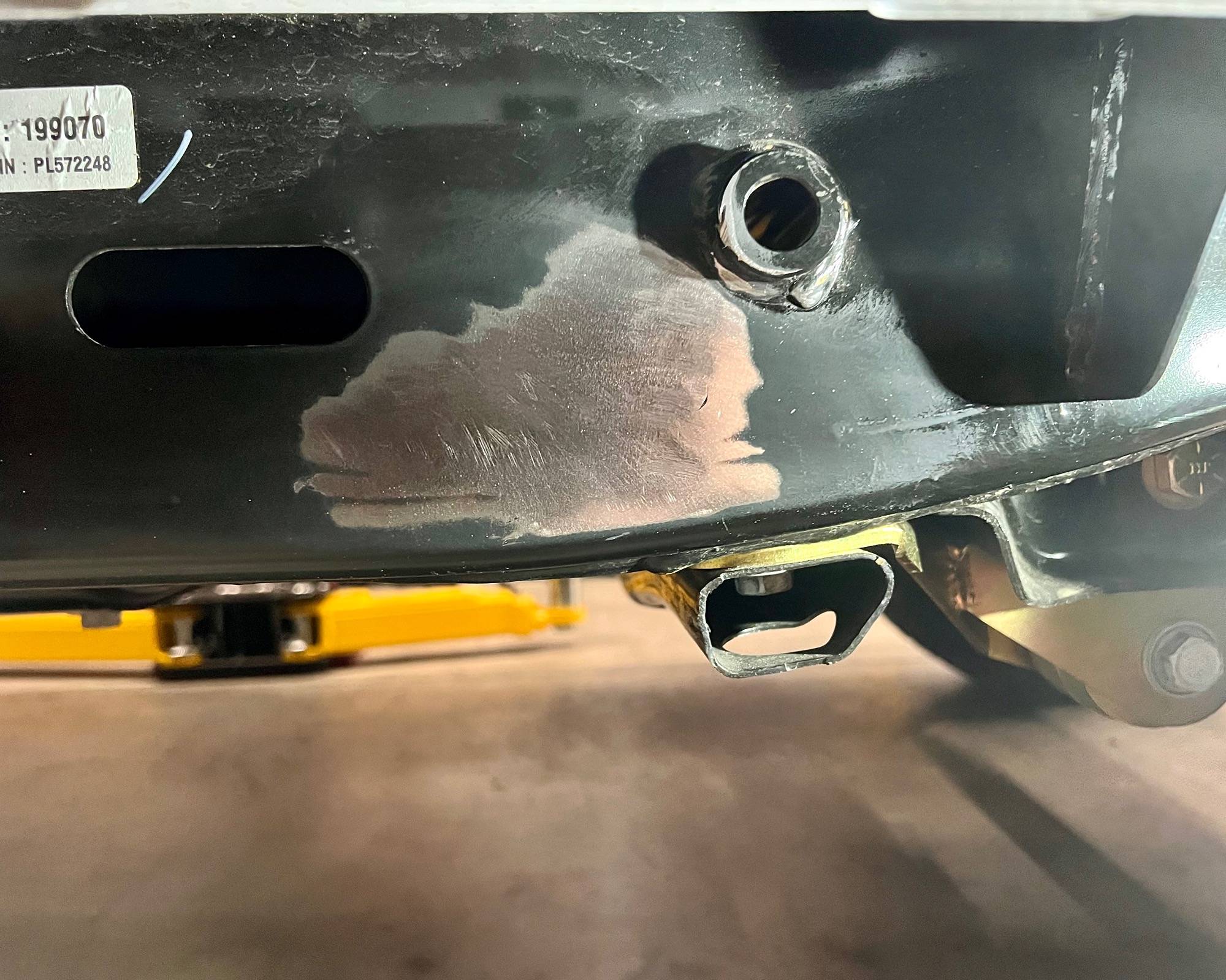

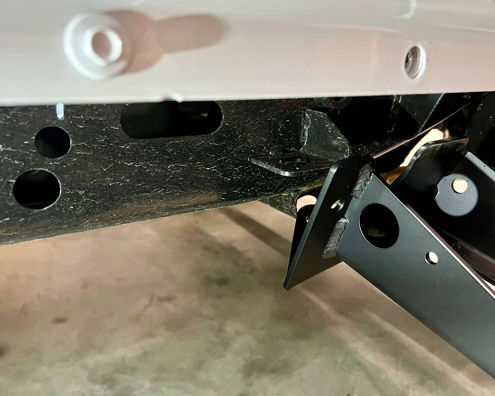

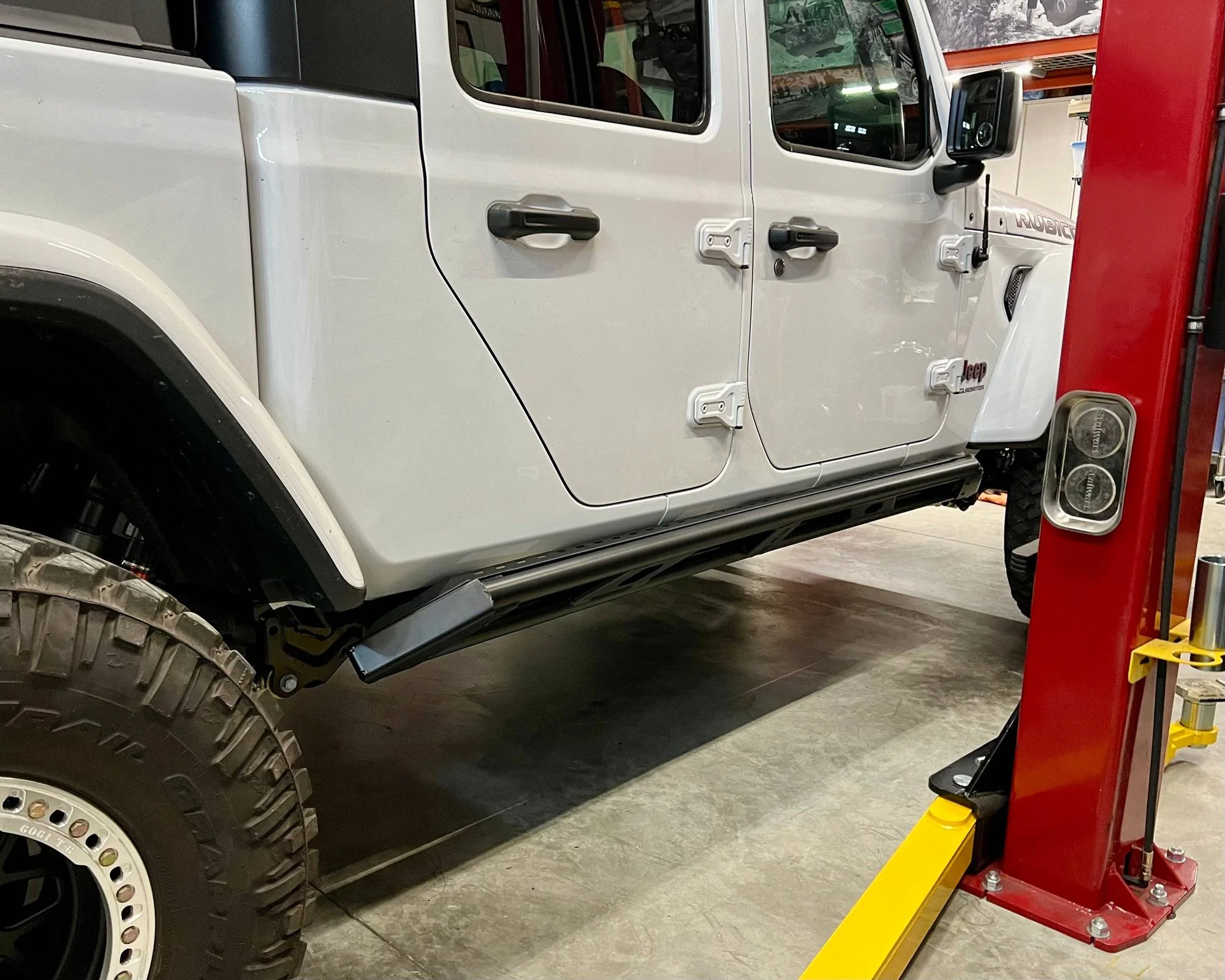

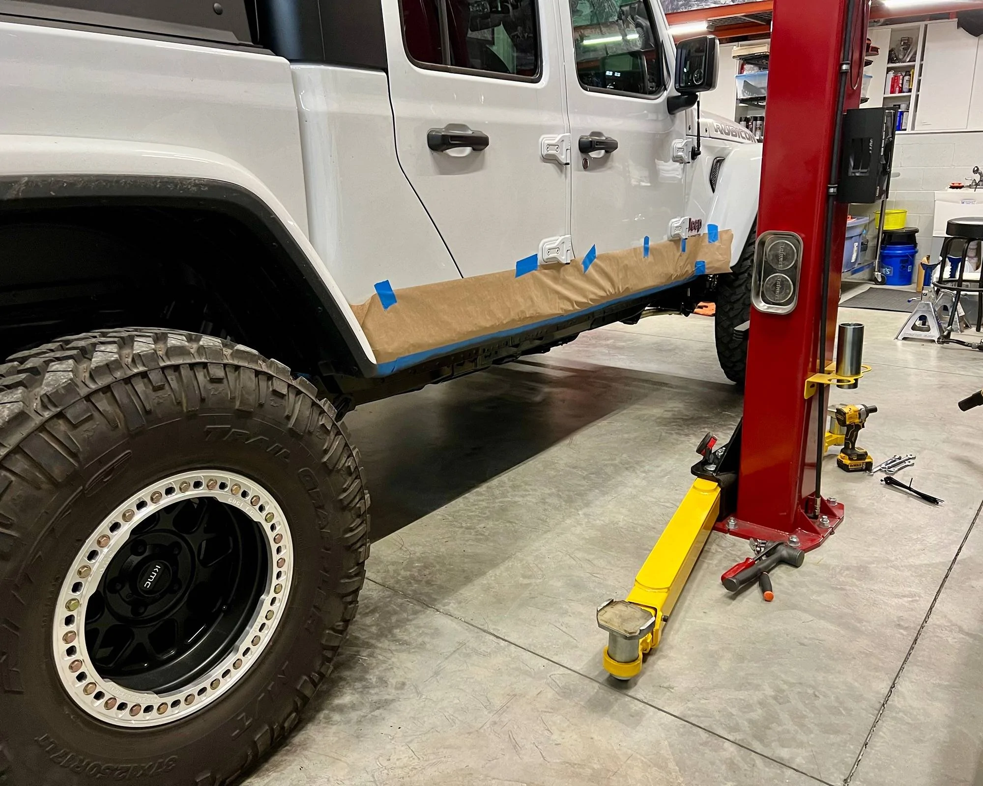

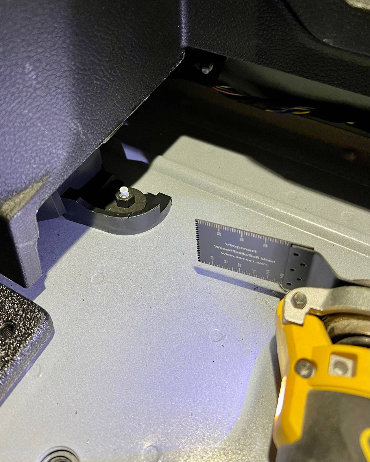

Added EVO Rockers… there is a factory bracket on passenger side that was removed. The center body mount brackets needed to be trimmed.

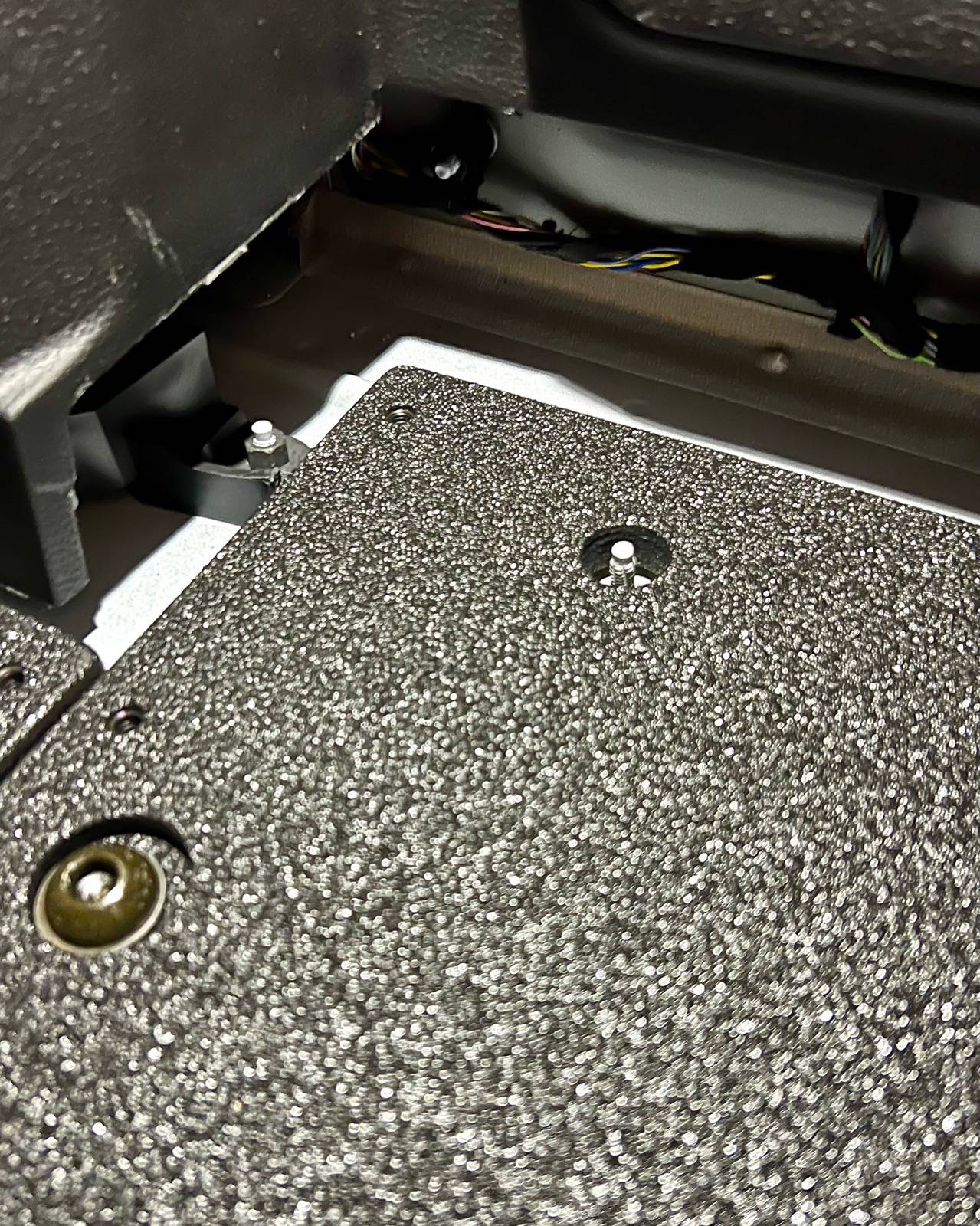

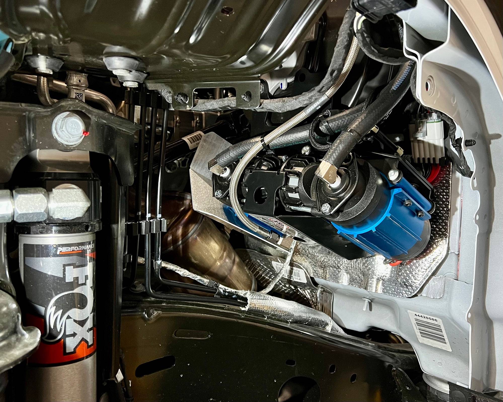

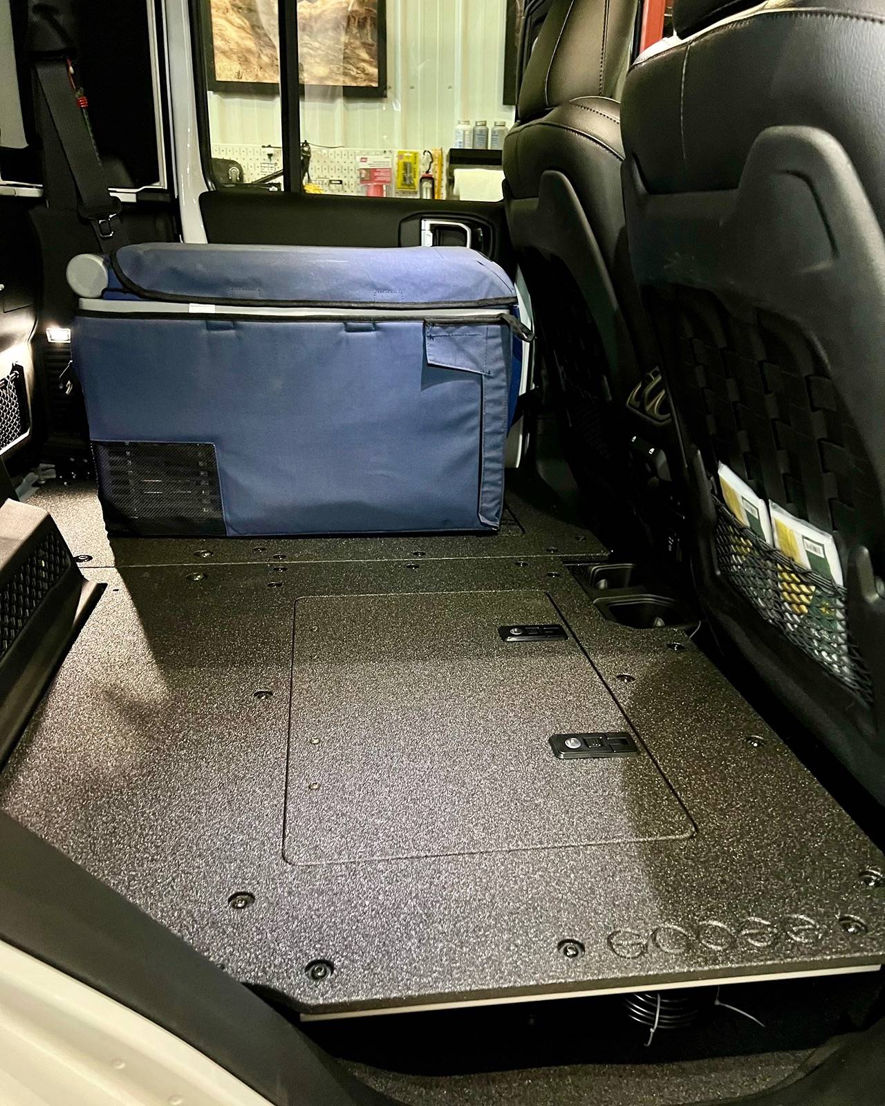

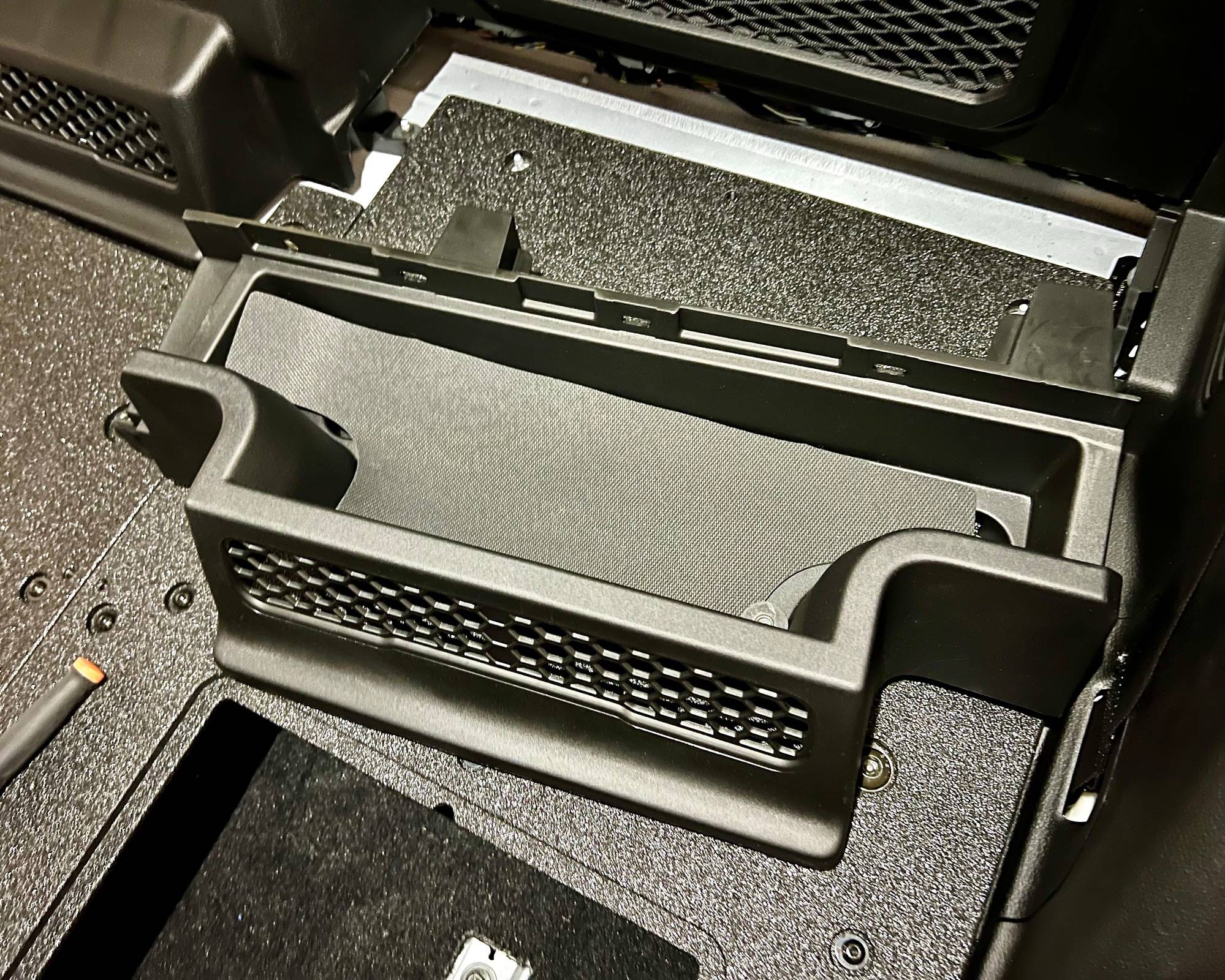

Added Goose Gear, on the 40 side used the longer version which requires removing tray on driver side and cutting 3/4” off a plastic trim retainer. Now more room to push ARB Refrigerator back.

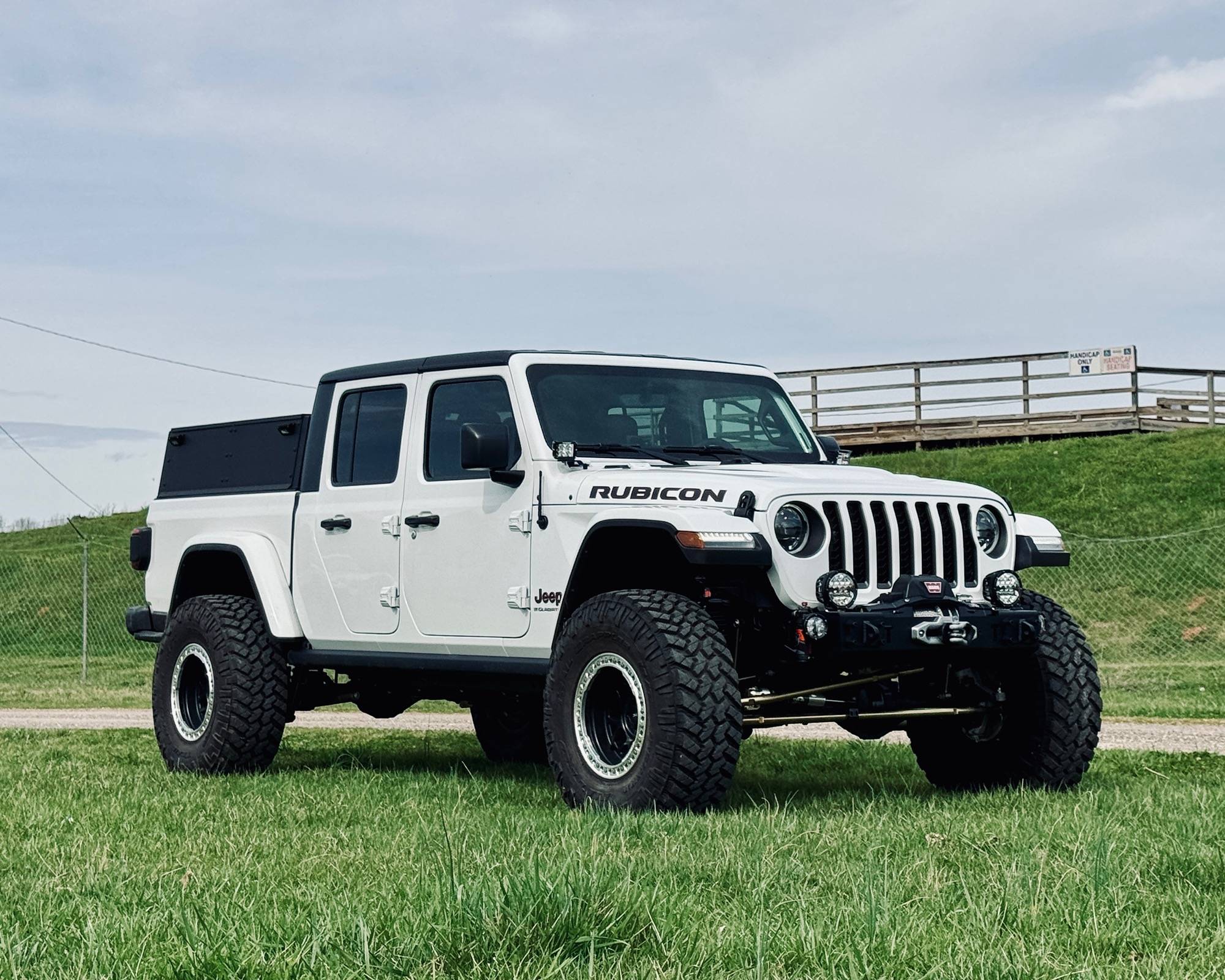

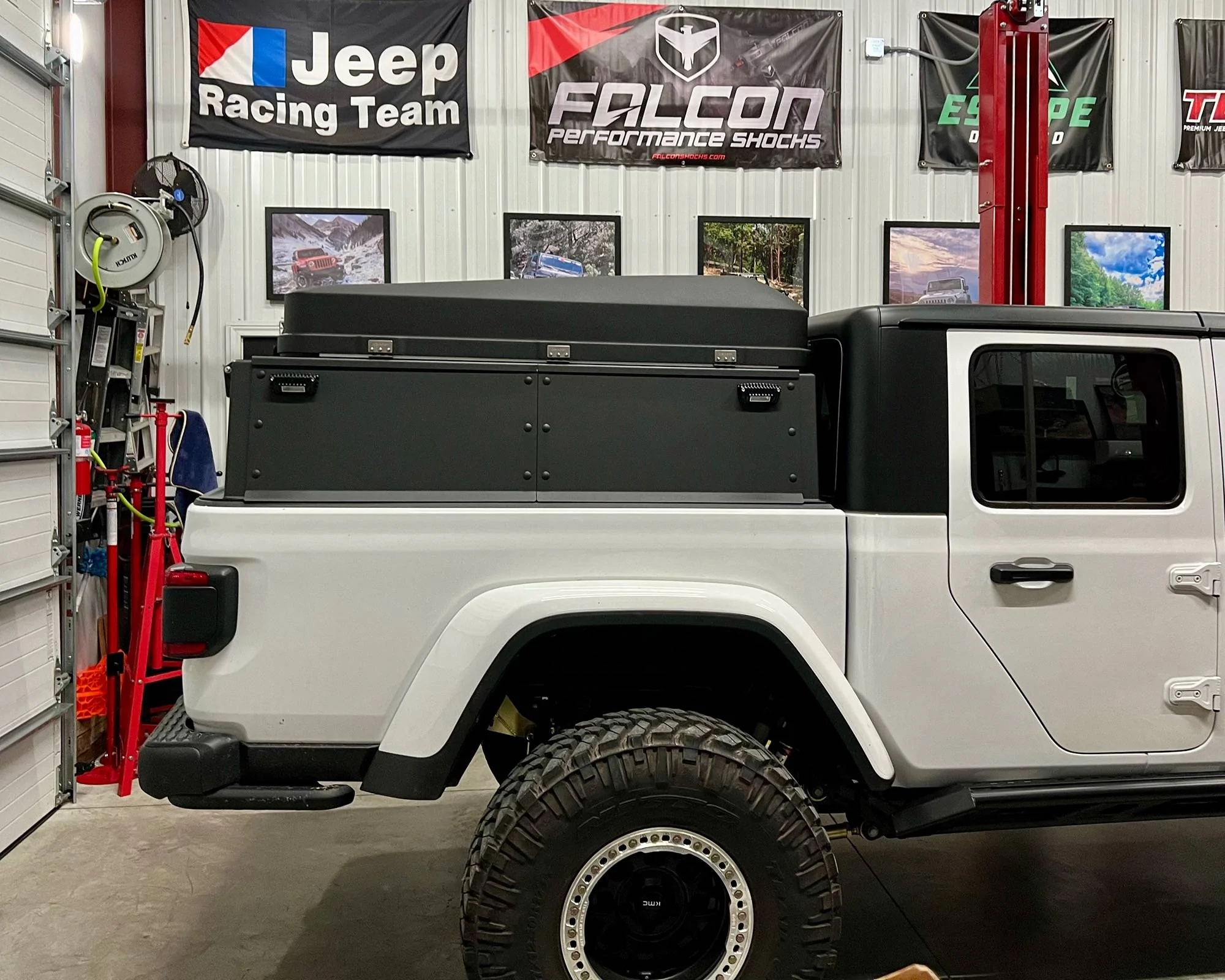

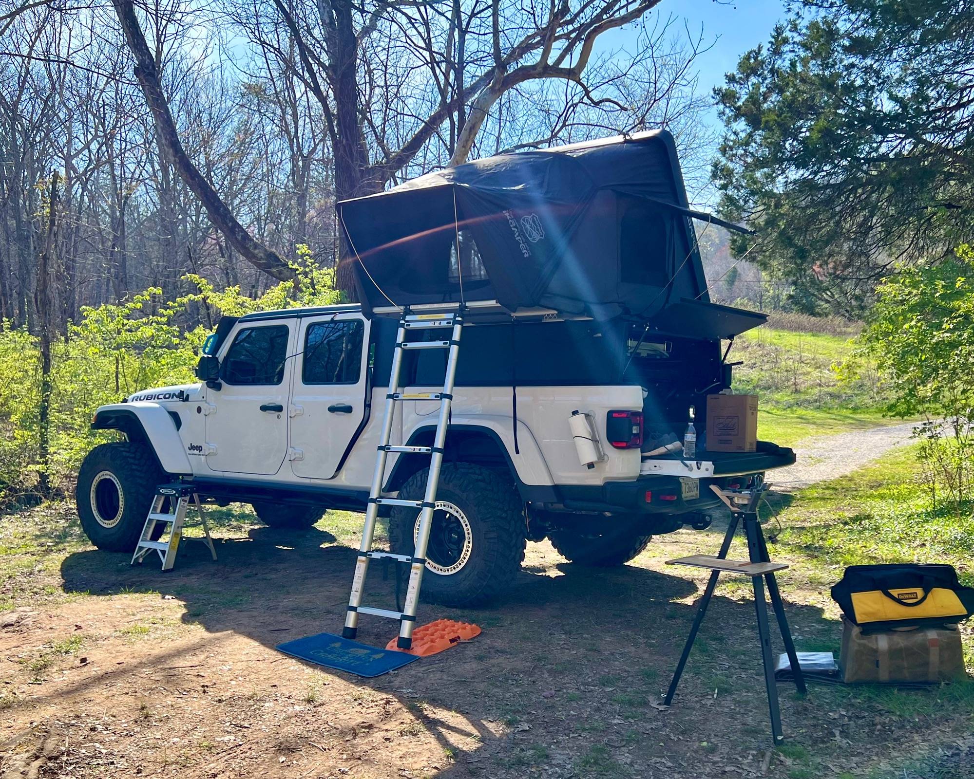

Added iKamper using custom aluminum pucks.
Jeep Gladiator “Queso” 2023 Gladiator Build and Travels IMG_5644
Jeep Gladiator “Queso” 2023 Gladiator Build and Travels IMG_5654
First night out, many to come… breakfast was steak and eggs, photo before the eggs

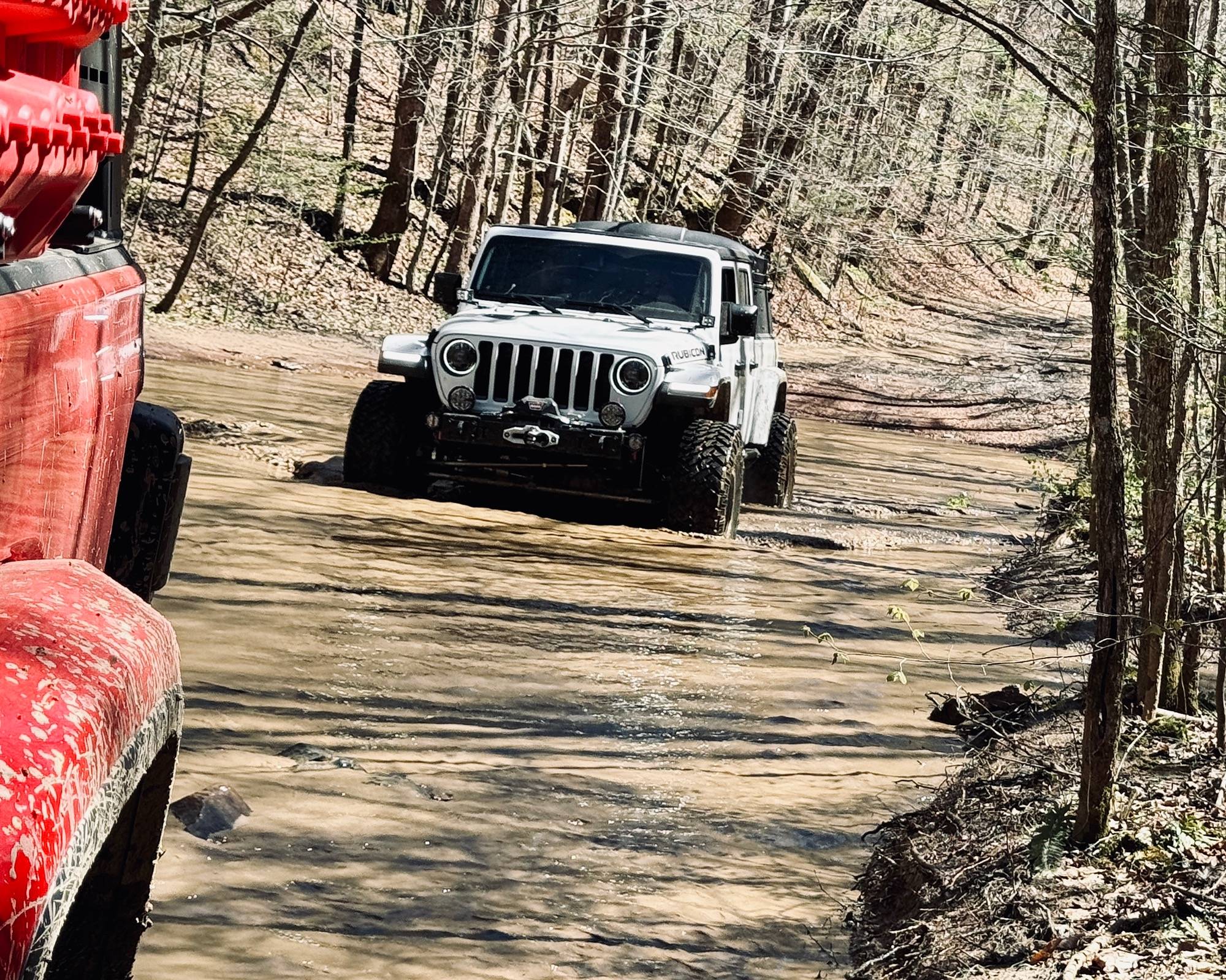

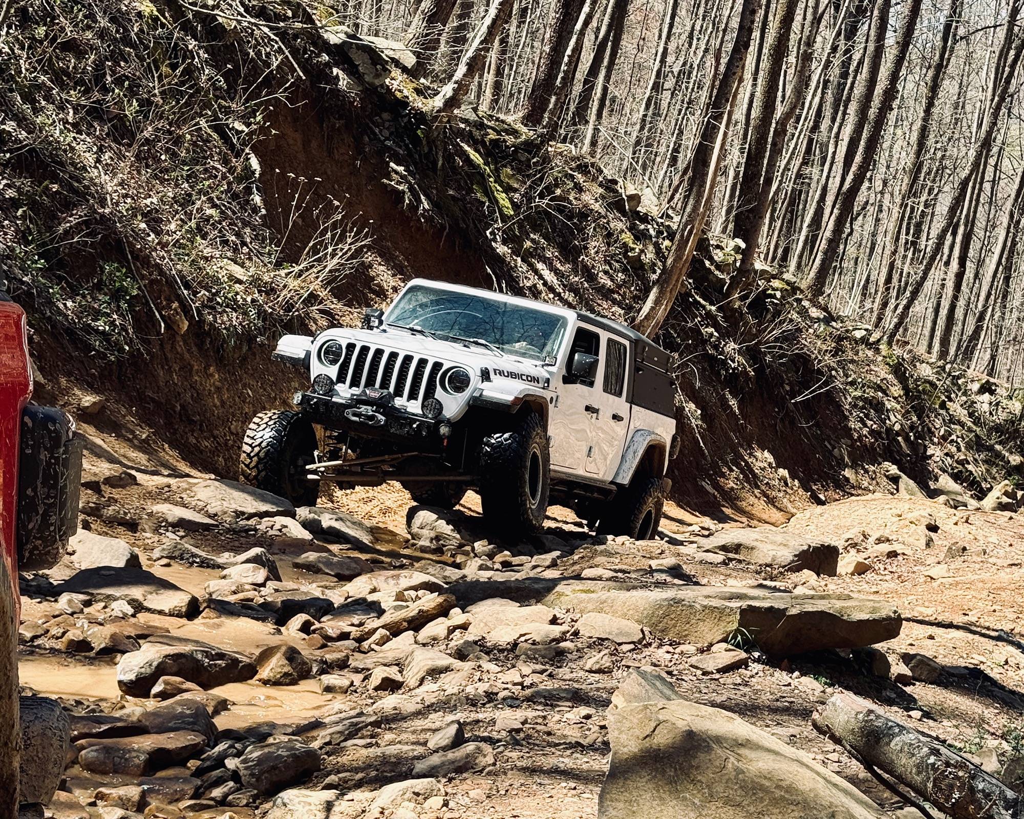

Nice shake down run at Windrock.
