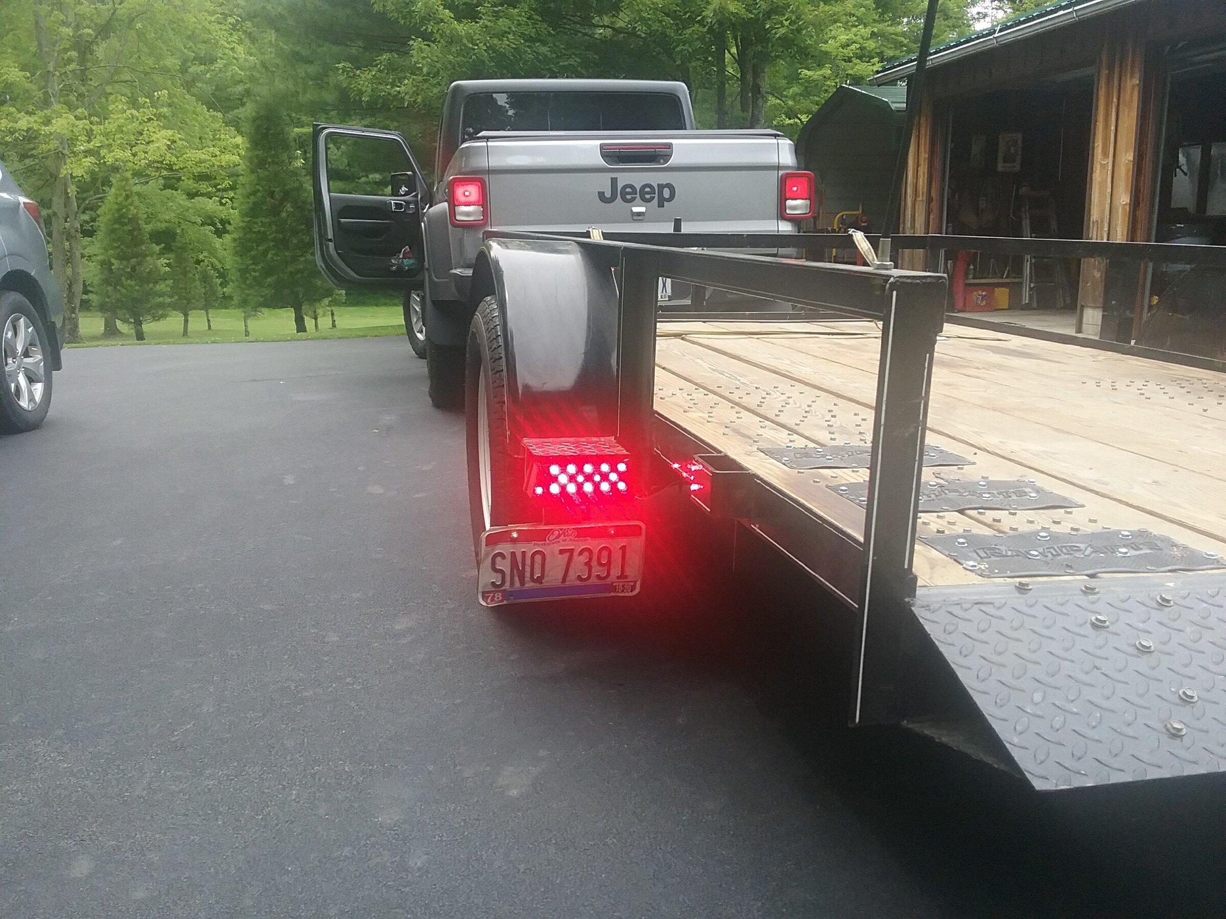

If the bed of the trailer is above the wheels I wouldn't want it. Utility trailers keep the load low so less chance of flipping on a curve. Snow mobile trailers are usually above the tires so you can get two of them on it. Not the best set up but that's the way they make them.
This is a 5' x 10'
Jeep Gladiator 8’4” x 10’ - Feasibility for an inexperienced tower Resized_20200627_135812_4283
